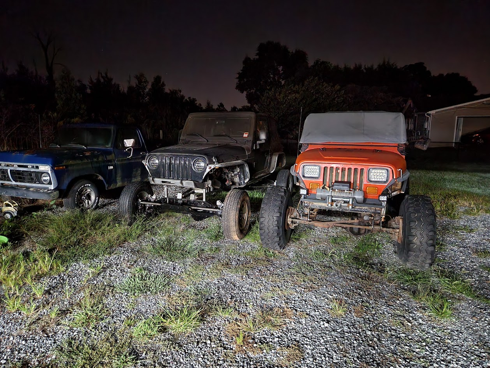

Squatter Jeep is a roller and no longer taking up shop space
Now we wait till the customer supplies the parts that I've been waiting on for way to long.

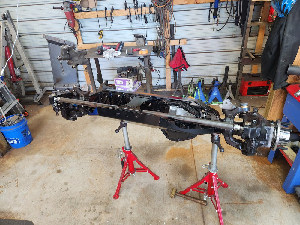

Absolute beast of a Dana 60 (only has a tie rod for roller status, got a PSC ram for it)

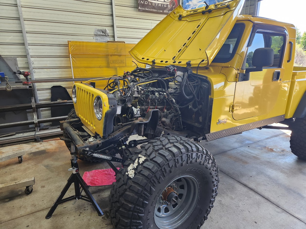

Tear down begins on Big Bird

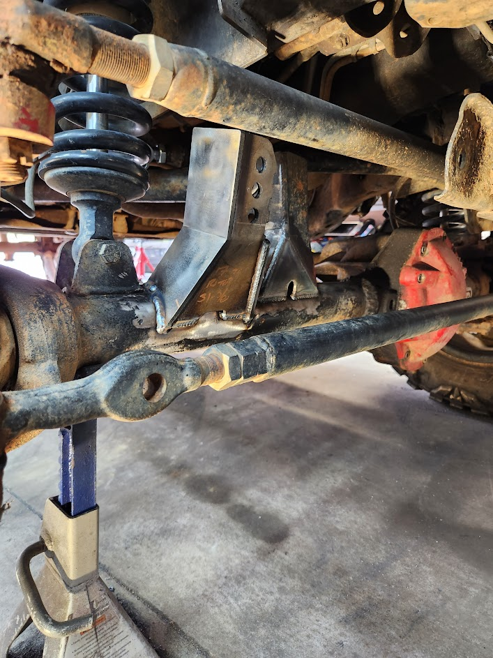

Really dig this Goat Built Bracket setup, definitely ordering one for my motor.

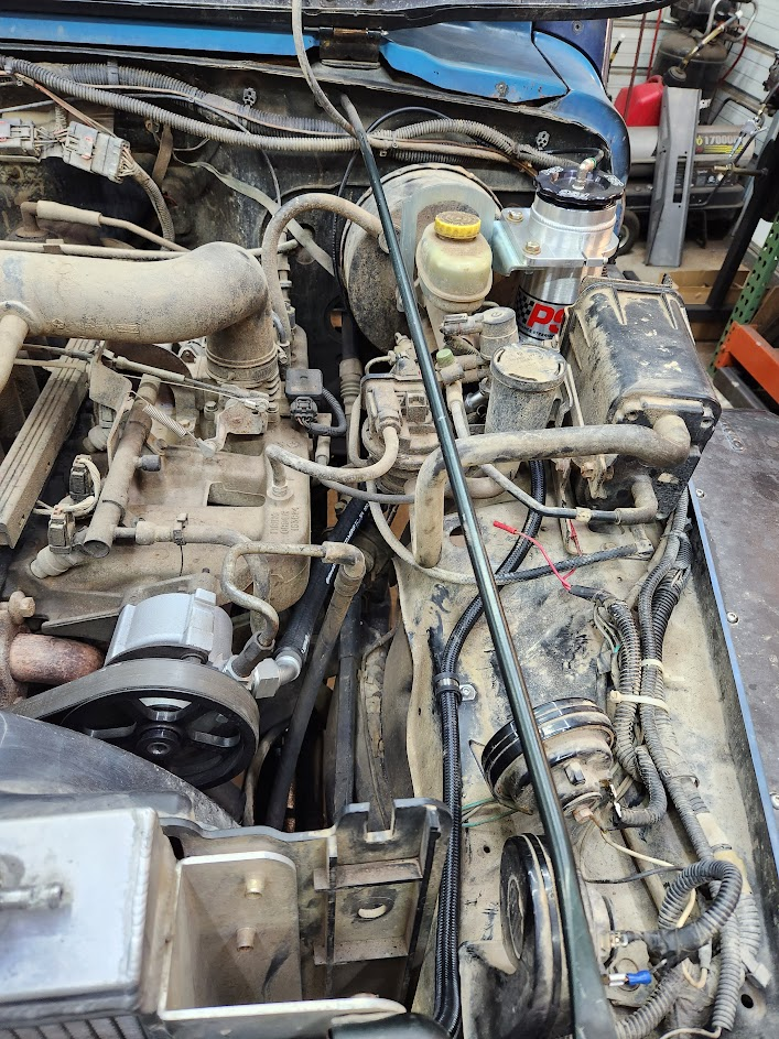

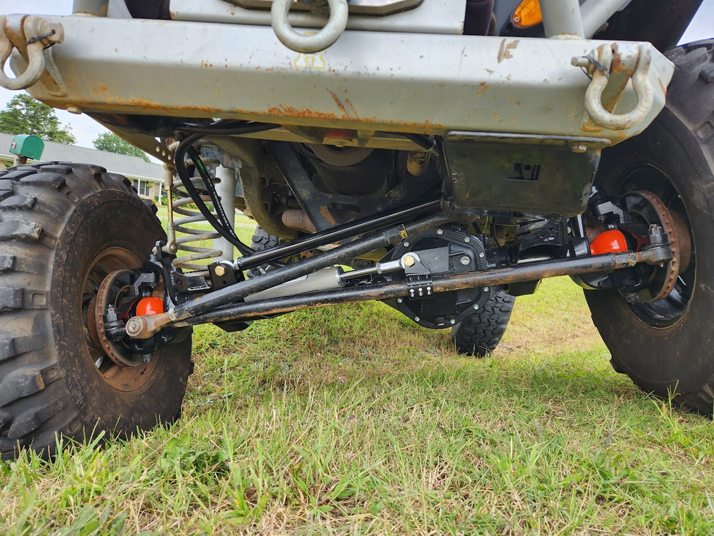

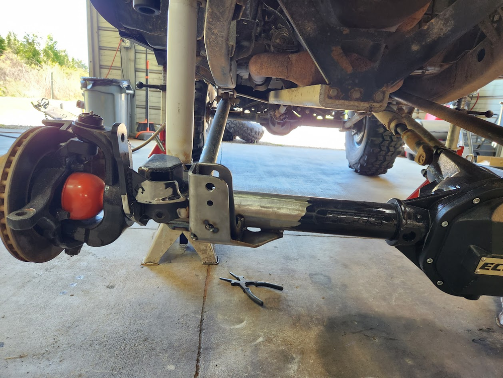

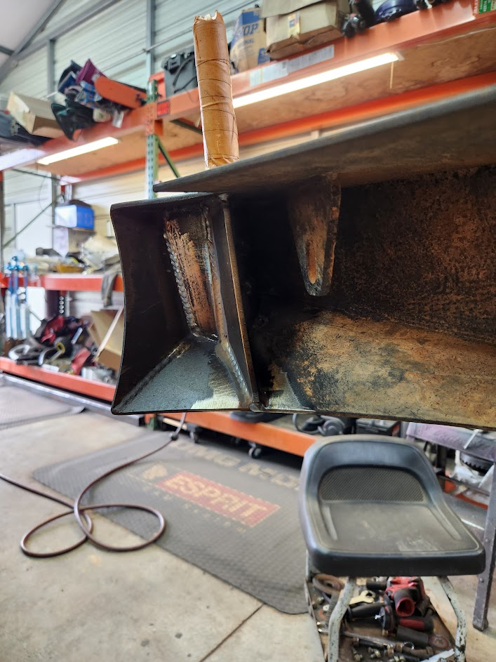

Did a hydro assist set up on @BigClay TJ, got PSC pump kit and ram along with a new Blue Top ported steering box. Plus a new track bar set up (old track bar was wore slap out) and power steering cooler.

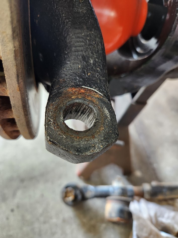

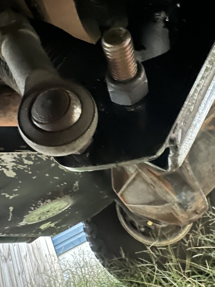

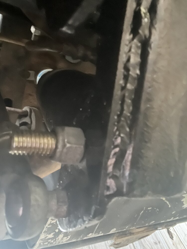

Unexpected repair caused by the shop who bolted this axle in, not going to name who it is but unbelievable that shit like this is ok to them. Not sure what they reamed these brand new knuckles out with but by far the worst I've ever seen. PS was reamed about a 1/4" to deep and the nut was loose when I dropped the steering out. They also didn't move over the upper link joint from the old axle that used a 1/2" bolt (ECGS send them with the stock sized 7/16"/10mm joints) so they just put a 7/16" bolt through the link that's drilled for a 1/2" bolt. So had to swap that out for a new one since Clay had already sold his old Dana 30. So just be cautious of where you take your junk to get worked on.
Compare that to what a properly reamed tie rod end hole should look like.
Clearance is clearance

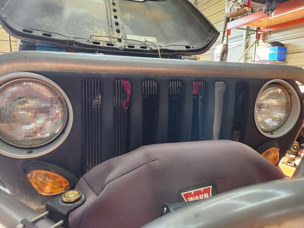

Clay's very dirty under hood shot with a few shiny new parts.
Nice large steering cooler installed, mount came out minty.
Came out really nice and drives much better having a tight track bar and basically no noticeable bump steer with the new track bar set up.

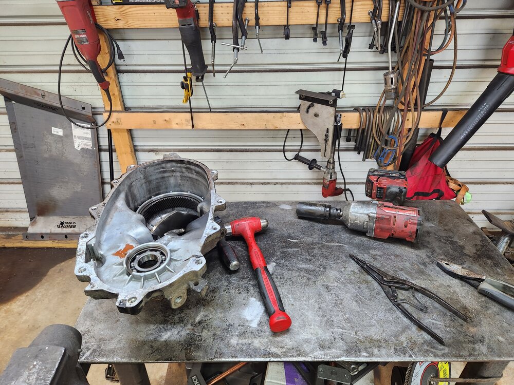

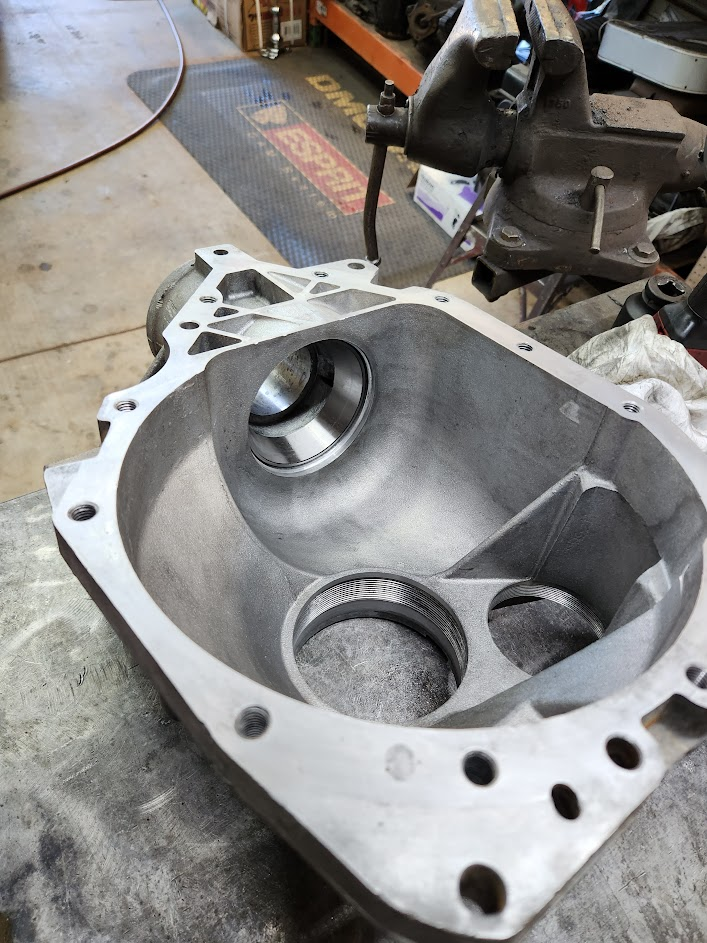

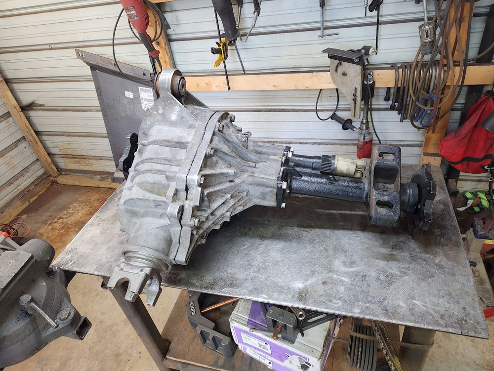

Re-geared a AAM 9.25 for @CarolinaHD These things really ain't to bad to do after you get done with draining every 4 letter word in your dictionary :laughing: After that they are a breeze.

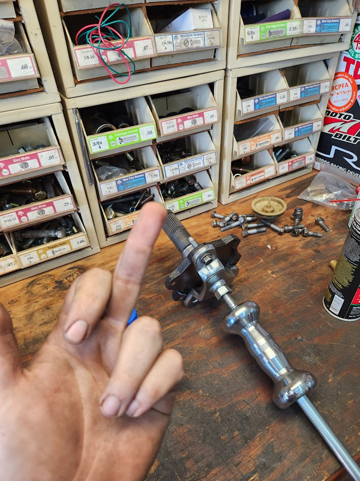

Driver stub shaft fought me for 45 mins before it finally came out.
Another area of difficulty, race in the freezer and a little well placed heat makes the race go in much easier. Similar process to get the driver side carrier race out since it's driven into a blind hole, just take the o ring off since the MIK doesn't come with a new one.
All back together with a fresh set of 3.42 gears and all new bearings and seals.

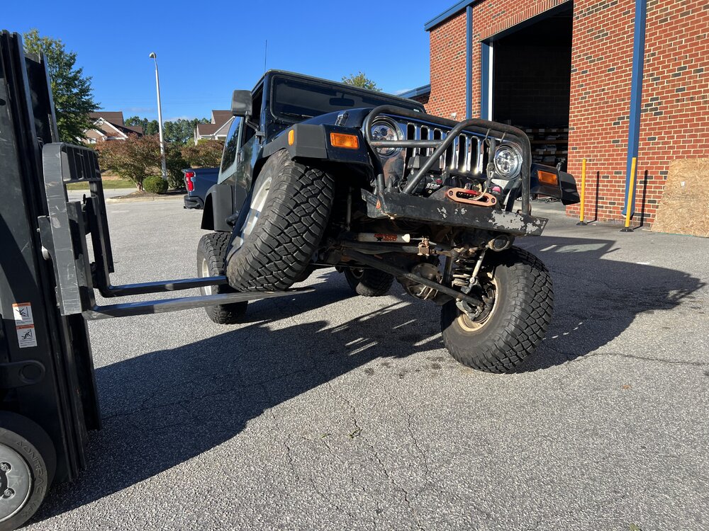

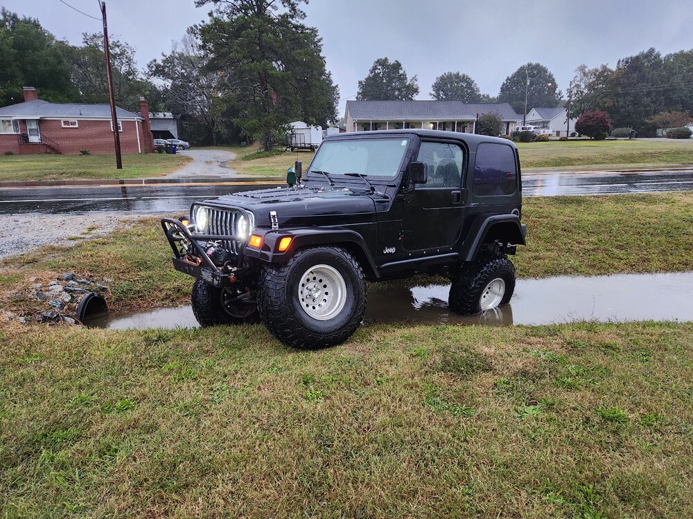

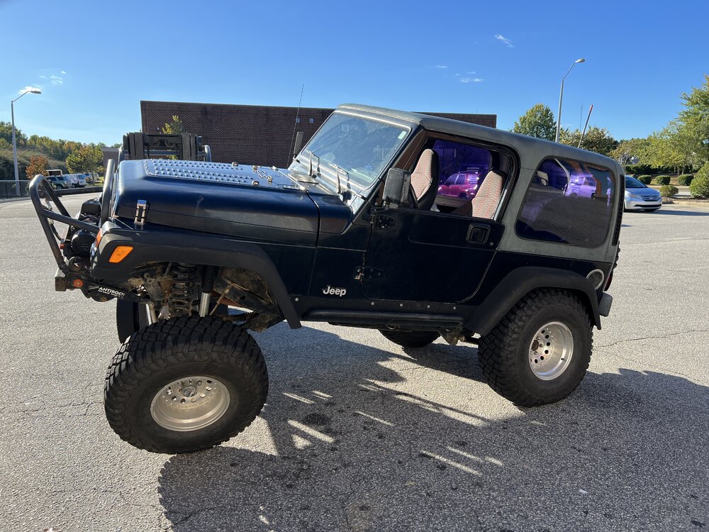

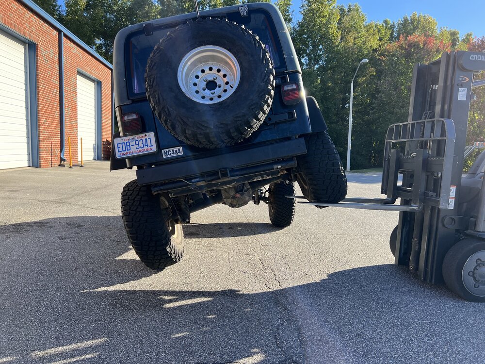

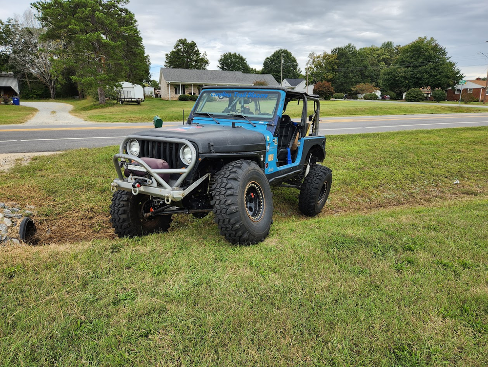

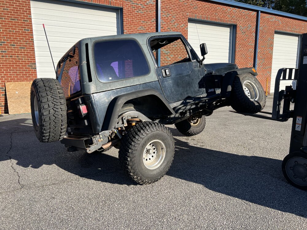

Just your average flex test during a hurricane.

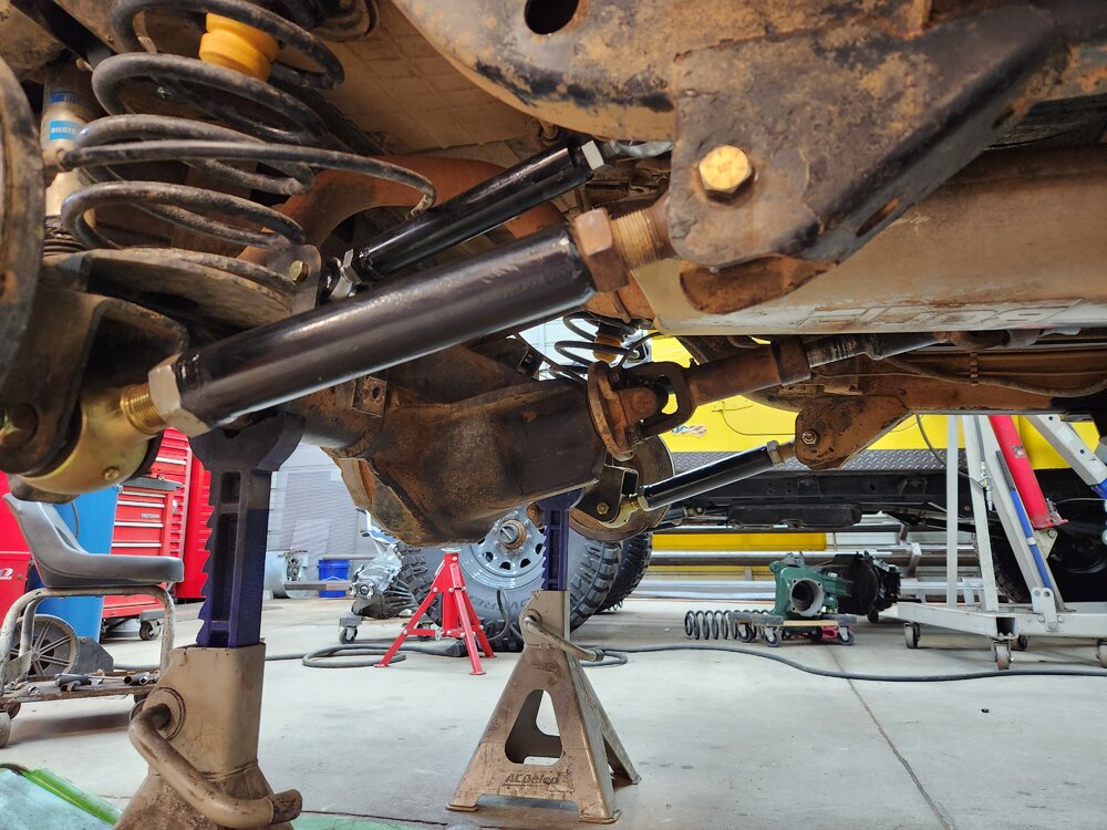

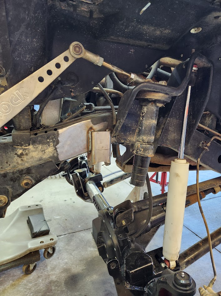

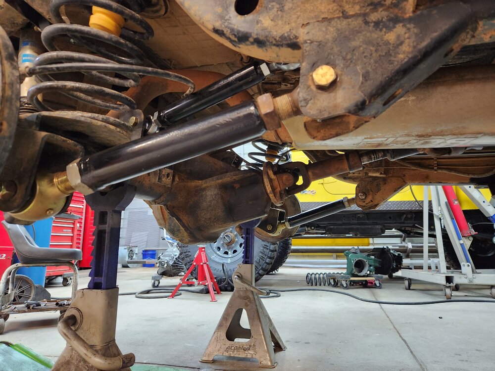

I'll need to grab some more pics tomorrow but the sway bar tabs came out slick. Probably some of the cleanest cardboard templates I've ever made.

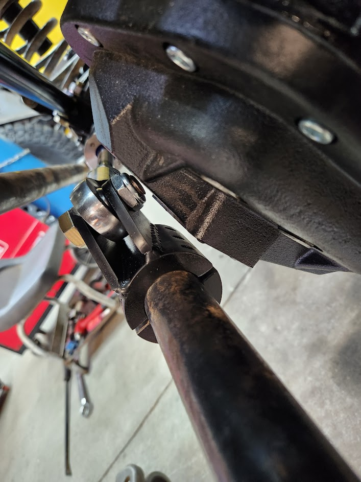

Enduro's added to the lower control arms plus new uppers with heims. Flexes better than it did, still slightly plagued with short arm problems but will actually flex now where before the drivers side was binding up pretty hard.
Not what I was expecting to find when I dropped the tank to install the Savvy gas tank skid.

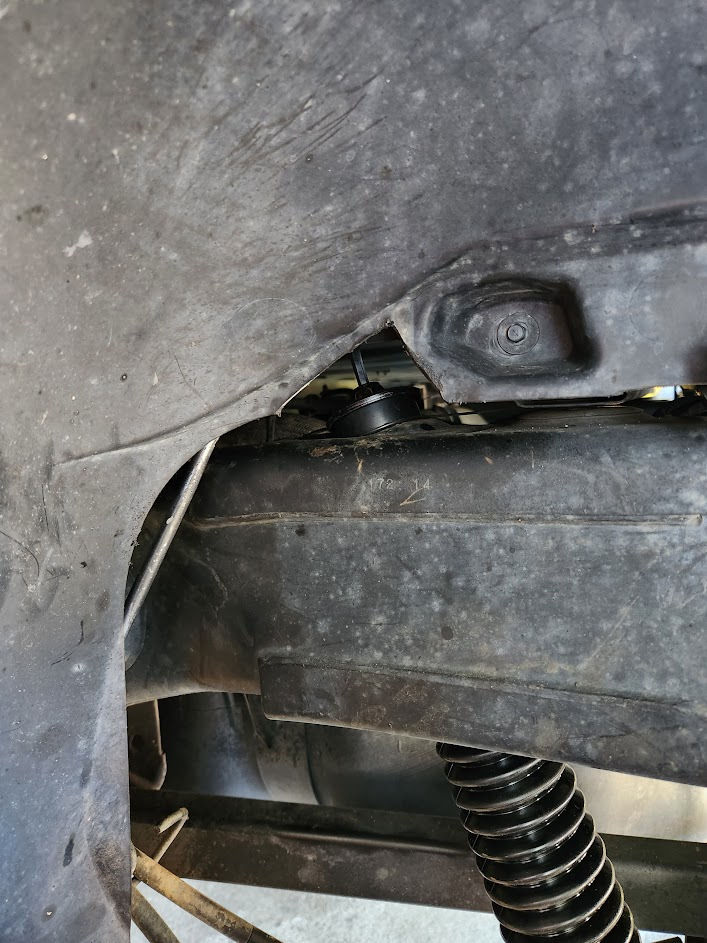

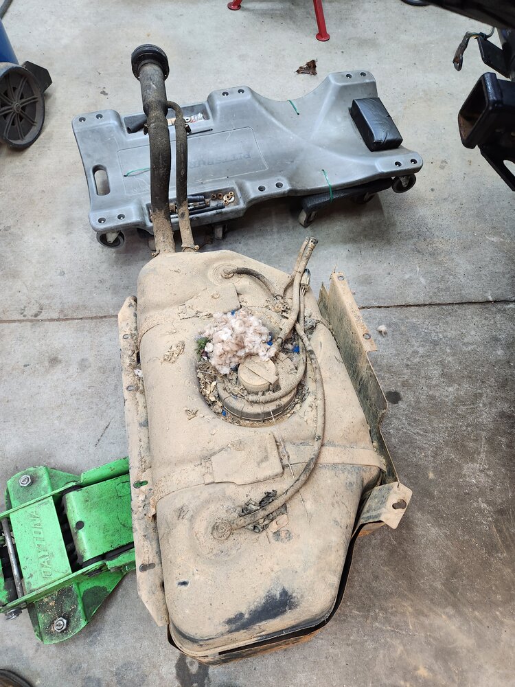

Best pictures I could get right now of the antirock shock bracket.
Got to test out the flex at work today. It's very smooth now.

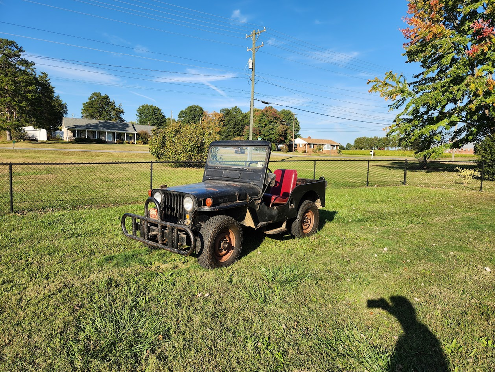

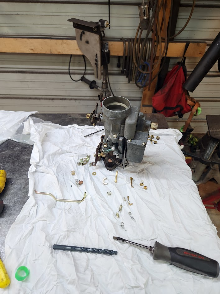

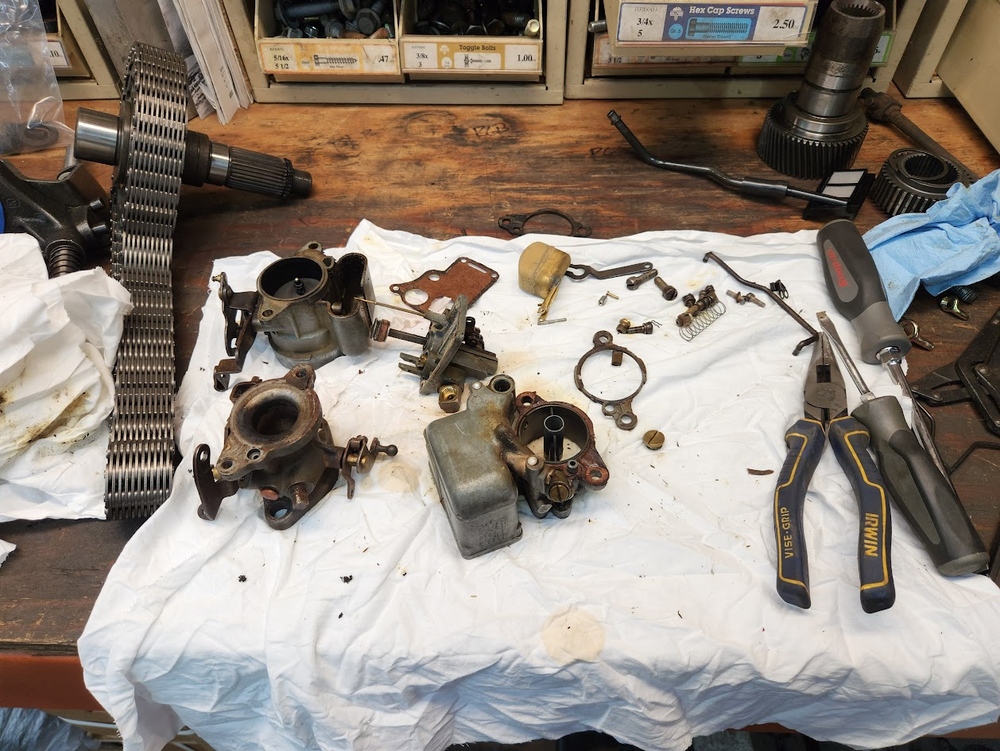

Had a CJ3A in shop awhile back, oldest thing I've ever worked on. Was running right and needed some tune up TLC so @Joe J. and myself got to work.

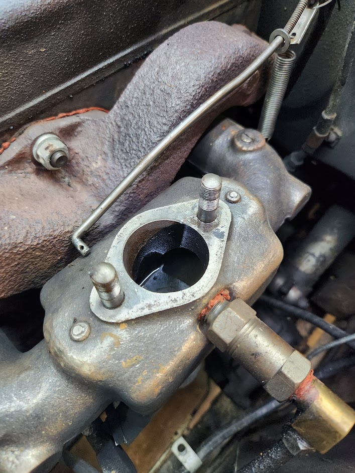

Carb needed a touch of a rebuild, was straight dumping fuel like a top fuel dragster.
We're just going to act like I knew what I was looking at while taking this apart.
All cleaned and back together, just overlook all those extra parts and know they weren't needed.
There were many "test drives" with this thing, was stupid fun to rip through all 3 gears at a blistering 40 mph

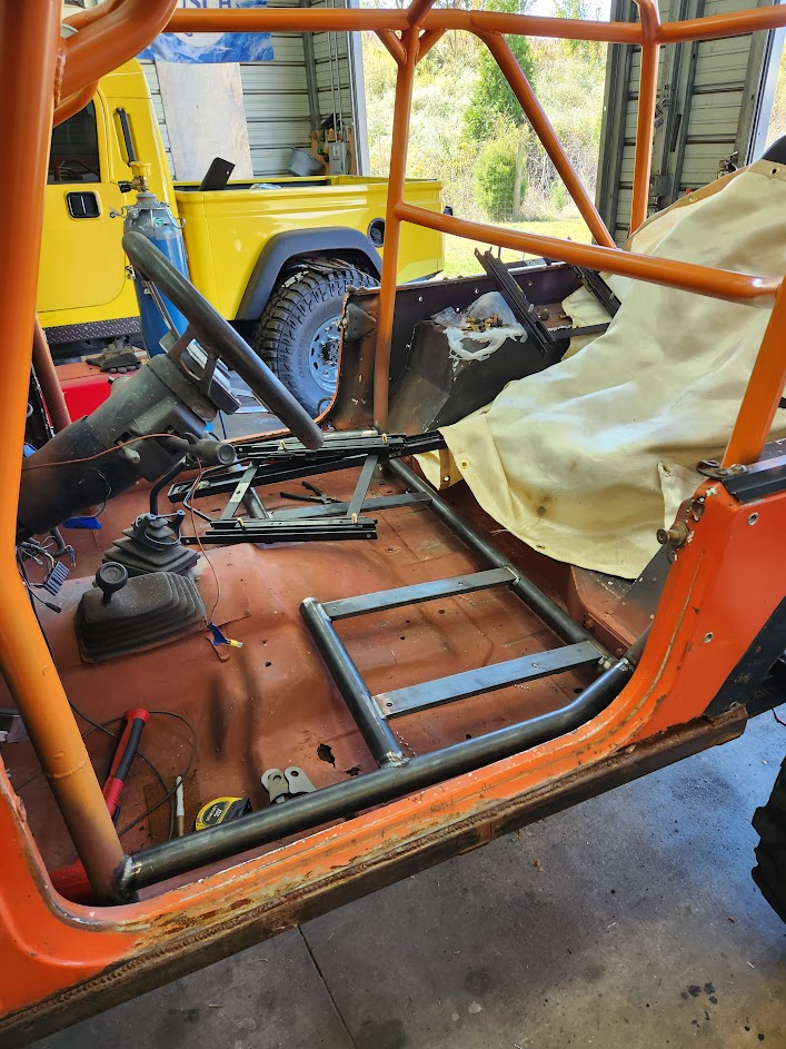

Small little update on my dads Jeep, should be making more progress on this thing finally.

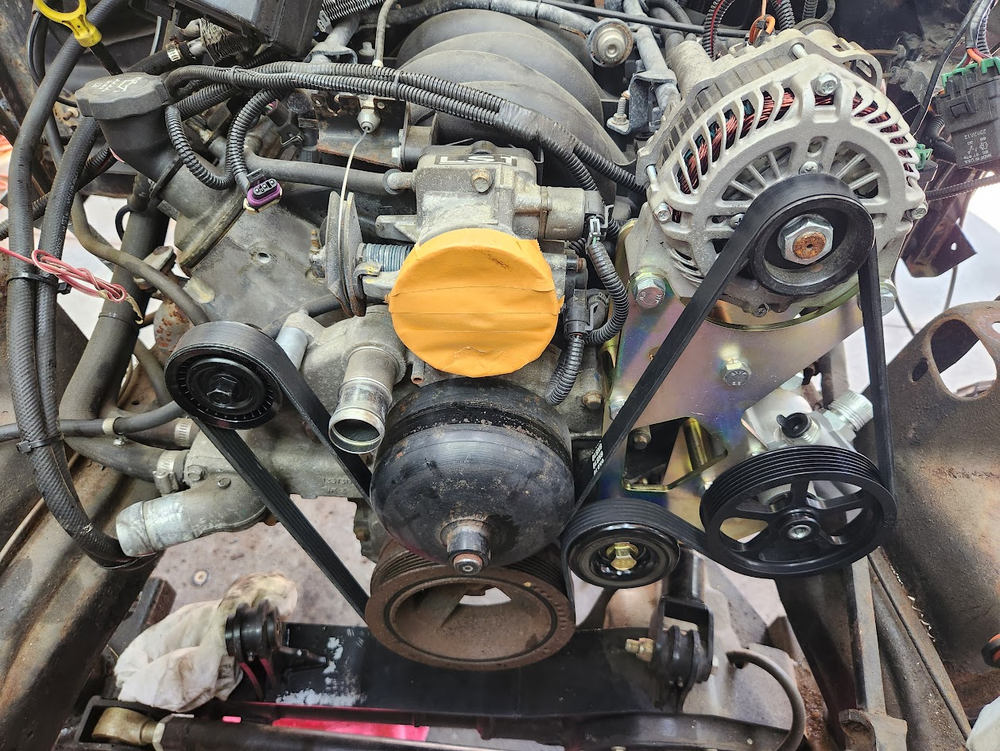

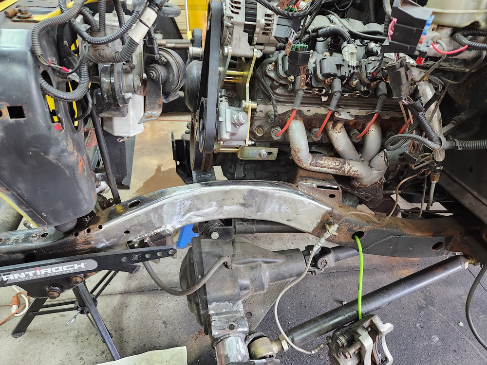

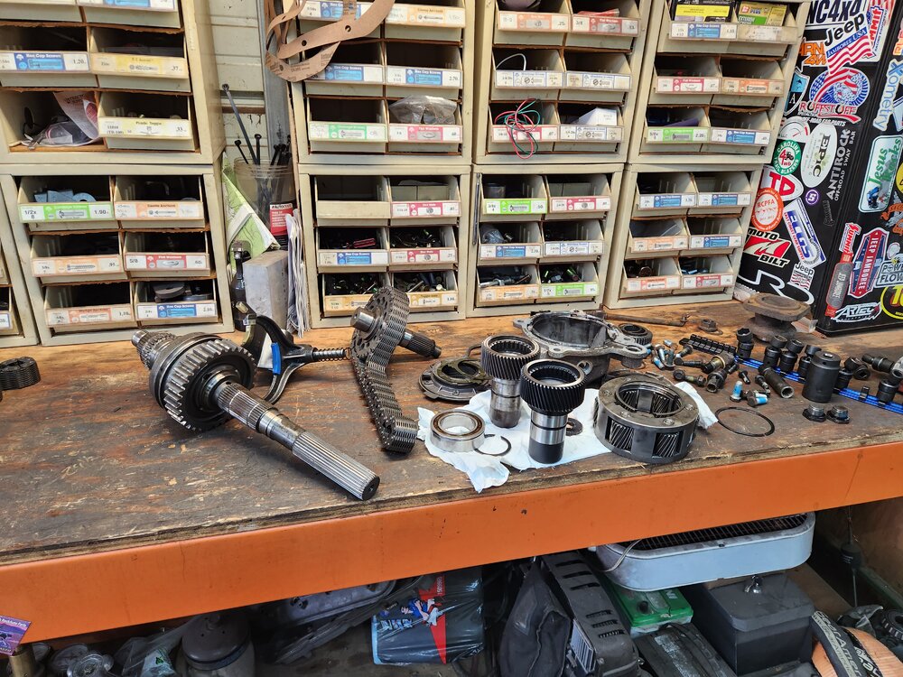

Some Brute updates. Got the 4L80 back today and should be getting the trans stabbed back in tomorrow assuming UPS comes through and delivers the torque converter.
I'll never enjoy working on rusty vehicles or cutting off TJ coil buckets.

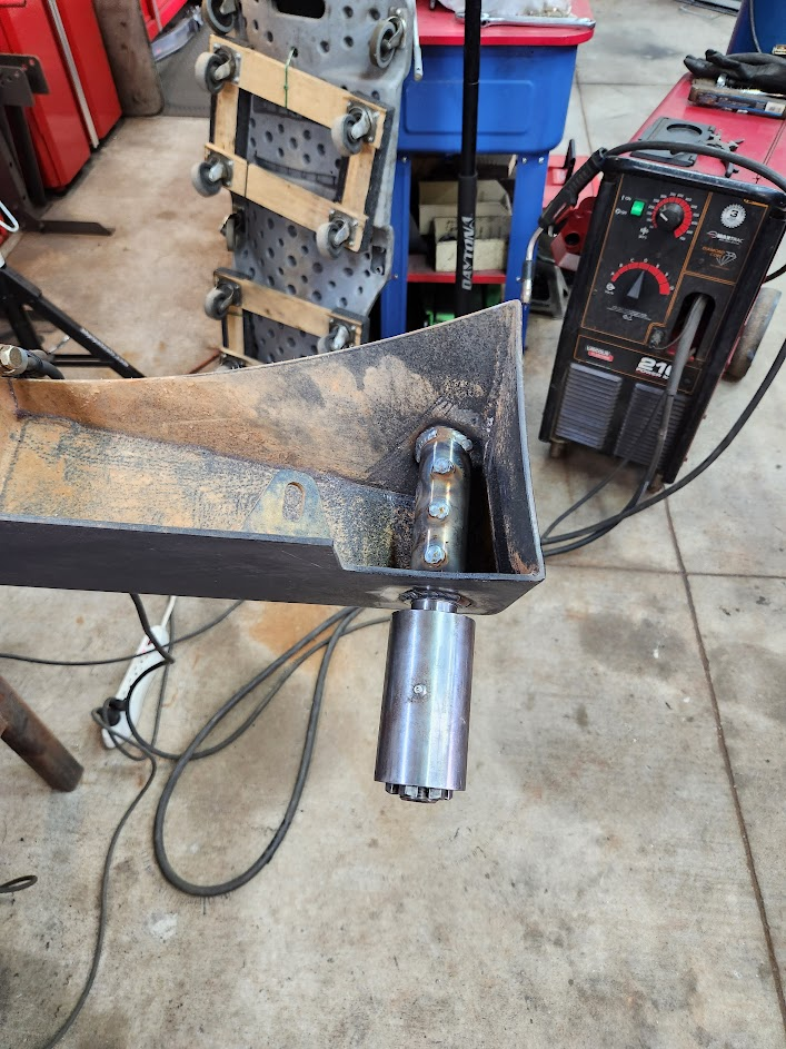

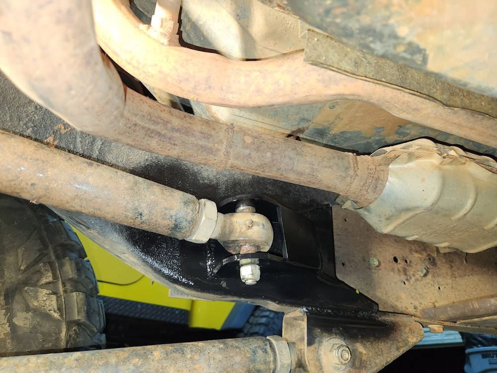

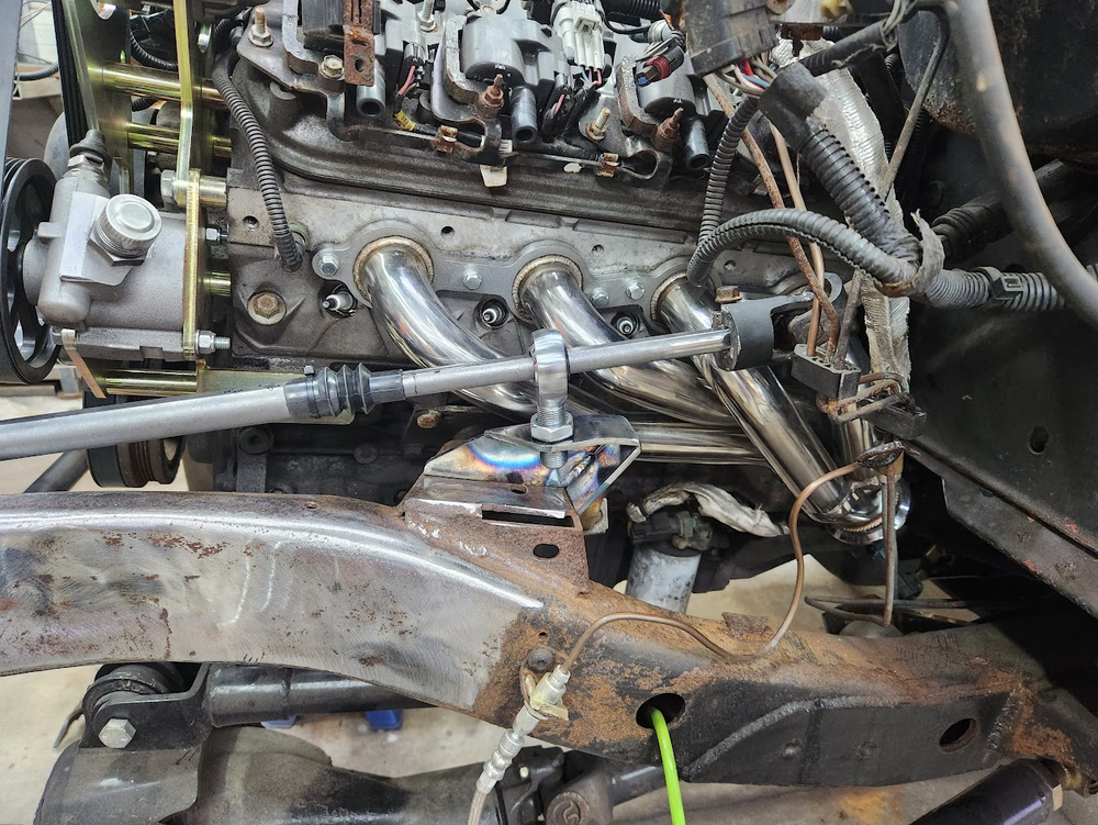

Cleaned up the truss ends, going to move the upper link over to the drivers side for a bit more driveshaft clearance and more room for the exhaust on the drivers side.

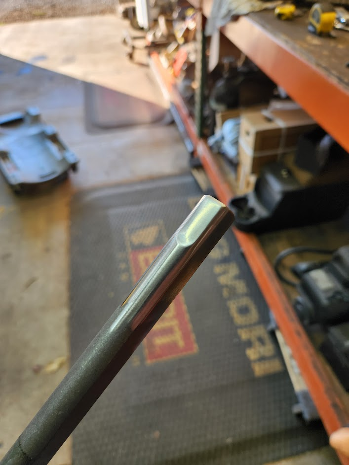

Just a touch of hand machining for the new steering shaft to fit the factory TJ stuff at the firewall.
Also re-did the support bearing as it was more than a bit worn out and janky. Also gonna try out these headers, pretty confident the passenger side will be easy to route, drivers side looks like it'll be a pain but possible.

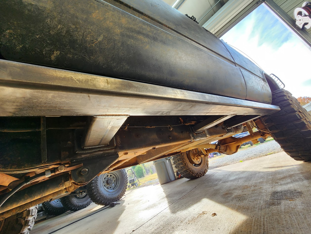

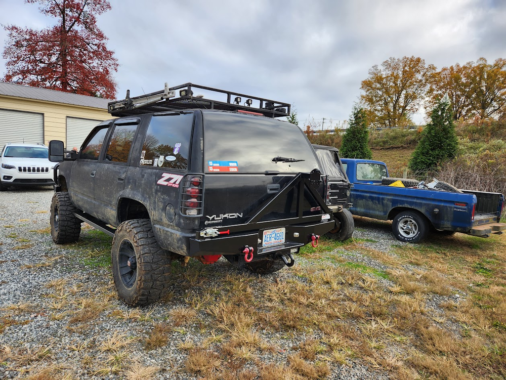

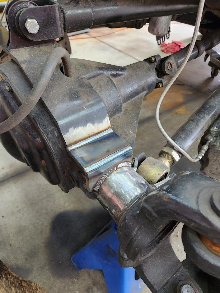

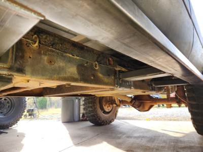

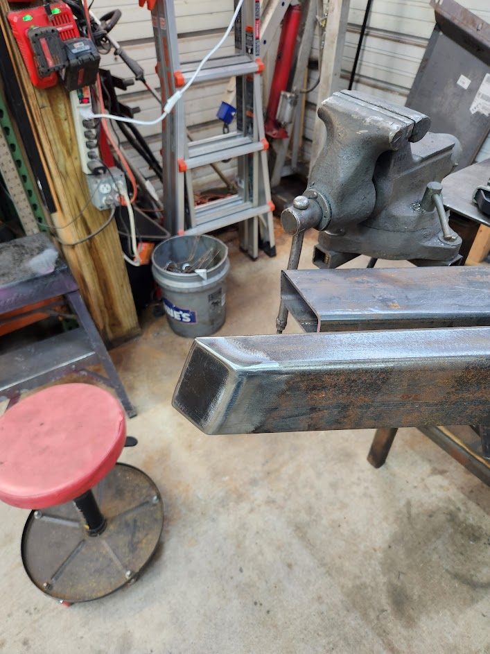

Did a bit of work on @DonYukon rig, built some sliders, tire carrier and cleaned up some brackets that were more than a bit janky.
Little bit of "cad" first for the end cuts.
Sliders welded on

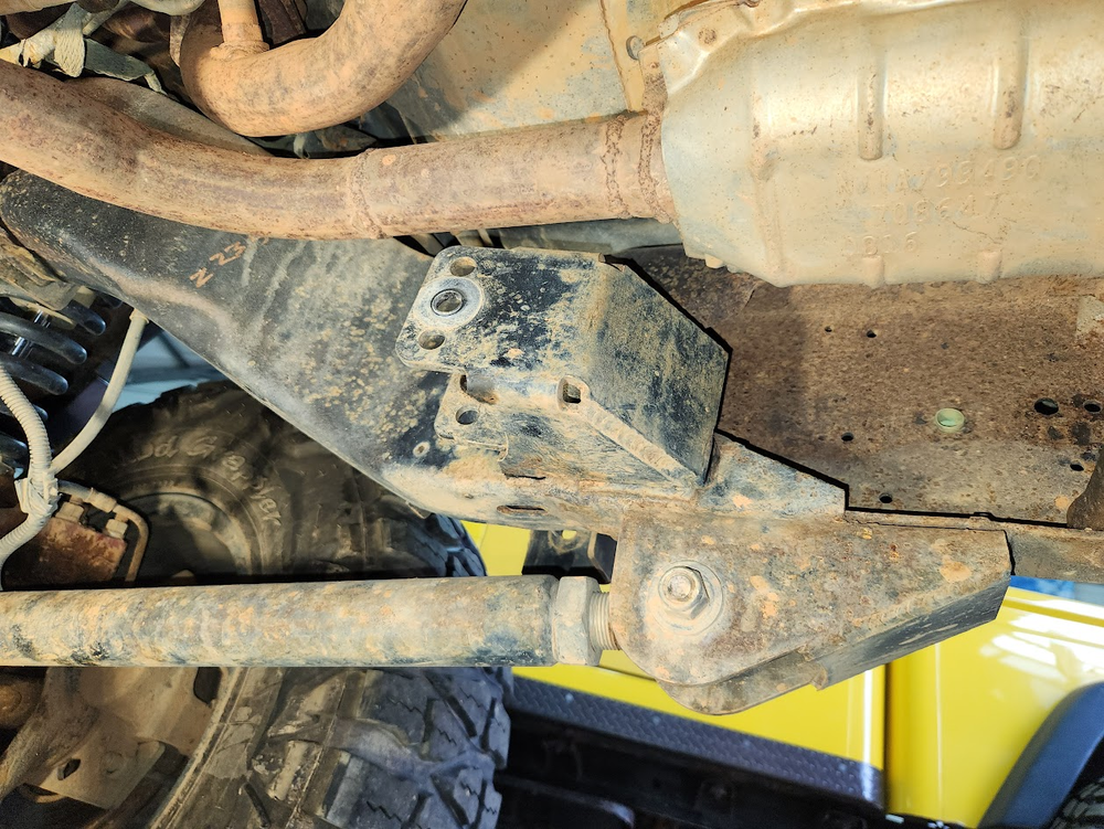

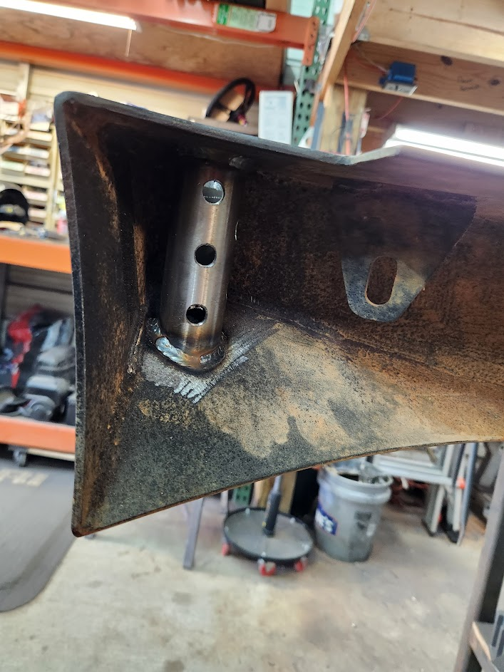

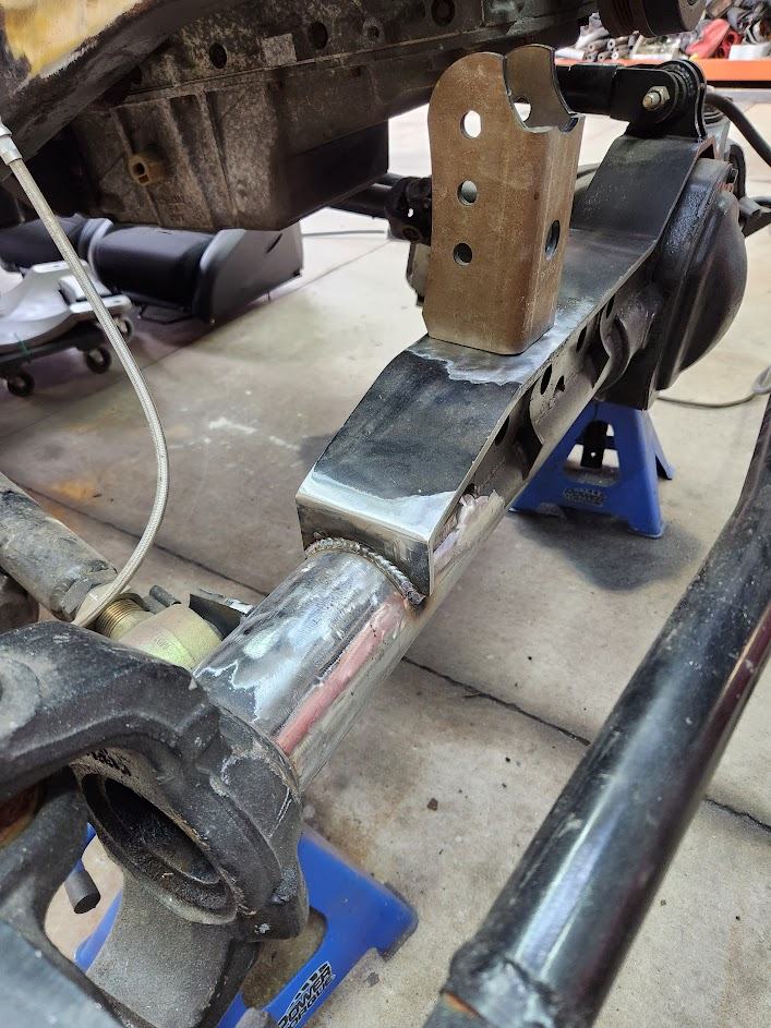

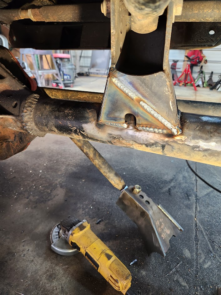

Upper link bracket before, pay close attention to the utter lack of weld that was holding this thing on.
And fixed, welded in a plate to fill the massive void then super glued a new bracket on.

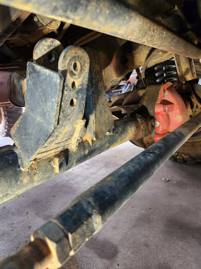

Just a look at the before on the track bar and upper link mount.
Upper link bracket was hanging off the tube quite a bit on both sides and looked like turd.

Tire carrier time
Touch of gusseting

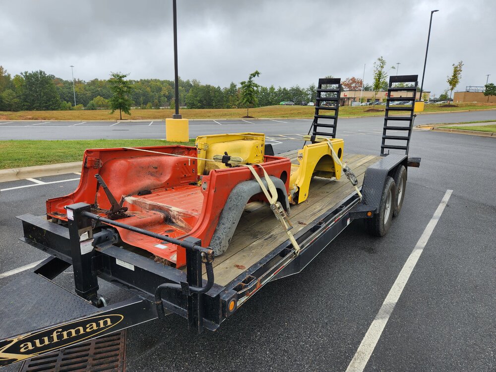

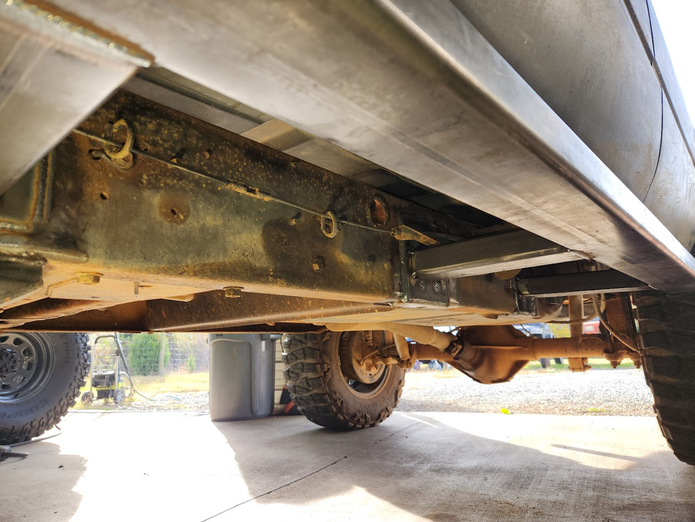

It's amazing how out of hand tear down gets sometimes. Shoutout to @rcalexander105 for helping me get that bed off considering it weighed about 8,000 lbs. Should have some more updates on this thing in the coming days.
