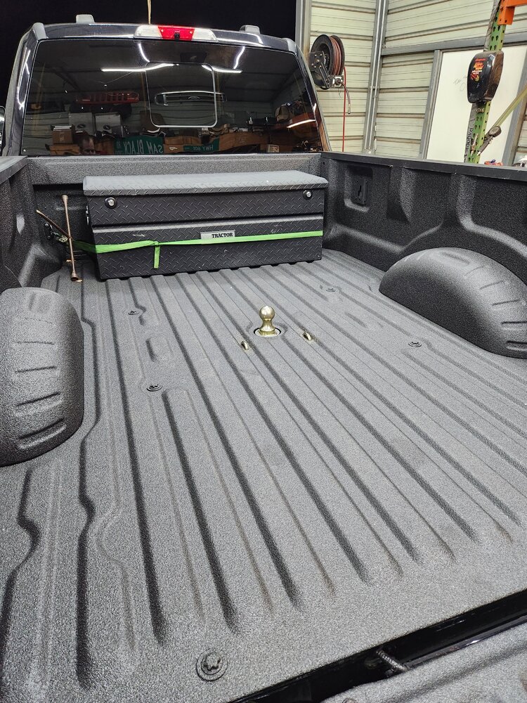

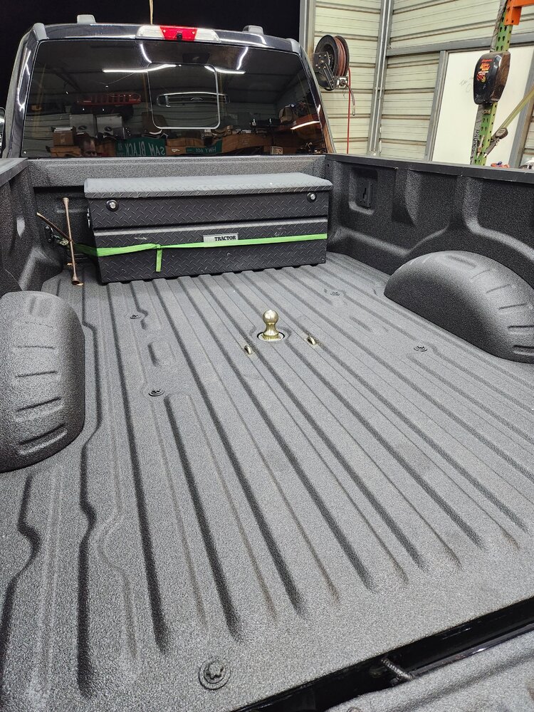

B&w Gooseneck install on a 21 F-350, crazy it didn't come with a factory hitch. 7 pin bed harness will be here tomorrow because if you put something in a cart it's not automatically ordered šŸ¤¦šŸ¼

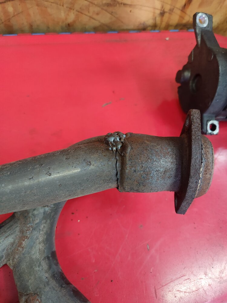

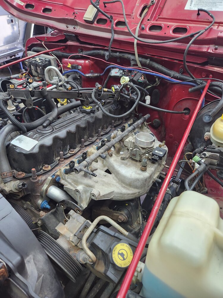

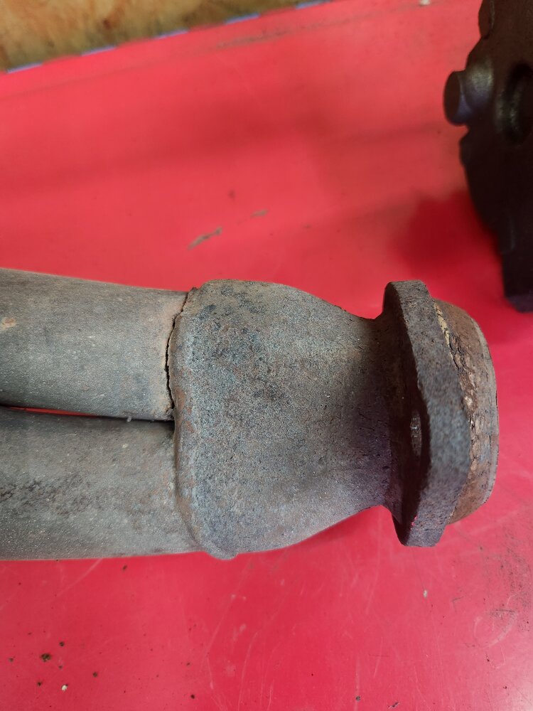

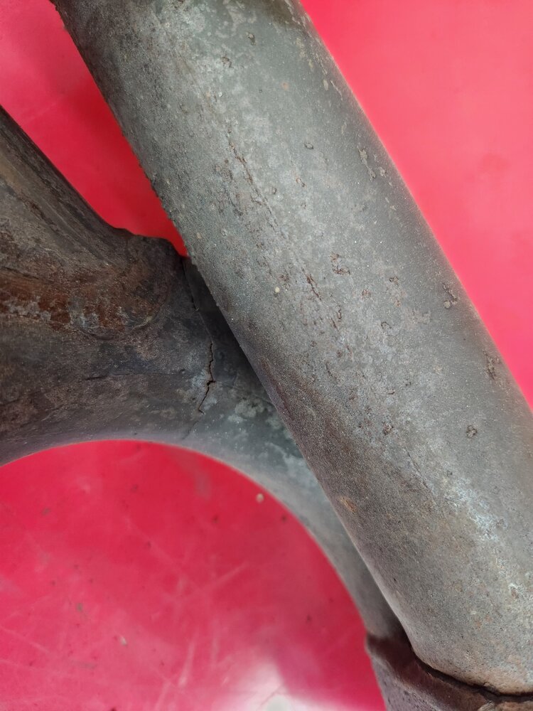

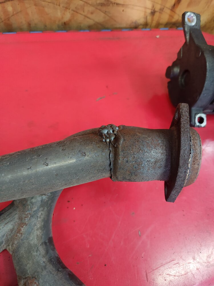

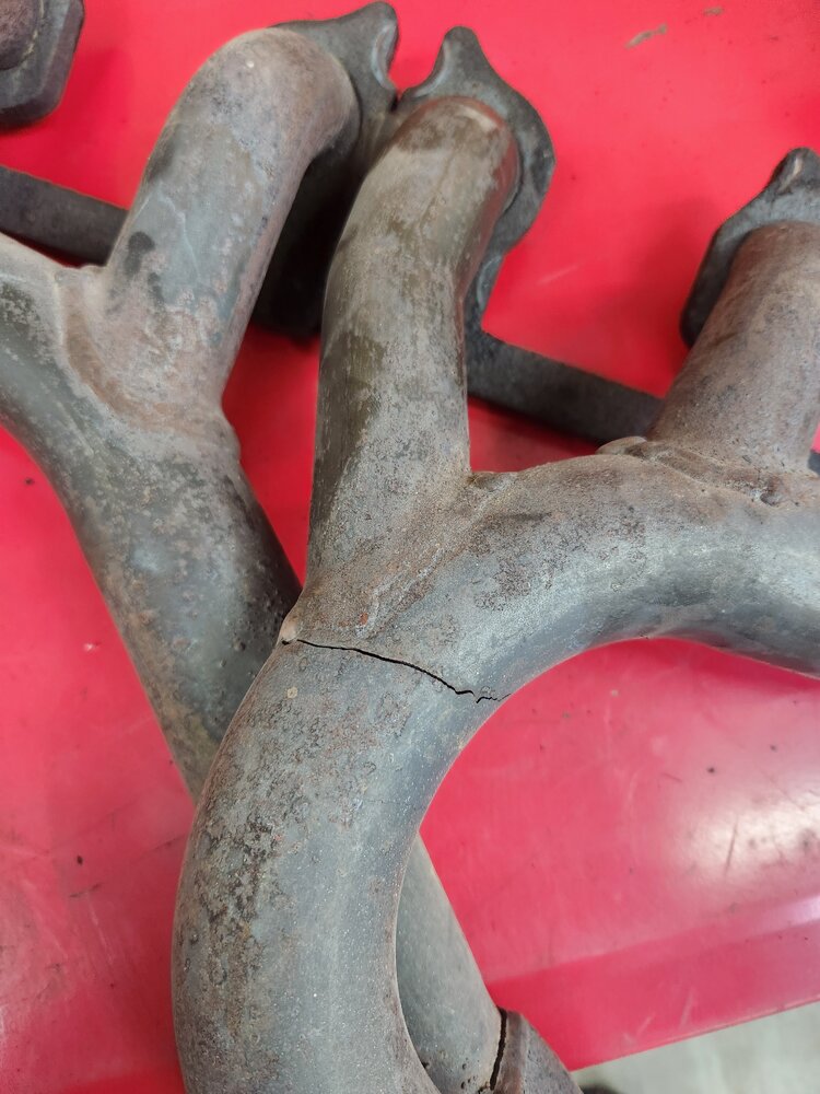

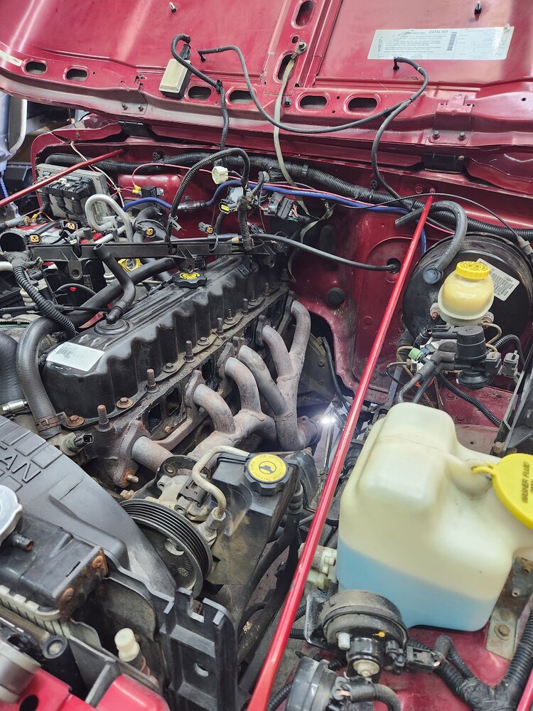

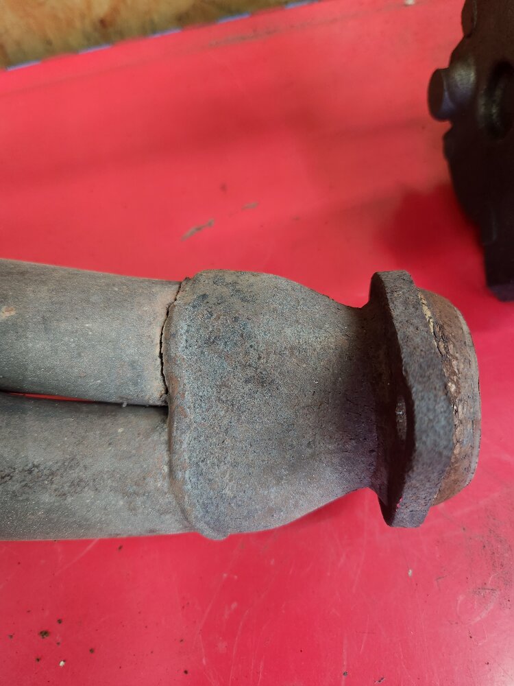

Did a header and fuel pump on a TJ this morning. Customer stated it had a slight exhaust leak and had a long start condition. Fuel pressure was 10psi while cranking and normal-ish after it finally started. Seen a few TJ pump start to bypass internally and cause the same issue.
"Exhaust leak" culprit, you can see where someone attempted a repair.

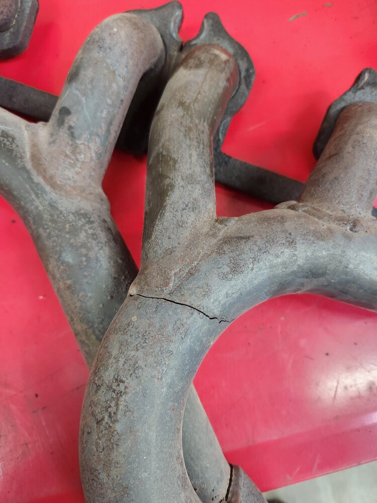

That hitch came out very nice
I kinda like the B&W over a factory Ford or Dodge hitch, if I'm being honest. Not sure how the factory Ford hitch balls engage, but the Dodge one is asinine and begging to get stuck in the hitch.
Haven't seen a GM one to be able to comment on them.

I really like my B&W in my Super Duty. I felt the same as you about the OEM GN stuff.

Funny this came up, @Chris_Keziah & I were talking about this today at the shop. The puck style hasn't given me problems, but I probably prefer the slide pin style of the aftermarket hitches vs the flip lever on top of the ball in my OEM setup. What we were scratching our heads the most was how a 1-ton dually didn't come with the hitch (or 7-pin in the bed) from the fac-tree on the Lariat trim šŸ¤”
But I guess for exactly what yall said, it can be ordered without... just thought it was strange

It sure is beefy! Very well built

Iā€™ve only seen one factory ford setup and didnā€™t like or trust it. Short of needing this done in a hurry, I prefer that we had to add one.

Itā€™s a very nice truck! It was strange working on something so clean underneath lol.

I need a price on that install because I dont have the balls to drill holes in my new truck bead....

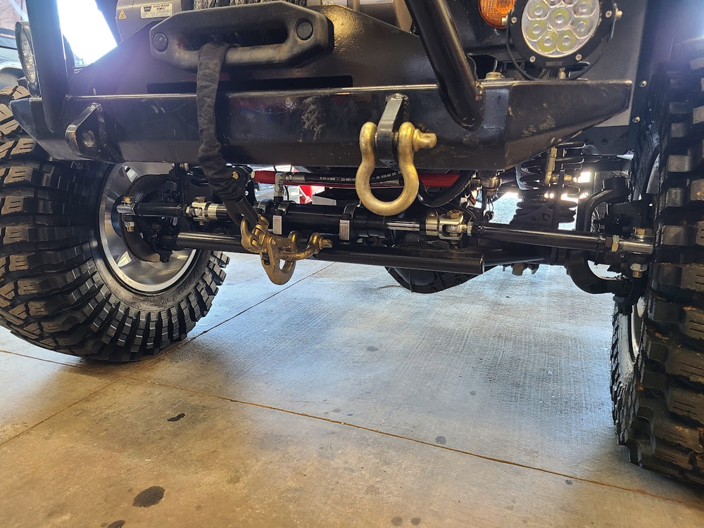

What length ram was used? Is the travel limited?
Killer work by the way. I like seeing the picture dump updates
It's an 8" limited down to ~6.5" crazy thing is the brake calipers are why you can't use any more. They end up getting into the inner c and push the piston back in.
