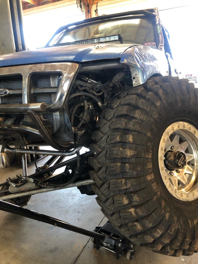

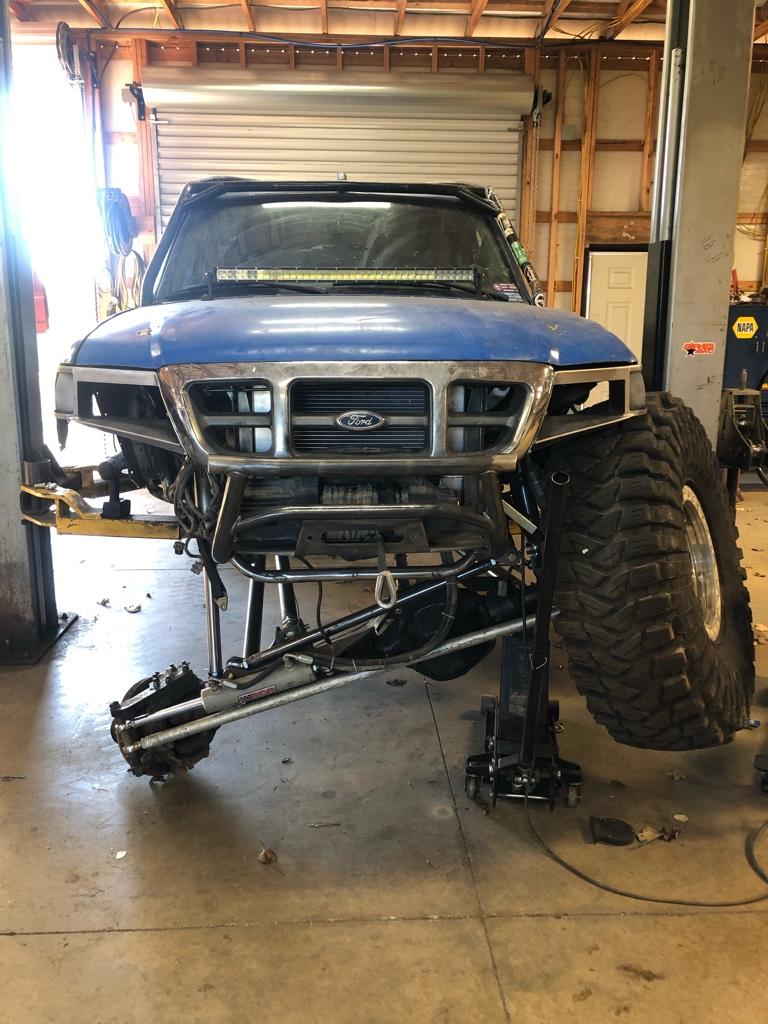

I wondered if it was the same one. I recall how nice it looked when you finished the first time. Hate to hear all the grief is caused you.A shop in concord hired me to build really nice suspension and axles for it 3 years ago. It’s coyote powered, ax15, d44 front with chromo’s arb and the best of everything. Rear 9” with billet third, arb 35 spline chromo’s etc. huge 14” wilwood brakes. Fox remote resi coil overs, rear Currie anti-rock. Front hellwig EB sway bar.
Basically it’s a money is no object build. The interior is immaculate, the body is immaculate, the frame is immaculate etc. it’s nice.
It’s back here at my shop because long story short in the 3 years it took the other shop to do the rest of the build lots of things on it changed including changing from large fender openings in the rear (what I set up ride height around) now it’s got the short skirted fenders in the back and has to sit a couple inches higher than it should. In doing so it drives terrible, the links are short because of space constraints in the front and they’re steeper than they should be. In an effort to try and get it to drive better I built new longer lowers and new frame mounts. It has been an absolute nightmare that I can’t get away from. This build has caused me more stress than any other build in my 12 years of business and now I’m having to eat thousands of dollars of work to try and make it right for the customer.
bummer to hear its back again.Yep. It’s definitely been a pain. To add to that the owner lives in Washington state. When it leaves here to go to its home it HAS to be right. It sucks. It’s somewhat my fault so it’s gotta be done.

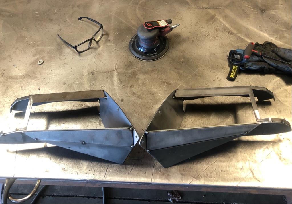

You're just showing off at this point

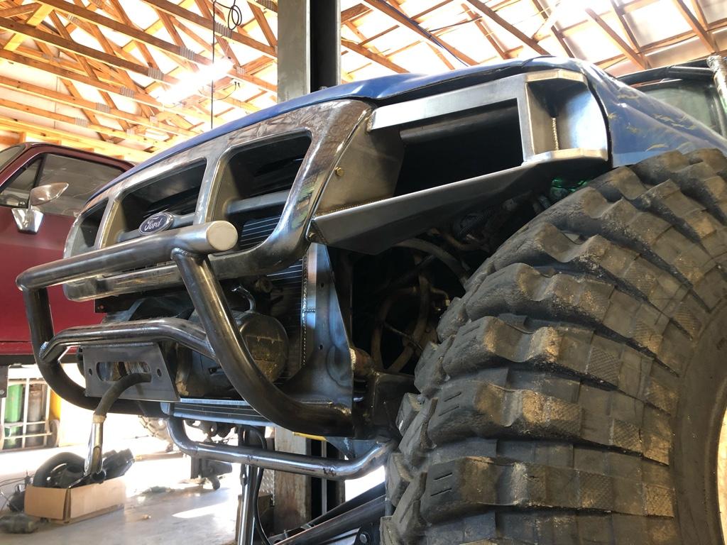

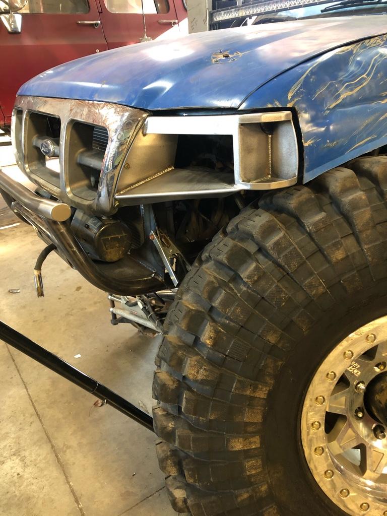

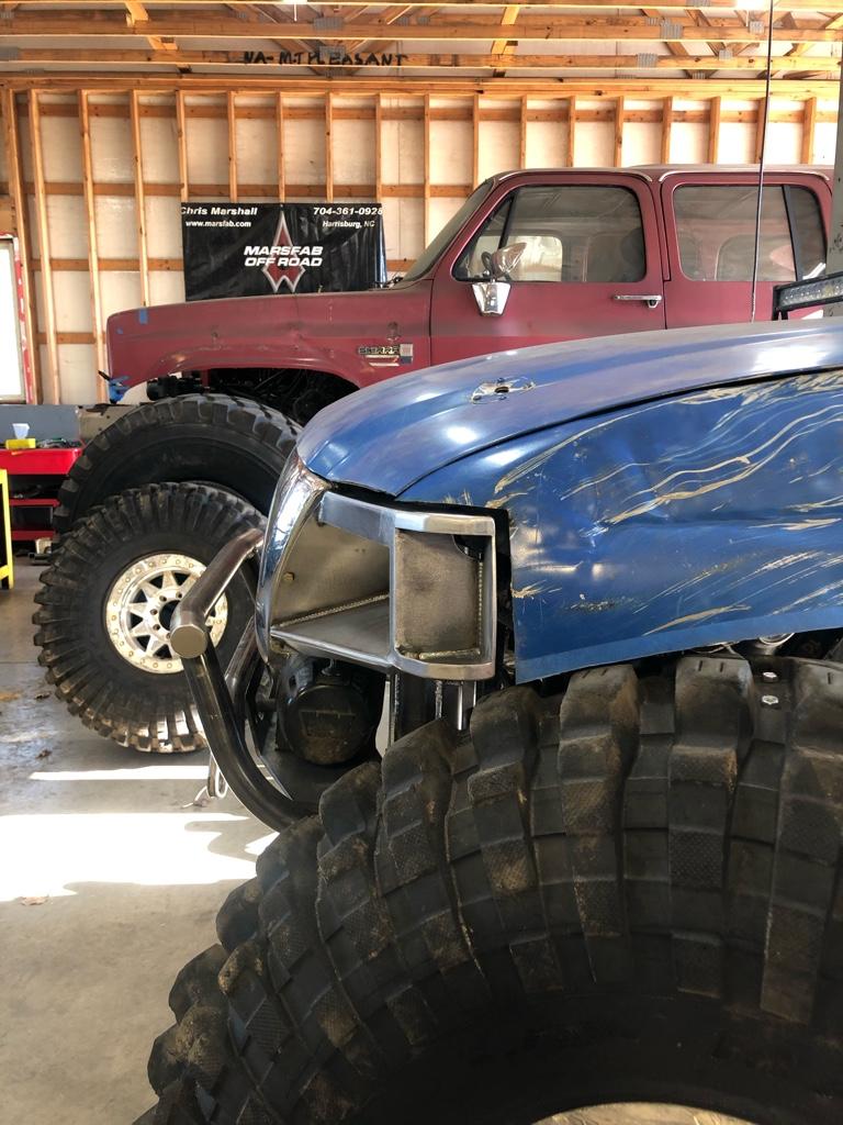

That looks better than the original idea! That is looking awesome.
