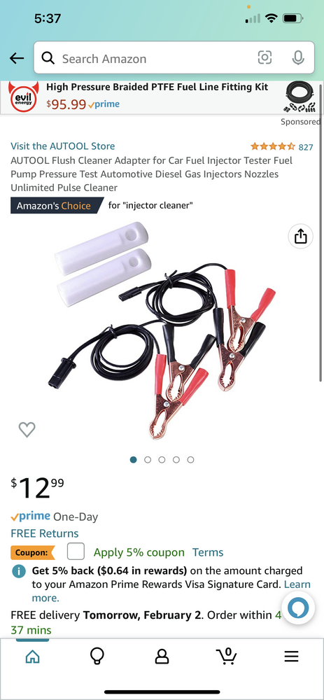

Just about ready to toss in a set of 30# injectors I have on the shelf. Wondering if the ones in the rail got clogged up while it sat?
I mean, at this point, it's gonna be something funky.
Order an injector cleaner off Amazon, basically a plunger that goes onto some carb clean and alligator clips to a 12v source. I always clean out any that have sat. Works well. Can back flush if it’s clogged.
Decent chance especially since you mentioned the fuel lines being hard. ethanol gas sitting that long has done it before. Finger crossed for ya.
