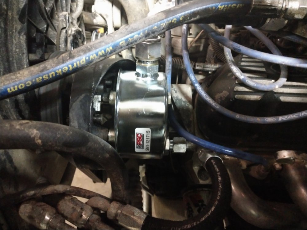

Been a pretty solid year of wheeling so far. No complaints and no issue aside from a noisy power steering pump. On my last outing, my PS pump would whine under load. Plenty of assist, just noisy.
I bought a new one (PSC P pump) and sent the old one back for a check over/rebuild. PSC emailed me a tracking number and sent me back a rebuilt pump for free. I couldn't believe it! At least I have a spare now.

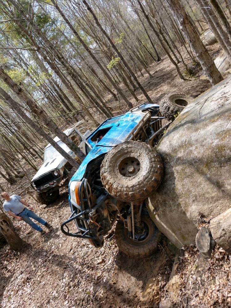

looking at your front bumper, I am planning to do something similar. But with your clevis mounts mounted where they are, do they stop your approach, or get bent at all? would you mount them elsewhere?
They make a compound that does that now for dirt track tires...
Yes...This! LOL! Hence the term..."soaked tires"!:D
Also... there are several compounds made for Asphalt racing tires. Not quite as aggressive as the dirt compounds. Been around for ever!
Example; Toluene was always popular to soften asphalt tires.;)
Have you looked at my rig? Dents and bent steel don't worry me!
I like them where they are. They have never hindered my approach or anything like that. Besides, they are like 1" thick.
right, same here, but bending a clevis hole makes it useless for the clevis....no? but good to know that sticking down doesnt seem to matter!

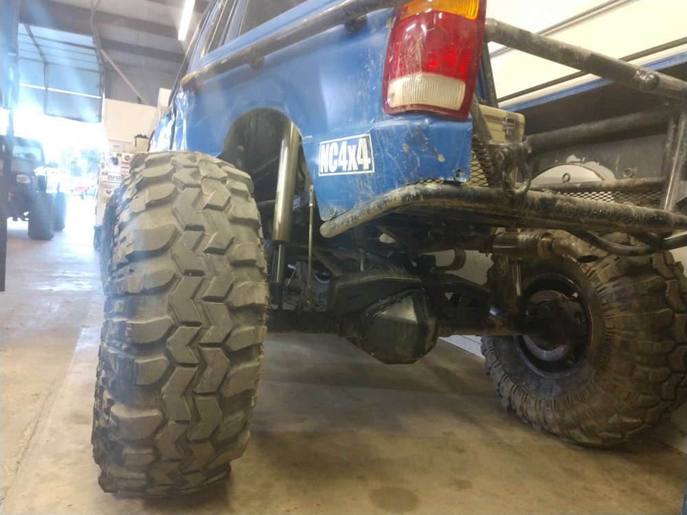

I also recently swapped my 43 Sticky SX on Racelines for 42" sticky Treps on Dirty Life wheels. Dirty Life is trying to spread the word about how cool their wheels are and partnered with a local wheel distributor to have me showcase their toughness and good looks. Much like @McCracken, handsome and strong. @Stuntman Autoworks is always making excuses why my rig does so much better than his, so I decided the best way to show my driving superiority to run the same tires he does. Maybe that'll shut him up. Unlikely, but I'm hopeful. :flipoff2:

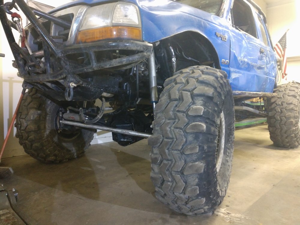

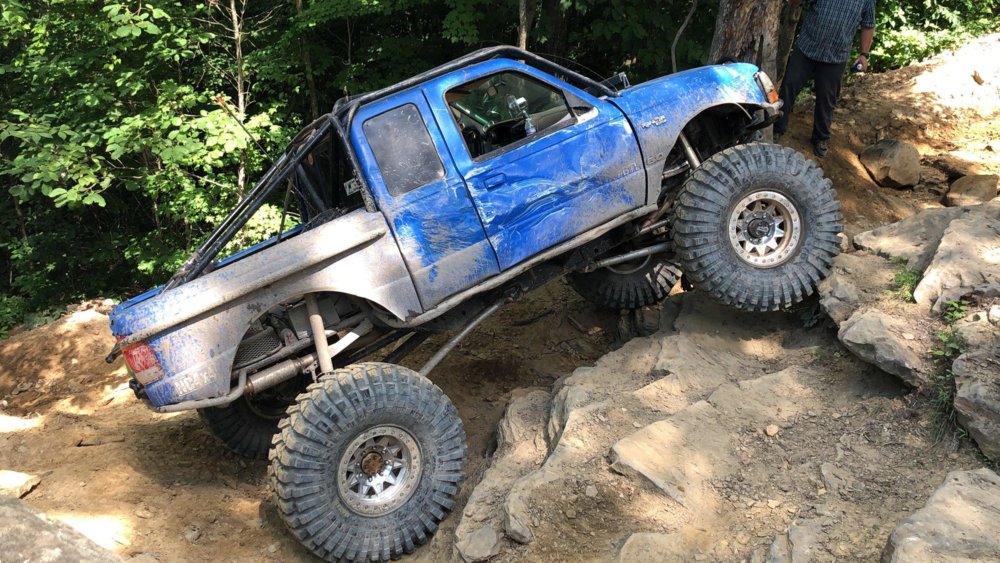

A few months have passed and I'm still beating on the truck relentlessly. I recently sold the 43s and went back with an old flame, sticky Treps. But this time in the 42" flavor. Had them on the truck for a few trips to the Flats and last weekend, Harlan. They performed great and I couldn't be happier.

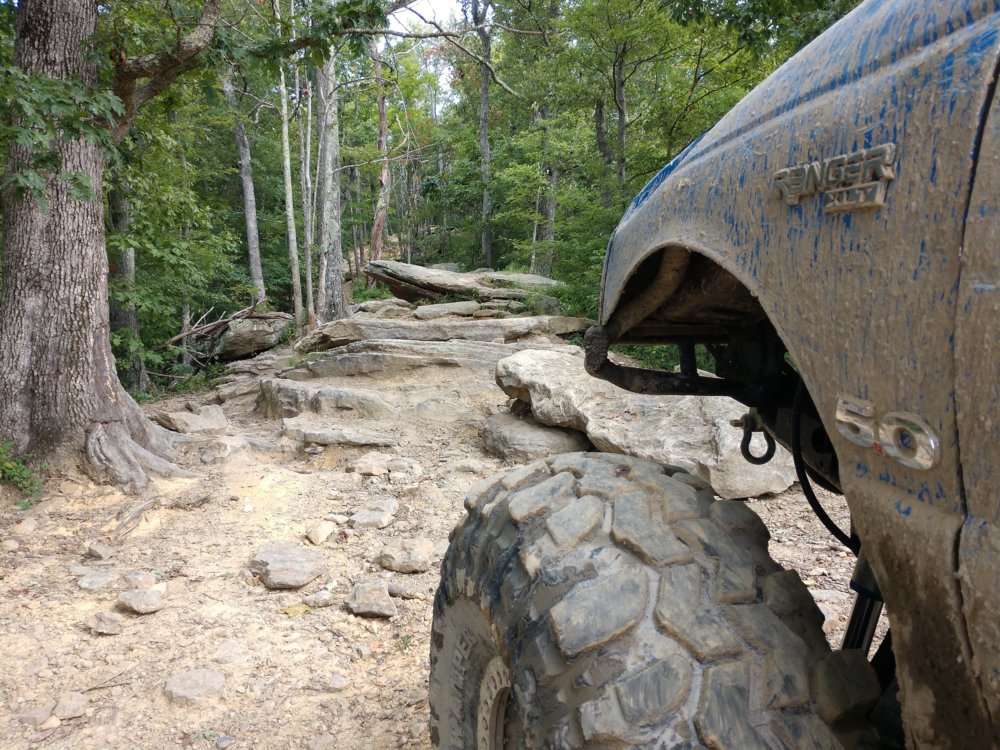

Truck kicked butt all weekend and even though the pic doesn't show, the winch is still spooled the same as it was 3 months ago. The Ranger flat out works!
However, changes are a brewing and needed.
Yesterday, my wife nagged me for the 3rd time about the smell of gasoline while we were wheeling. My cell vent is in the bed and when bouncing on a hot day, the fumes can creep into the cab. But this was a stronger aroma. I shut it off after going up Your Turn a ways and found my fuel rail was cracked and spraying gasoline near the alternator and distributor. Holy crap.
I limped it back to the trailer with multiple extinguishers at the ready but luckily, none were needed.
My plan is to swap another OEM rail on and while it's apart, going to install all new ethanol friendly hose front to back as a precautionary measure, The rail split from fatigue I'm sure but this is a great time to correct any future leaks from occuring. I also have a 24 gallon bladder cell that will be going in so I have more weight down and back.
