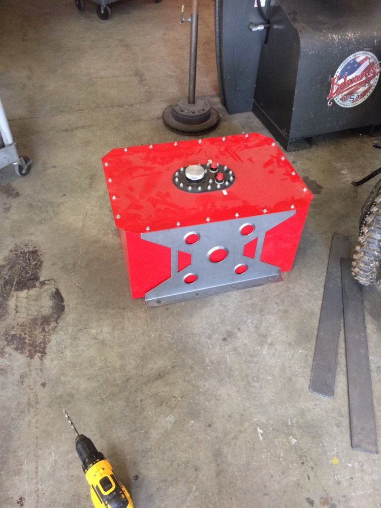

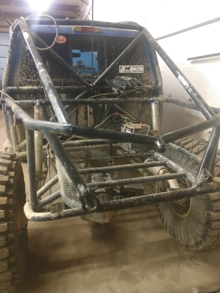

Started cutting up the rear cargo area last night. The plan is to install a much larger bladder style cell to get more weight behind the axle and also to give me more fuel reserve on weekends.
My old cell was a 15 gallon aluminum and I would go through around 10 gallons in a full day. It was also located forward of the rear axle. This combined with poor weight distribution, made steep downhill decents somewhat unnerving. With the cell in the rear most portion of the chassis, that will allow me to make specific mounts for my Action Packer, tool box and cooler where the cell once mounted.
Going to drop off the cell at Ujoint Offroad this afternoon so they can cut some custom mounts on their plasma table.
Hopefully I will start on the toolbox and storage fabrication tomorrow ahead of the brackets coming back from UJOR.
