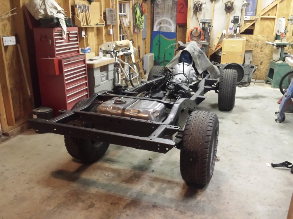

It is an 81 CJ8 Scrambler, I am the third owner. It has the 258 6-cyl and an automatic transmission, 4x4, etc. The chassis has been redone, painted, etc. Has a SOA done and the longer H-shackles. Driveline has been tilted back a bit, etc. I need to install a new upper cowl section and some rocker patches but other than that it is good to go.

So here it is as it sits. I am going to be bringing it to the shop early next week. I do have the rest of the parts too, they are sitting in storage.

But that frame etc looks pretty nice. How much of it do you have?
I have every bit of it. Down to the last bolt which are all in bags and labeled. Even have the hardtop and rollbar. The seats are actually pretty nice too, but I don't think I am going to use them because I am probably going to change the color around on it.

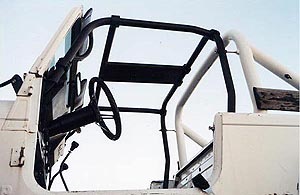

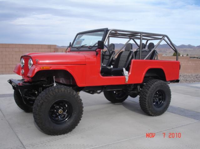

So here is what I am going for with the cage. I just need to find someone local to build it for me. I'm tempted to try it myself, but the risk of me screwing it up and killing my timeline and losing my battle is not worth it. :lol:
are you wanting to be able to reuse the factory half-top? If so that cage wont work. You would need to go with a full top/bikini. If going with a full top, i suggest waiting until you get it to make sure the cage fits inside, but most builders could likely achieve that without the top.

I probably won't be using the factory half-top. I plan on installing a full-top on it, I will be ordering that next week hopefully. If I tried to retain the factory half-top I would probably make it work and then never use it and hate myself for doing it. :lol:
I thought about doing a full fabbed cage, but I really like how reusing the factory bar kind of retains the period correct look of the Jeep.
OK, so I think I am changing my cage idea a little bit. My wife and one of my best friends didn't like the cage idea, and don't think I need a third row seat. They are probably right. My wife had an idea for it and I think she is right. Just don't tell her I said that. :lol:

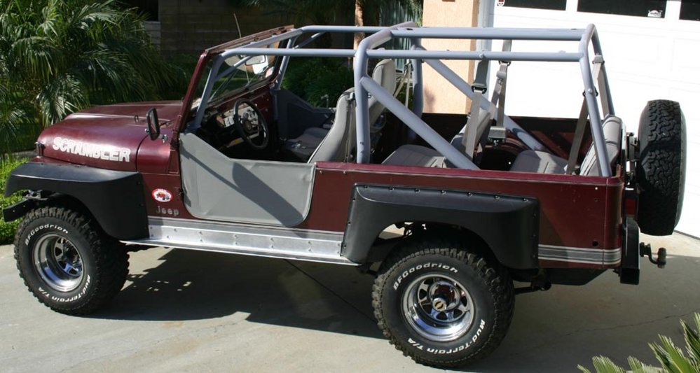

I found this picture and this is pretty much the same lift and color I am going with. I think I am going to take the factory cage and slide it back about 2' to be over the rear seat. The build off the front into a cage over the front seats.
I like that idea much better myself.
has the amc 20 rear already been converted to 1 piece shafts or swapped out? If not, id suggest doing that and welding/truss the center to the tubes. They have been known to twist.

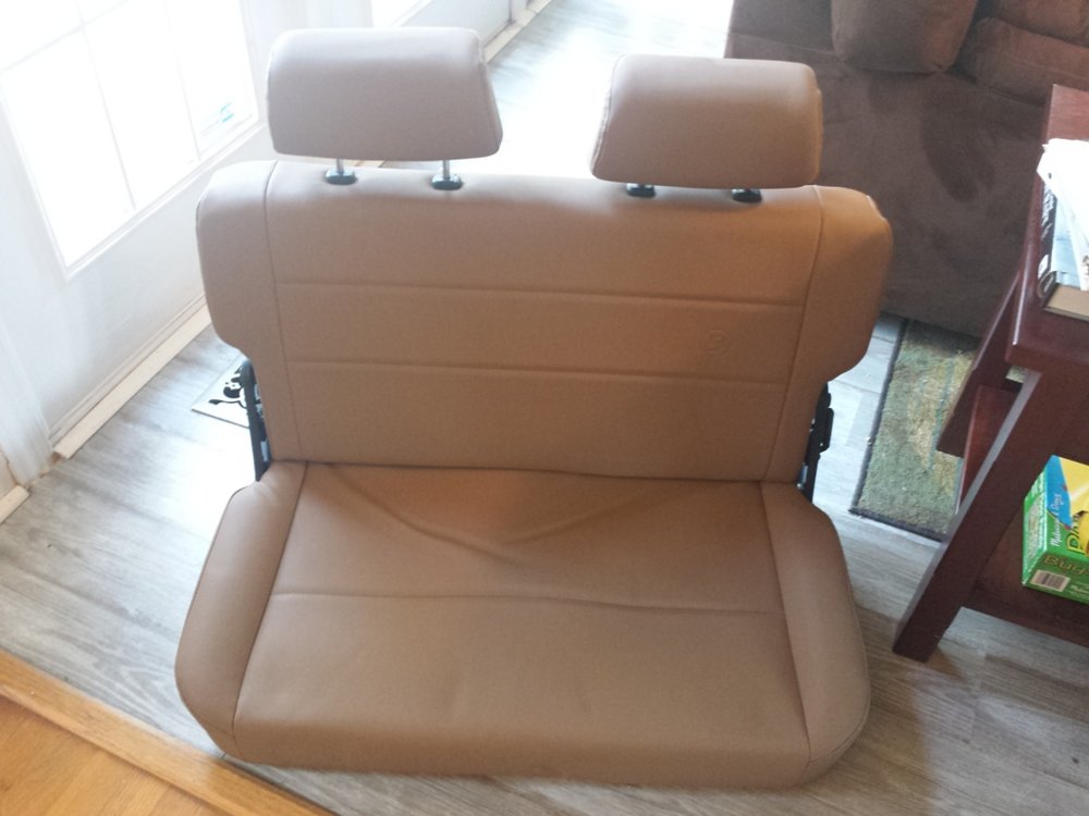

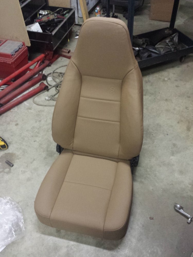

Just ordered my seats. I want to have them so we can be sure they work with the cage and also match my interior liner color to them. I ordered Bestop TrailMax II seats in the Spice color, got the reclining fronts and the flip and fold rear.

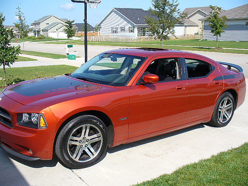

I have a color picked out, my wife suggested it and I like her idea. While I mostly work on Jeeps now I am a diehard Pontiac guy at heart and also have a built 98 Trans Am. Ours is red, but my wife suggested we go with a color off of the Fbodies.
Sunset Orange Metallic. This is going to be the color.
Got some new parts in. Here is the front seat, I am pretty happy with it.

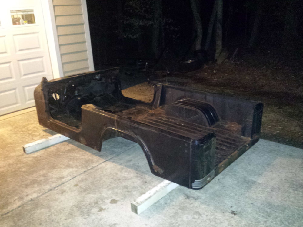

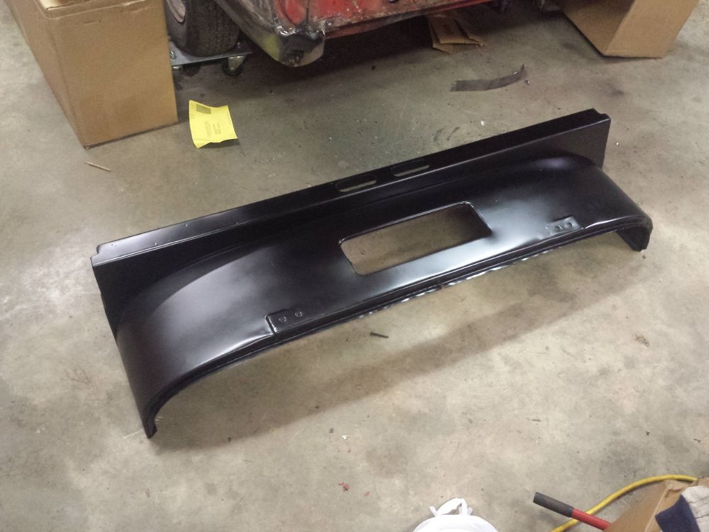

And also got a new Omix cowl panel. I am not that impressed with the quality of this panel. The metal is extremely thick but doesn't seem nearly as well put together as most aftermarket panels I have used. It looks like it is going to need a TON of work to make it look straight with paint on it. I may just pirate a YJ tub I have here for the right patches I need.

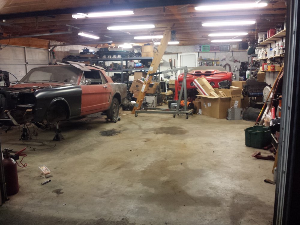

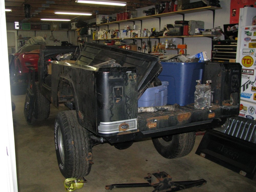

Cleaned out the shop and moved some stuff around to get ready for the Scrambler. I can not WAIT till this summer when we move into a bigger shop.
Of course, the Mustang is going to a new home soon and the TA is going up to the garage in the house, but still, more is better, right?

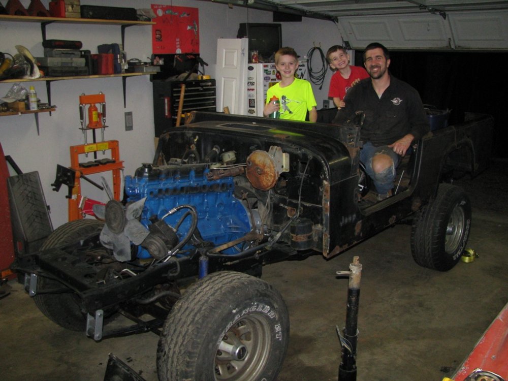

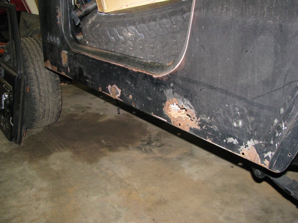

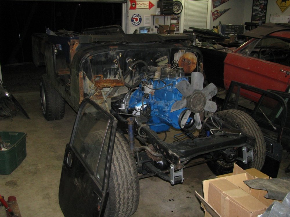

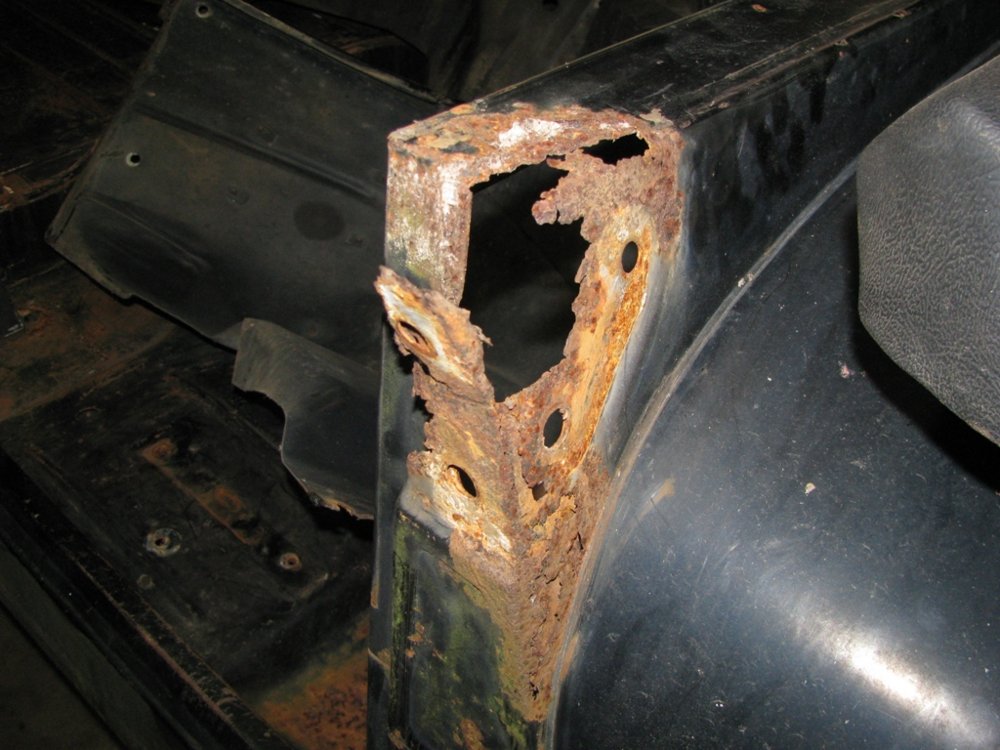

Finally got it in the shop. I am very surprised at how straight the body of this thing is. The floorpans are perfect, the fenders are perfect, and there are only a few rust holes. The worst rust is right at the windshield hinges. I literally have every single piece to this Jeep, it is just a matter of getting the body straight and then cleaning up the parts and installing them. Hope to start the rust repair next week, don't think it will take that long. Then the paint and liner begins!
And my boys love it!
