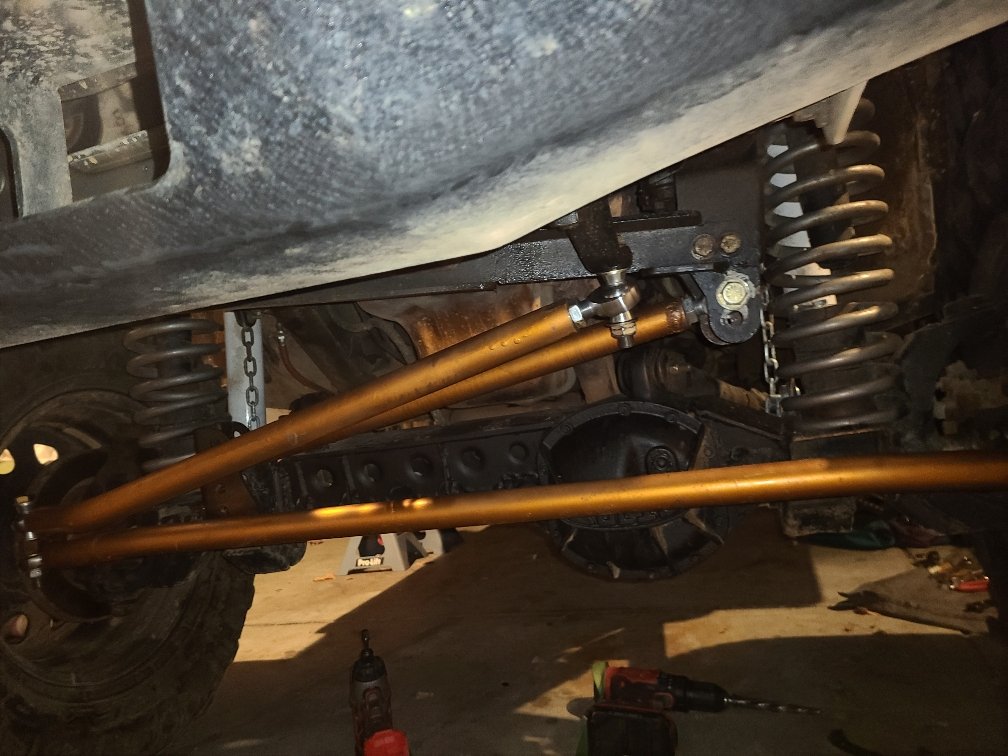

Go look at how @adamk did his, basic just welded in a crossmember just aft of the tcase. The Barnes kit is cheaper, and I can sell you the tube you need.
Okay, ill see if i can find a picture of his. The barnes is out of stock I'm also thinking about going with the TMR one it is very similar to the barnes.
Sent from my SM-G981U using Tapatalk
my old build thread should have pictures of it all. I made the crossmember 3 pieces so the center could be dropped if the trans or TC needed to be pulled.
Send them a message, have had that before where it showed put of stock when they really had it.

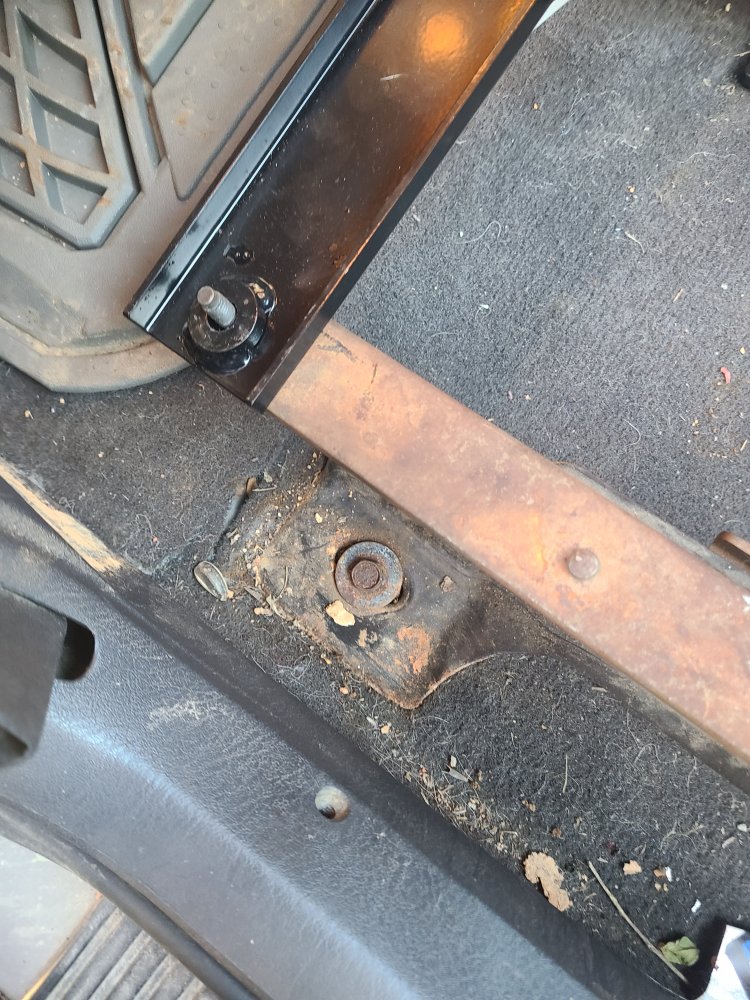

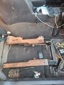

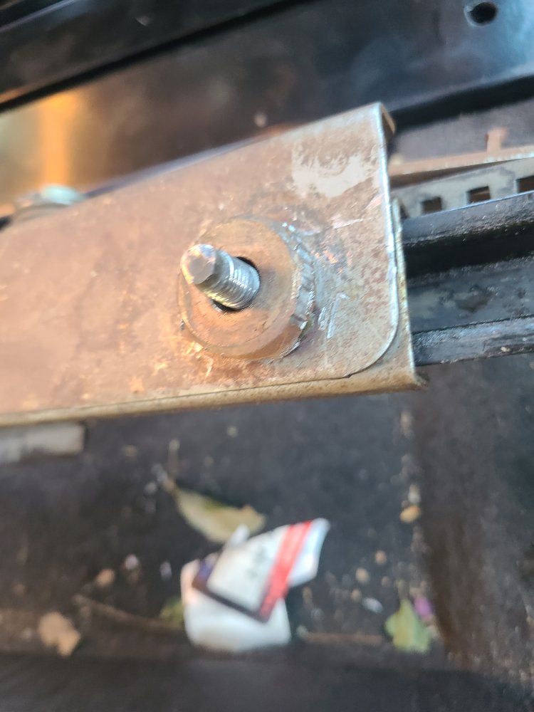

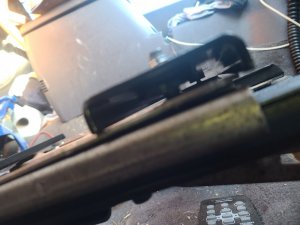

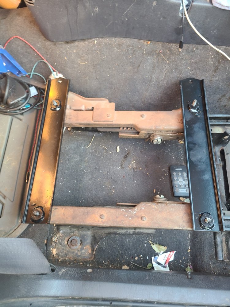

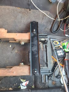

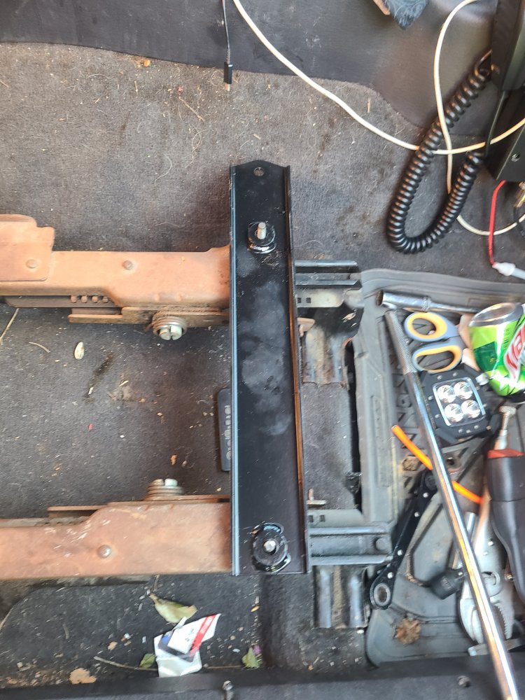

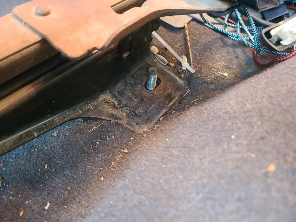

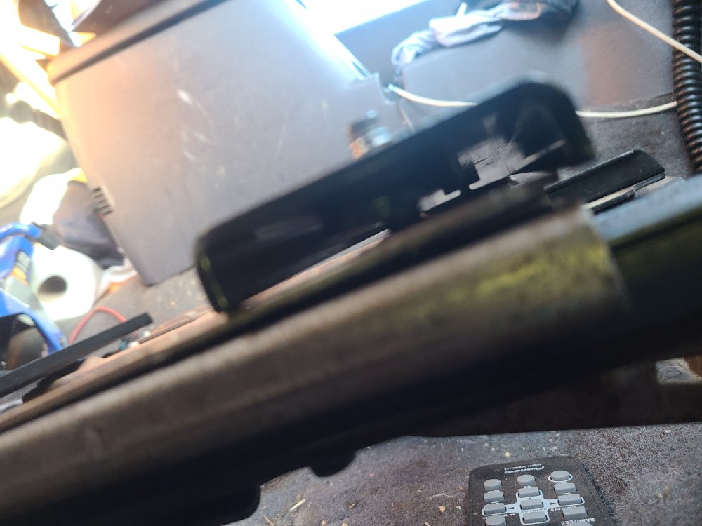

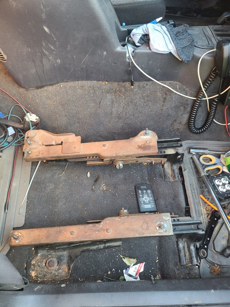

I got the brackets in today. I went head pulled the passenger seat out just to see how the adapter brackets worked since they didn't come with instructions. When I called mastercraft they said they don't have instructions for them. In order for the brackets to work you have to remove the thick welded washers from the slide. You have to do this inorder to actually have threads showing on the pressed in studs.
I got the brackets set in and the slide loosend up since im going to use two of its mounting locations for my harnesses.
I'm going to drill out the hole for one of the bolts in the back so I can use an actual bolt and nut through the floor instead of the stamped and threaded nut thing it currently has. Then use the stud on the other side. Im debating a tab or just bolt hole on the front cross bracket for the submarine belt.
I'm hoping once the seats get here I will be able to easily tell which way these go on once the seats get here.

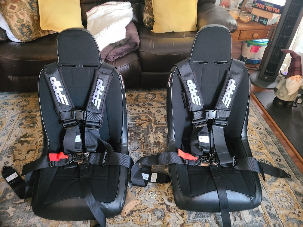

Seats came in today along with the harnesses. Only down side to the seats is im not going to be able to use any of the harness slots except for the anti submarine slot. I also hope they soften up after some use. Hopefully i will get them mounted up tomorrow afternoon or Saturday. They will definitely be in before the veterans day event at ure.

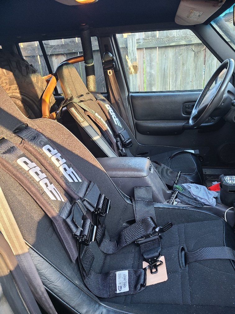

I officially have the seats and harnesses in. I end up just drilling a hole in the seat bracket for the anti submarine strap. I need to put some more padding on my b pillar since it is so close to my head.

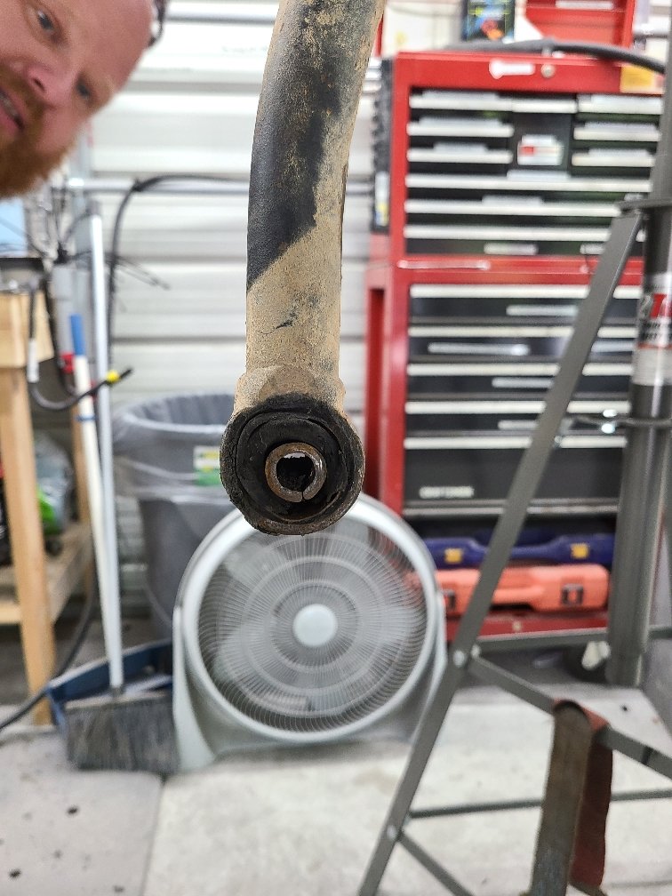

Well I have managed to trash another trackbar bushing. This time it was a poly bushing. Instead of just replacing bushing and hoping it lasts lo get than a few trips. Ive decide to just build a new track bar with heim joints.

I want to clarify why I trashed it. There is no doubt that it is beefy. It got trashed because my track bar bracket on the axel side was toasted. It lasted over 2 years with daily driving and light abuse. When I went to an over the axel track bar we modified it to make it shorter and use a poly bushing.

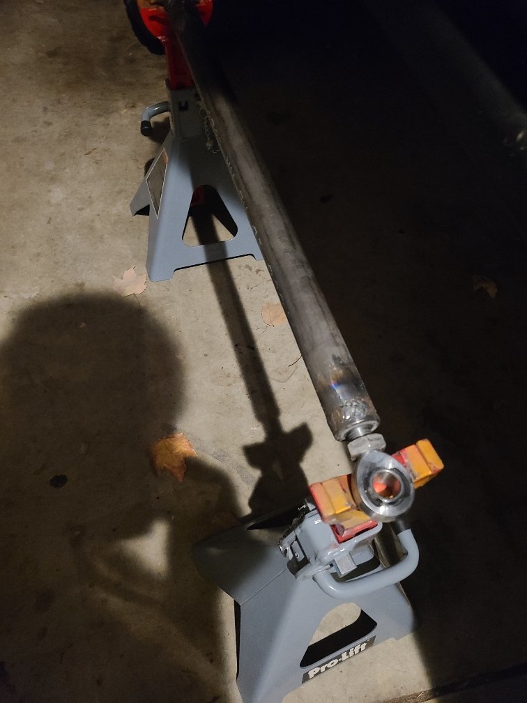

Got my new track bar burned together. Going to paint it up tomorrow and get it thrown in on Wednesday.
