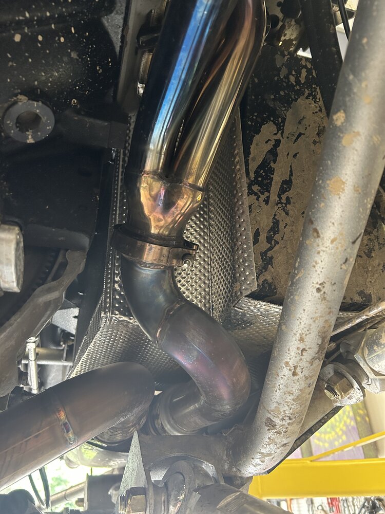

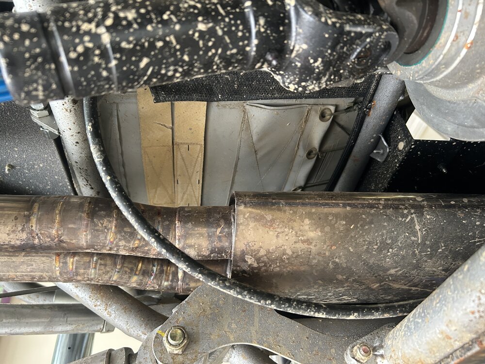

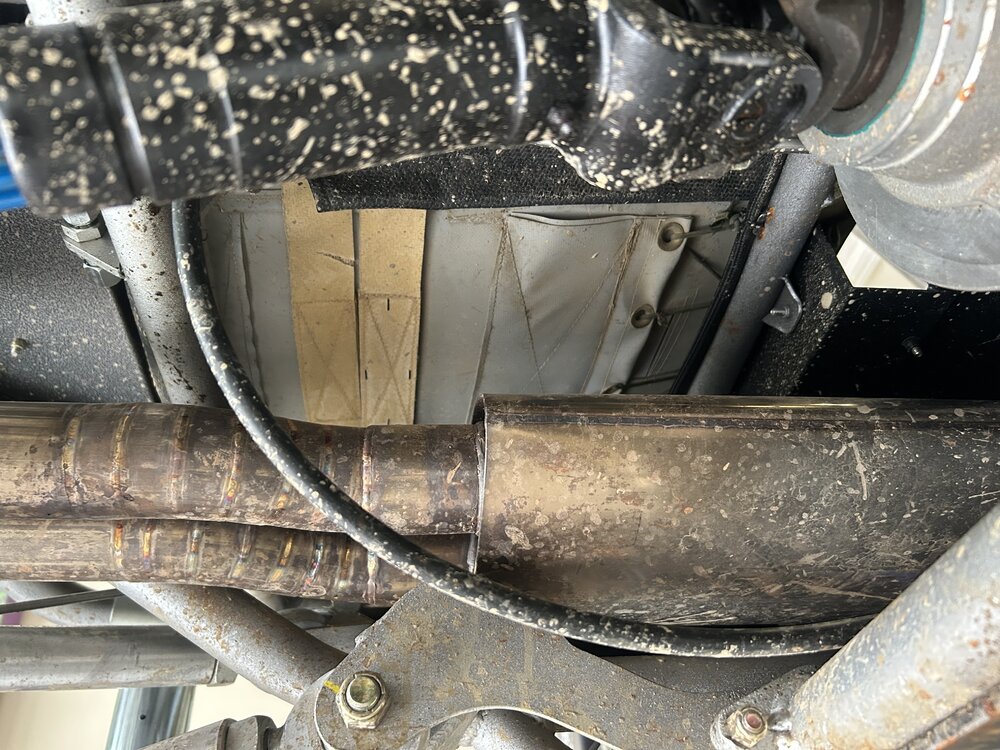

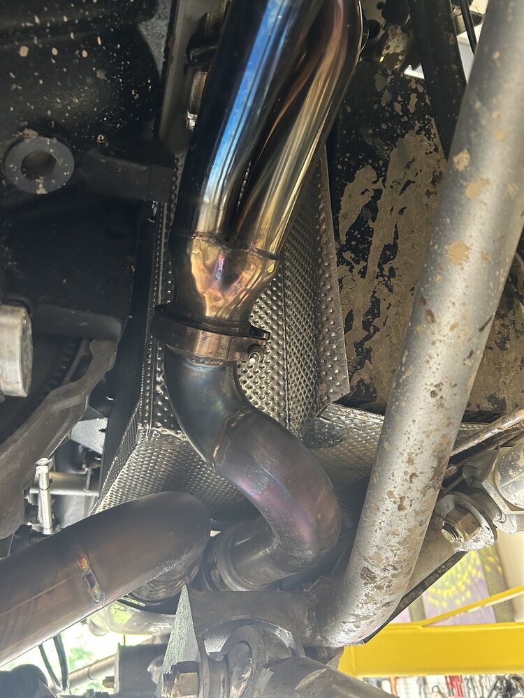

Does that stuff attach to the bottom of your floor or do you make a bracket for it and let it "float" in the air gap between the muffler and the floor?
Little bit of hot seat going on in the buggy and I realized that I never properly answered your question. Better late than never. Here’s a picture of what Matt did with that giant sheet of DEI material I bought.
Custom bent with an air gap and riveted to my floor pan. Footwell has not gotten hot a single time. The underside of my seat however is staying warm like I left the butt warmer on. I originally thought there was enough air gap to not notice. I was wrong!
So hopefully this is the answer. I ordered one of these shields from Flowmaster. Should provide the air gap and if it’s still too warm, I’ll be ordering that same stuff you got to then wrap around the muffler and shield. Here’s what I ordered:

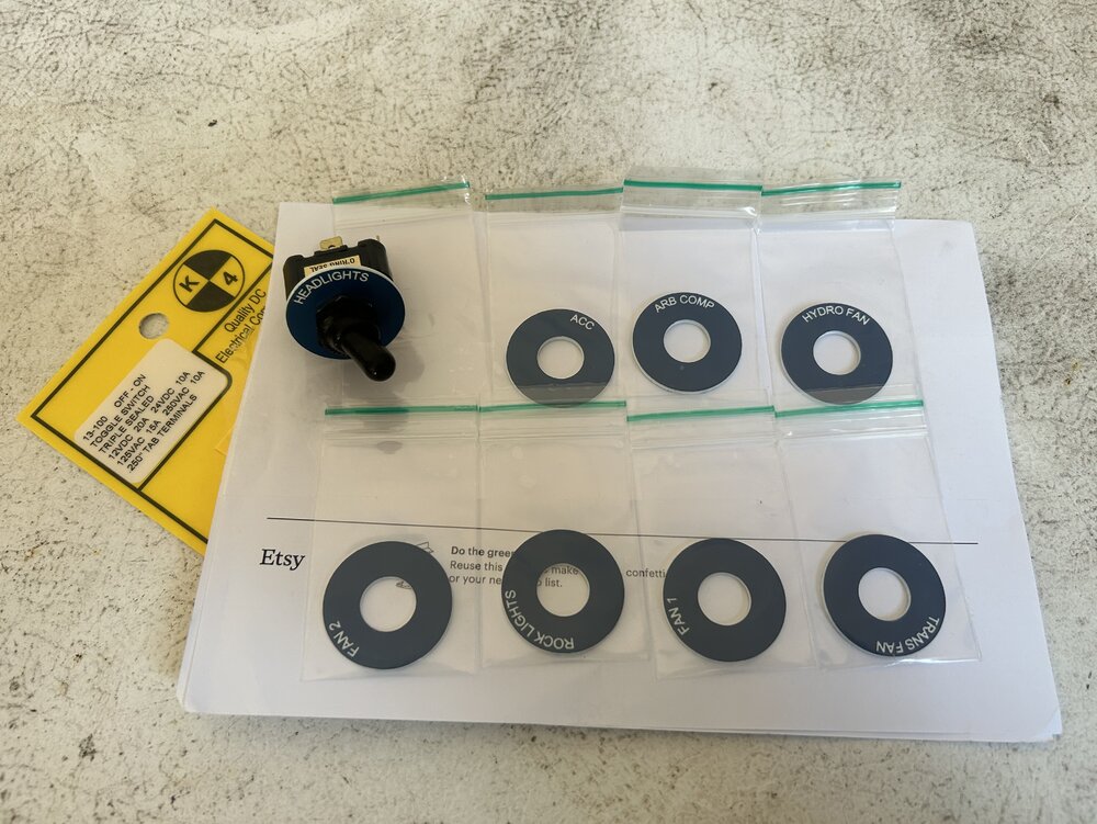

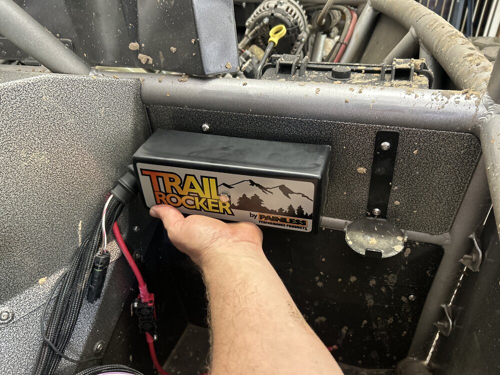

Painless Trail Rocker gives me 8 circuits with old fashioned relays and fuses. I’ve got some sealed toggle switches coming and some fancy labels from Etsy.

Haven’t made any calls. I was somewhat apprehensive to use it at first, but a buddy talked me into it. Even then, I refused to use it as my ignition or start circuits. The Painless setup is not near as compact as the SwitchPro, but at least there’s something there for me to diagnose and repair.

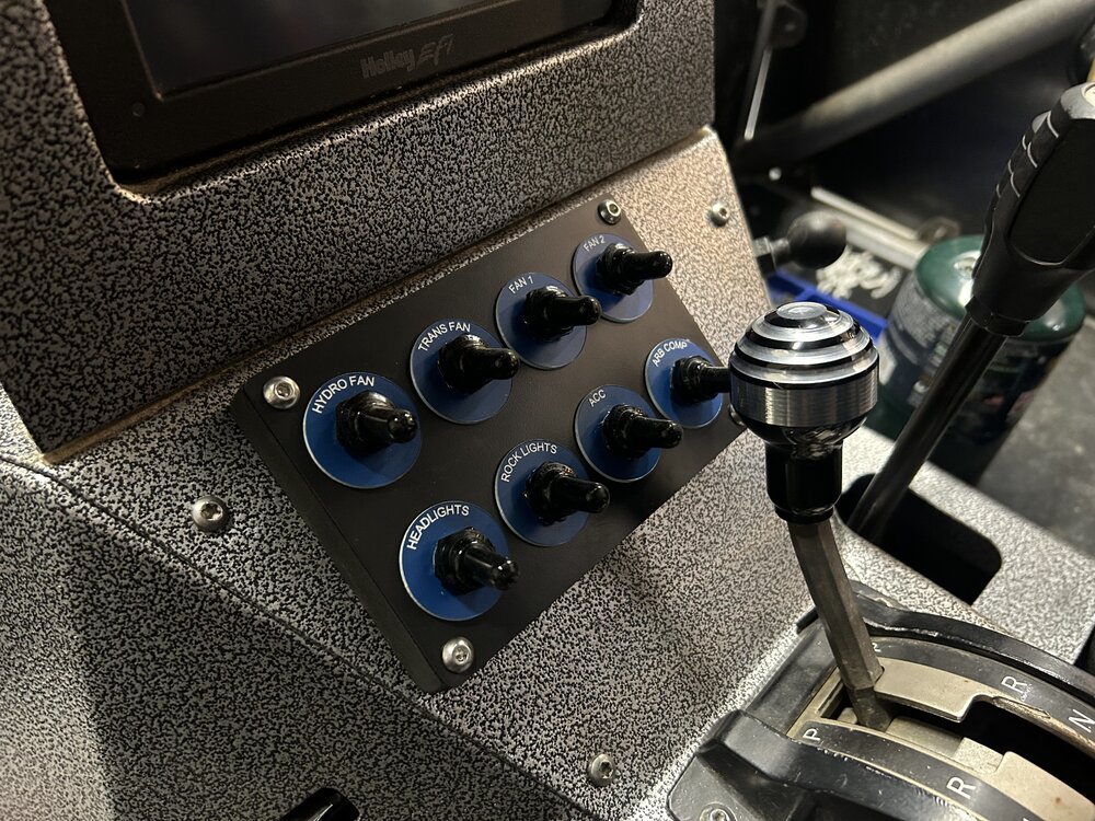

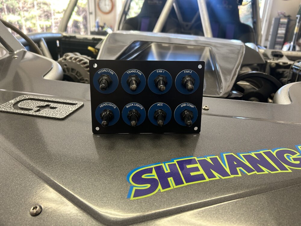

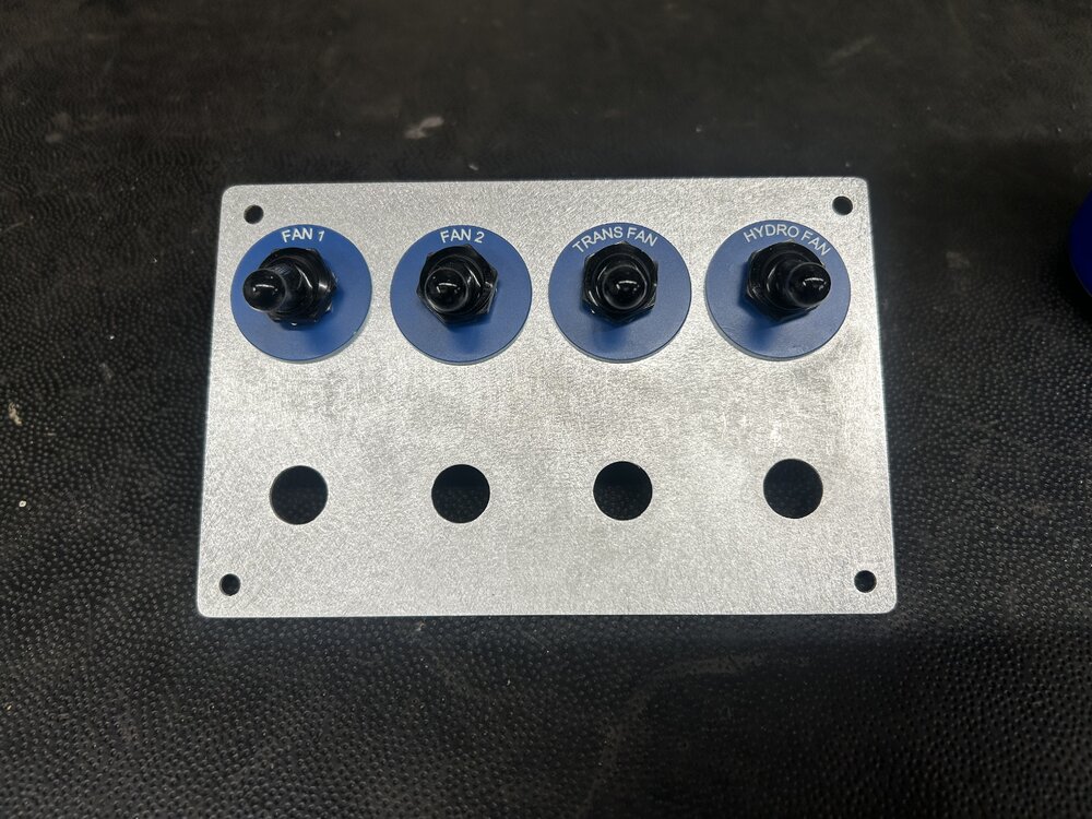

Little trip up to Mayberry to use the Maestro’s tools. Here’s what I made. Most likely get it powder coated some form of satin or gloss black.
Decided to have the new panel Cerakoted through a local gunsmith. Turned out pretty good and should be just as durable as the powder coated panels. Also had to use a 3/4” piece of HDPE to space out the face of the panel just enough to clear a hydraulic line. Then a slight bend in the shifter to make everything clear. Pretty happy with the end product.
