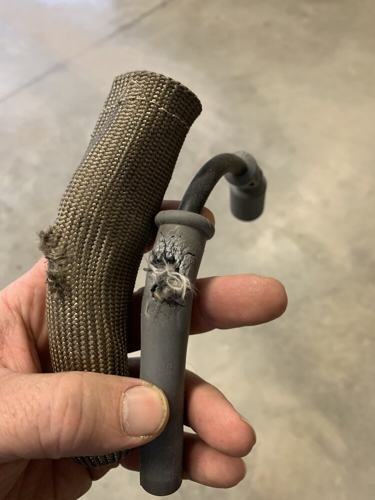

I like the MSD wires with the bendable plug ends.
That one must have been wedged up against a header primary!
Anything that touches the headers will never last long though.
I wouldn’t say it was wedged against the header pipe, but definitely touching. I’ve ordered a set of the ACCEL 9000 series ceramic wires. I’ve heard and read good things about those. May have to custom dent a tube or two to make them work, but it is what it is. On the plus side, I’ll have at least a dozen MSD spares in the trailer.
Which primary was it touching? I've noticed, depending on brand, that sometimes they don't leave you much room between the plugs and primaries. It's like they mocked them up and said...F it, you can still see the spark plug, that'll work! 🤣
Cylinder #5. I pulled all the other plug wires and they’re still looking brand new. Not a scorch mark anywhere.
