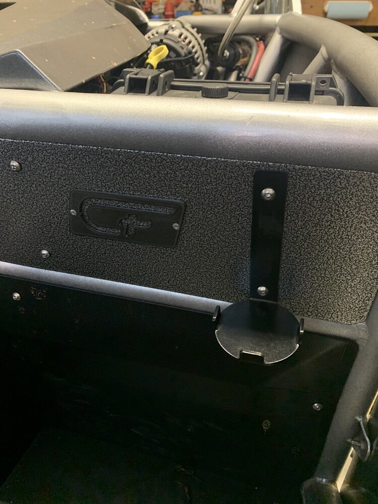

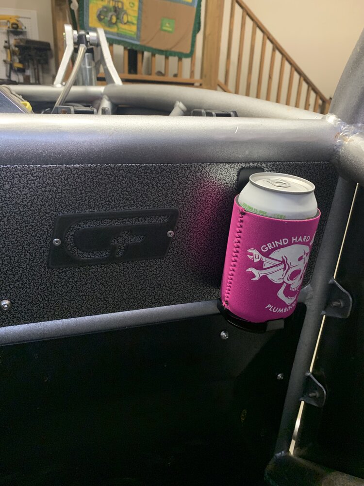

Almost forgot to add the interior touches. First are some CutlerFab original cup holders. Steel, 3 tabs, and intended for a magnetic koozie.
And a picture with my favorite cold beverage, a Diet Sundrop.

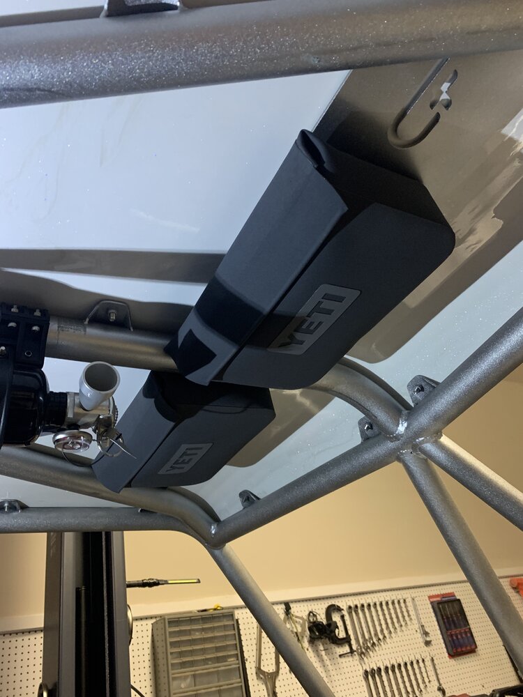

And then there’s the overhead storage pouches. His and Hers that are waterproof and dust proof.

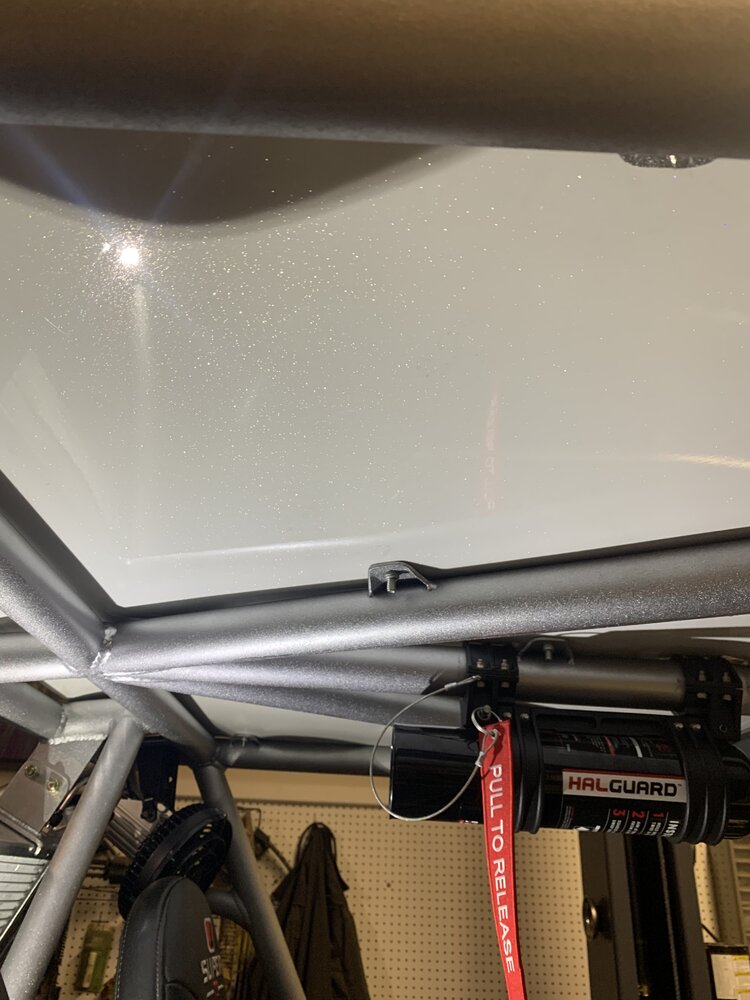

And the last finishing touch was a promise made to my Lil Sis. If you remember from the beginning of this build thread, I let my wife and kids choose some color’s because they helped me out along the way. It was brought to my attention that Lil Sis probably helped the most because she made the round trip to CA to pick up the chassis. Her color choice was “GLITTER”. What kind of big brother would I be to deny her request. The underside of my roof panel is powder coated the most glittery pearl white ol boy had. Shows up quite nice with the interior light turned on.

3- She probably thought you'd hate it, but I bet that pearl/glittery white is pretty helpful and very reflective when the lights are on. I dig that a lot, actually.

There wasn’t any spite intended with her color choice and she didn’t pick how I used the color either. It took me a good month and a half to come up with the roof panel idea and it 100% was intended to serve as a reflective surface to light the interior.

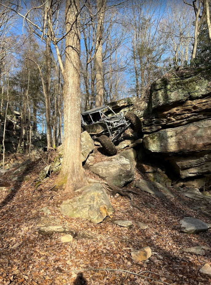

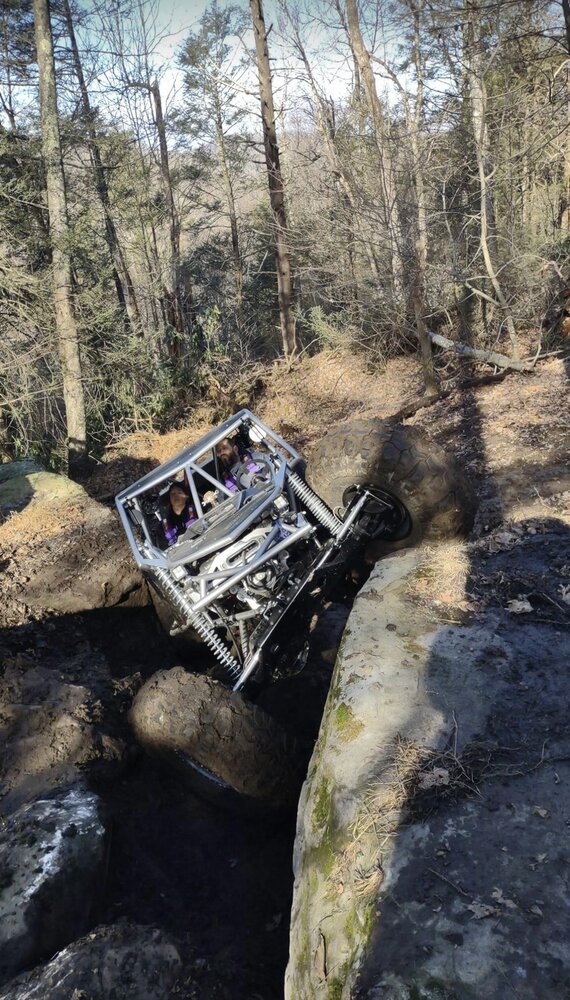

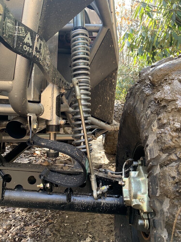

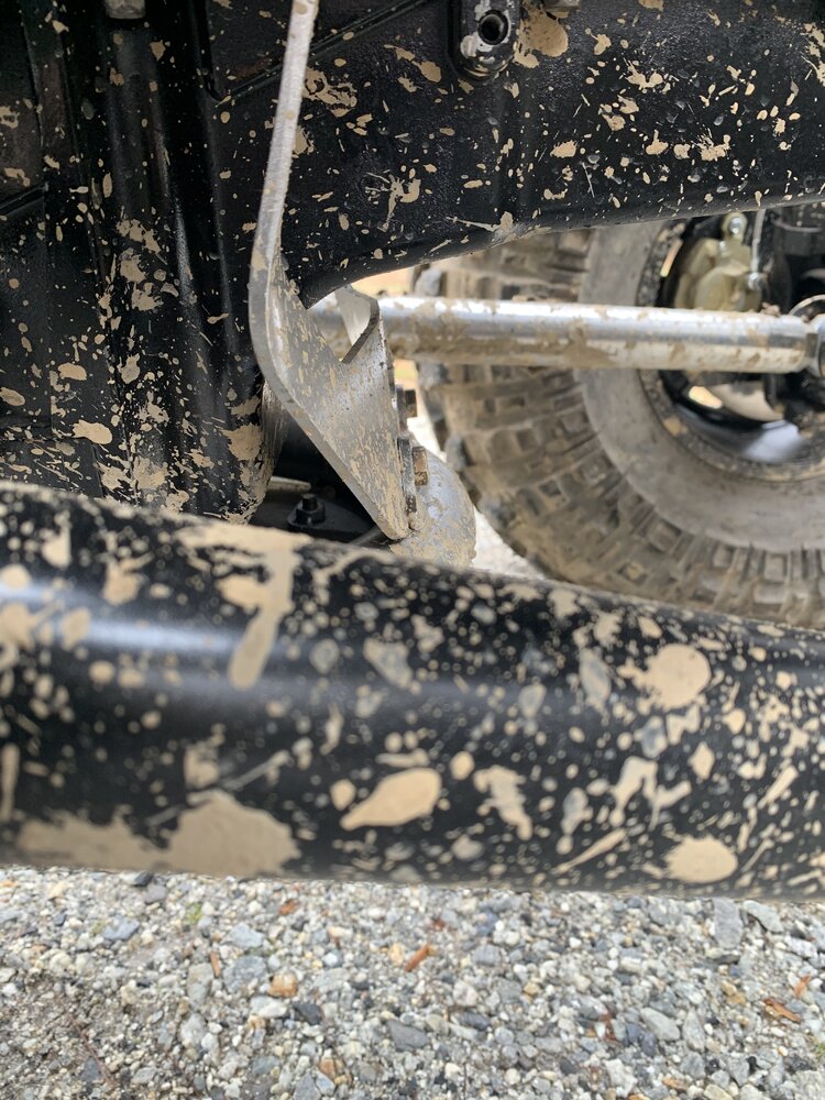

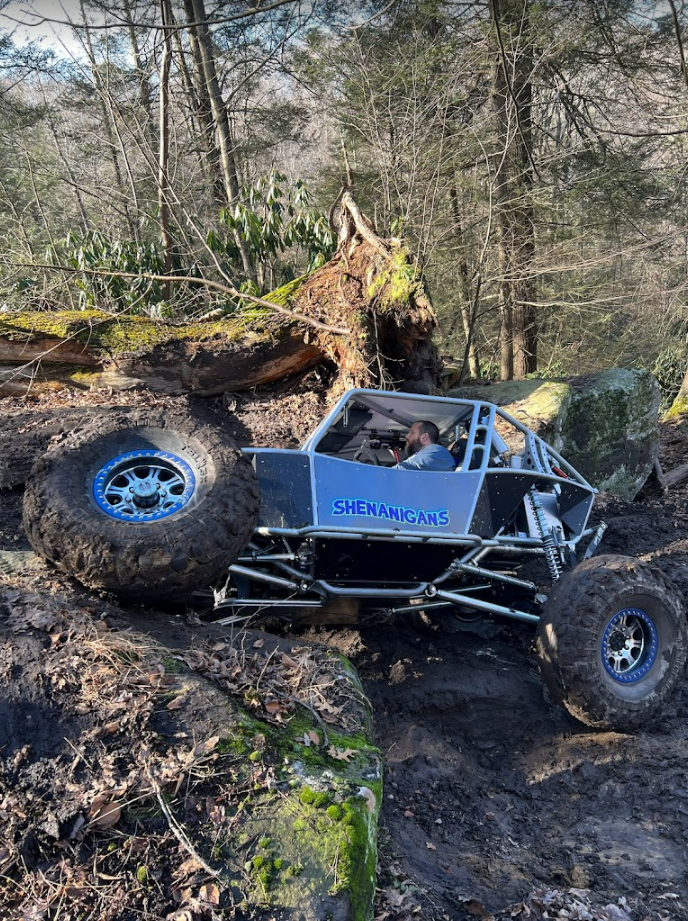

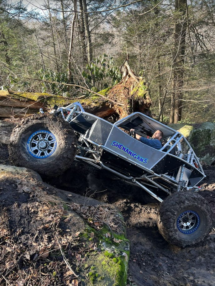

First trip out in the buggy went pretty well. I’ve got a small suspension adjustment I want to try on the rear, but other than that, it performs better than I’ve ever dreamed. Here’s the carnage from my first trip to GER. First thing to go was the rear sway bar. Too much flexy-flex and it mangled the passenger side. Started chewing on my bump can. It’s been removed and I honestly didn’t miss it the rest of the ride.

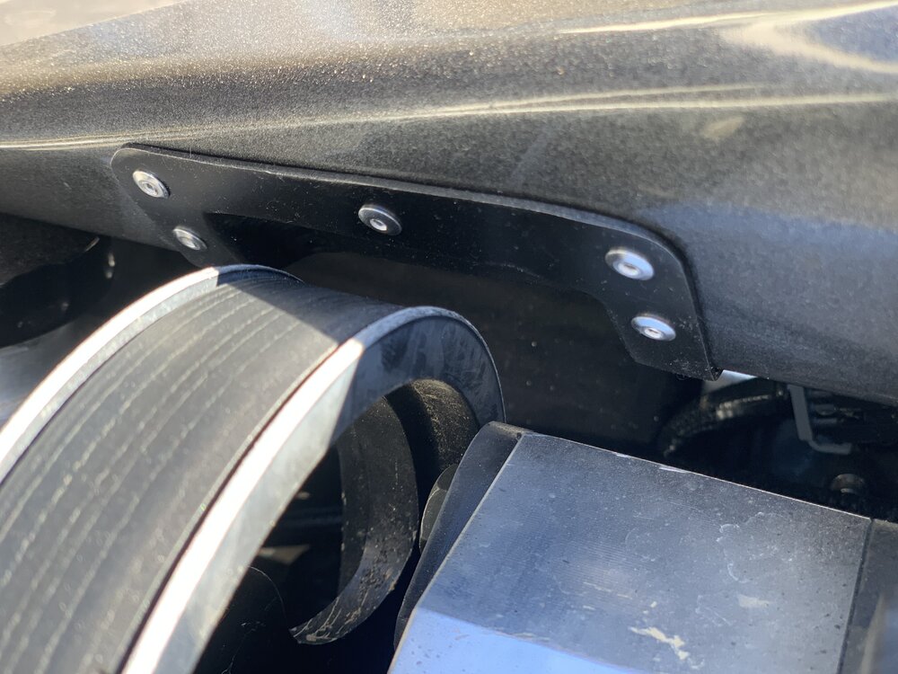

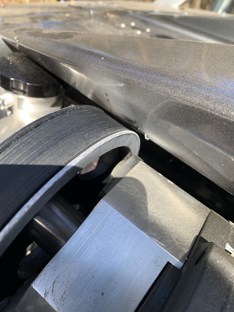

Next thing I noticed was some interference between my power steering pulley and my nice pretty hood. Chews pretty hard in LO and in a bind that torques the motor. The hood is with Matt now and he’ll do some magician type stuff that’ll clear and look awesome at the same time.

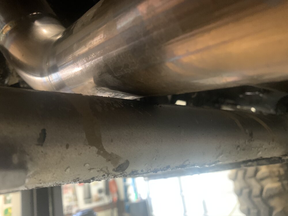

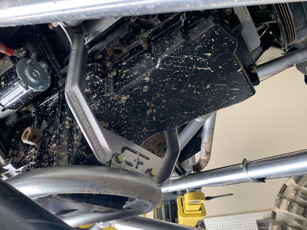

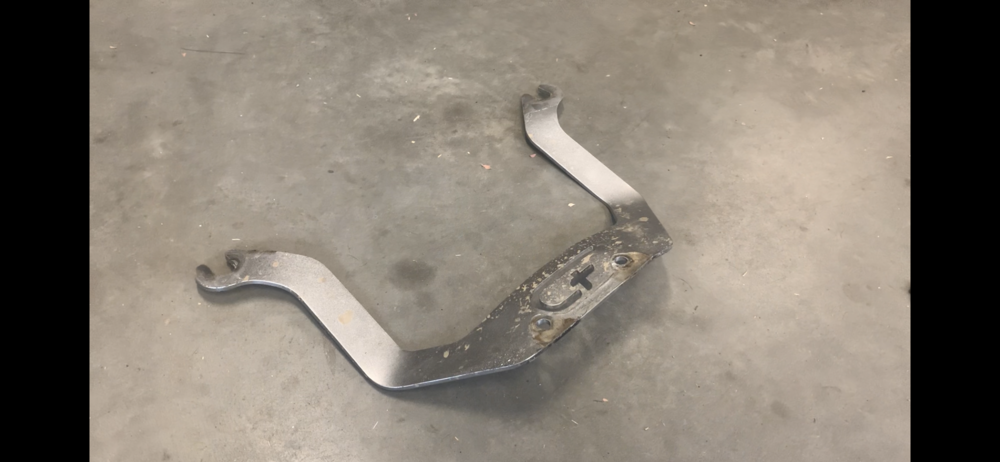

Last part to see some damage was my engine skid. Found something hard and the brace buckled under the weight. Flexed just enough to dent the exhaust crossover, but other than that, it did its job. Matt is gonna print me another one out on his plasma table, but this time he said he wants to add spines for rigidity. Version 2.0 sounds much mo better.
This part used to be flat…

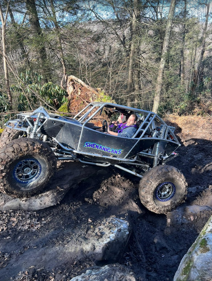

My wife’s face looks like someone that has complete trust in my driving ability…

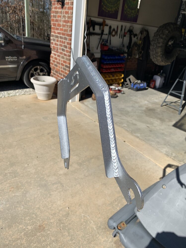

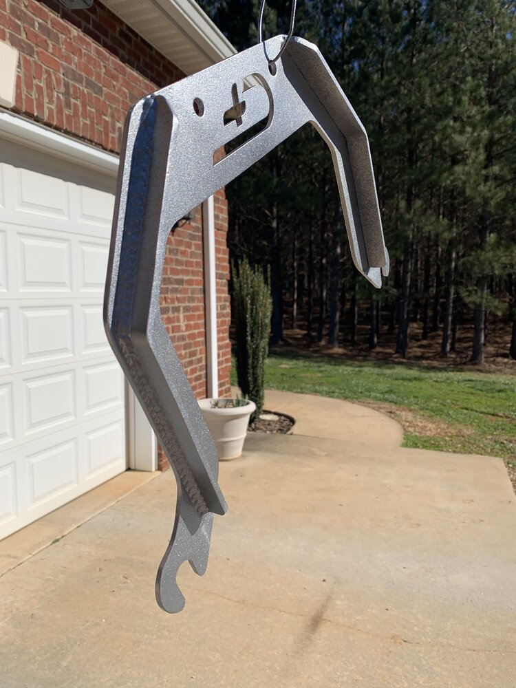

Quick trip up to Mayberry yesterday and patched up my couple of issues. First up was the potato chip support bracket for my engine skid. We mashed it back flat and Matt welded on some spines. I added my redneck sparkle finish and bolted it back in place today.

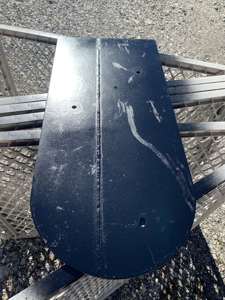

In addition to the bracing, Matt stitched two of my scraps of AR plate back together and we ditched the aluminum piece altogether. Now I’m AR plate everywhere for armor.

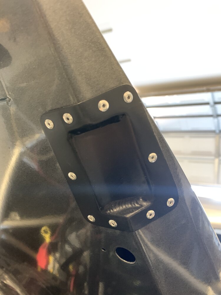

And the last detail was to address the power steering pulley chewing on the corner of my hood under load. Little snip here, little TIG there and voila…

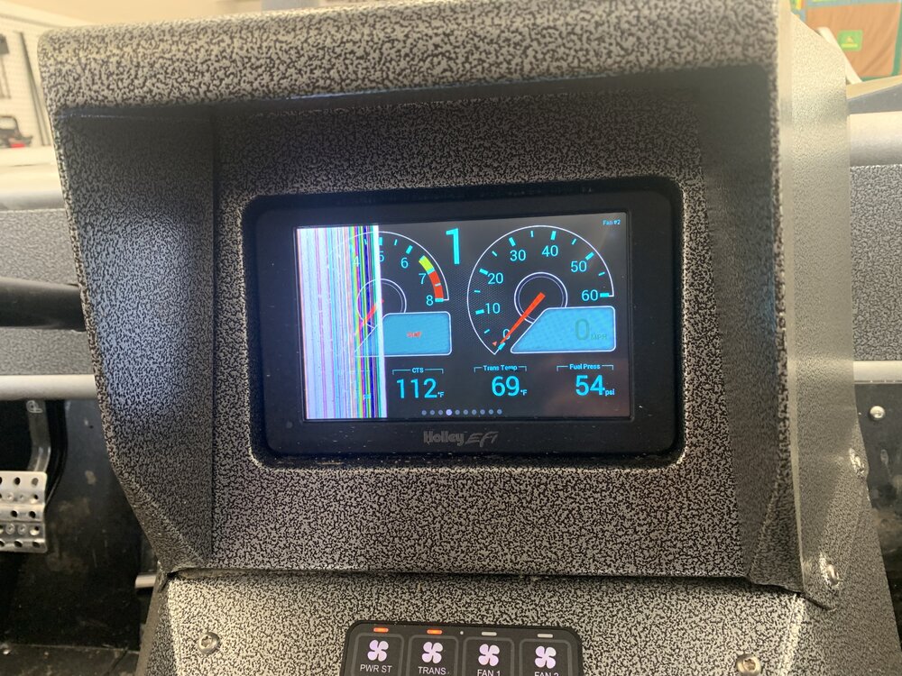

FML!! Who thought putting fancy electronics in a buggy was a good idea?
