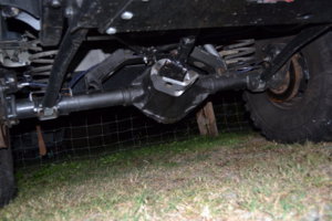

so wow what a day. simply 1 ton is well out the window the front axel was suppost to be a bolt in app. well the guy that had it before told me the upper mount was for a rockcrawler joint it wasnt had to order a new one of those. he welder the coil retainers in the wrong place and if i run the trac bar mount that is on it my tb is going to be about a foot shorter witch well probly give me terriable bump steer even with the hydro assist. havent had a chance to cycle the suspention but from the looks of it with the way the lower control arm mounts are the control arms well come in contact with the frame im not planning on have alot of up travel so i guess at this point i well fix all the other stuff that wrong and keep my finger crossed that they wont hit the frame.
this pic is still some of the weight on the jack stand and the tire are not all the way aired up
