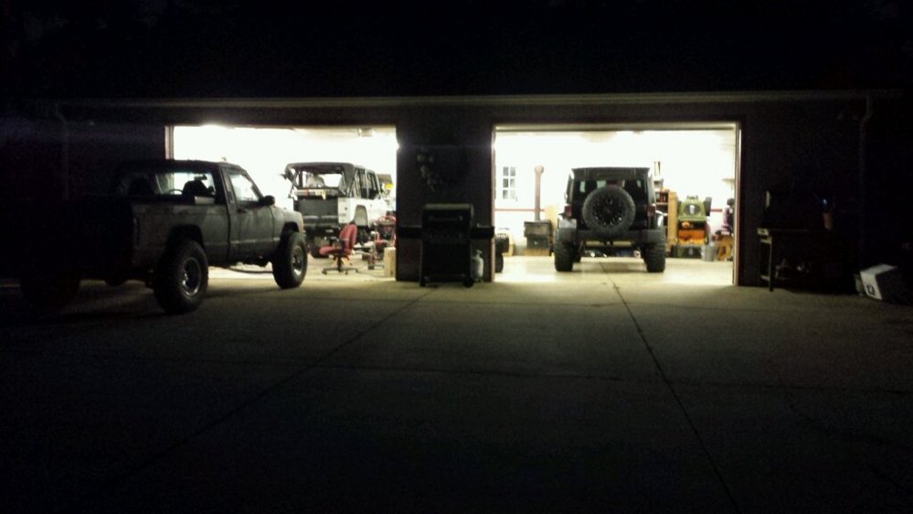

I hate I missed the meet and great at twin peaks but I picked up a new toy

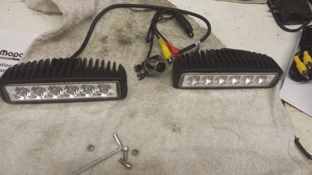

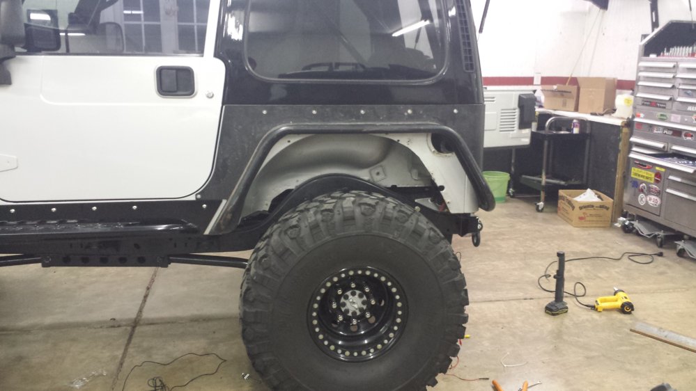

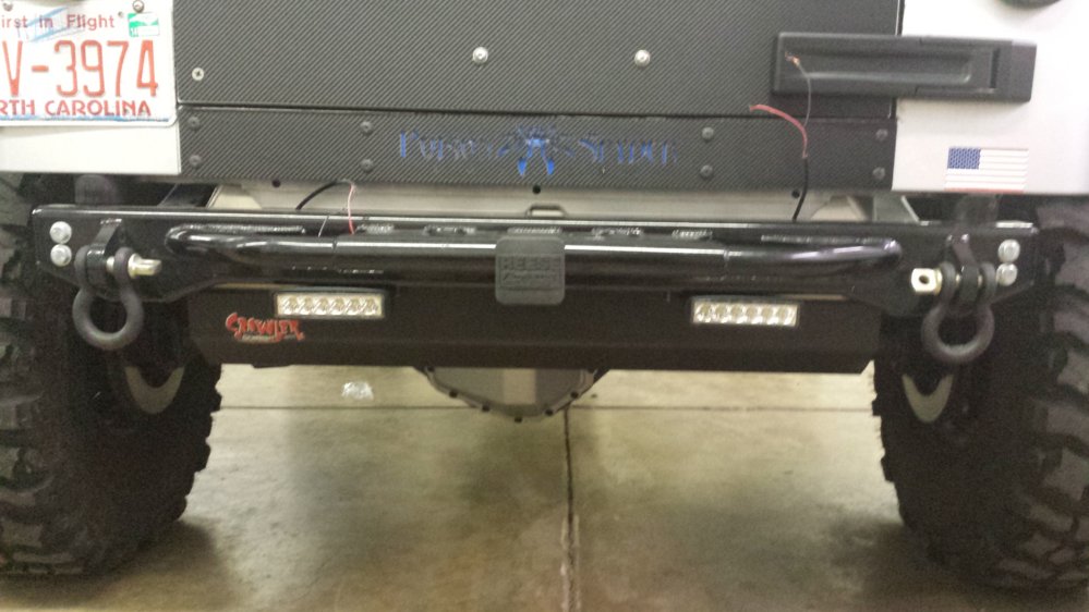

Anybody that has a tj now's how crappy the back up lights are and visibility. Since ive added my double din Ive been wonting to add a back up camera and some lights. I got to looking and found some leds on amazon and a camera for about $70 shipped. Wiring was simply used the reverse light power wire to open a relay from the battery making the leds and the camera activate. Also change out my mile marker for a warn zeon 8000 and wow what a difference. My mile marker has never let me down but the warn is a lot nice and seems to have more line pull plus a brake were the mm didn't.

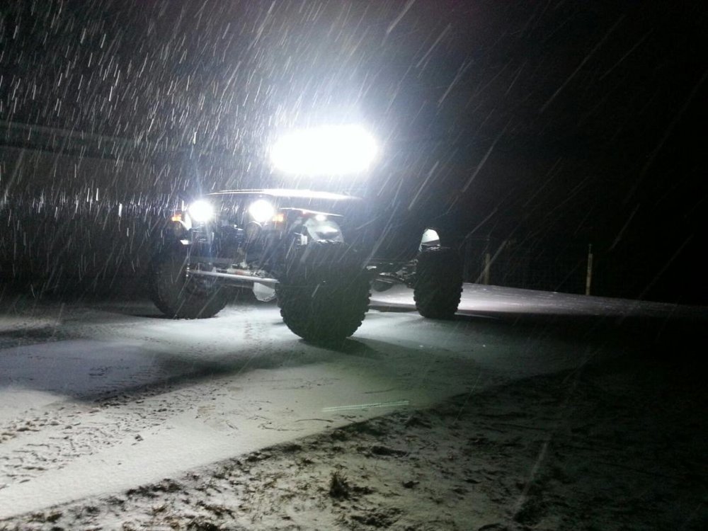

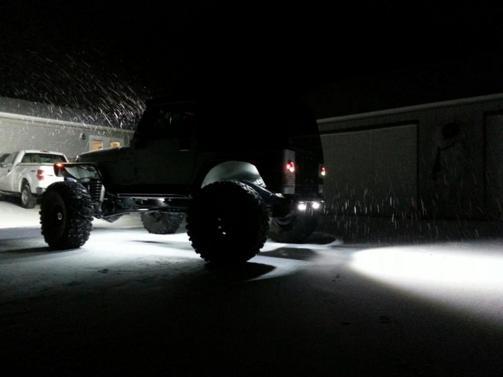

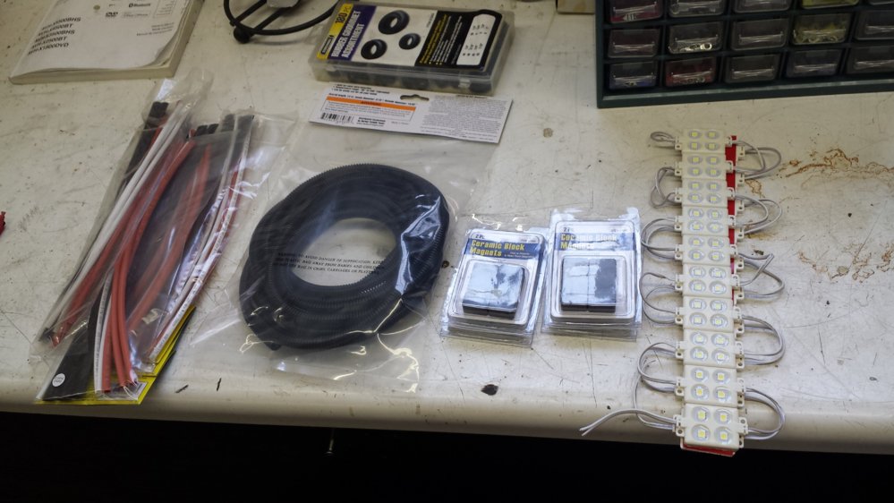

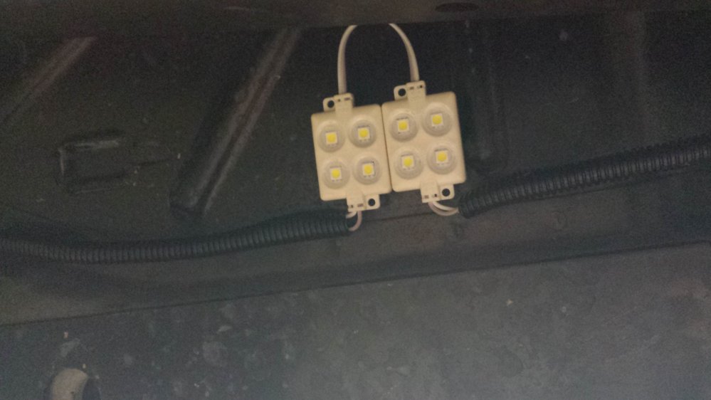

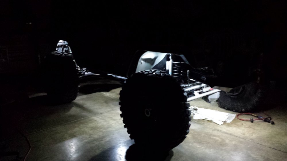

So after playing with the leds reverse lights got me wonting to start my rock light project. After looking at several kits they were ether way over priced or just crappy products. Once again I found my self on amazon looking at led light and ran across some that were water proof and after reading a bunch of reviews they sounded pretty tuff. I ordered 48 pairs (each pair has 4 leds) now I had to figure out how I was going to mount theme. After doing some searching I indeed up using magnets to hold them to the body. Wired the lights into my spod tada I got rock lights.

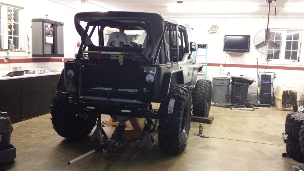

30 + days and still no tracking number on majority off my parts, tired off waiting so I got started.

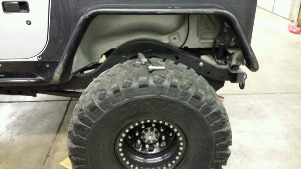

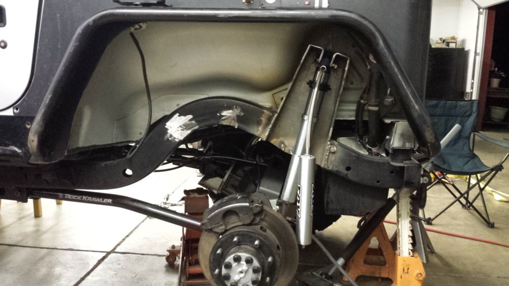

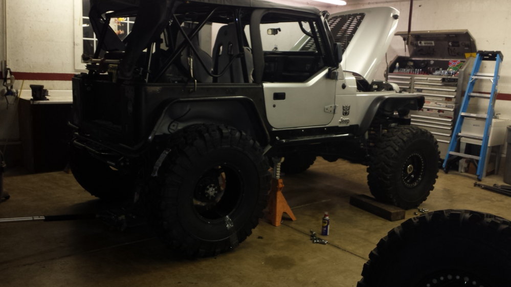

41s showed up along with the 5" rear stretch.So I spent last night mocking up the new rear suspension, 41s are alot bigger in person....

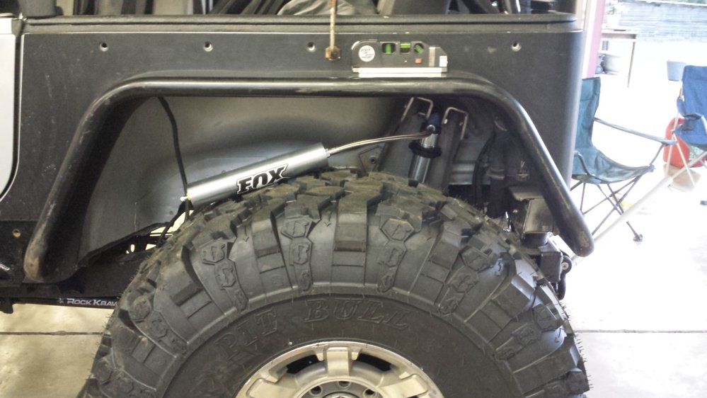

Started mocking up my coilover's , ended up ordering them threw Carolina truggys along with the upper mount they had by far the best price I could find. For now my wheel base is going to be around 101" with 5" of up travel....

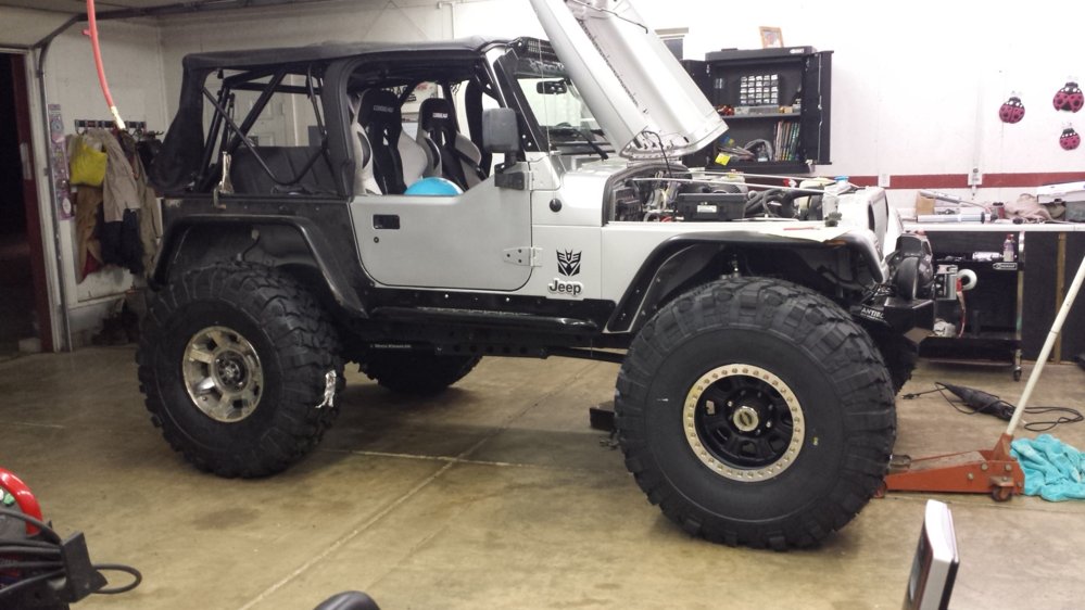

Got my raceline wheels in to day and there awsome. Got one mounted up and the back spacing is perfect. I think I'm going to have to raise the front up 1" to get everything level plus it will Def help with clearance until I get coilover's for the front.
