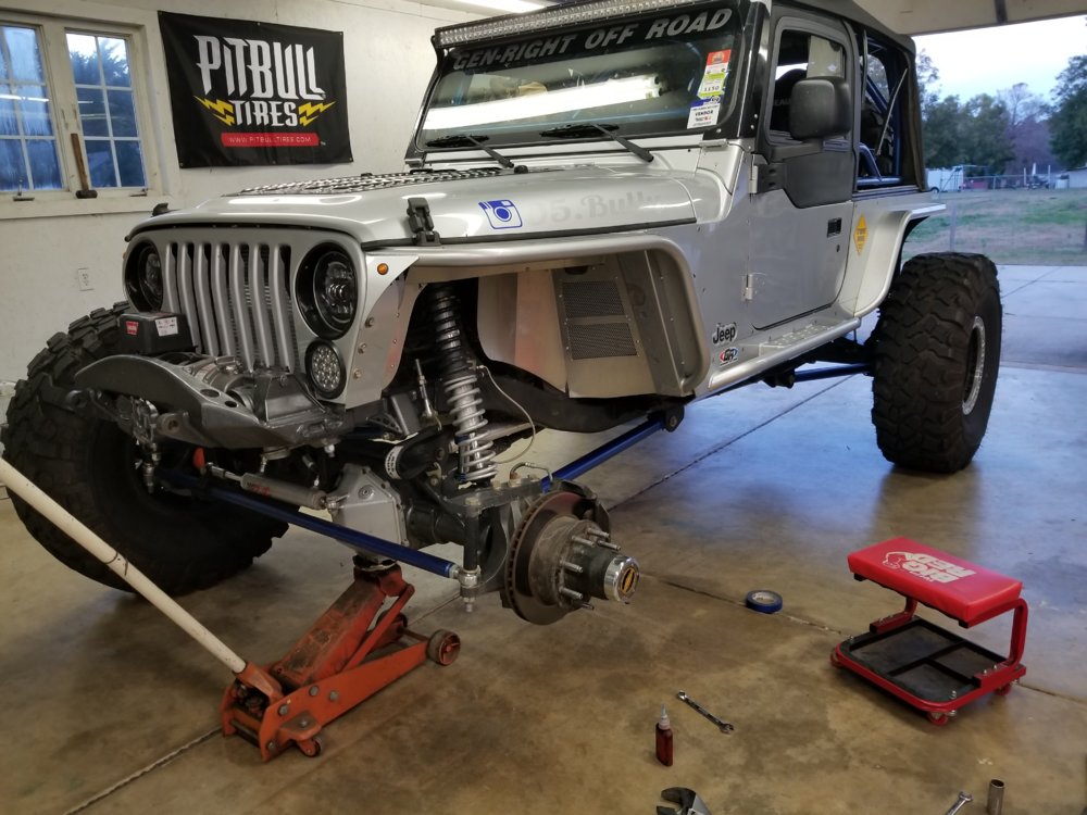

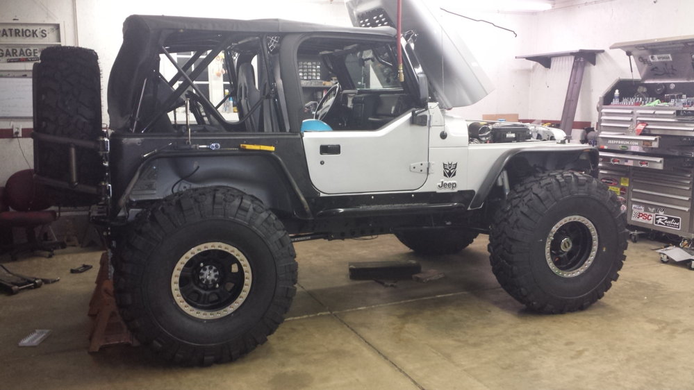

Got bored and built me some lower coilover mounts last night. Now I've got to do the passenger and build me a rear cross member, clean some old welds up and get my brake lines in order. I think I'm going to end up going with a solid bump stop for now in the rear and these winter when I have it dialed in I'll put some 2.0 fox on.

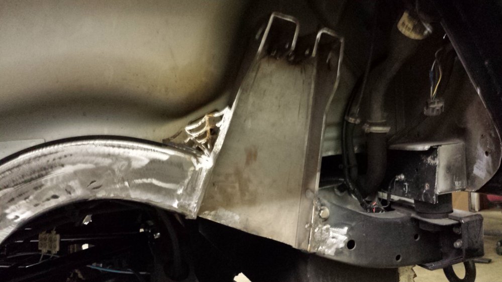

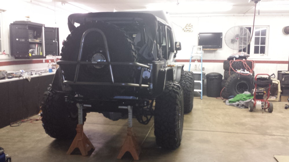

Rear tire carrier showed up and it is exactly what I wonted. 41s fit perfect open and closes easy, time to start sending parts off to powder coat.. only parts holding me up is my coilover springs should be in by Friday hopefully have it on its on weight by saturday

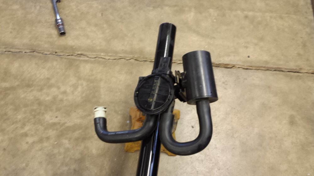

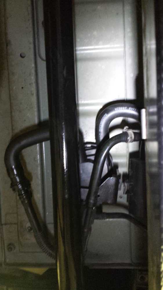

After moving the axle back 6" I had to do something with the evap. I read and read but no real strait threw answer so I started experimenting. Turned out super simple. You can completely remove the charcoal canister with no codes at all just tie the two hose that went into the can together and your done (see pic for what I left). I also went ahead and removed the rear cross member and added a piece of tubing. The tubing will hold what's left of the evap and the limiting straps.

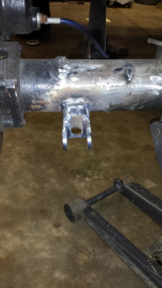

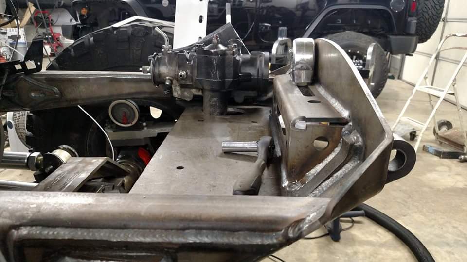

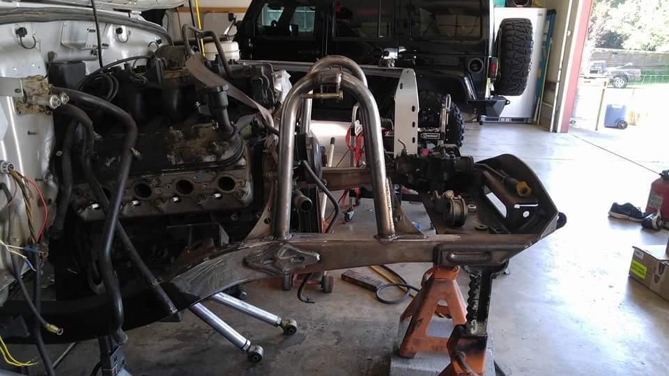

Psc box in the stock location with a pitman arm made for a 4" lift. This setup was almost totally use less offroad at the frame height i was running at the time.
I ended up ripping the Trac bar off so the that lead to ls, atlas, new front and rear axles, new suspension and reworking the last 18" of the frame.
