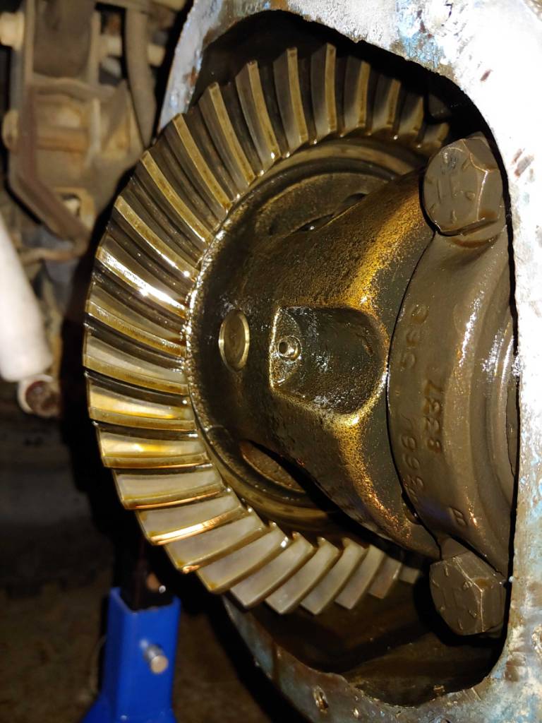

Well, last night I found out the noise in my rear D44 is the 2 small spider gears missing some little chunks. The larger ones are fine. Do I need to replace all 4 of can I just do the like ones? I'm assuming all 4. Any brand in particular, or does it matter. I don't want something so cheap they break again in a few thousand miles.
Also, every site I've looked at shows a cross pin bolt or roll pin for the D44 with trac lok. It looks like mine had a roll pin, but not 100% sure. Here's a pic, I'll try and get another if y'all need it.
If it's a roll pin, I should be able to punch it out without removing the carrier, right? If it's a bolt, it's obviously broken. Are the Yukon or Nitro Gear removal kits good, or is there a better way I couldn't find?

I'd bring it to an axle guy. Those limited slip units require special tools to change the spider gears. (Because the side gears put pressure on the clutch pack) all four gears need to be changed as a set.
Looks like a TJ D44. It'll have a roll pin as opposed to a bolt holding the center pin in place
Before you waste your $$$ on a Track Lok rebuild kit, put that money towards a Truetrac LSD or a locker.
You can swap out the spiders and side gears yourself using one of the shafts to rotate the side gears. You'll also need to fashion a tool to preload the opposing side gear in order to get the clearance needed.
