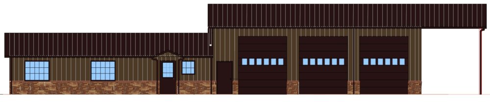

I'm not using metal studs, but building a garage with a 1,056sq ft (correction: 1122 sqft) "apartment" very soon (trusses arrive April 13th)
8x8 Post construction
MFG truss
14ft spans
2x6 roof purlins @ 24"
corrugated metal roofing
2x6 horizontal girts @ 24"
corrugated metal siding
Lick and stick stone
insulated garage with 4 tons cooling/heating

I'm not using metal studs, but building a garage with a 1,056sq ft "apartment" very soon (trusses arrive April 13th)
Did you do any sort of cost analysis vs conventional stick? Very curious to know how your numbers worked out.
