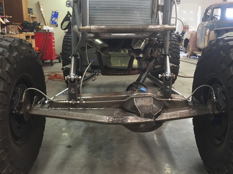

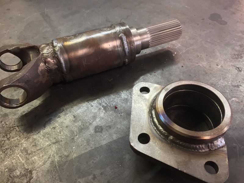

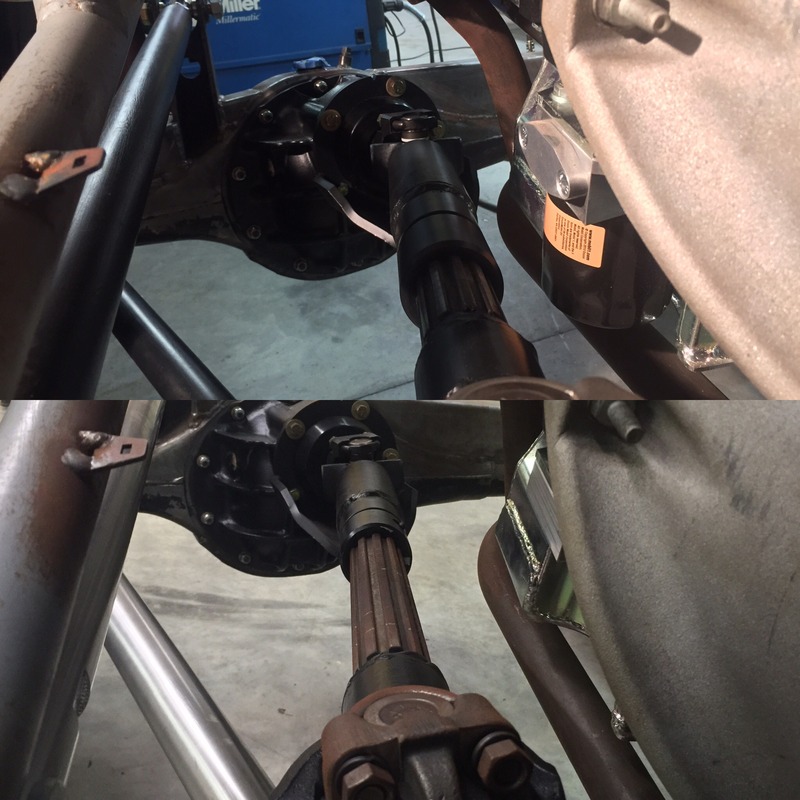

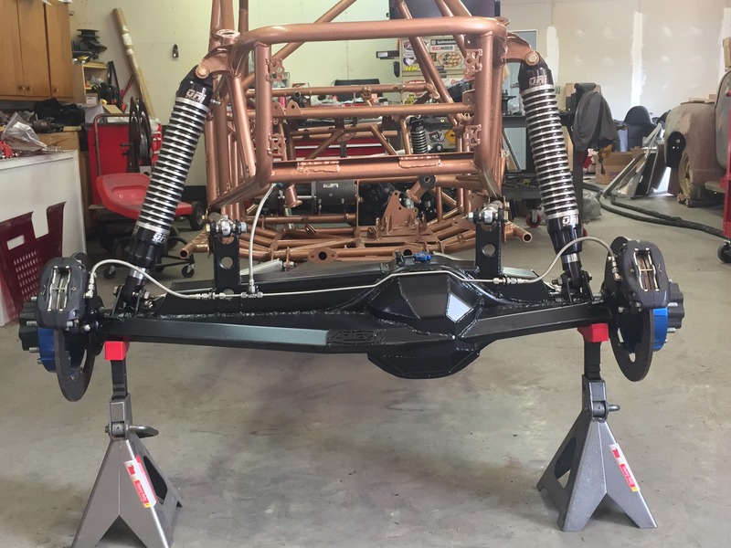

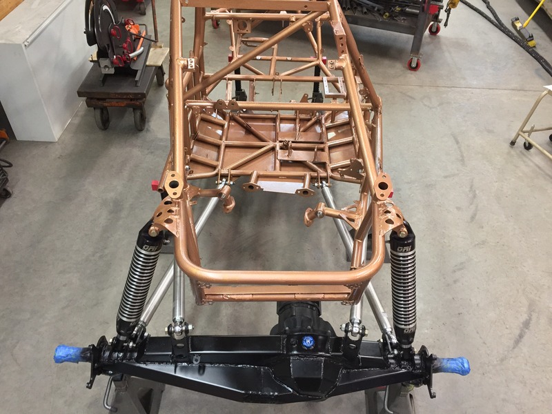

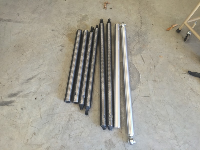

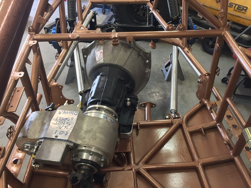

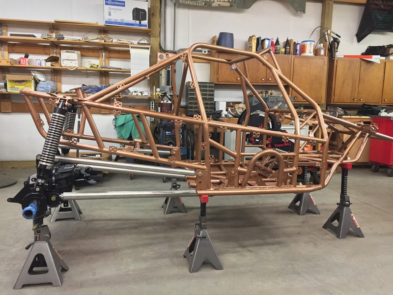

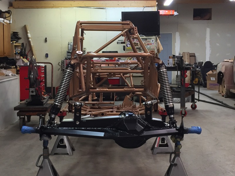

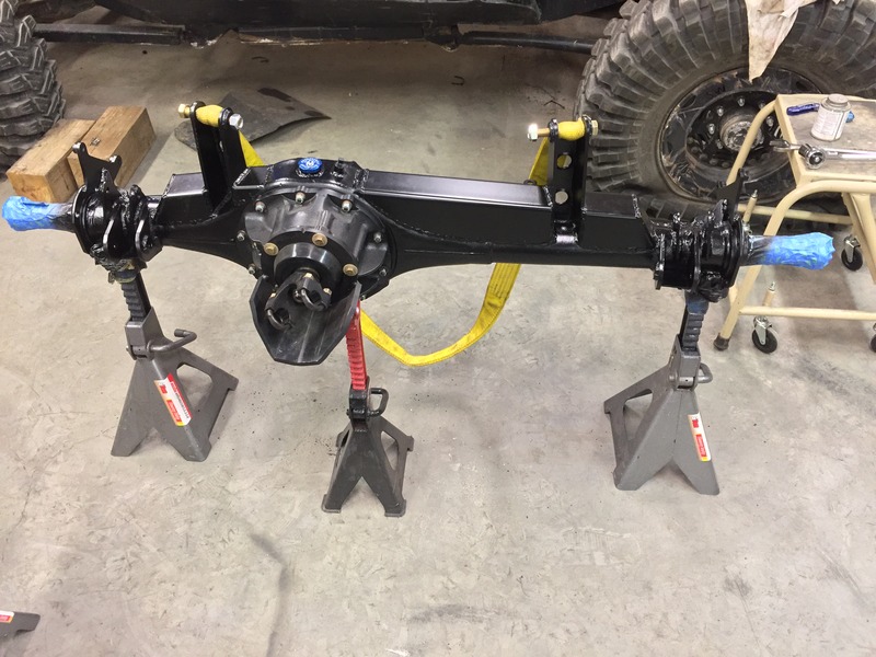

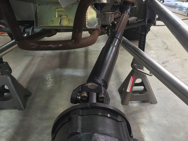

A few months back I ordered all new 7075 links from WOD. I had the rears made 7.25" longer to move the axle back to help with the driveshaft angle. It's going to require building a longer rear driveshaft, but the one I already had built will also fit the front so I'll have a spare now. And I'll just go ahead build two for the rear and have a spare for both.

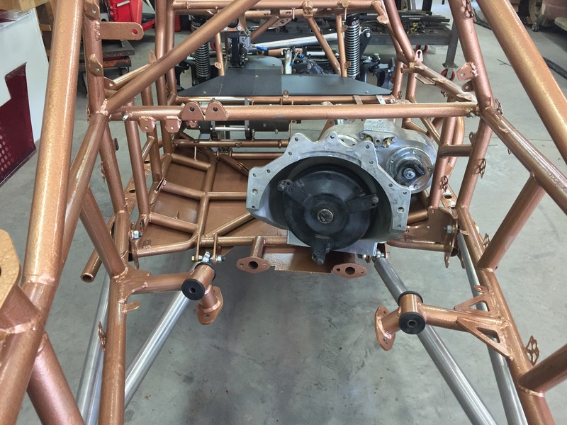

This picture shows a before and after of the driveshaft angle.

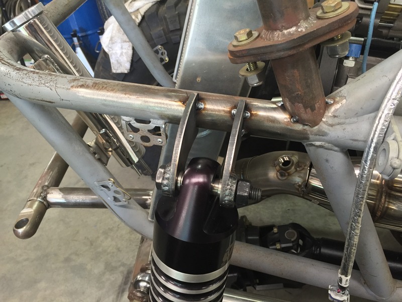

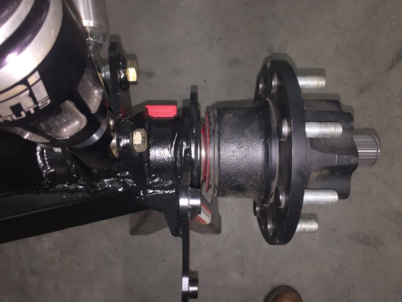

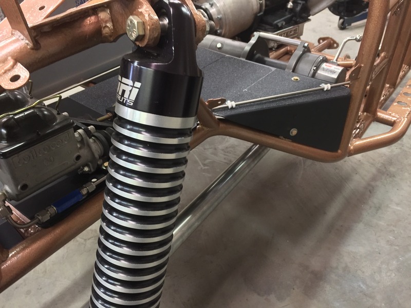

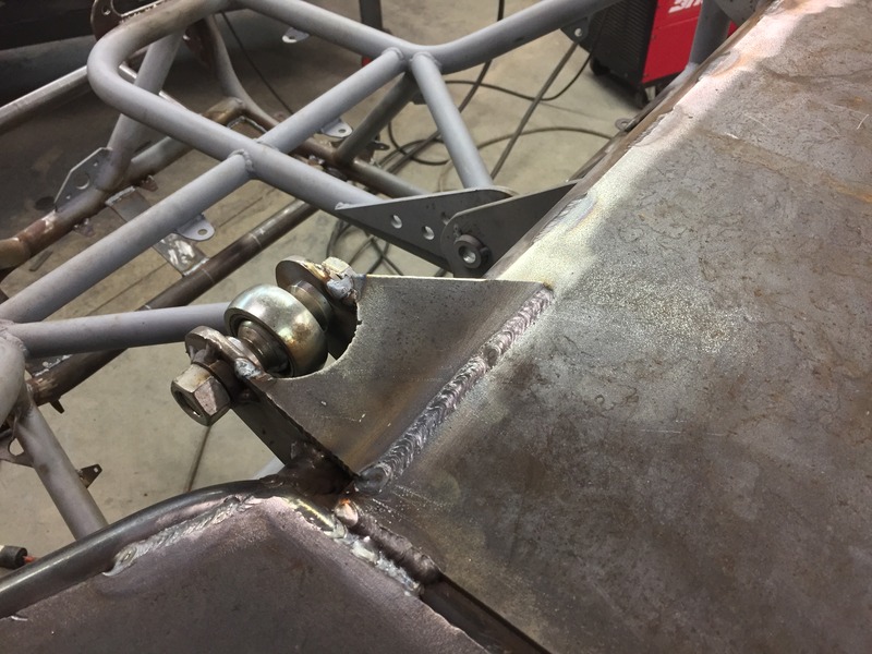

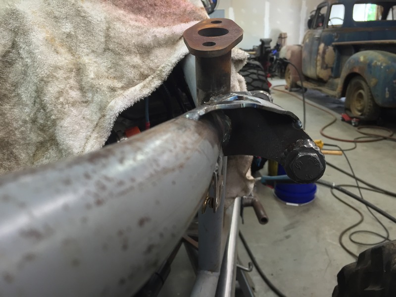

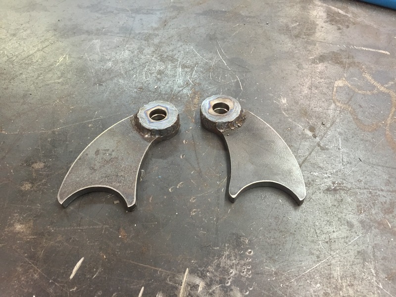

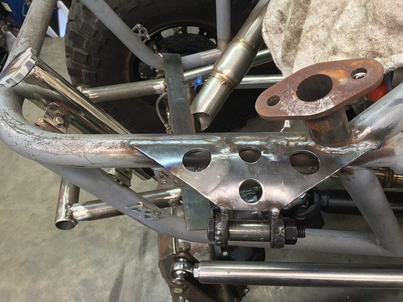

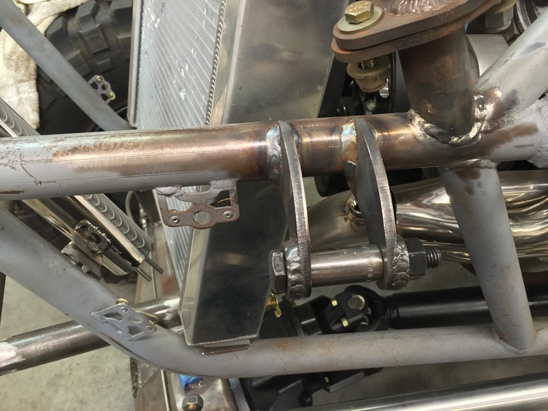

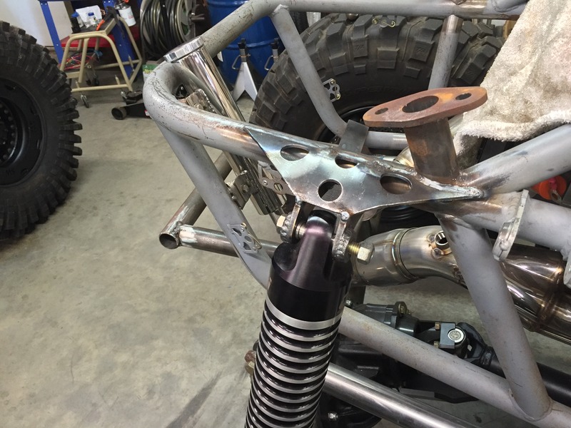

Moving the axle back also meant I had to build new upper shock mounts, but I had been planning to redo/reinforce them anyway because I've always heard that mounts for ORIs need to be beefier than mounts for air shocks/coilovers due to them also acting as the bumpstops. Over the last couple days before work I got one rear mount done. Still have the other side to do, and I'm also going redo the front upper mounts as well.
