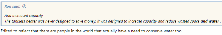

Tank-less Water heater Vs. Traditional Water Heater
Edited to reflect that there are people in the world that actually have a need to conserve water too.
But even that depends on teh setup.
