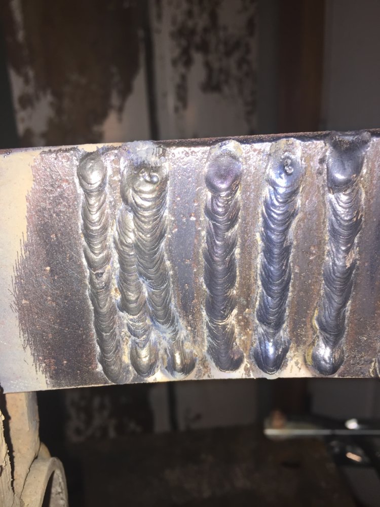

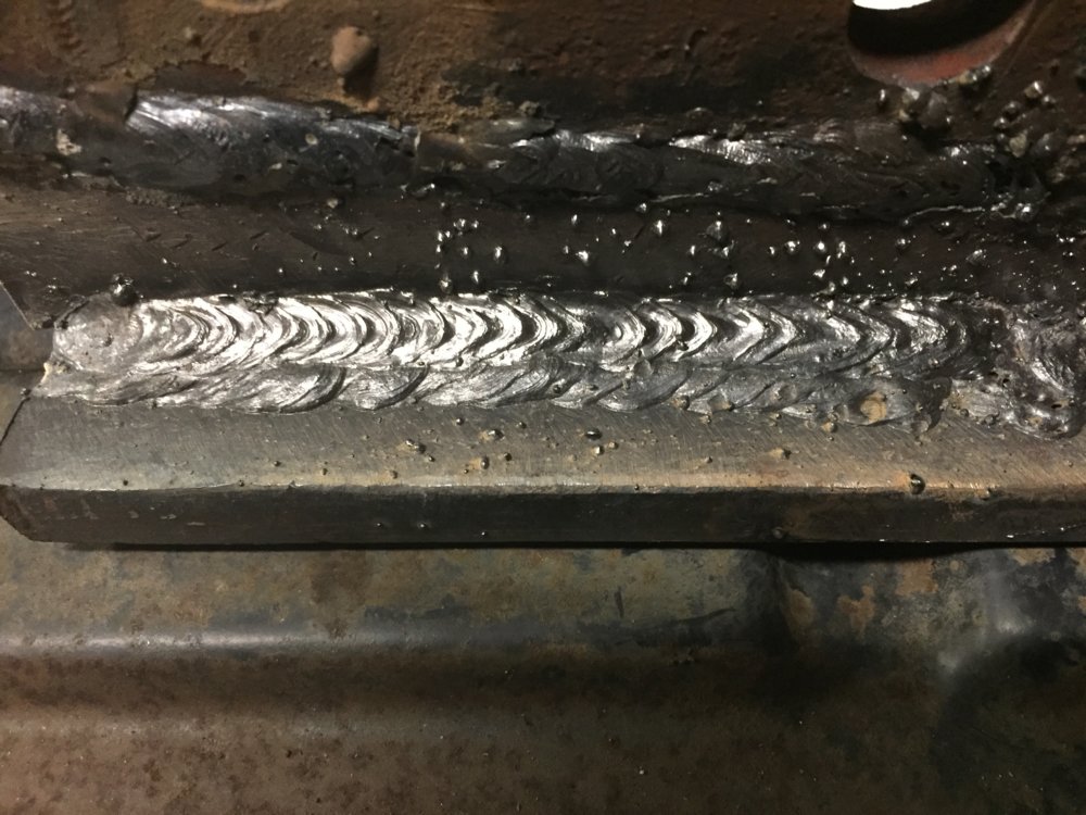

This is my 3 pass mig attempt flux core on 1/2” machine was cranked up wire speed over 400 or close! haven’t cut it yet to see if penetrated looks like last ones laying on top to me tho!?

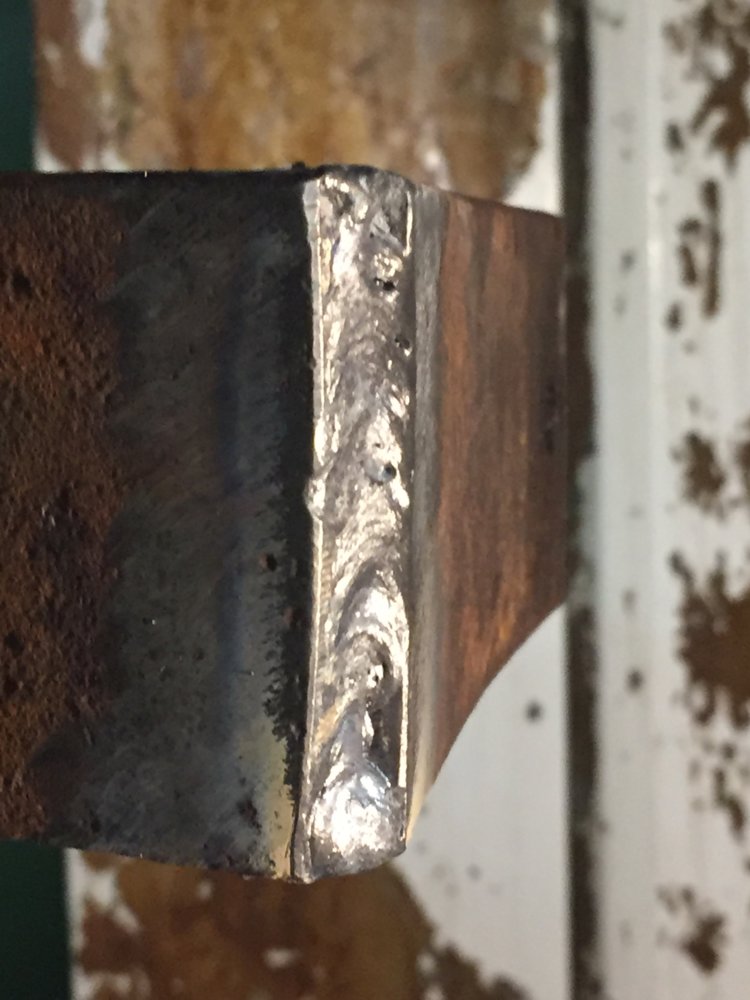

First flux core outside corner seems to have penetrated one side at least!! Was vertical downhill 20amp

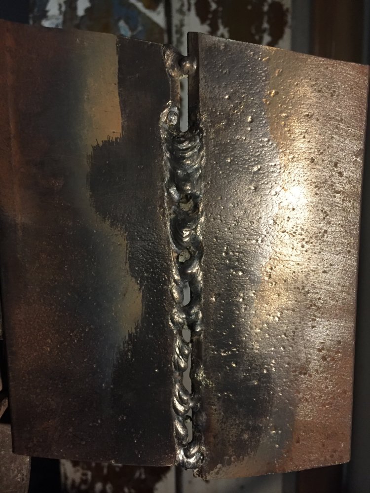

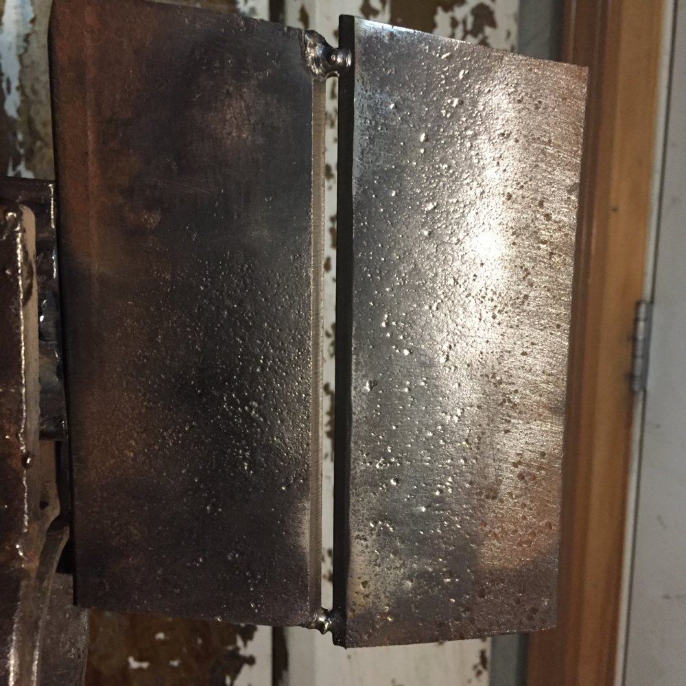

for your vertical, try 2 pieces of 1/4 or 3/8 plate. bevel one then tack weld the two together with about 1/8" gap between them. Stand them vertical then weld your uphill weld.
Vertical welds like to have a place to lay and cool/freeze
Without Backing plate? I’ve got some 1/4” I’ll try that with tonight if I get time gotta get more electrodes for stick I’ve ran through 5lb in a week.

Shit I beveled both pieces lol but here’s first attempt felt like a was using a gouging electrode lmao piss poor attempt to say the least will setup another one now one beveled instead of both
