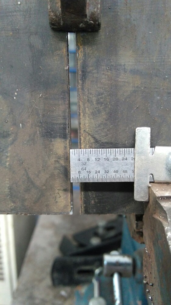

for your vertical, try 2 pieces of 1/4 or 3/8 plate. bevel one then tack weld the two together with about 1/8" gap between them. Stand them vertical then weld your uphill weld.
I'll do it tomorrow.. I've got 3/16 FB laying around.. too bad I got .030fc instead of .035... Still 1/8" Gap or should I make it 3/32"? It's just a hf Chinesium 90a 110 wire melter I've had for at least ten years.. I guess I can throw it in the 12 ton press too when I'm done..

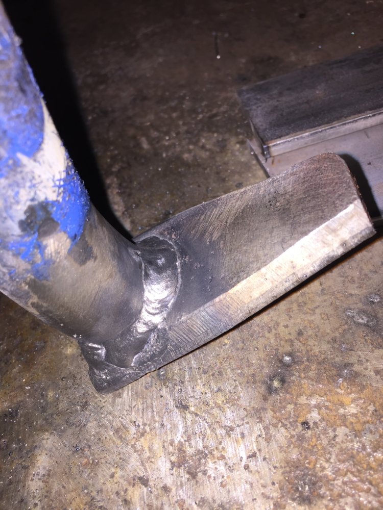

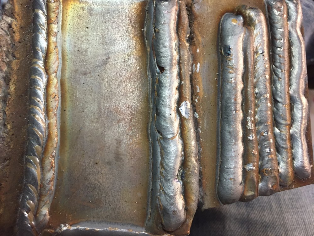

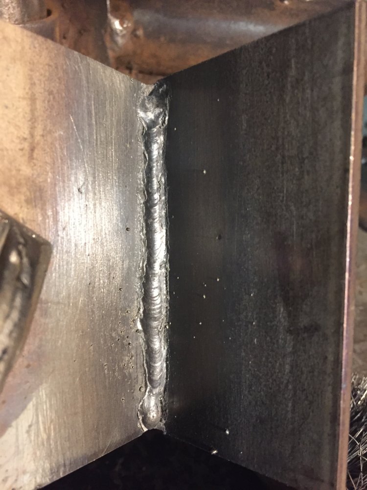

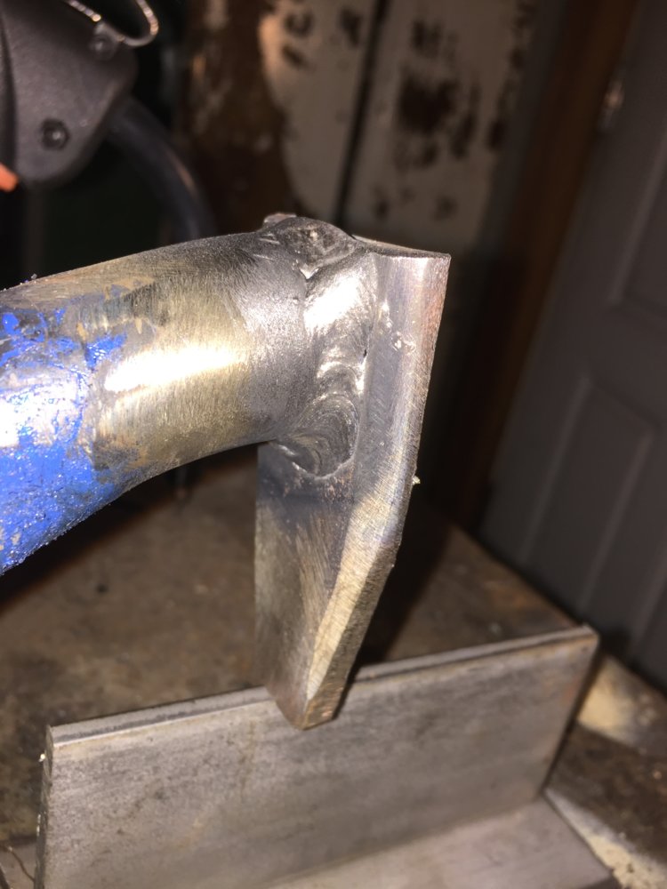

Here’s vertical inside corner flux core on 3/16, picking up some hrew tom so I can get the angle change practice in! I’ll hopefully have a order going in for a few sticks of tube tom and see what all he can get for me!

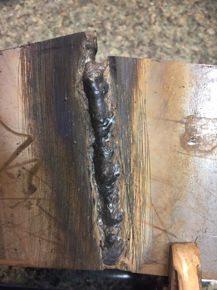

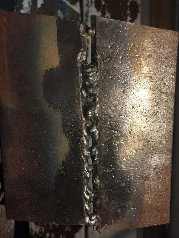

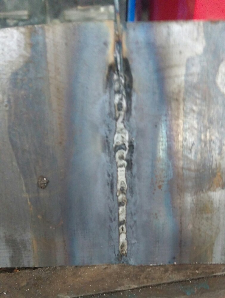

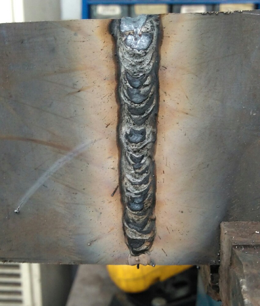

Vertical open root flux core 1/8”ish gap 0.30 wire I got lots to learn...!
Try it on flat plate, make a 90* and weld uphill. It's almost similar to tube, except it's not wrapped around a circle. Perfect that first, then try flat, and inverted. Or whatever order. Basically tube to flat will be very similar, though over a constantly changing angle. Simplify, then complexify. That's my 2 lb of scrap steel contribution... That might be about 12 ¢.
This just clicked... smdh I now see what your saying with 90* on flat plate! My mind is on overload lol
View attachment 274668 View attachment 274669
Not to horribly bad for a first time. I thought you were gonna stick it. But since your using flux core, come out of the root more and let the puddle flow out. blend the material of the unground side help fill the open root and the bevel side. uphill welds will need to be wider then a flat so the weld can "stack"

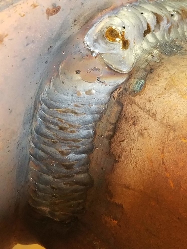

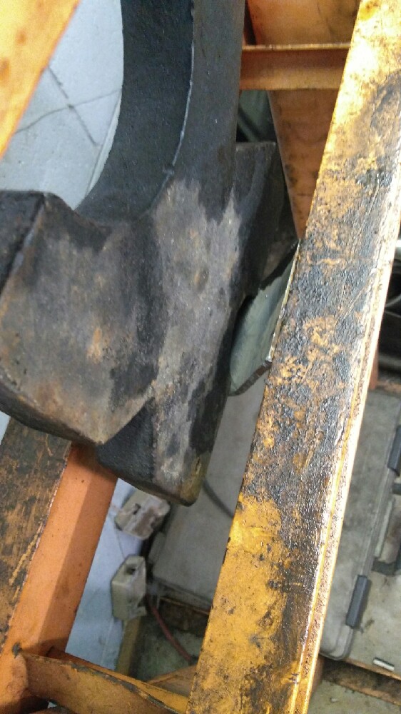

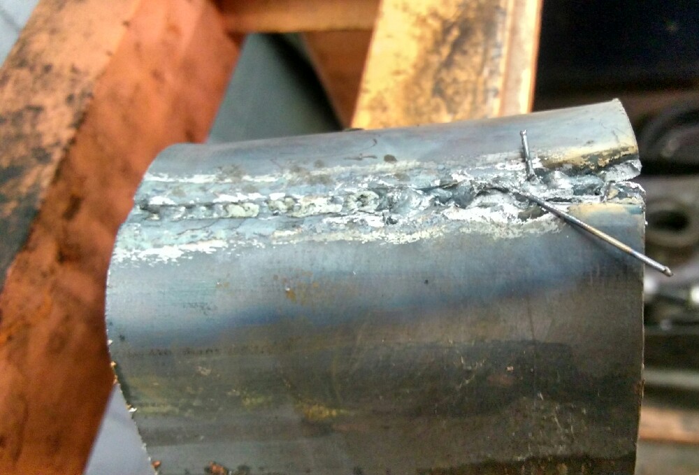

here is a vertical I did on a track loader last saturday. Was a crack in 3/8" formed plate. I ground the crack completely through then welded. Could not get a drill in to end the crack.
You can do 3/32, come out of the root and stack it. Remember to stop and let the machine cool too..

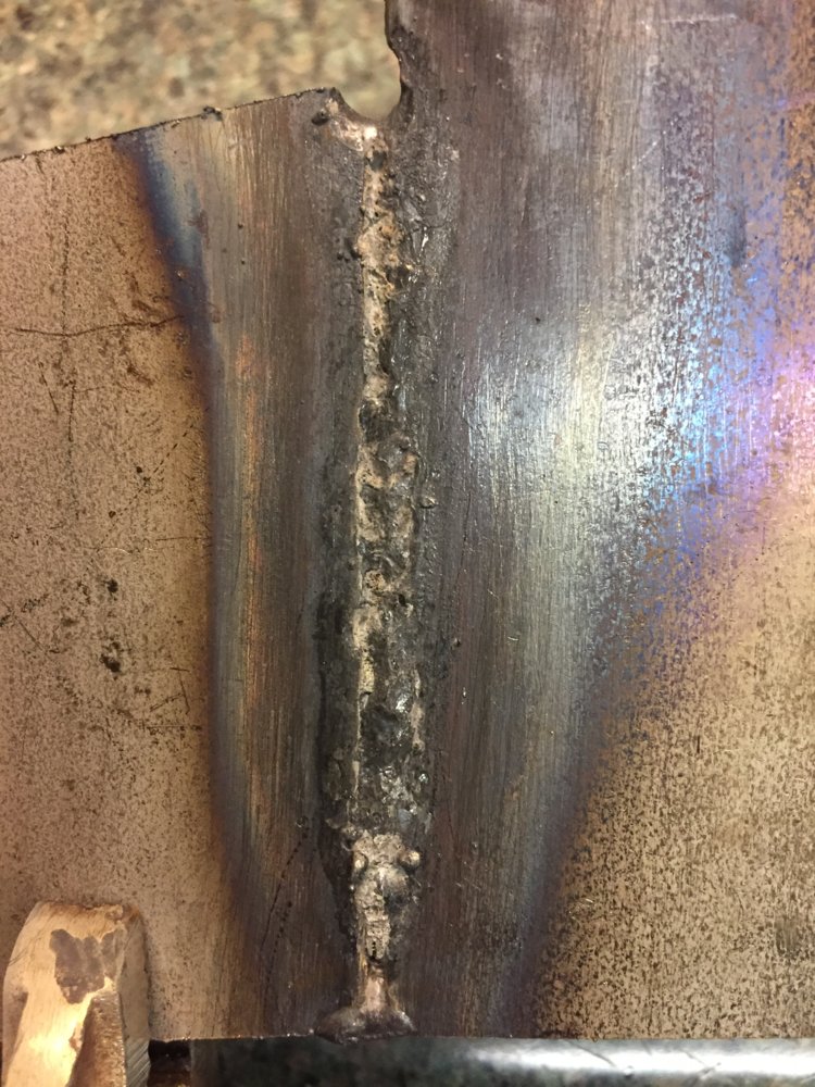

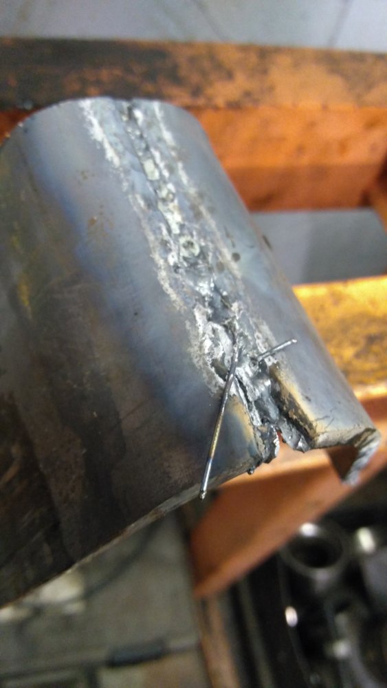

@Jeff B here was my stick attempt man pretty horrible my gap may be smidge bigger than 1/8 but no excuse lol
I’m going to do another stick test tonight if possible my first one was a disaster!

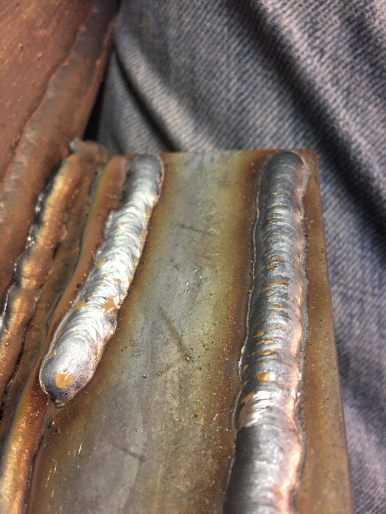

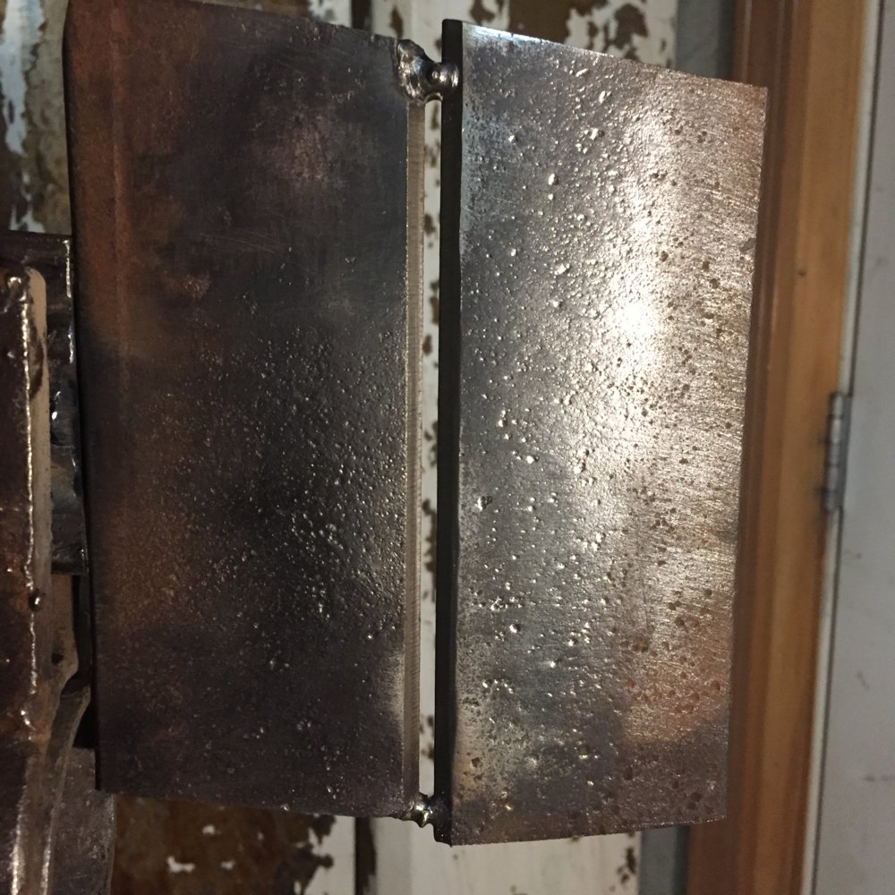

I forgot to bevel the plate.. oh well. It is .172 thick, root Gap 3/32.

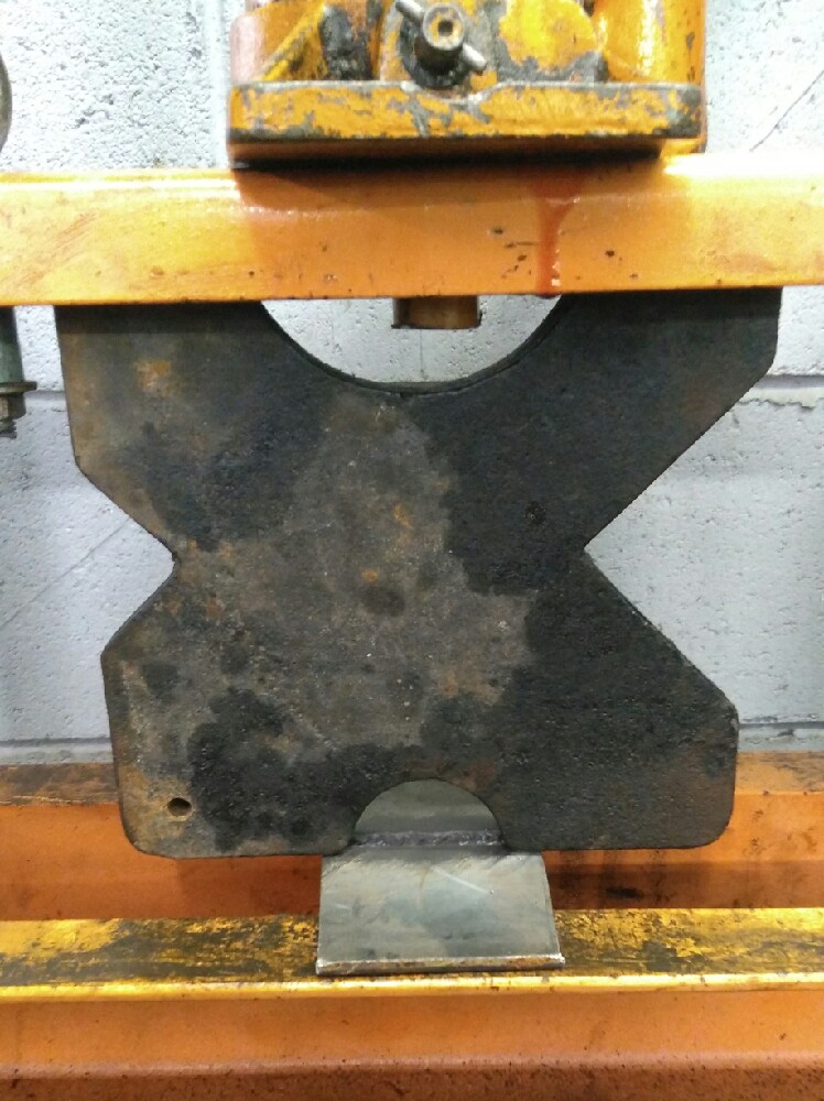

I didn't start low enough into it and quit before the top.. it shows when I threw it in the press.. y'all tell me if that's decent or not for someone not professionally trained or certified..

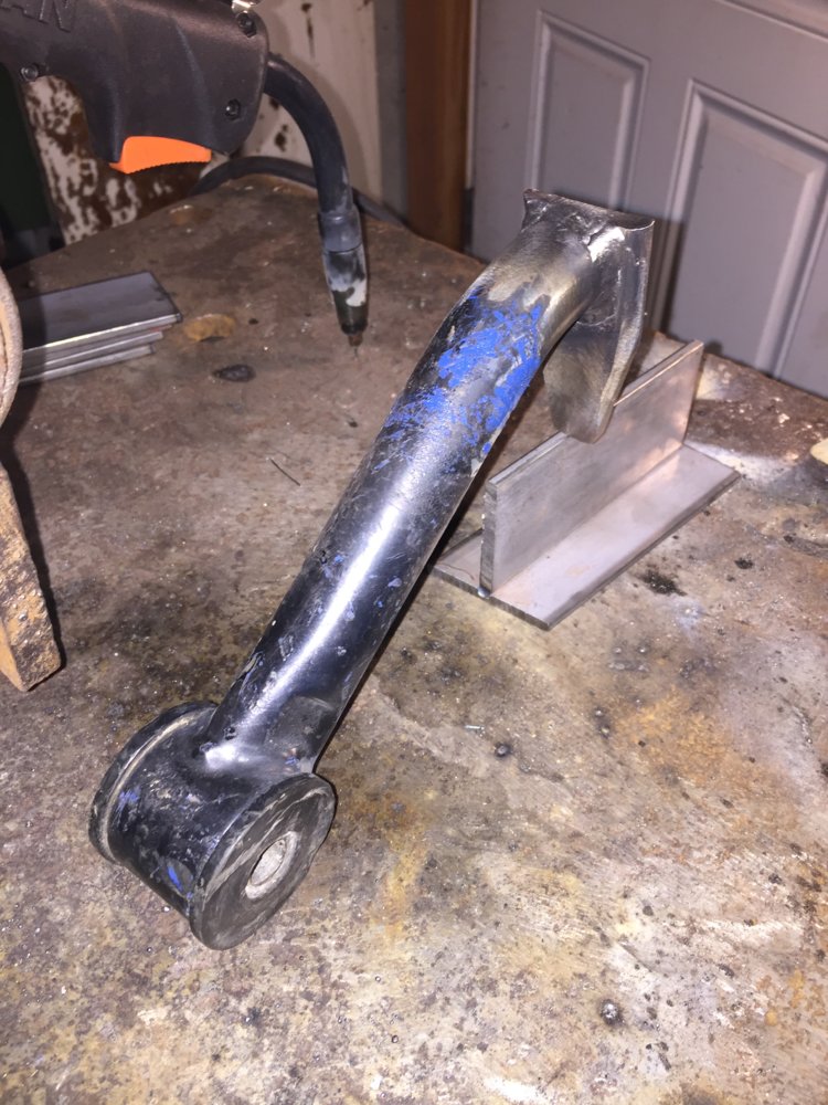

Made a third arm out of some tube I had off old links turned out pretty sweet needed the 220 power but it’s not gonna hold anything up but scrap metal lol
