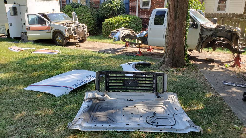

Front yard junk yard Sunday:

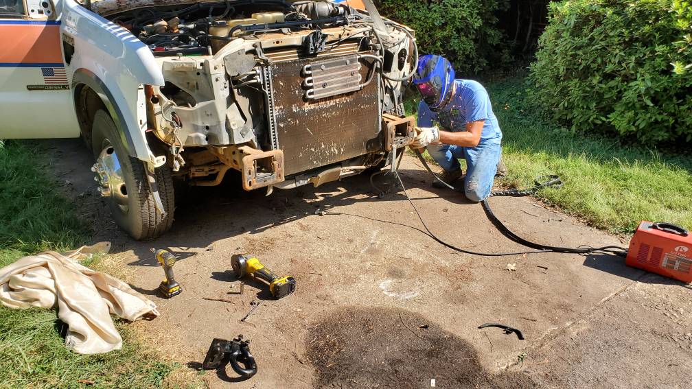

Matt brought the torch for the frame mods. I learned that no plug circuit in the house (theres only 2) is capable of running a 110V plasma. Had to reset the breaker no less than 10 times.

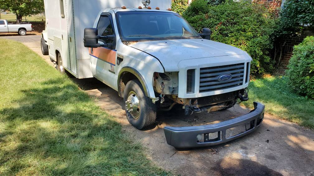

And the bumper isn't going to adapt the way I thought, so I'll have to fab something up. For now the panels are subbed up to measure for some spacers.
Generally, a 100' 14ga. dropcord is a bad idea for that much of a load ;)
My cord has the number 16 on the outside, so that has to be better than 14 right? 16>14?
Joking aside, my mechanical engineering degree says running the plasma off a drop cord would affect the power quality delivered to the unit, but not increase total current draw of the circuit.

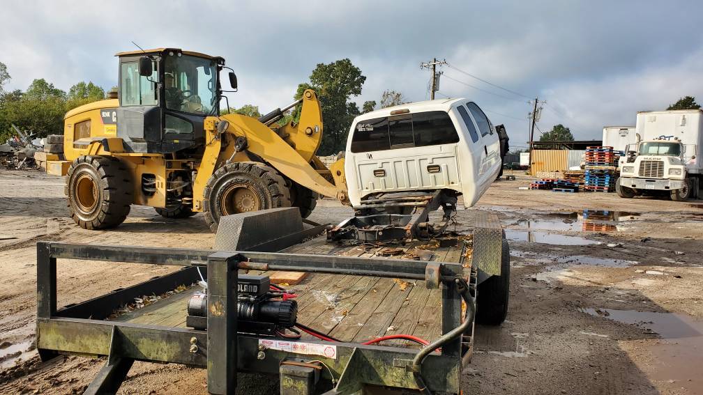

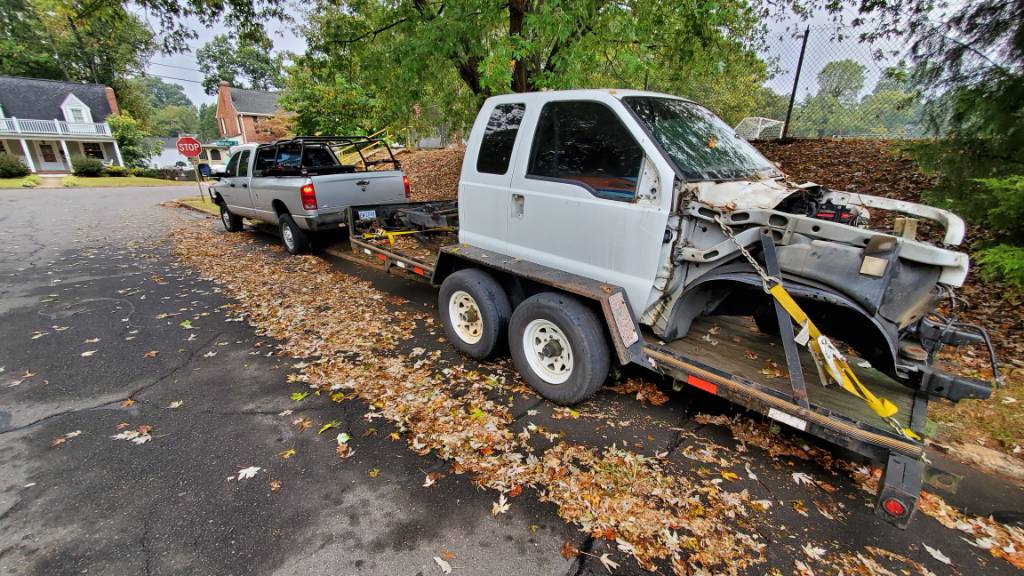

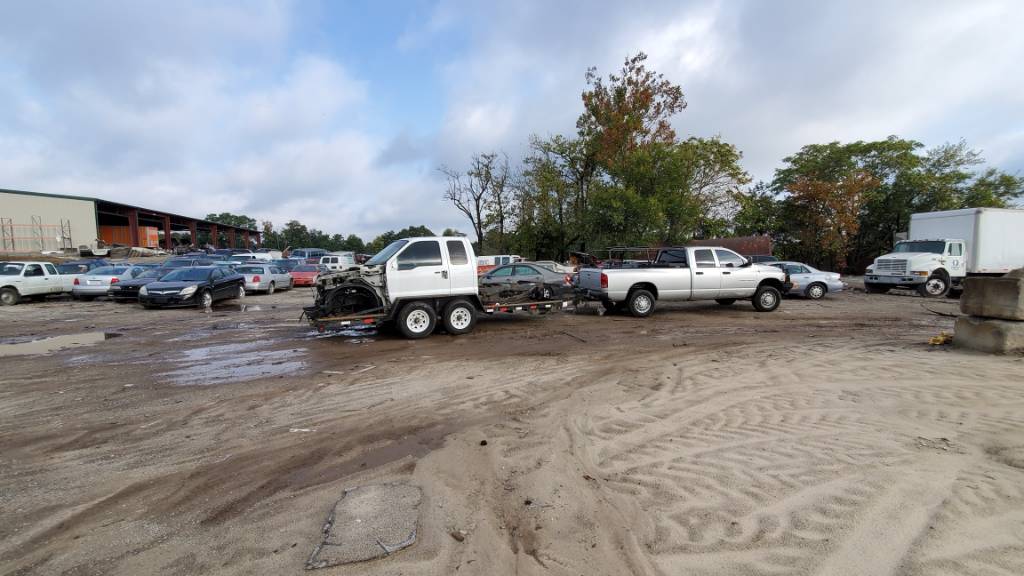

The donor has left the property.
Worth a whopping $78.
