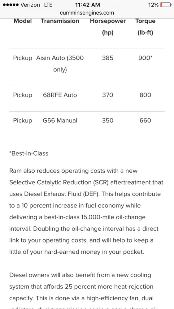

15,000 miles between oil changes? seriously?
I was kinda shocked by it too but that's what's listed as Cummins interval for the new ram trucks, using rotella oil.

Or you could just go by the owner's manual that says every 15k, or every 7500 for "severe duty".
