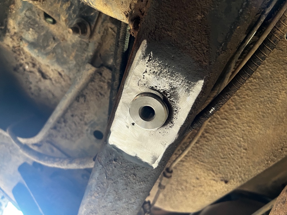

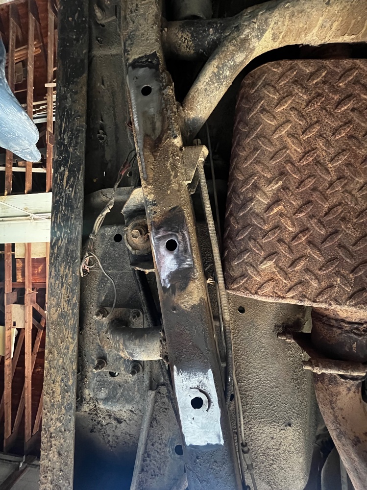

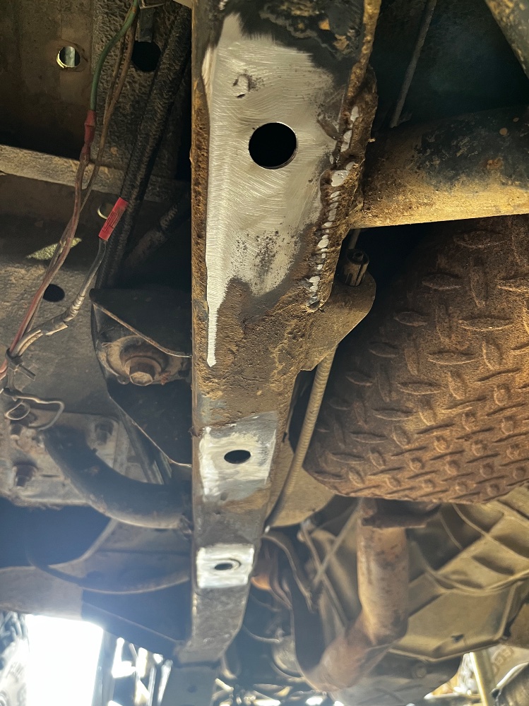

Threads have been messed up in the belly pan mounts for a while. The passenger side was fine but two of the three on the drivers side liked to always work loose. Got them ground out and replaced with the Barnes inserts.

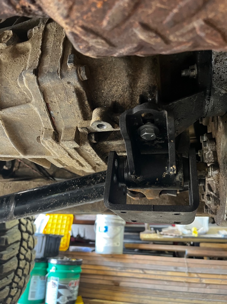

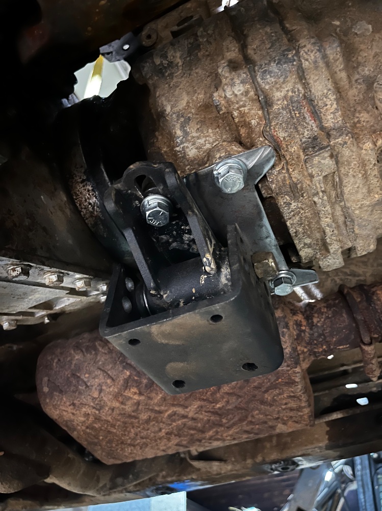

Back during my trans mount fiasco two years ago, we “fixed” it at gulches on the trailer but since the belly pan was off I retapped the holes in the transmission for 7/16 bolts. I still might pull it back off and make some tabs to tie into the front holes too.

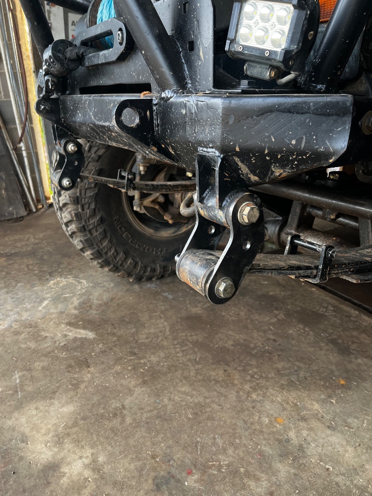

I ran a set of MORE boomerang shackles on the front of my old YJ and for all the years I beat on that thing it never inverted a shackle or even tried to bend a spring. May be a cheap easy upgrade worth looking into.
Oct 2024-March 2026. Thanks for the motivation @Hokie_YJ 😂

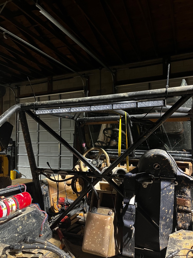

Fresh harnesses, racecar lights then parked the shitbox outside to start deep cleaning the shop from a winter of tractor and jeep repairs.

Did those inserts come out after you ground the tacks or did you have to beat em out

All the recent work seems to have held up great and it rides a million times better with the slightly longer shackles and padded harnesses.
