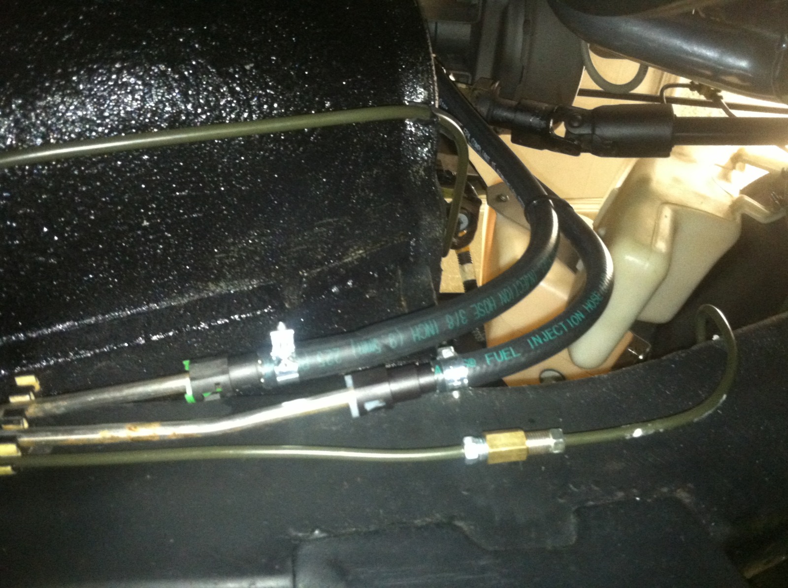

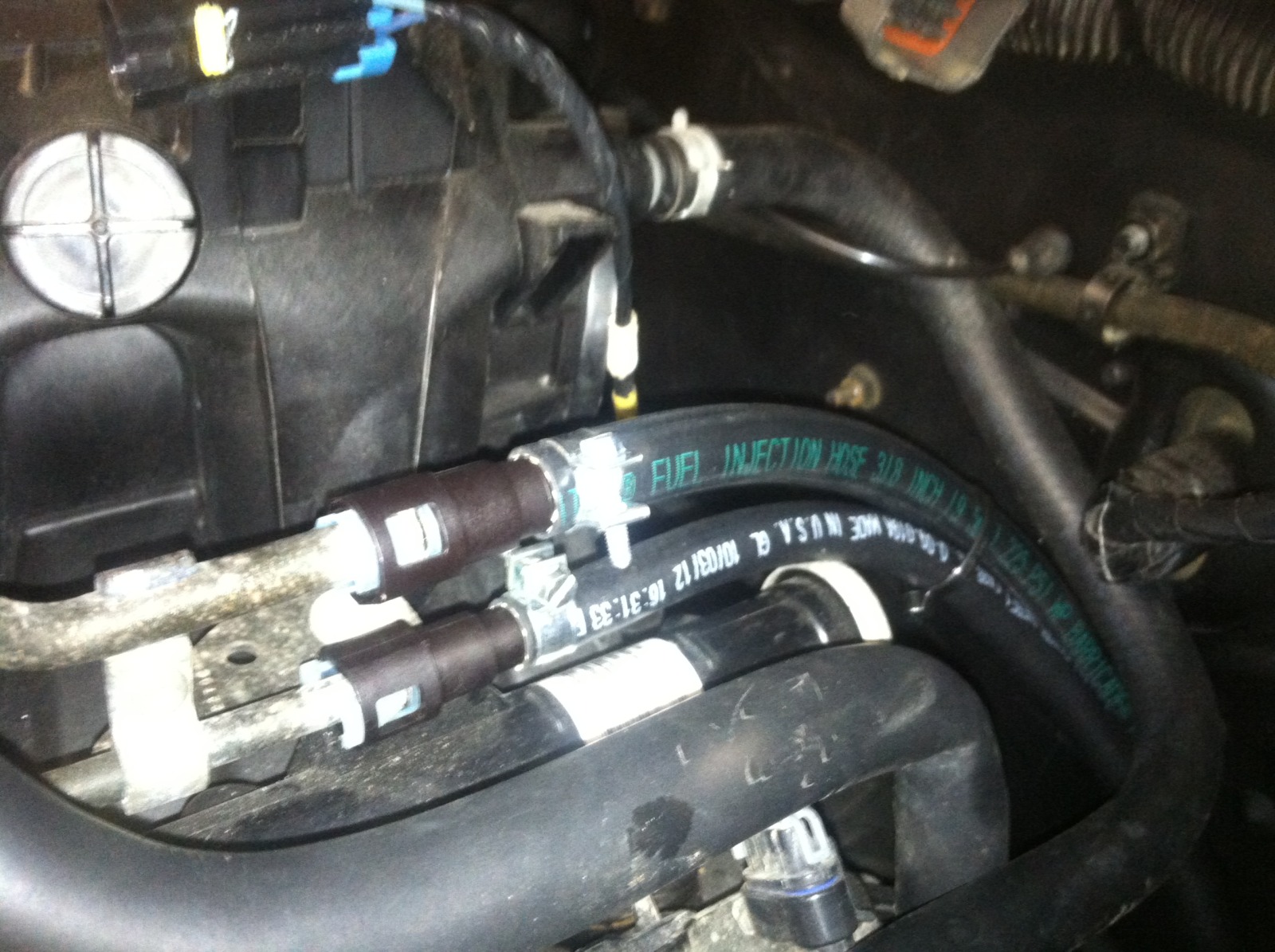

I ran the fuel injection supply hoses from the frame rail up to the fuel rail on the intake. I just made some lines using Dorman QDs, fuel injection hose, and fuel injection hose clamps. The only trick to this was I had to order a QD that would adapt from 5/16" to 3/8" on the supply line since the Jeep supply was 5/16" and the Chevy was 3/8". The return for the Chevy and the Jeep were both 5/16". For those guys who are wondering, my 5.3 is a 2002 so it is NOT a "returnless" engine, it has a regulator on the fuel rail on the intake.

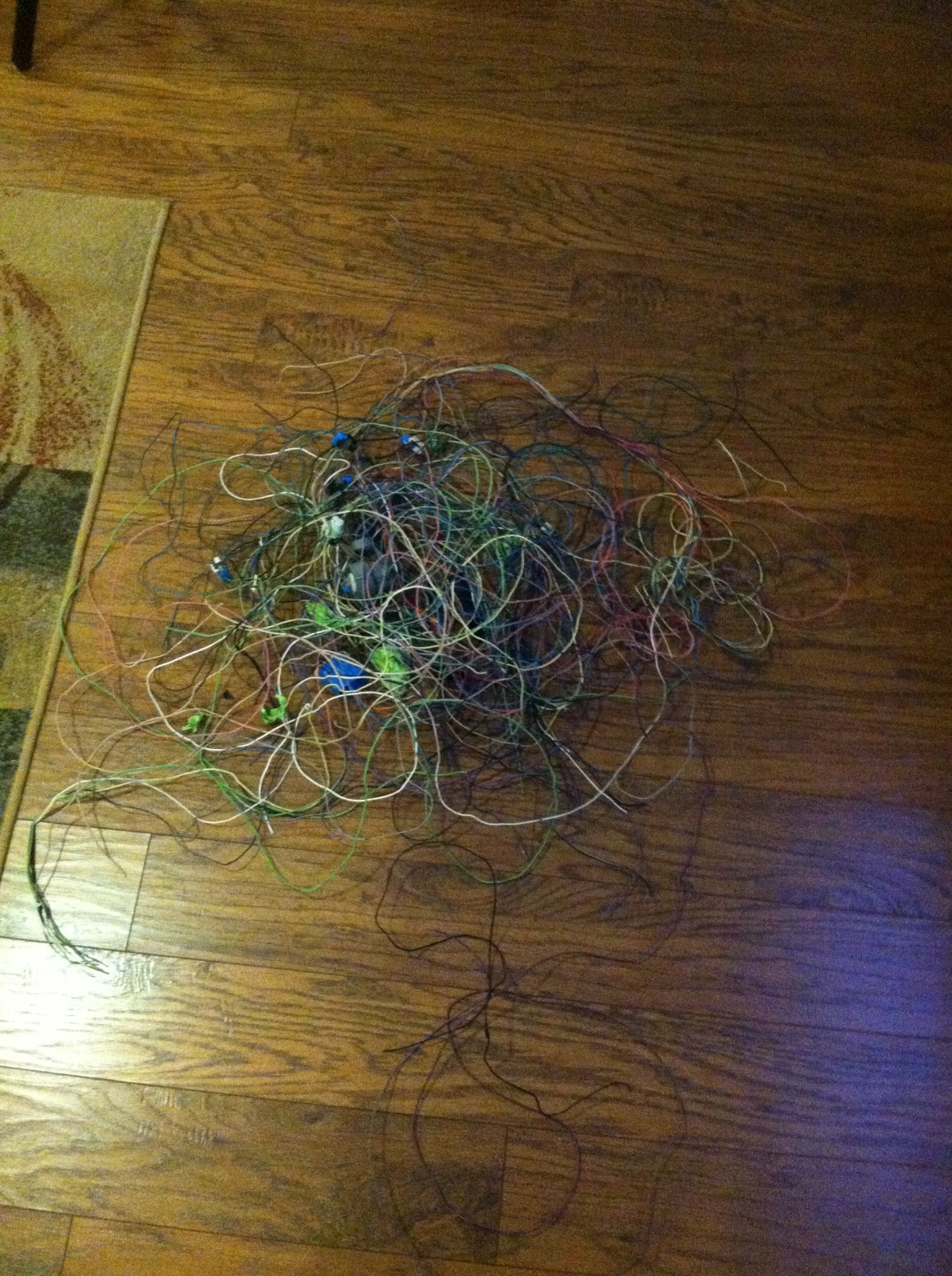

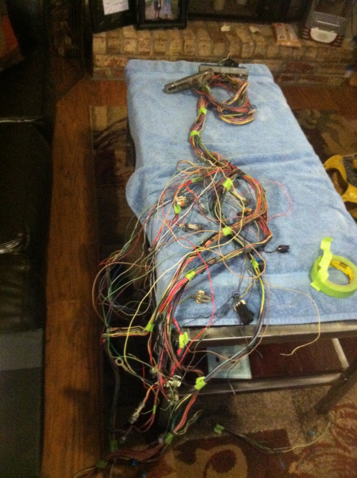

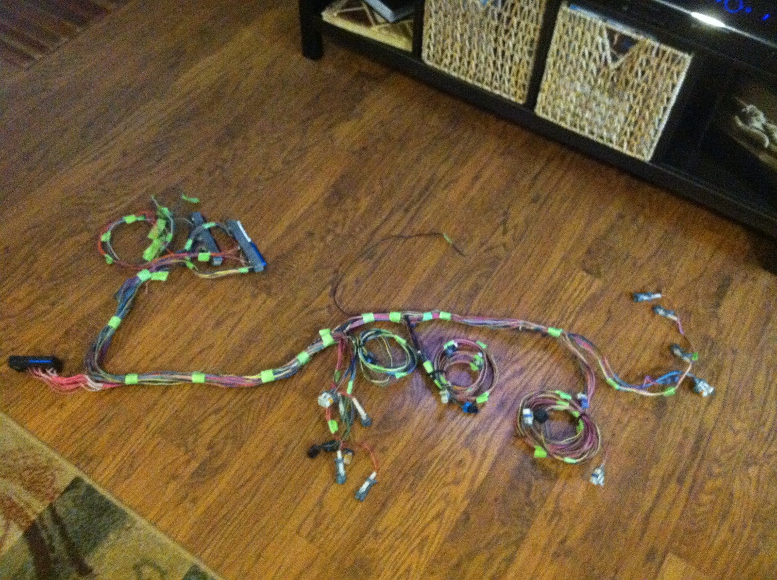

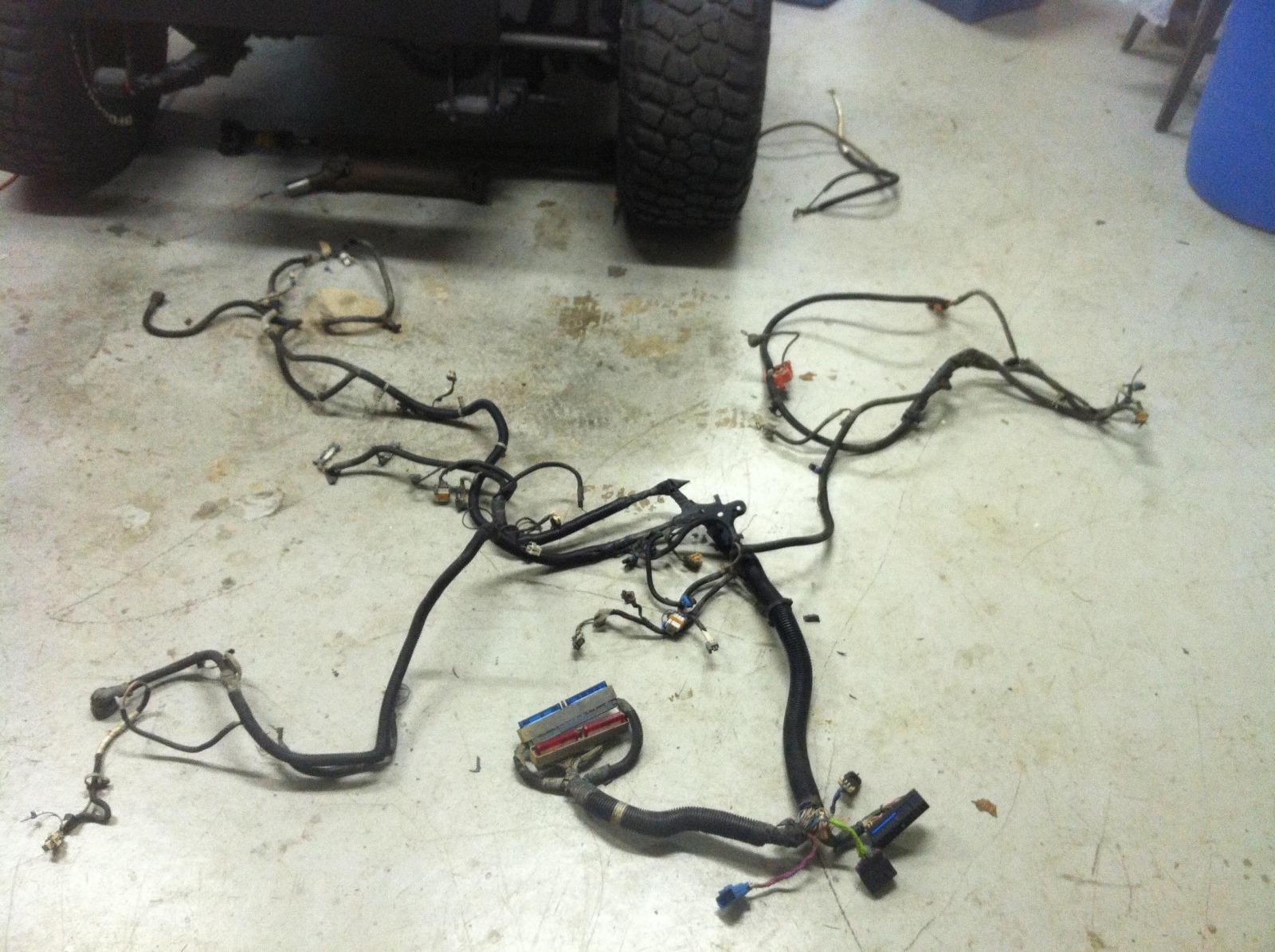

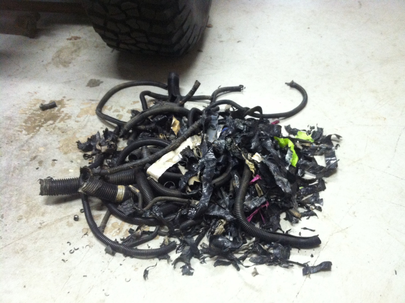

Next I decided it was time to tackle the wiring harness on the 5.3. I decided I was going to strip it down, remove the uneeded wires, and pull out the wires needed to make it stand alone, then rewrap the harness with new split loom so it would look as clean as possible. I have not completed this yet but I did get the wires I don't need stripped out and the wires I need to hook up to battery power and keyed powered pulled out. I also pulled out wires for the tach, check engine light, VSS, Fuel pump, serial data and the TCC brake switch. I still need to either create a small fuse block and relay center or try to tie into the Jeep block. I will tackle that next. Here are a couple pics.
