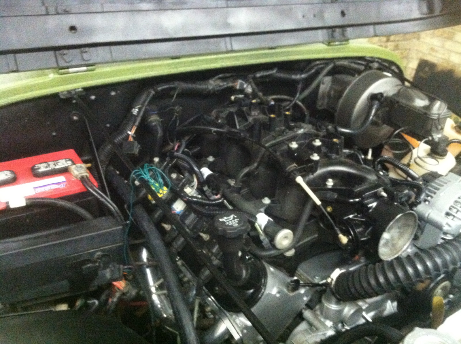

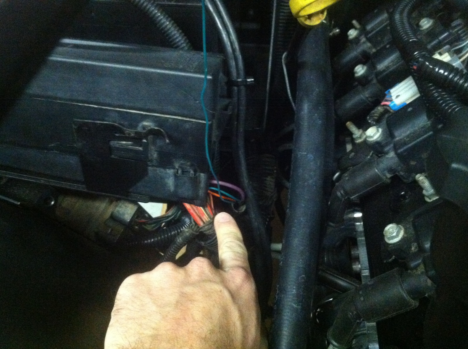

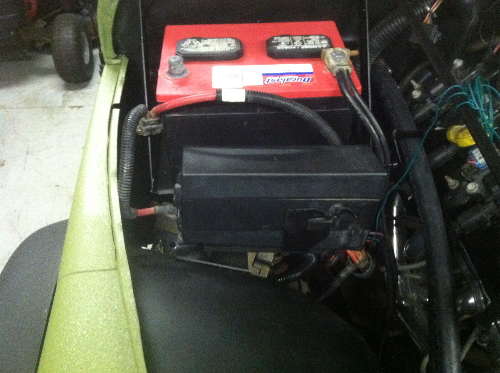

I have not worked on the Jeep a lot in the last two weeks. I spent some time reorganizing my garage/tools/junk laying around to give myself some more space. I did finish wiring the GM Harness into the Jeep using the Jeep Distribution block and Relay center. I rerouted the PCM harness and put the GM PCM underneath the battery on the passenger side. I put it here to kind of hide it because I wanted the install to look as factory as possible. This way you will have to look to find it and it is not “in your face" when you lift the hood. I still have to wire in the OBD II port and then go into the computer and turn off the VATS and disable some things I eliminated. Next up is wiring the Auto Meter gauges and installing the dash.

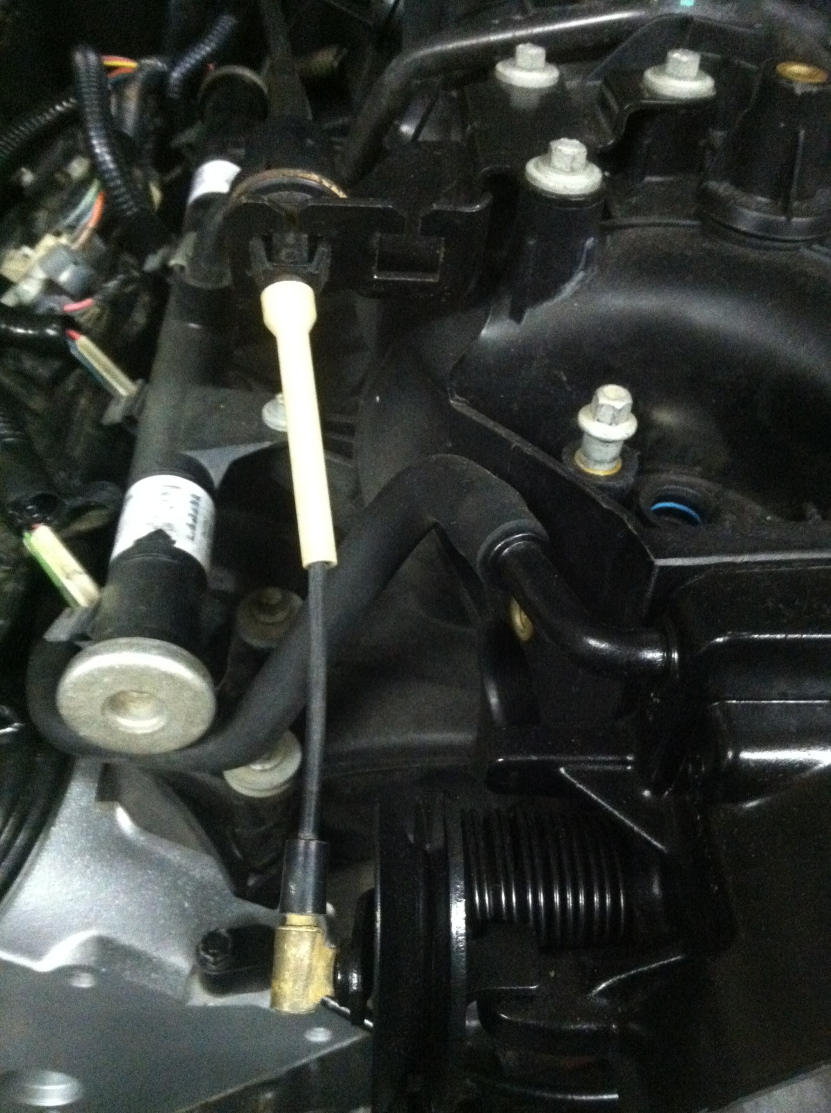

This thing is beautiful. Very clean install. Perhaps I missed it, but what throttle cable did you use?
Thanks man
I was able to use the stock Jeep throttle cable. The only modification I made was to the cable holding bracket right before the throttle body. I filed the circular hole in the bracket that was meant for the transmission cable to a square hole and ran the Jeep throttle cable through it and to the side mount on the throttle cam.

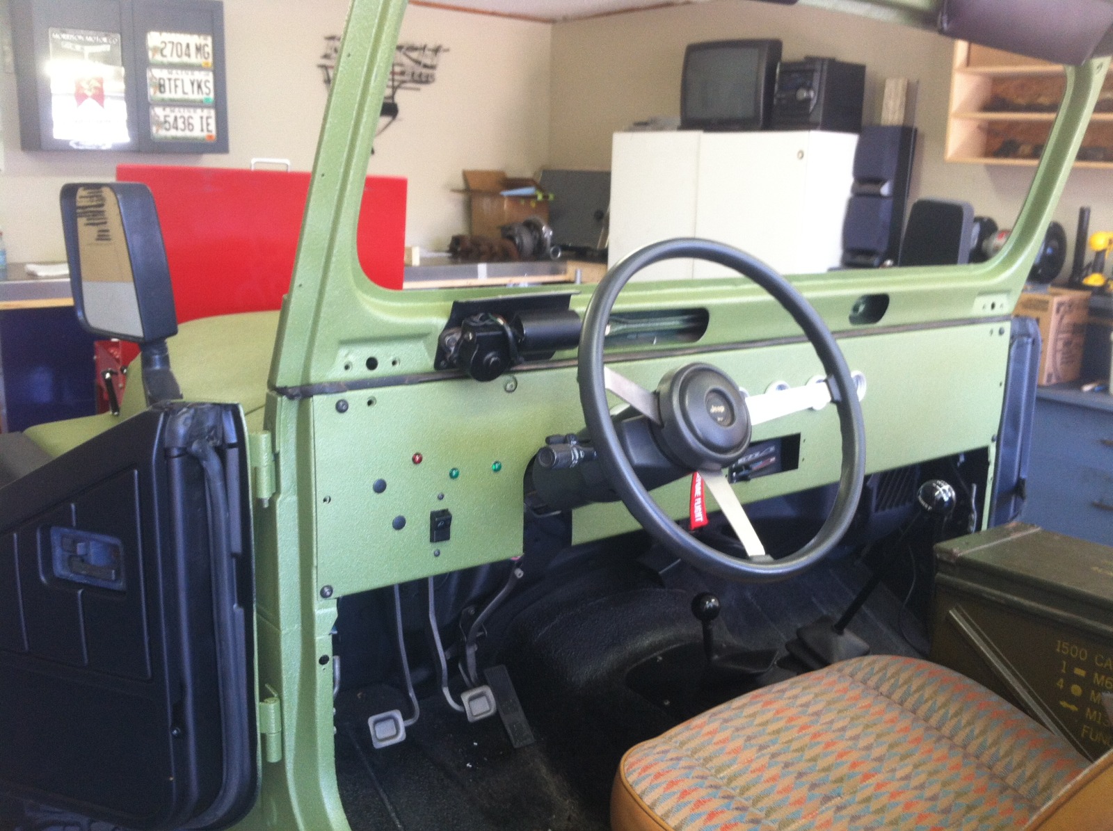

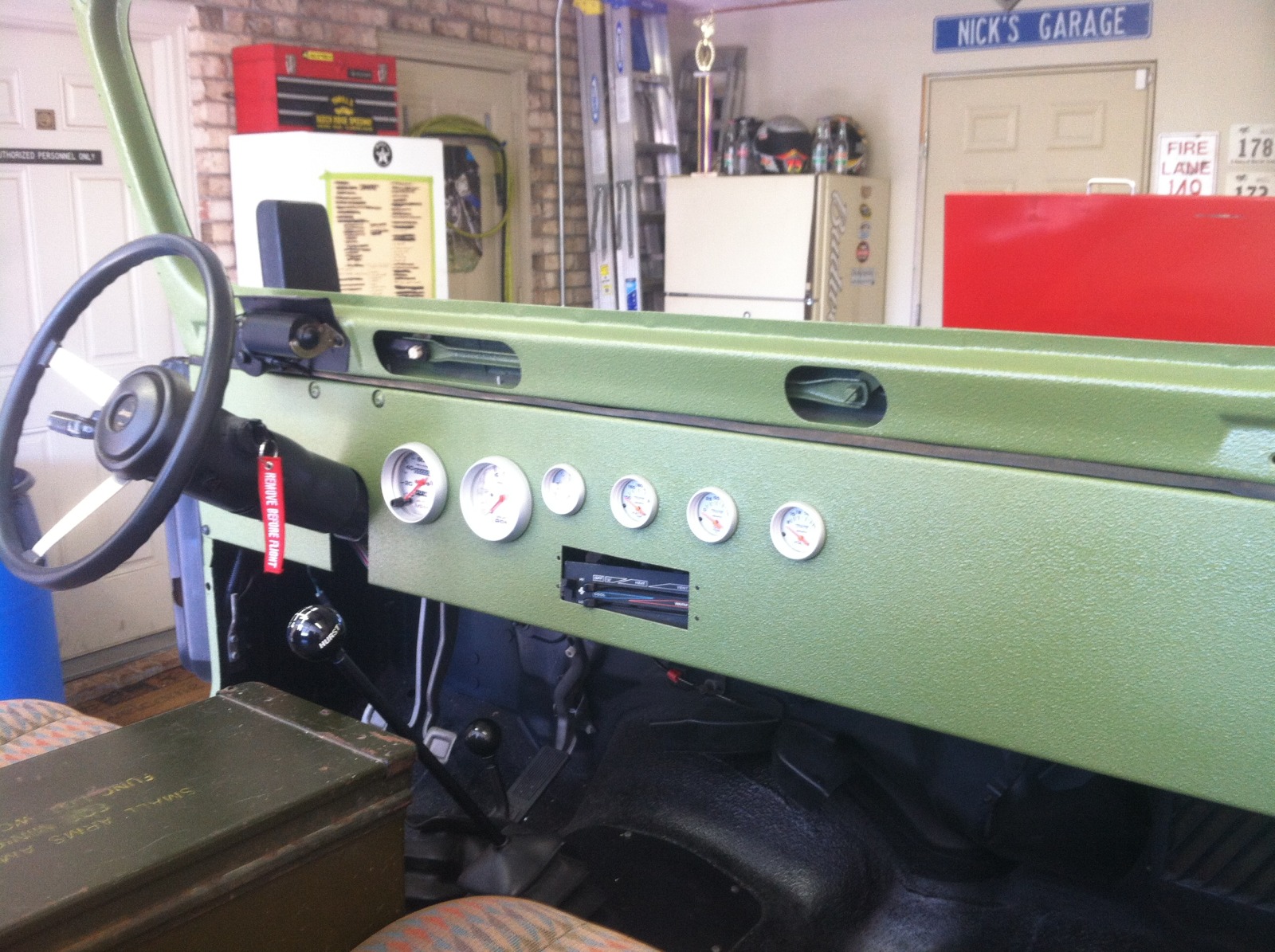

Another small update, not much:
I finally wired up my dash and got my gauges installed. Wired up my blinker indicators, check engine light, and the gauges. I need to still bolt in the heater controls, and hook up the oil and water senders under the hood. The radio will be in the Ammo Can. The Dash is stupid simple looking, just what I was going for.
