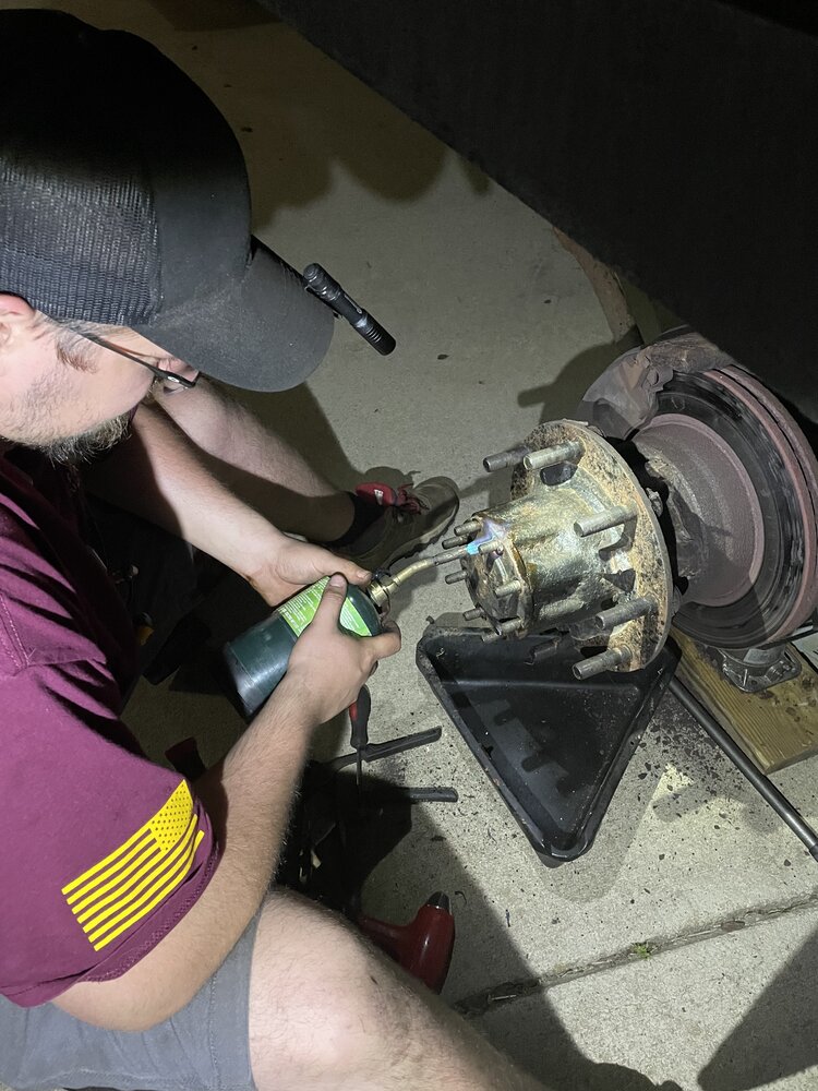

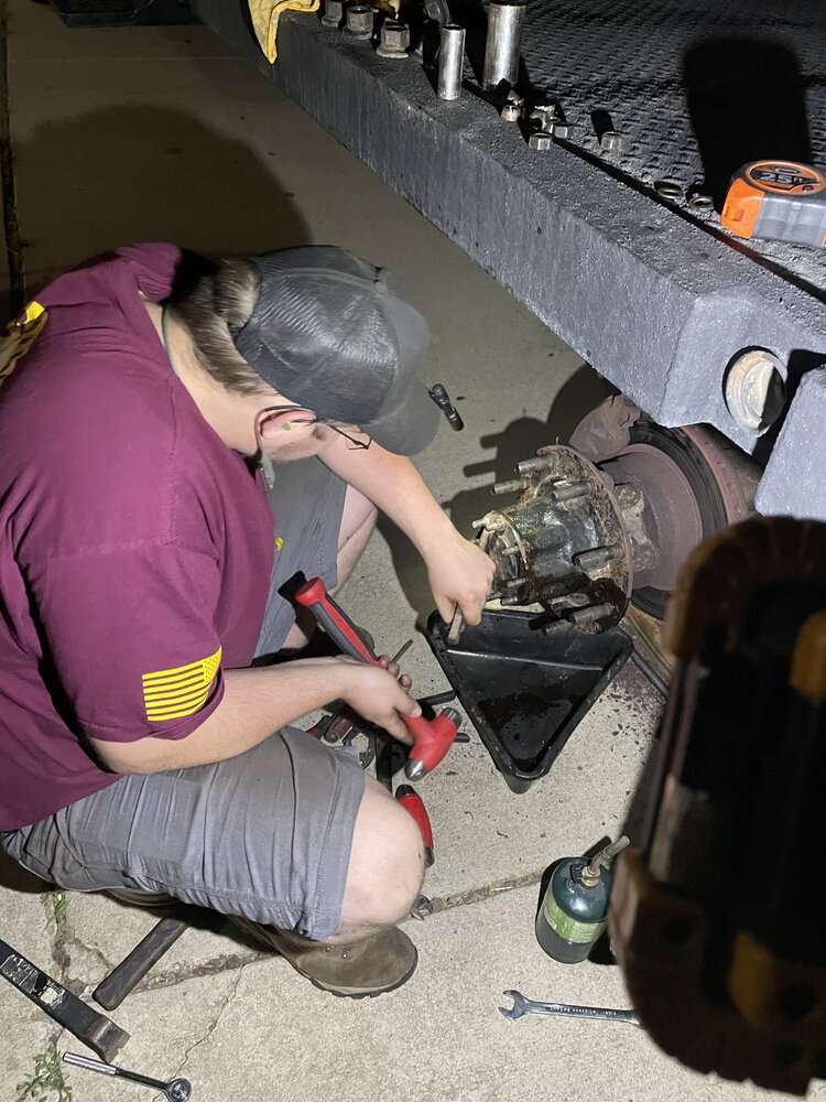

I’m an idiot. I just had to touch it. I got tags today for it and had decided I was gonna use it to haul my junk to The Ranch this weekend.

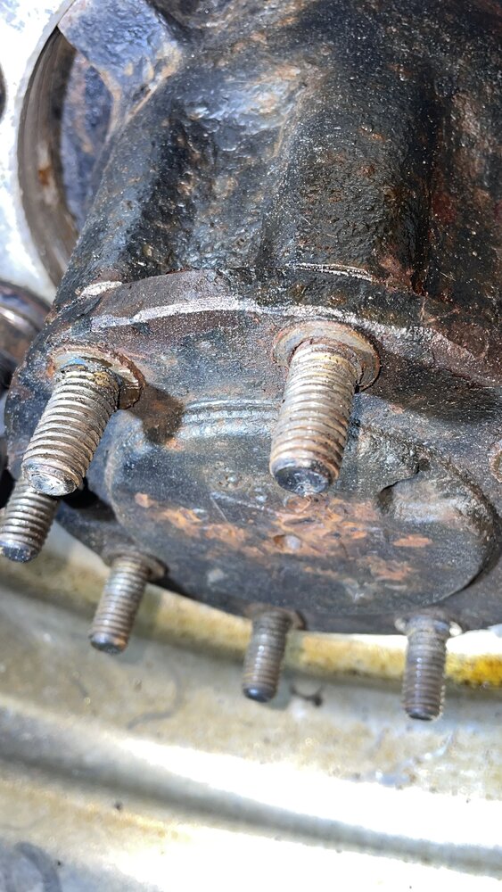

I knew it had a bad wheel speed sensor, the PO told me and said that a few weeks ago he and a buddy tried to fix it but realized it was a little too much and they didn’t have the right tools. In the process they’d broken the seal at the axle flange, so the hub was leaking just a little bit. No big deal, I’ll just pull the shaft, clean and reseal it. Wrong.
Dang thing has cone washers with studs. It’s like a giant 14 bolt, on steroids. I had no idea what I was doing so I called @Chris_Keziah for advice, he offers to ride over and we can knock it right out. Wrong.
We get all but 1 of the cone washers out and one was totally fubar. It’s now beat flush and I have no idea how to get it out.
I am thinking maybe tomorrow I can find some more cone washers and just put 7 of them back in and rock out, so long as it doesn’t leak any worse than it did before, which was very little.
I’m also going to have to invest in a Milwaukee impact and a socket so I can even take the wheels off.
Just curious on that cone washer. Could you remove the stud on the one that is stuck? Or do the washers lock in the studs?
sometimes you can put a socket that is larger than the cone washer over it and beat it with a hammer. That can shock the axle shaft enough to rattle it out.

I also thought that a air hammer with a flat punch would rattle them out?
That might work, but he ain't got any air. Tried to pull the stud but it was dumb tight and was not trying to break it. Looking back it may be easiest to to weld a nut to the stud and back it out. @Jody Treadway method would definitely work and I'm going to have to make a thing for my slide hammer for future work.
This and some penetrant and possible heat cycles. The washer will bounce out of the taper done right. All beaten to death and deformed will aid into it biting the other surfaces...mostly the thread. This is also where she is probably hung. The rest is no more complicated then a machined taper on a spindle or tooling. Get the threaded portion to break the rest will separate.
Back off the nuts 1 turn or 2 then do a couple neutral drops to shock load the shaft and break the cone washers free. #themoreyouknow
