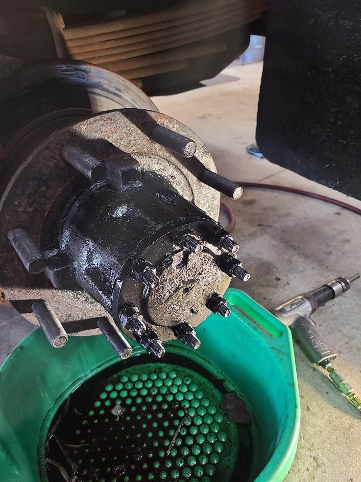

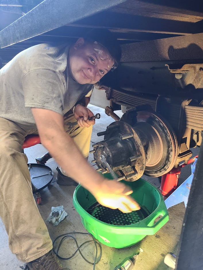

Victory to that bitch ass cone washer. Ended up having to pull the stud to get it off.

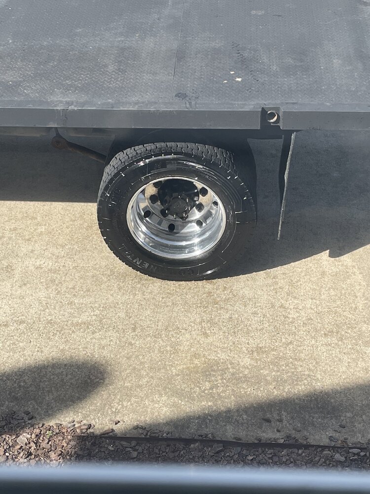

Hit the hub with a little rebuild in a can. Phillip also laid a quick polish on the wheels and they look tits now.
So i talked to my buddy that works on big trucks about those cone washers. He said loosen all the nuts a good bit, but leave them on to protect the studs. Wail on the center of the shaft with your favorite bfh with a long handle. A 5lb or 10lber. It will bust them free.
Yeah that and similar methods worked well, except for the one lol.

I hate I'm too late but there is a special tool to get the conical washers to unseat on a big truck axle shaft. Most of the time when they are stuck like yours, only two methods work, the special tool/ striking it with a large sledge hammer or taking the studs completely out. If anyone is curious look up the Kiene diesel axle shaft puller, it works awesome, and also keeps you from having to fight with striking the shaft with a large sledge hammer and not striking anything that you don't want to like the studs. While I know it's not a feesable thing thing for most people to buy for 1 time use, just know it works great and saves a crap ton of headache. I've had two just this week at work that were the same PIA on reasonable newer freightliners, that tool handled the problem both times.
