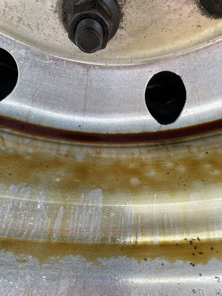

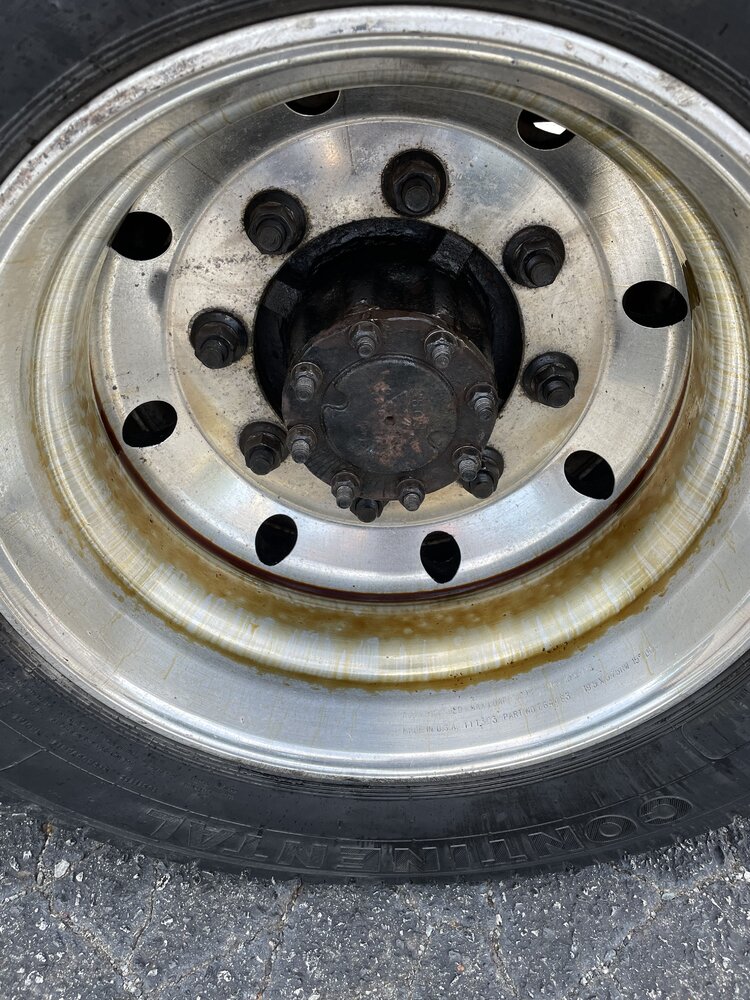

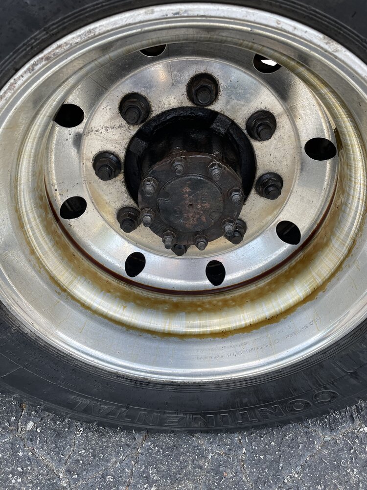

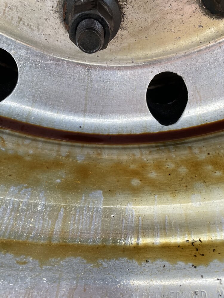

We tried the reverse/drive method last night hoping it would free the last cone washer but had no luck.
Today I found new cone washers and put it back together in hopes it leaked the same as before, but no luck. A short 10 minute drive made quite the mess, so it cannot go to The Ranch now.
Probably has a gasket, paper type or something thin. Its disrupted so no matter how many cone washers you have or the amount of uggah duggahs its gonna leak.
Worst case best bandaid is supper clean surface and a heavy bead of RTV stuff around the flange. The housing should not build pressure. The oil is distributed by the turning action of the shaft. I'd still check for a clogged vent. A short drive shouldn't make heat or pressure so I'd lean toward a seal on short trip oil slinging.
Yeah that’s what it is, which is why I was trying to take it apart. Thought I’d just quickly freshen up the seal, not was I wrong.
I found the seal online, and the coke washer at Napa so next week it will go over to @Chris_Keziah to be fixed.
