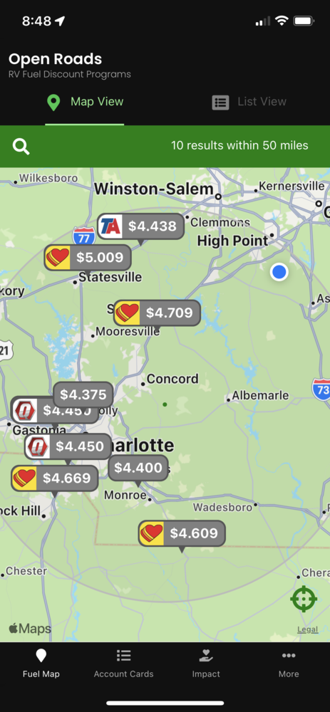

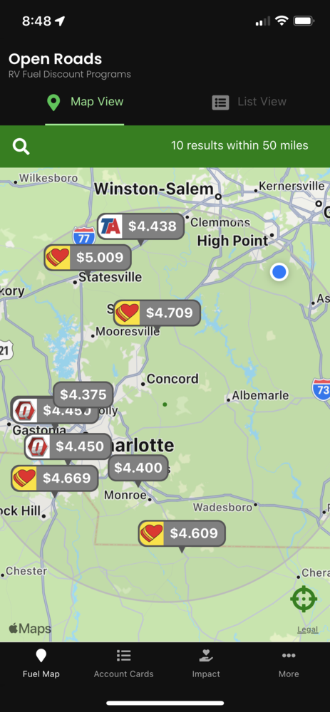

It’s not a credit card, you have to give your bank account info and SSN. Online application is easy, it will say that it’s being submitted for approval but then it just shows up in the mail about 7 days later. Link the card to your app, you get instructions on how to use it. Then in the app as seen below, you can search out the best prices in your area or along your route. They charge a $0.65 fee for each fill up.

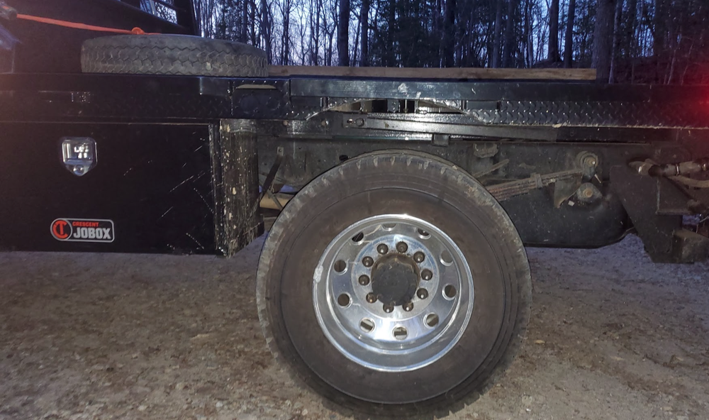

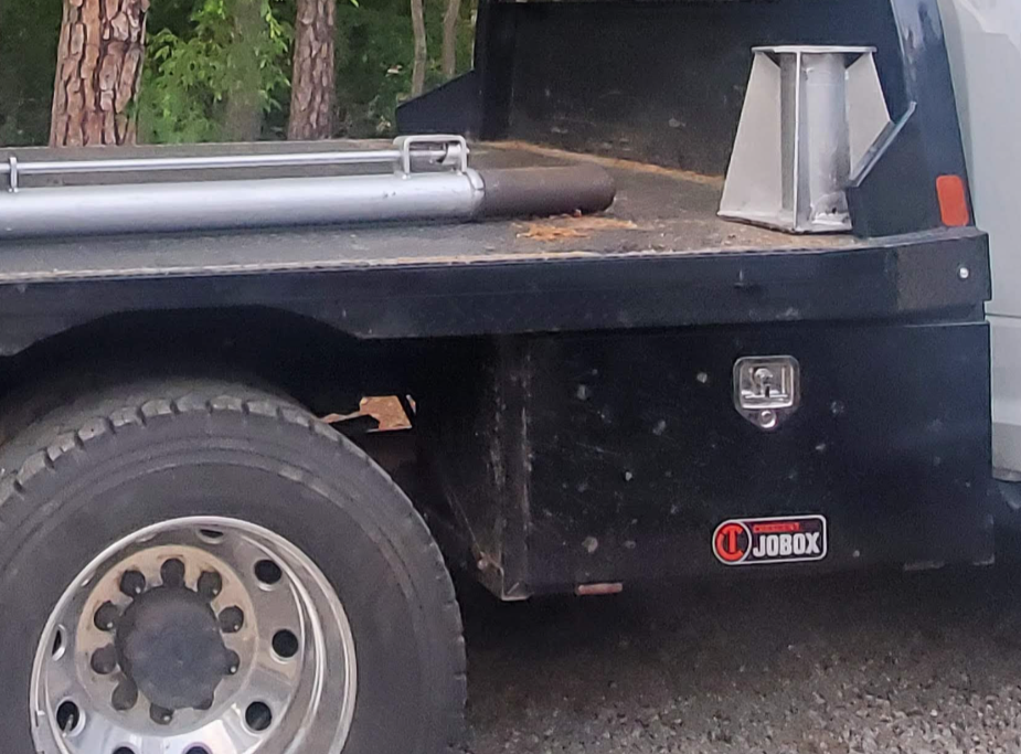

I’m also going to be ordering the underbody box that @jeepinmatt linked in here. I really need two but will start with one. I also need to find time to wire up the flatbed lights before I move out of this house but I just don’t know when/if I will be able to do that.
Go ahead and buy 2. That way they are already keyed alike and you get the hassle of mounting out of the way while its still fresh.

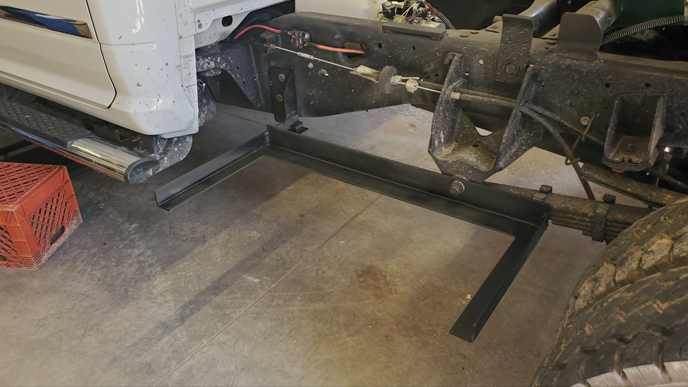

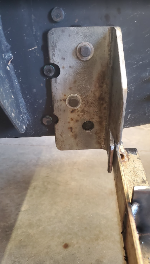

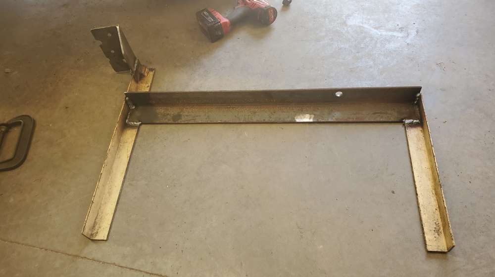

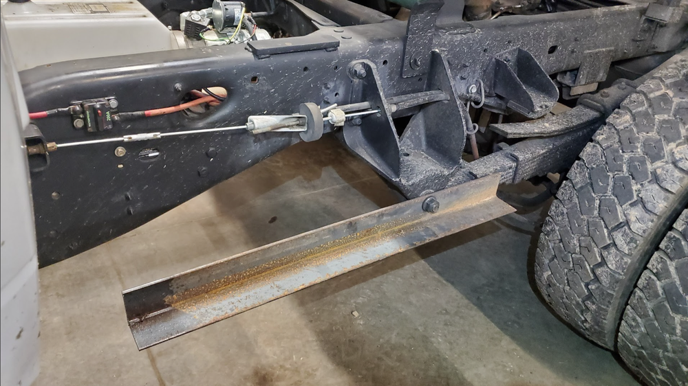

They also sell mounting brackets. For my application, I did not see them as useful, but they may work better since you have more framerail. Here's what I did:
I also put a diagonal strap at the front and rear of each box, and bolted it through the inside of the box for security and stability, but didn't take any direct pictures of that:
Your tool box mounting bracket looks just like my little trailer ramp catch. Weird.
It has shitty welds too? :laughing:
