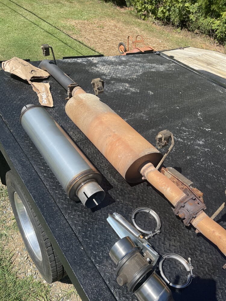

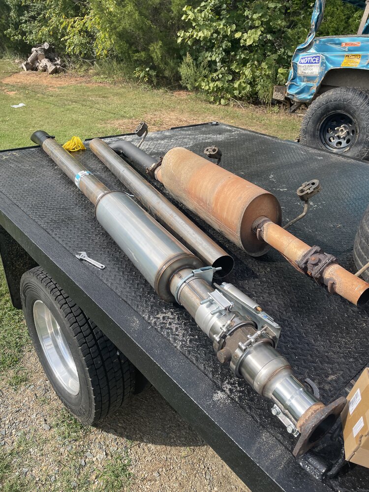

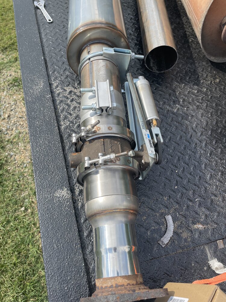

Most of my exhaust parts are in. The rest are due next week. Just some hangers and clamps, and some 4” pipe with a turn down.

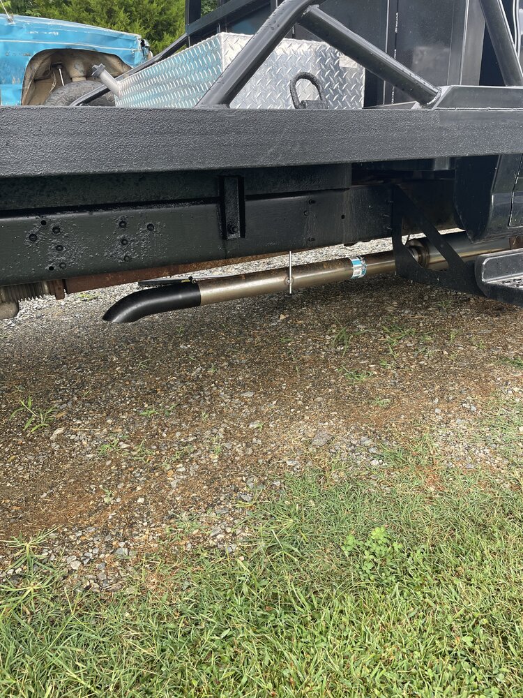

Got the exhaust done today. Very happy with the muffler @shawn recommended. It’s not nearly as loud as it was straight piped but still has a nice rumble to it.
Just need to get the air compressor mounted and plumbed in. I have 5’ of 4” exhaust leftover, I may extend it back further later. My trip to Ivy Branch soon will determine that.

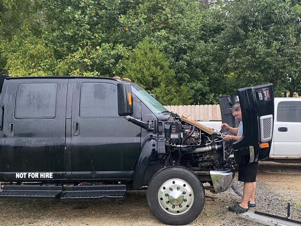

wife came outside and said “you know it’s raining right?” as if I didn’t know. I was soaked from head to toe. Soon as I got balls deep into replacing the AC condenser it’s started raining but I just stayed with it.
I don’t know if I ever explained what was wrong with the AC. I thought it was the schrader valve leaking so I replaced it, which was in fact leaking a little. But I quickly discovered a hole in the condenser when we charged it up. It turns out it was my fault from when I had the intercooler out for cleaning. When I put it back together a trans cooler line was touching the condenser and it slowly rubbed a hole into it. It didn’t show itself when we put it under vacuum cause it pulled it against itself and the pump overpowered the leak. So now that’s replaced and ready Be recharged.
