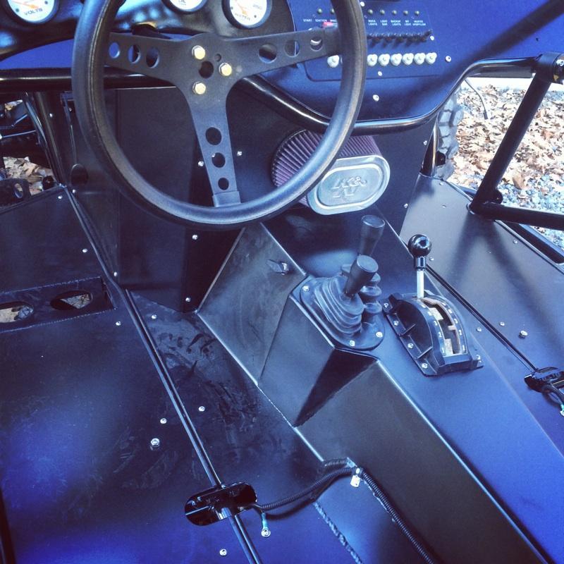

Idea is great, the sound will drive you up the wall!!!
just a bump for the in-cab filter....
mine is this way is and it's not bad at all. little noise before it's warmed up, but fairly quiet after that.
