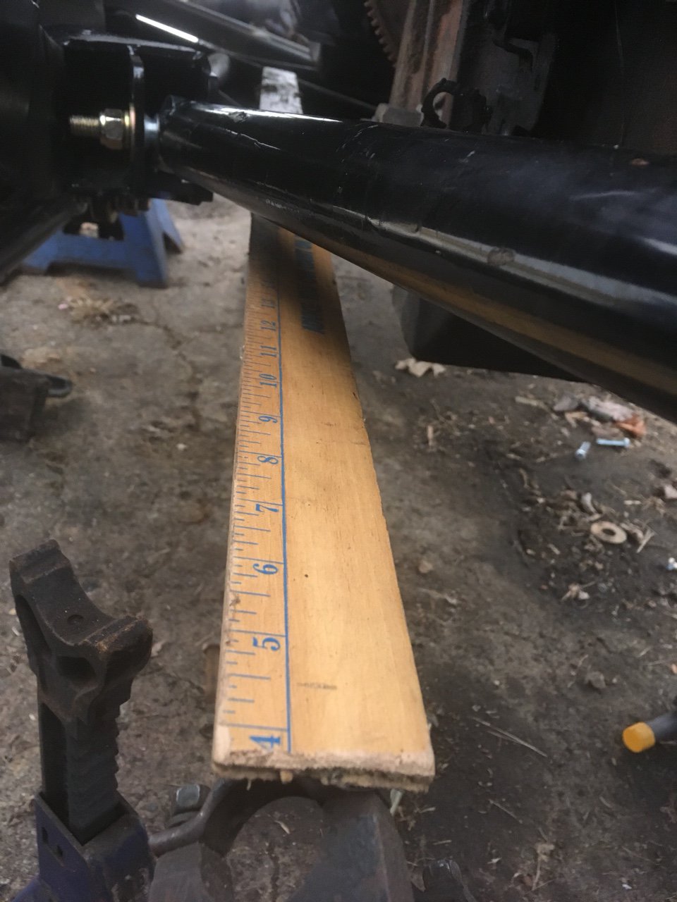

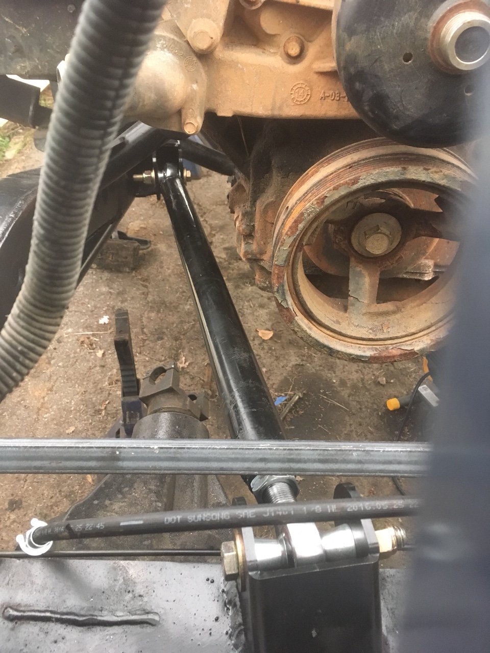

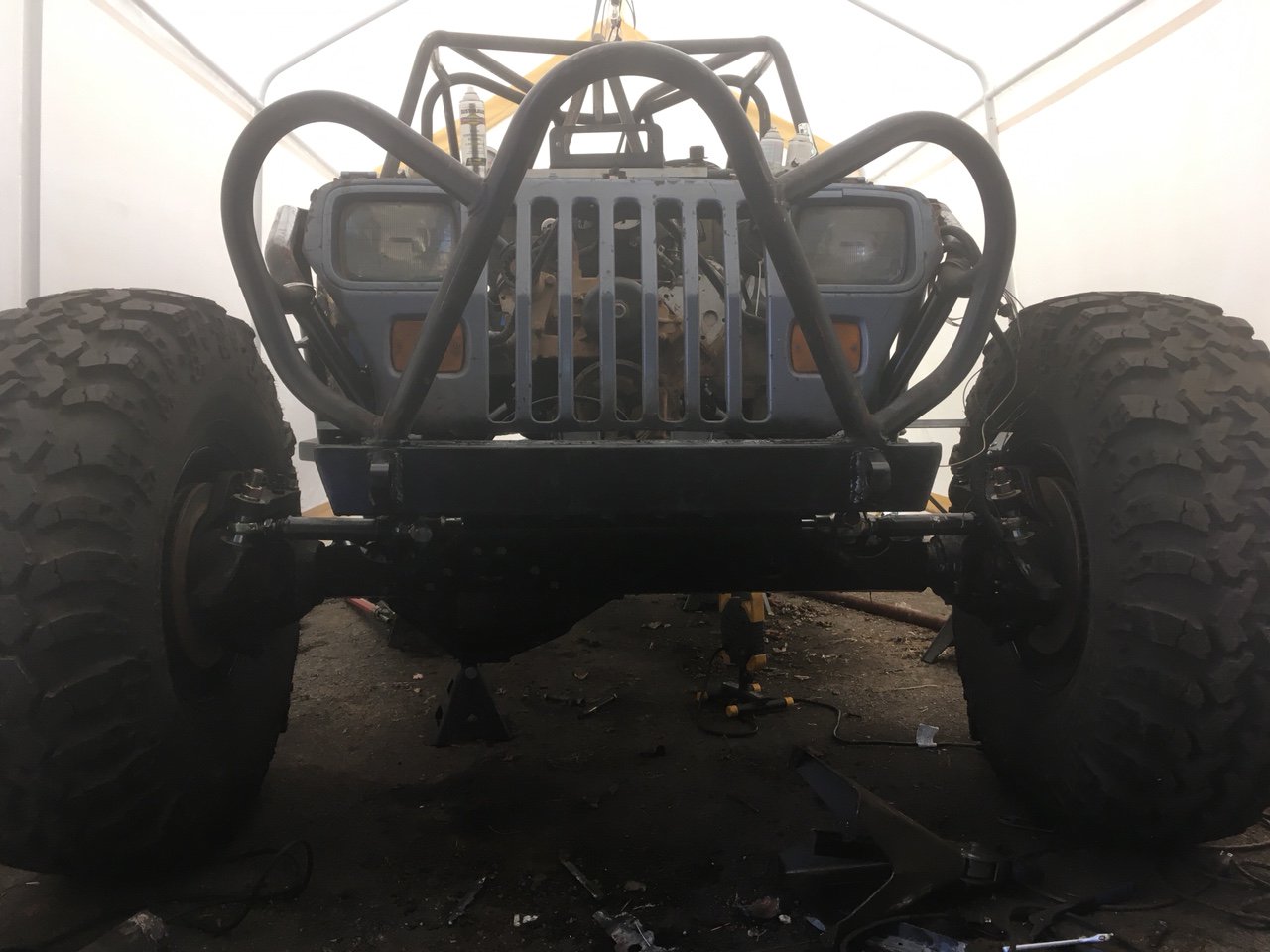

Finally got the front axle back in and everything tightened up. The front is sitting on the frame for these pictures, I’m thinking I will need 1/2 to 3/4” min higher. Belly height right now at full bump is 18”.

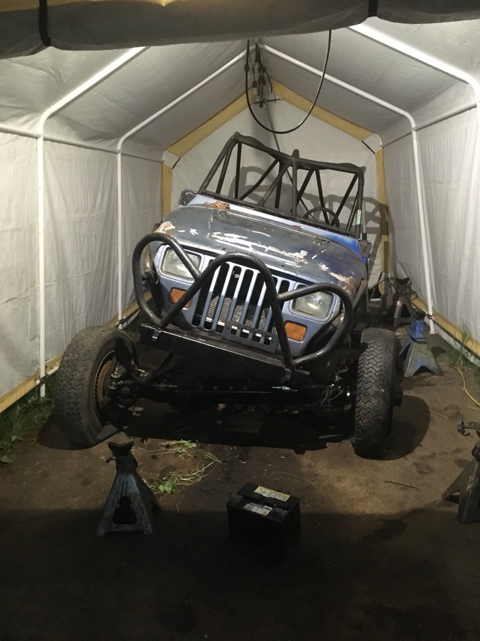

Pissed off at the Jeep throwing it in the back yard tomorrow till I figure out what I want to do and have some spare cash to throw at it. Rear lowers are 39” long giving me a 126” wheel base right now. reusing the lowers and uppers that are on the jeep it looks like my uppers are going to be longer than the lowers. Have a set of the inside the frame upper and lowers from Barnes that I planned on using but that would require me cutting out and possible losing my rear cross member and back most part of the belly skid which I don’t want to do. At this point I may cut the whole back half off and start from scratch.

Picture of it half way down to move tomorrow

Don’t give up BTL! Take a step back and figure out how you want it to end up. Sometimes cutting the old shit off and starting from scratch ends up being cheaper and quicker than making what’s there work for your needs.
Finding a passenger drop / ls full tube buggy chassis with links may end up be what I look.... idk yet just depends on how some things go
Tomorrow I'll tell you the same thing I did on page one.
Cut that gomme (sp?) off behind the passenger compartment. Set the rear axle to 1xx" WB. Then place the lowers where they fit appropriately and are nearly parallel. Have your imaginary friend hold the uppers in place and make mounts on the chassis.
Then finalize the tube work, wheel and do it all over again like we all do.
Taking a break is a part of it man. But develop a plan and stick to it
