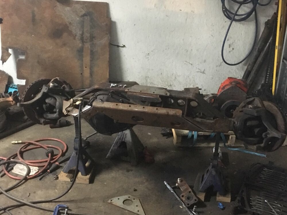

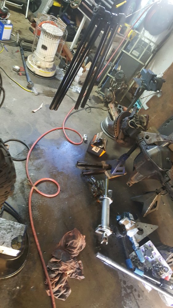

Suppose to help a friend on his house today but he was sick so I worked on the jeep for a bit. Got the front axle truss welded up new king pin bushings in and high steer arms back on, and diff cover on. Need to get the ram mounting figured out and the front axles is ready to get the link mounts figured out and welded up

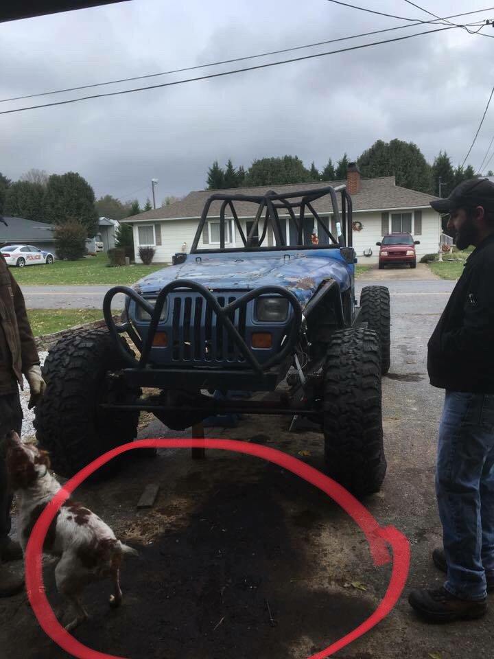

I just make sure there's plenty of dirt or grinding dust on the floor when I paint, that way you can just sweep up the overspray and it's like it was never there.
Not all of us are pro's... some of us just like to get shit done.....

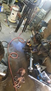

ya didnt get much done but make a mess.... didnt think 6 degrees and paint dont work well. even in the garage at 50 it took two days for the links to dry.... but damn they are looking.... decent but the whole buggy will look good once its painted
ya well it was on the wall, door, tires, welder, heater, toolbox, brand new drive slugs, tools, pretty well everywhere i should have thought to cover up
lol well at least your making headway

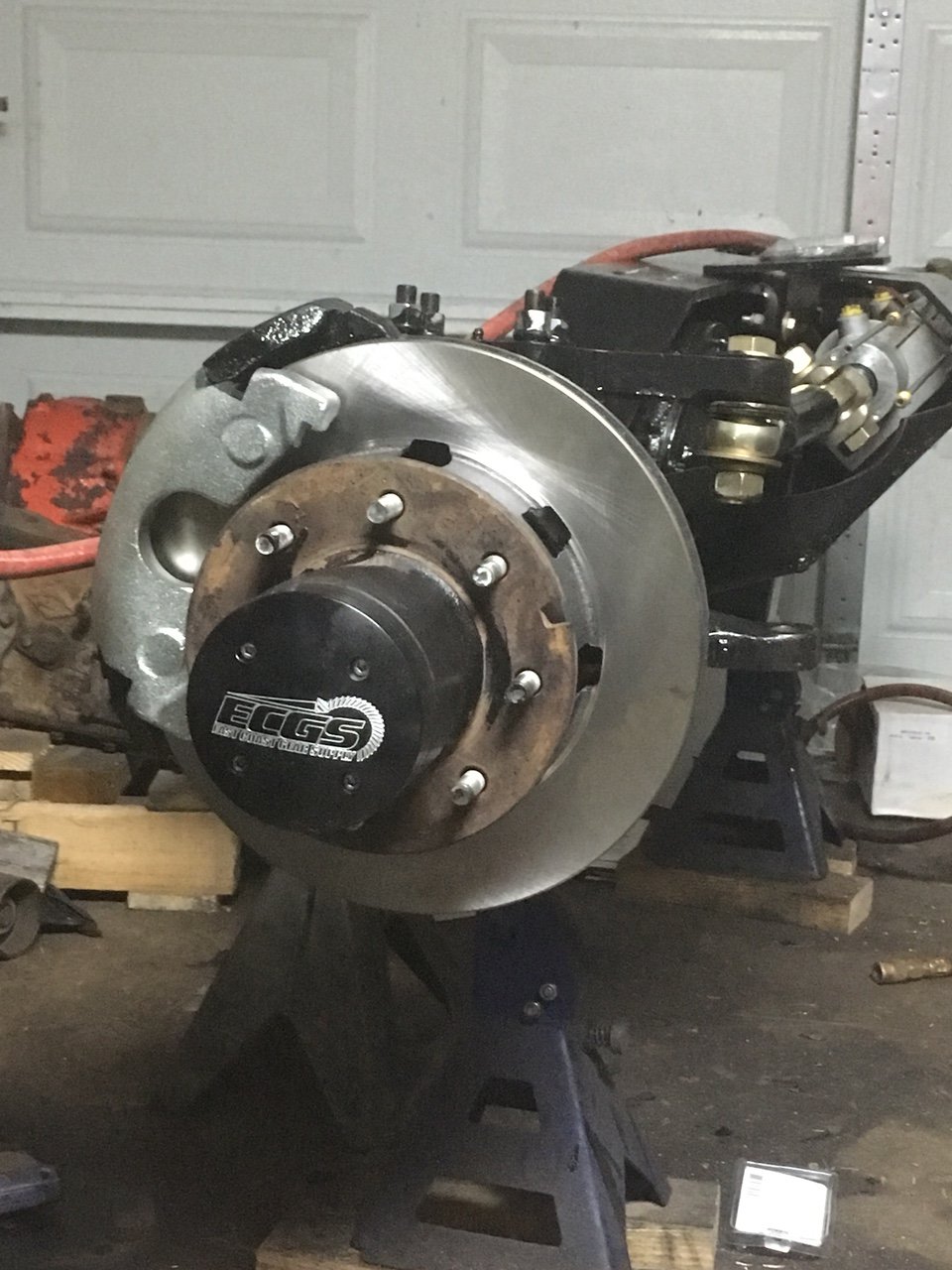

Finally making a little progress. Got the truss finished ram mounted everything painted. I repacked the bearing changed rotors and axle shaft on the short side tonight chromoly shafts with super joints went in, dang parts house gave me the wrong pads so will finish other side and put pads on tomorrow. I’m trying to do everything I can so once I weld the axle mounts on I don’t have to mess with the axle again. Brake lines will also be ran when I pull the axle out for final welding on the mounts
And yes I’m going to run the ram in single shear right now but no it’s not done I’m waiting on some spacers from Barnes
