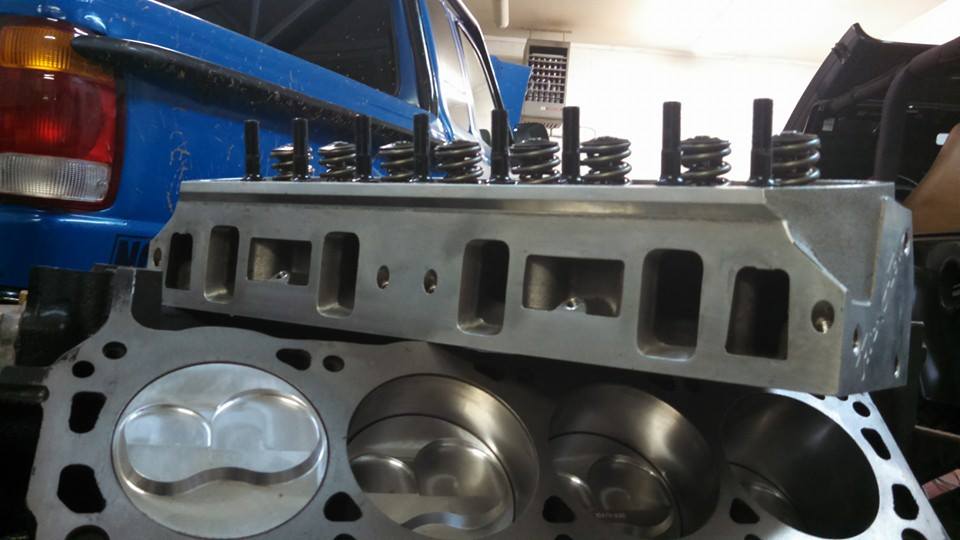

I call the car WARHORSE because I have spent a war pension on building it! I am building it the way I have always envisioned. 2003 model brakes with 4 wheel disc and 93 cobra master cylinder. 17x9 Saleen SC wheels and Dunlop tires. A forged 306 with every nut and bolt ARP. Trick Flow twisted wedge heads. Motorsport E Cam. Ported exploder GT40 manifold. 24lb injectors with matching BBK MAF. 1'' Phenolic spacer. 190 LPH Walbro pump MSD streetfire Distributor. Moroso ultra 40 wires and NGK plugs Full array of autometer phantom gauges. QA1 tubular K frame and UPR coilover suspension. New Monroe struts. (not a drag car build just a quick street coupe)

Engine sits assembled on the stand waiting to be installed along with the 03 brakes wheels and suspension. The paint has fought me the whole way. I am only able to work on the paint and body Wednesday after work and on the weekends and we have took several weekends off.

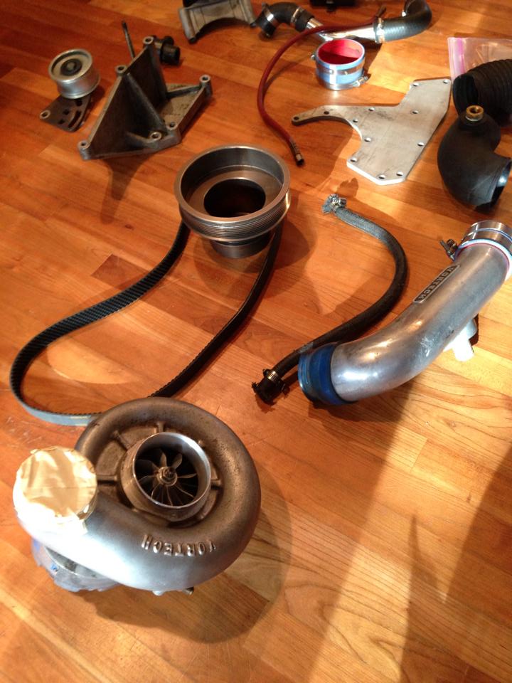

Well the build is changing directions again lol I scored a used vortech V1 supercharger with 10-12lb pulley. As soon as its painted and everything is assembled she will be headed to Redline Tuning to get a dyno tune. Hoping for 450 RWHP. On a conservative tune.
Love them Vortecs!! I used to run a cog pullied T-trim on my old GT good street manors and had the horsepower on tap!!
Got the blower Friday! All my tubular K frame coil overs and 03 model brakes.
