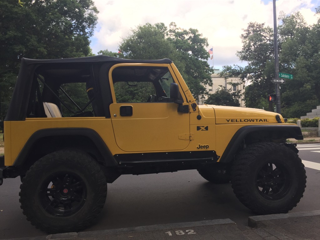

Most Recent Pics (As of 6/1/15)
ai1108.photobucket.com_albums_h407_sjones26573_Mobile_20Uploads_1432848165_zps11d040d7.jpg
I'll start where I stand:
2004 Wrangler "TJ" X in Solar Yellow. It was completely stock when I got it in 2010, aside from 31" BFG AT's

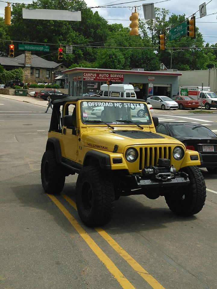

Took it wheeling last weekend with Jankoid. Daniel is way more washed out than it was last time I was there. The open diffs struggled to get past the upper ledge. The lower ledge wasn't bad but the spot right above it between the ledges has gotten bad and was more of a challenge than either of the ledges.
The LJ got in a tight spot and was close to tipping. The tow strap was a necessity.
