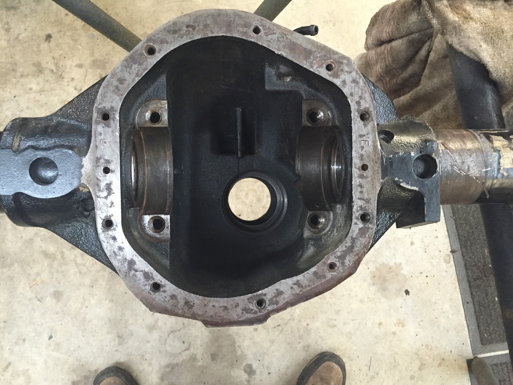

I know u already have parts but when I did my tj I started with a Dana 44. After pricing everything out it was within a $1000.00 off just going 60 14 but I did find a smoking deal on my axels. Trust me I understand on the $ side I about to put another $10,000 in mine.
I understand. I just didn't feel like messing with 1 tons. The 44 and 8.8, both trussed running chromo axles, should be able to handle the 37's with my wheeling.

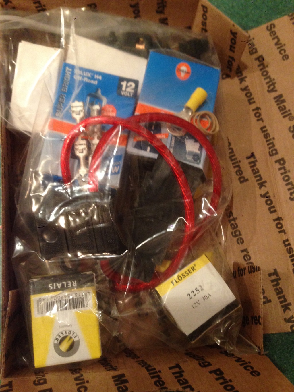

Started off at 4WP Raleigh at the Madness in March sale. Talked to a few guys in a club I'm looking to join. Then set on my way to the Charlotte 4WP to catch the end of their event. Stopped outside of Raleigh to help out an older woman whose '06 X blew a tire. Unfortunately the tire that blew was the spare from a previous blowout, so couldn't get her back on the road, but I talked to her until her son arrived. I think she loved her Jeep as much as I love mine. Got home and ditched the doors. Then me and my father set out for 4WP, with both the TJ and the JKUR. Event was over by time we got there but I still opted to play on the crushed car. Then rolled back through uptown Charlotte. Always fun to turn a few heads in the city. Working on the YJ axle swap tomorrow.

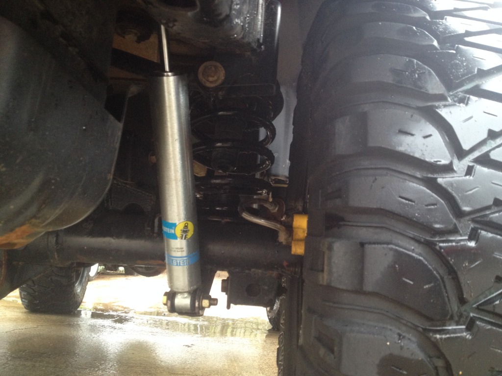

Over spring break I got the rear 2" BDS springs and 5100's in. Of course that was a PITA and took way longer than planned. Nothing ever goes easy for me.

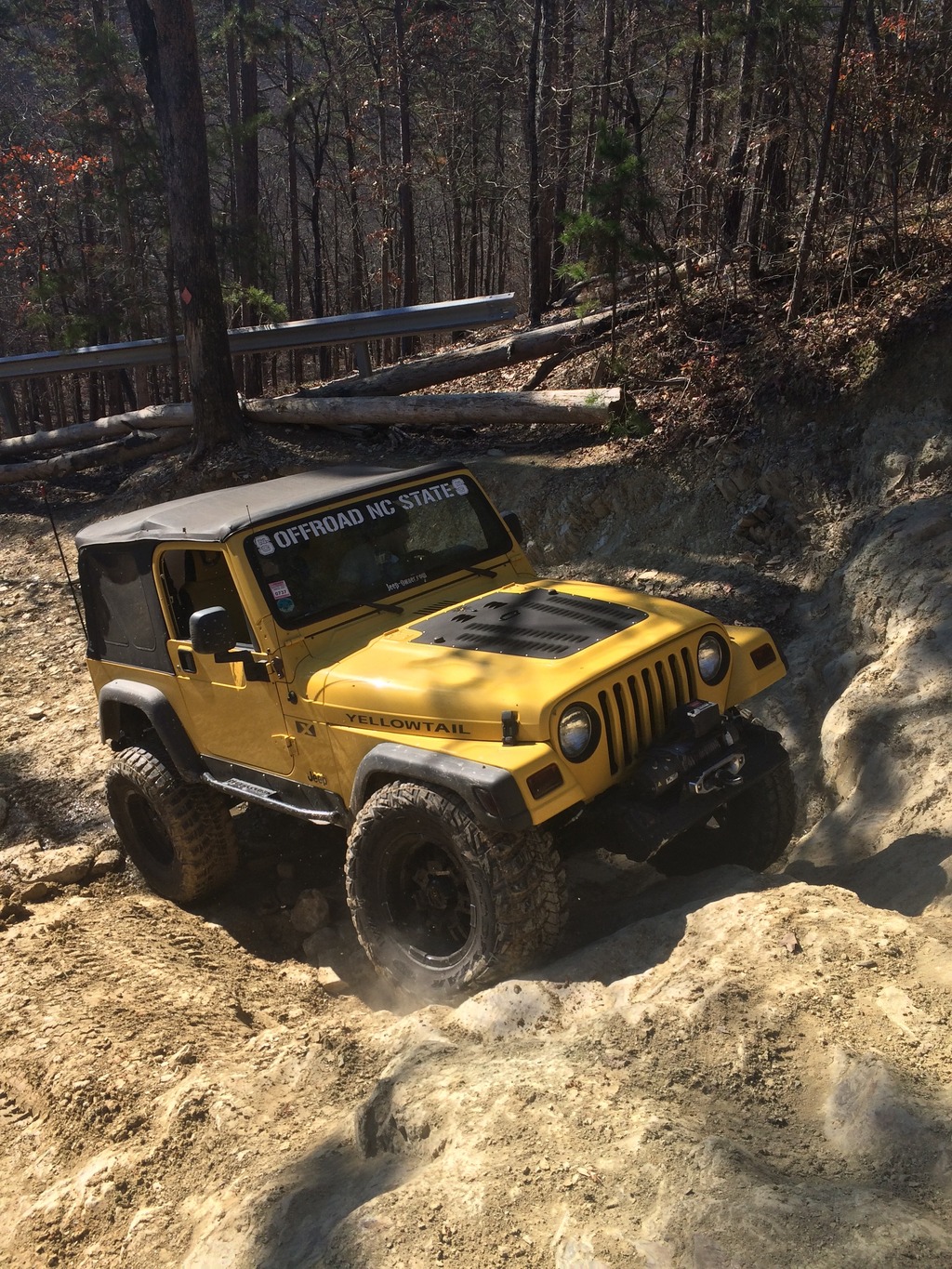

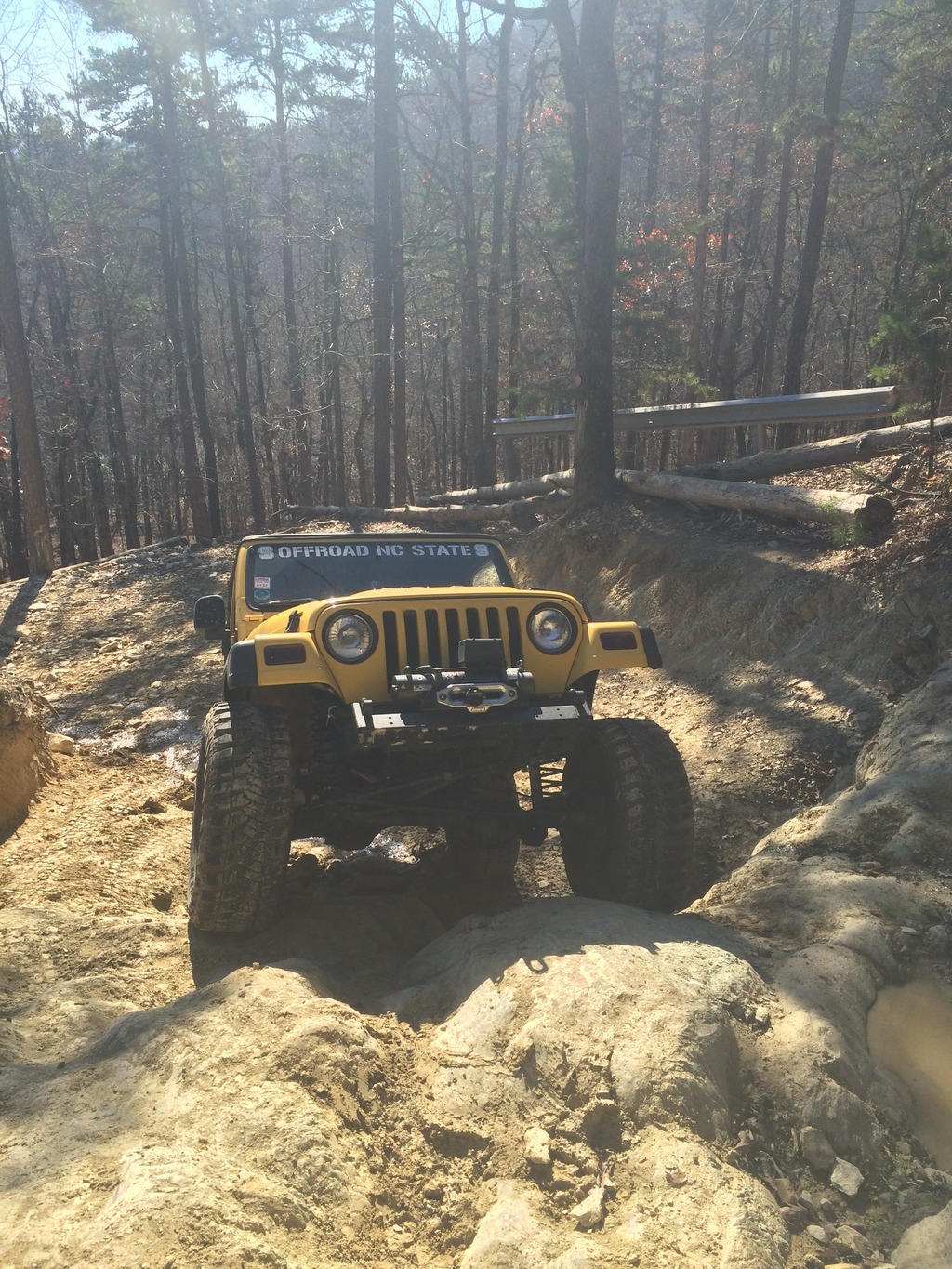

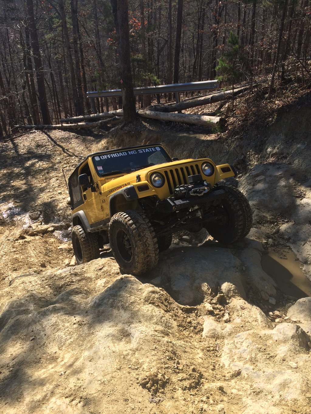

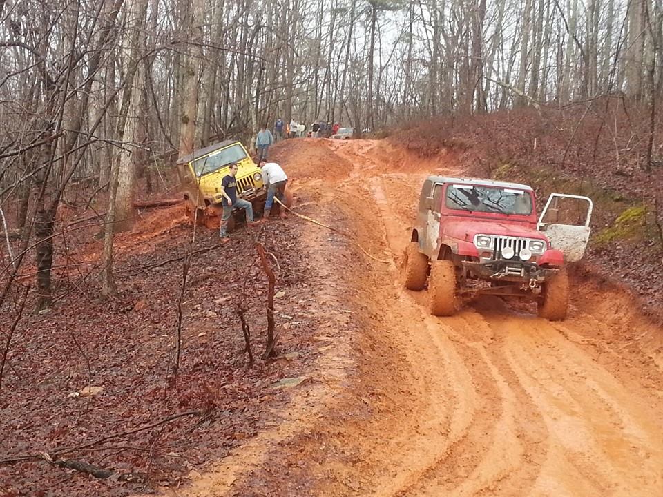

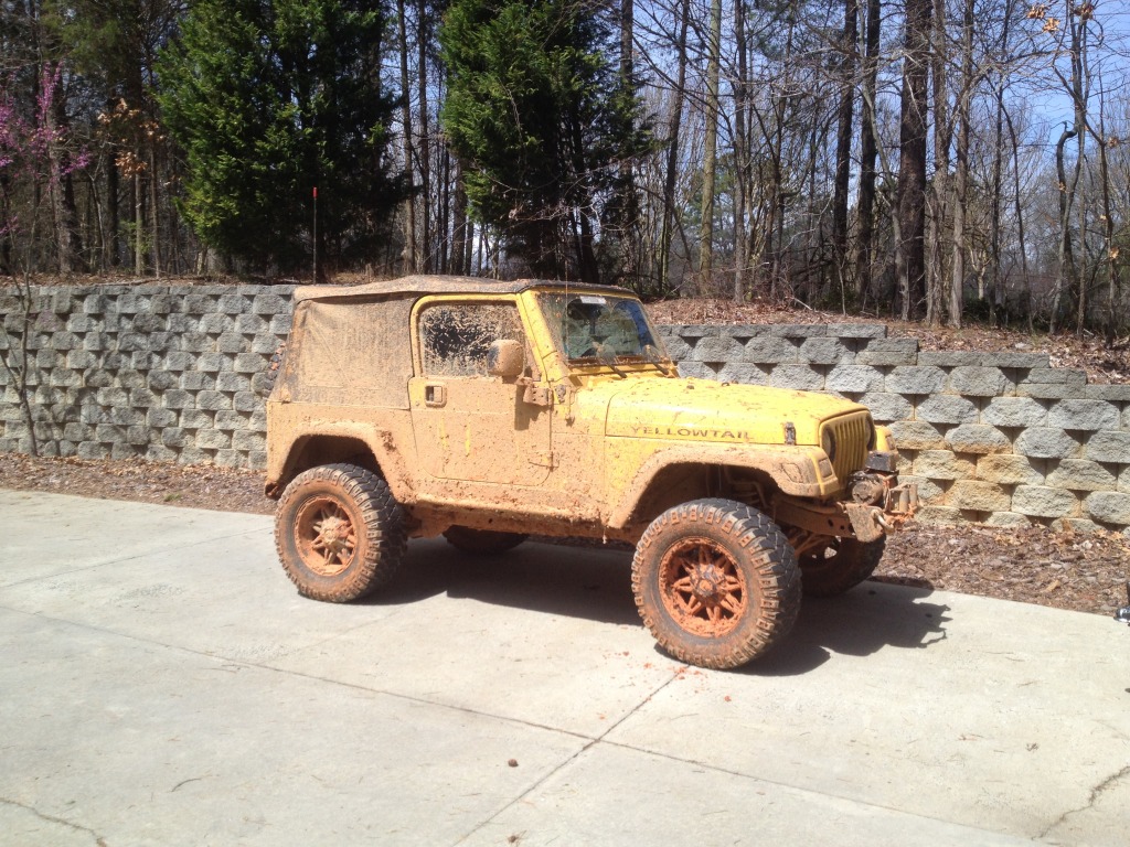

Wheeled it last weekend at URE. Muddy as all hell. Any trail with a clay hill was all but impassible. Even going down here required a tow, and for me, a winch. The ditch and some ruts kept shooting everyone into the ditch. The YJ got towed over without sliding off (barely) but I wasn't so lucky. Slid off until it was teetering and I had to run a winch line up the hill to get it back on the trail. We ran a snatch block for the next TJ to keep the front end up the hill as it went over the hump.
ai1108.photobucket.com_albums_h407_sjones26573_10155614_624543374300375_1698138425_n_zpsec033f1f.jpg

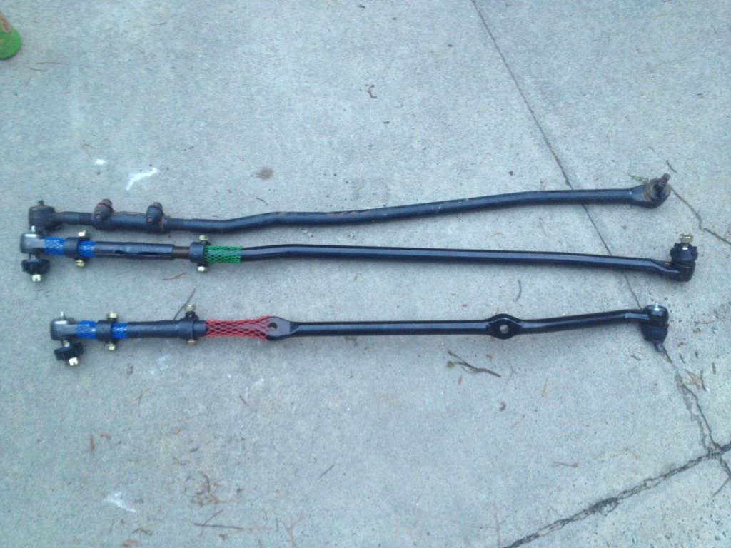

Only major damage was a 2nd destroyed tie rod (this was a few month old ZJ tie rod, so I had to work to kill it so fast) which we managed to pull back into driveable shape by tying it to a tree with a strap and backing up a few times. Still driving on it (no sense in destroying a 3rd one at the Jamboree) but it will be replaced. I had to power wash it forever to get the ungodly amount of mud off of it. Then washed it.

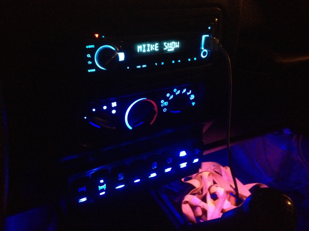

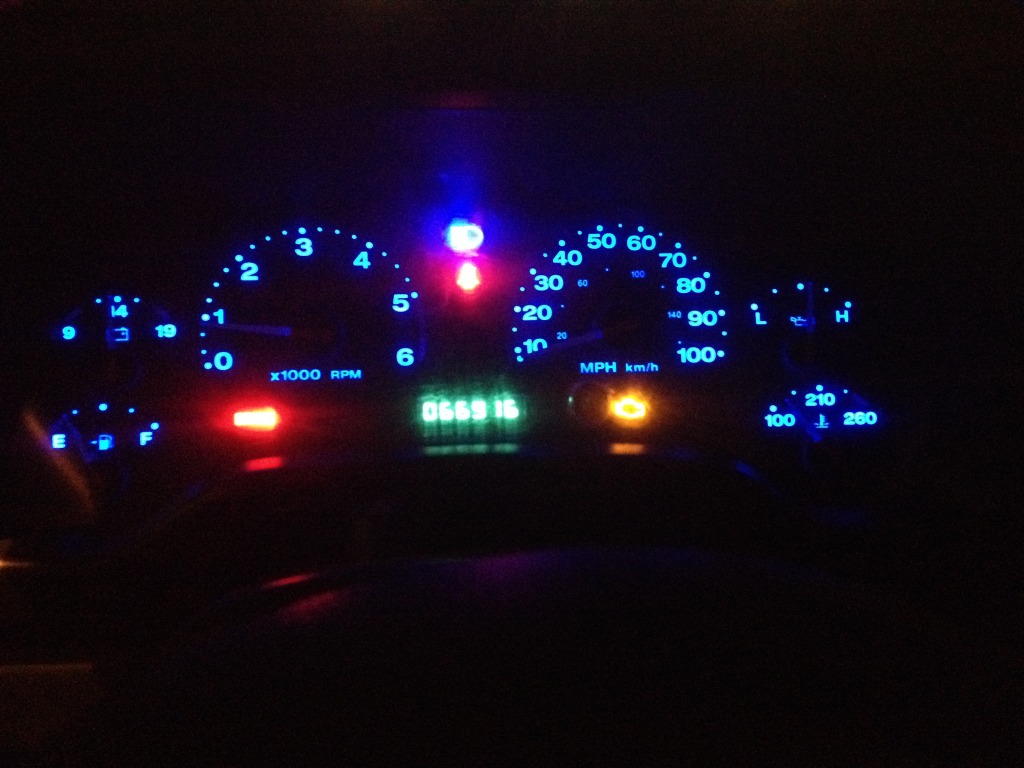

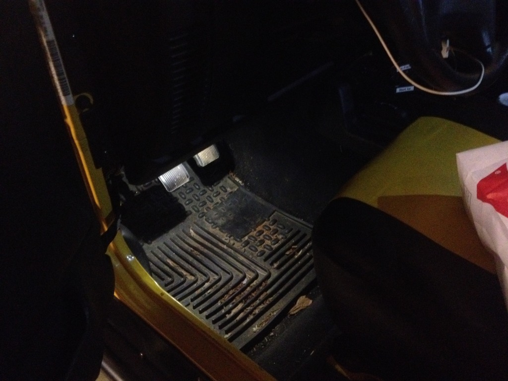

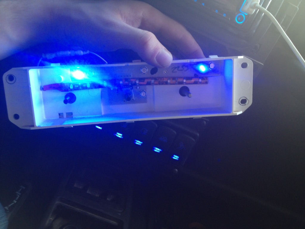

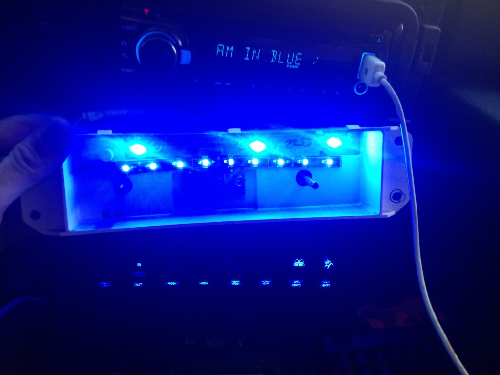

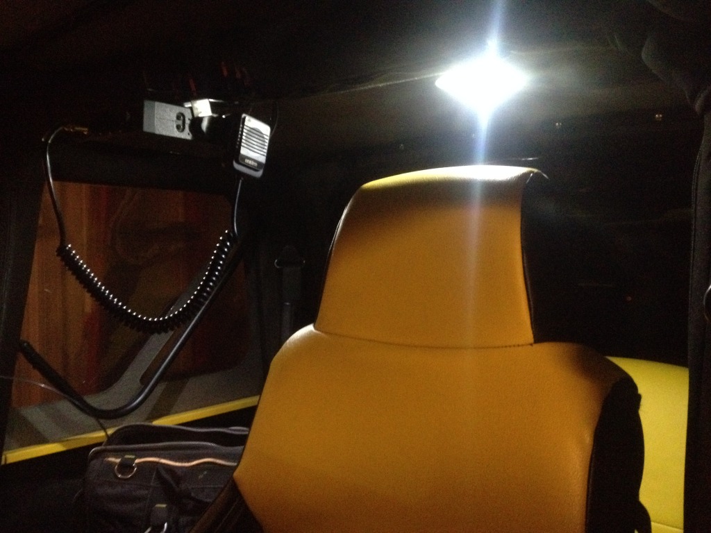

This week I received and installed new dash and HVAC bulbs from SuperbrightLEDs. Half of the old ones were burnt out or flickering.
This shows one of the old 2 LEDs on the right and the new 1 LED on the left.
ai1108.photobucket.com_albums_h407_sjones26573_Mobile_20Uploads_1396317383_zpsfb65e7b0.jpg
All new
ai1108.photobucket.com_albums_h407_sjones26573_Mobile_20Uploads_1396317389_zps31f7a93c.jpg
Installed
ai1108.photobucket.com_albums_h407_sjones26573_Mobile_20Uploads_1396317525_zps480aa40a.jpg
ai1108.photobucket.com_albums_h407_sjones26573_Mobile_20Uploads_1396317532_zps2337c298.jpg
Soooo much better not having the center of the cluster strobing in my face at night.

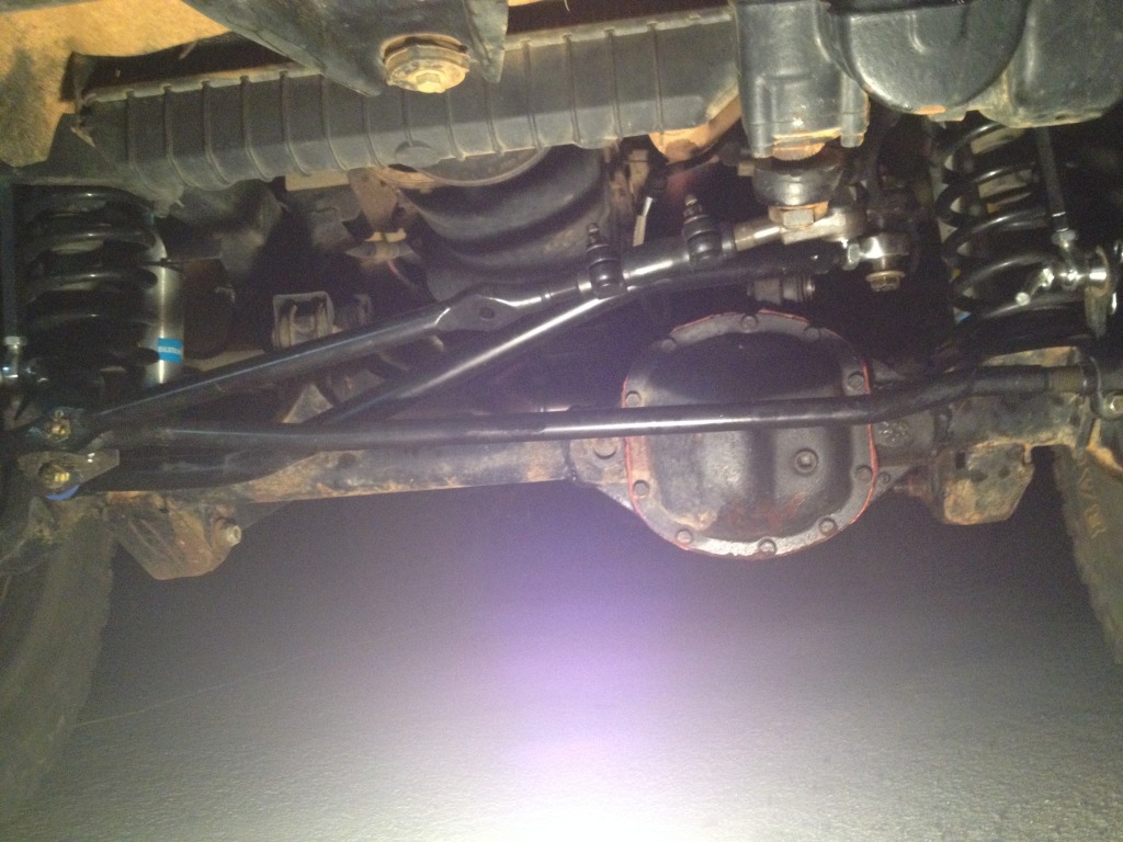

So recently, I bought and installed Crown HD steering to last until I swap the Waggy, stripped and retinted my turn signals which look great now, and fixed my homemade 3rd brake light with new SuperbrightLED LEDs.
ai1108.photobucket.com_albums_h407_sjones26573_Mobile_20Uploads_1400906405_zps83a115d5.jpg
ai1108.photobucket.com_albums_h407_sjones26573_Mobile_20Uploads_1400906414_zpsb411b1d1.jpg
ai1108.photobucket.com_albums_h407_sjones26573_Mobile_20Uploads_1401068355_zps21c07d41.jpg
ai1108.photobucket.com_albums_h407_sjones26573_Mobile_20Uploads_1400349635_zps28ab15bc.jpg
Painted the front diff cover, as well as some other stuff, and bolted on the guard. Probably only going to use it once before swapping in the 44. Also placed a deposit to have 35" MT/R's mounted next week, just in time for Windrock.

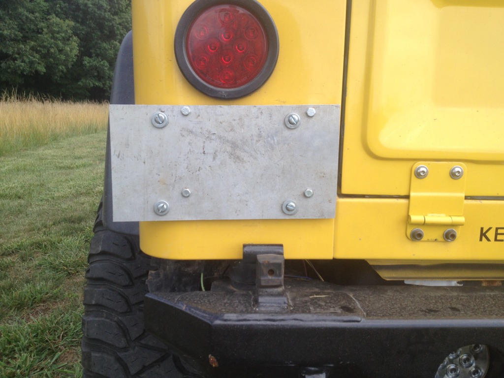

Yesterday I got my aluminum tag bracket mounted. Still have some work I want to do before painting it. Much better than the zip ties I was using.
ai1108.photobucket.com_albums_h407_sjones26573_Mobile_20Uploads_1404355671_zpsdb082c57.jpg

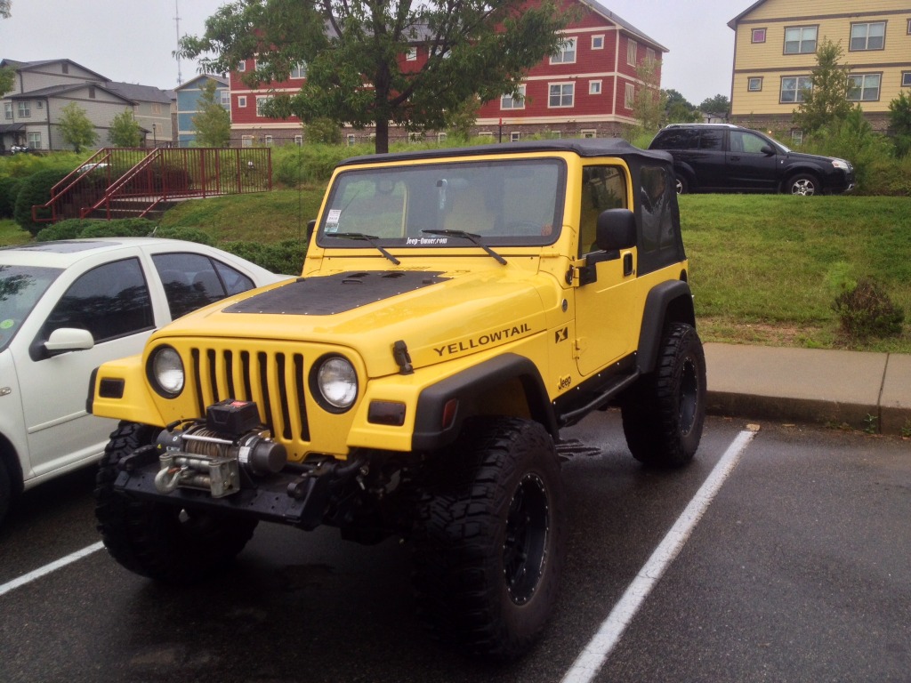

35x12.5x17 MT/R Ks mounted, rear driveshaft rebuilt, Poison Spyder hood louver installed (got it new from PS for less than half retail), installed some 3W Cree LED rock lights (which turned out to be shit and I'm removing), installed Metalcloak front uppers during a death wobble battle, made several audio improvements, added some latches (JK hood latches) to the CJ gate, and added an antenna mount on the back. And took it to Windrock.

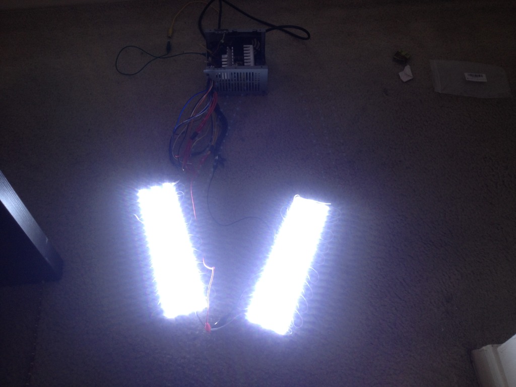

I got the much cheaper and better LED's I'm going to be using instead as rock lights today, and damn are they bright! Thousand times better than the shitty 3W ones on it now.

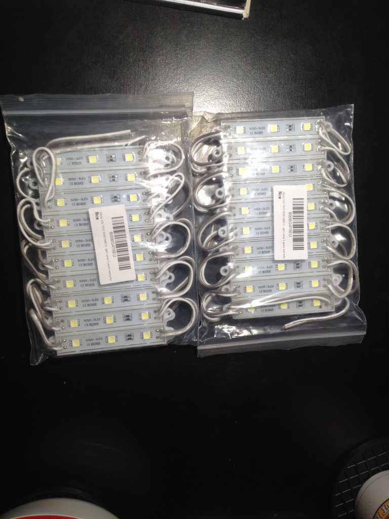

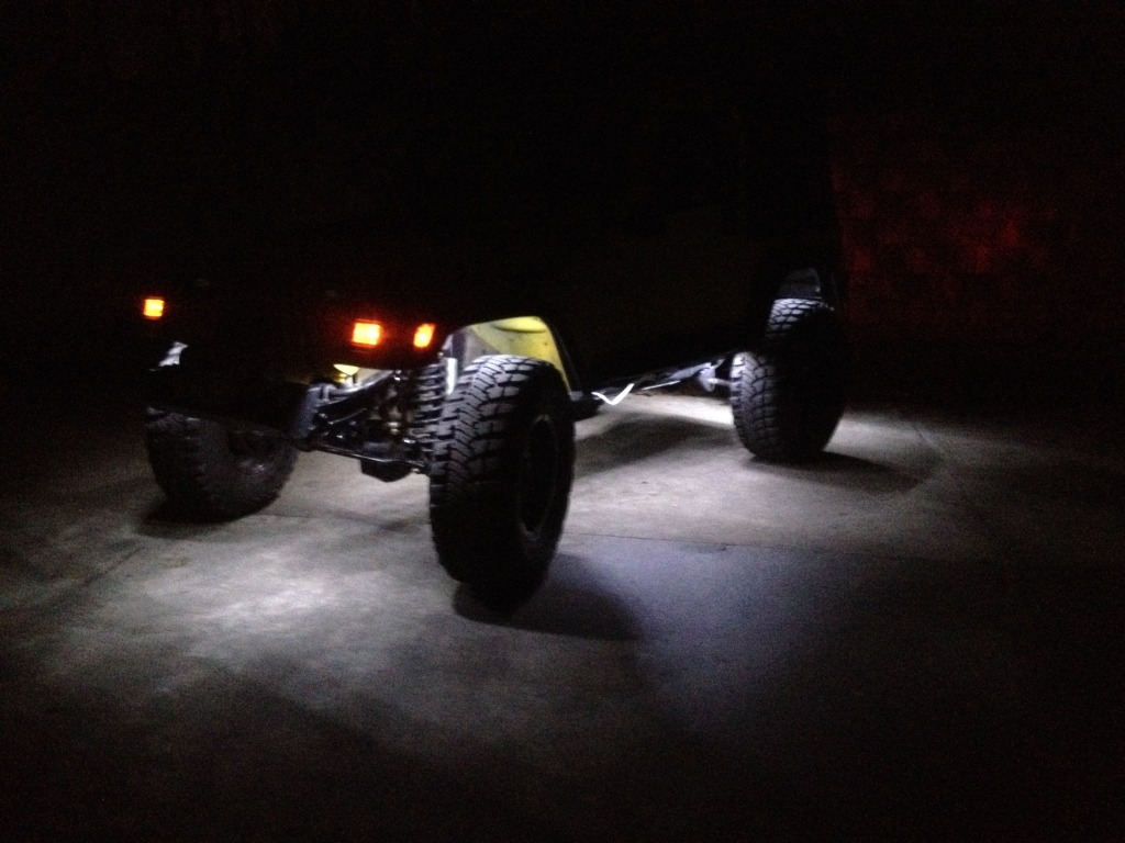

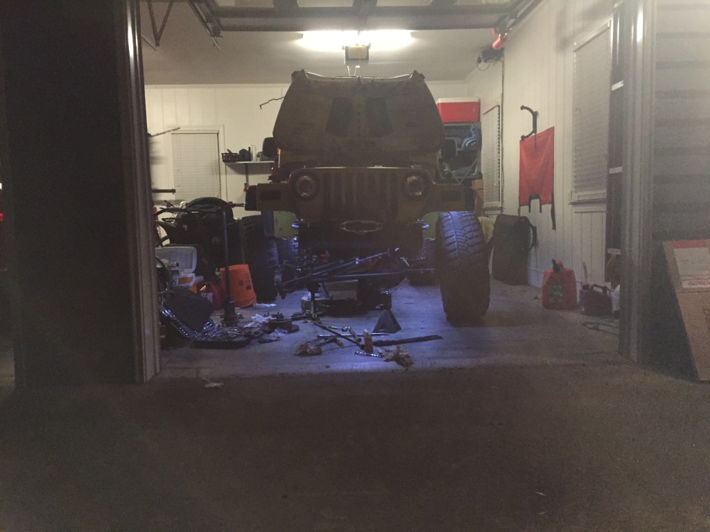

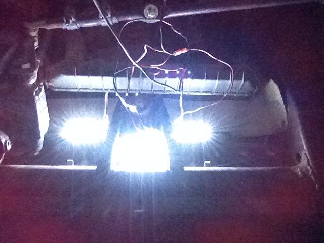

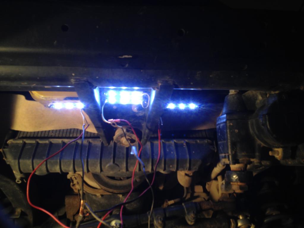

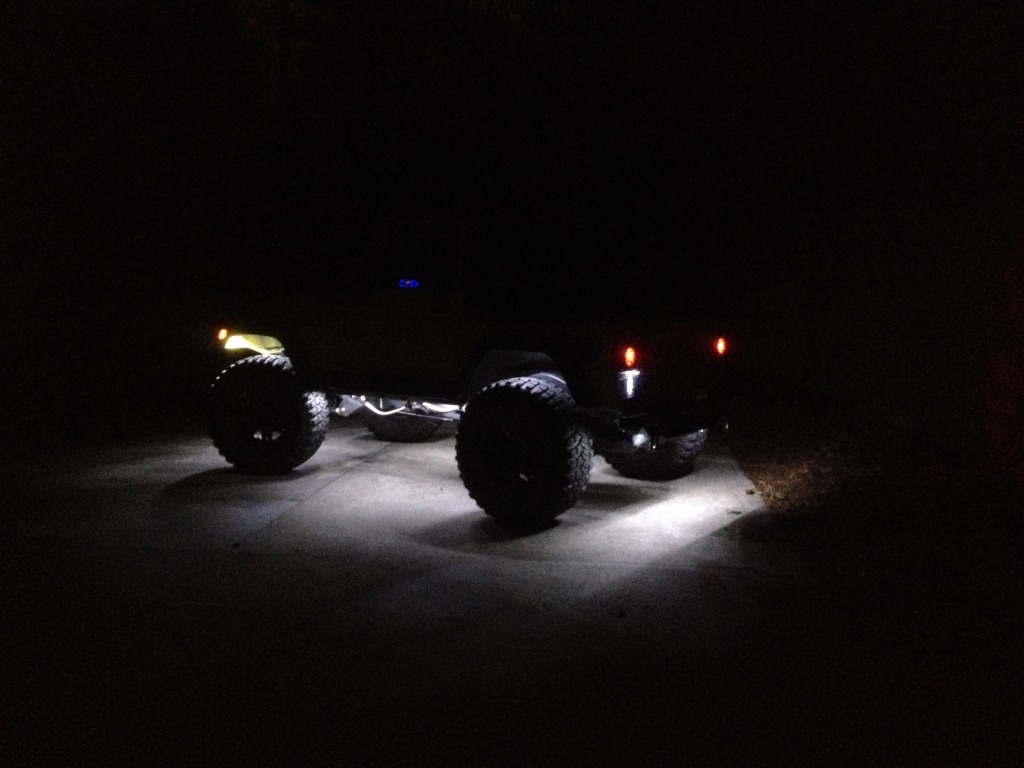

Ripped the old lights out. 20 of 40 pods installed w/ stainless self-tapping screws. Bought 50 feet of ANCOR Marine 16ga Duplex wire from West Marine, although no wiring done yet.
Jury-rigged* 4 of the front pods to test output. Blown away at how bright they are, especially compared to the crappy ones I ripped out. And this is only a small piece. In total, there will be 8 front, 8 rear, and 12 on each side.
*Jury-rig executed by incompetent moron. Do not attempt.
Brightness dimmed by camera:
Actual output: (Idk why NC4x4 is flipping this pic. It's not happening anywhere else.)

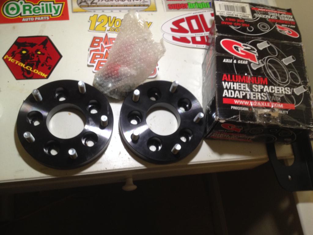

Drove to the nearest 4 Wheel Parts in Charlotte to pick up a pair of G2 5x4.5 5x5.5 adapters to temporarily run the new wheels on the 30. Will be going to the shop tomorrow to install the Super 88 in the rear, which will be switched to 5x5.5 when the wheels are mounted.

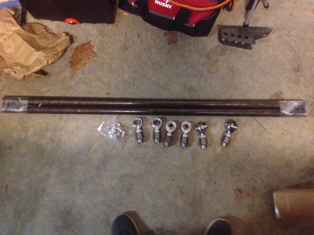

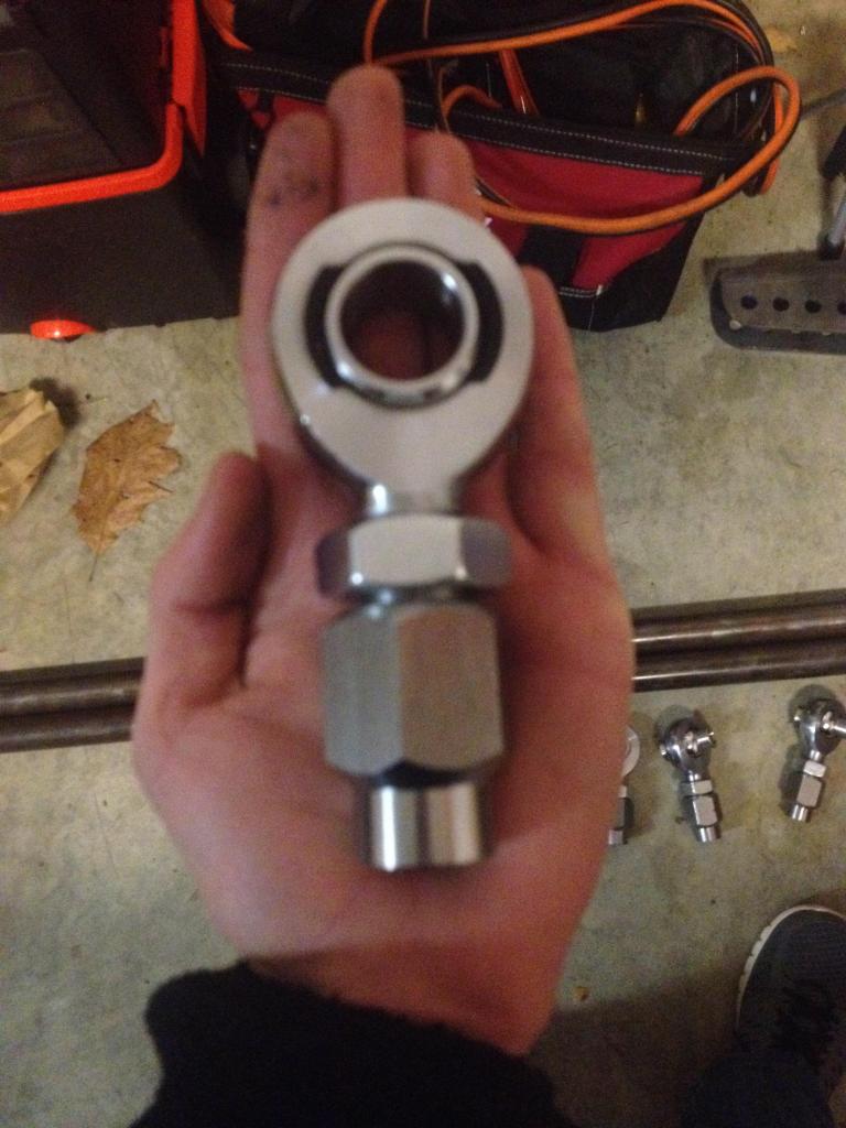

The Ruffstuff order I have been eagerly awaiting also came in. 7/8" heim steering and heims for the trackbar. UPS picked a bad day to switch drivers, as the new guy didn't know to back down the driveway, so he had to heft the 44lb box all the way to the house from the street. My god this kit is pure beef.

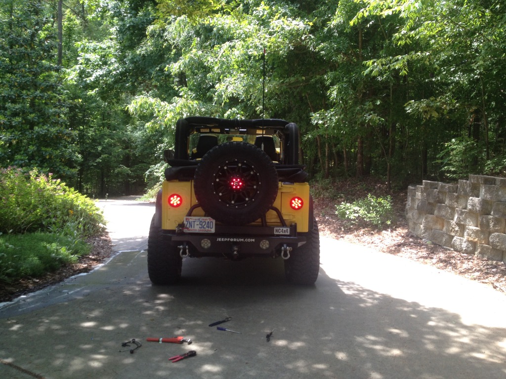

Ok, updates:

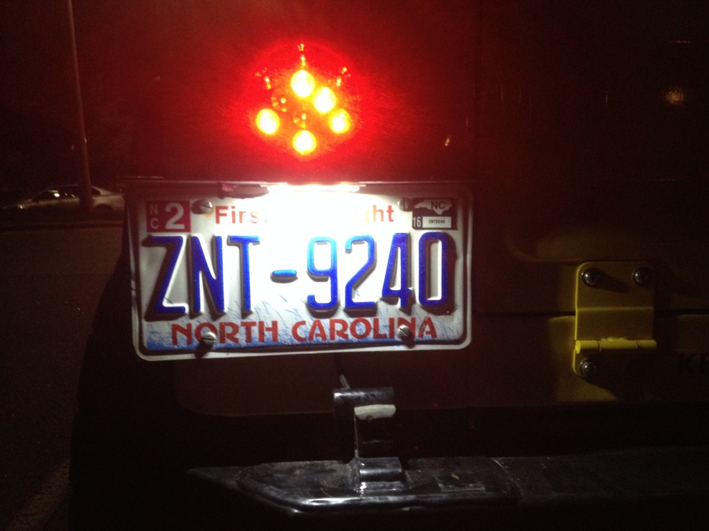

New SuperBrightLED's tail lights:
ai1108.photobucket.com_albums_h407_sjones26573_Mobile_20Uploads_1428028934_zps440cd81b.jpg
They super bright :cool::
ai1108.photobucket.com_albums_h407_sjones26573_Mobile_20Uploads_1428029025_zpsee63ece2.jpg

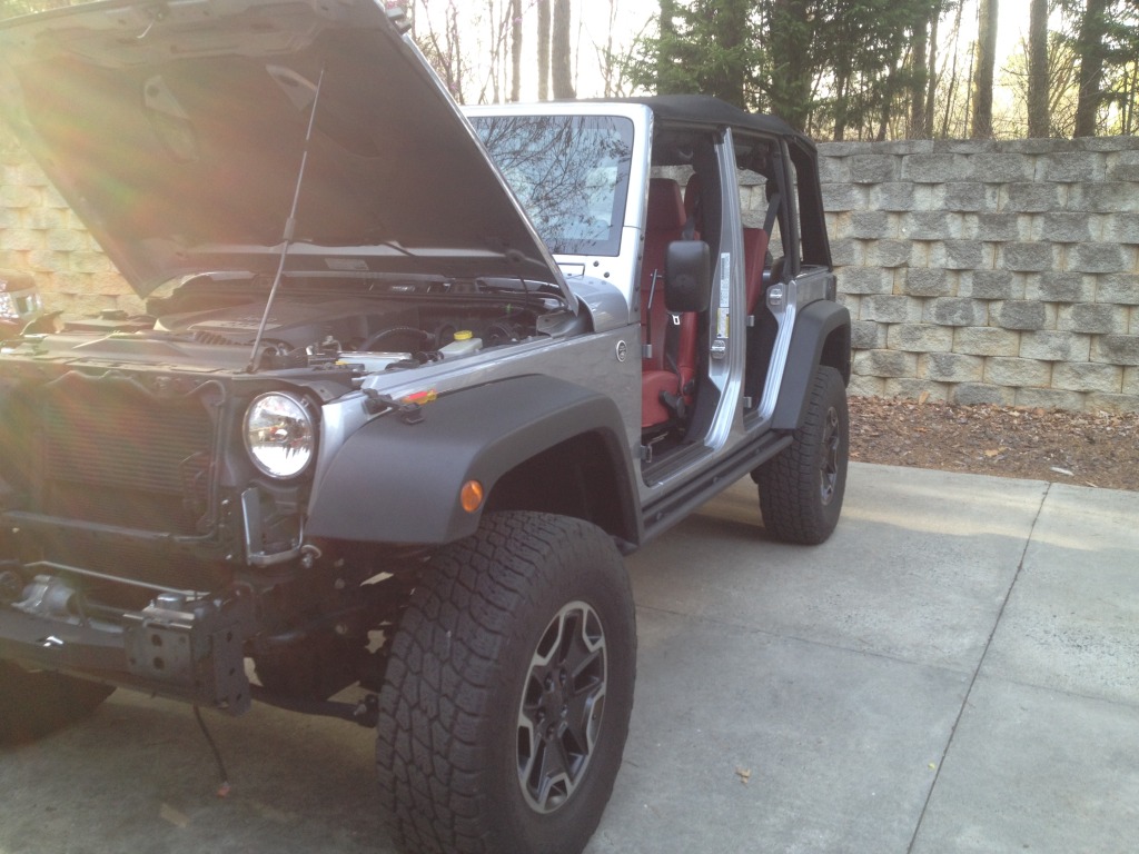

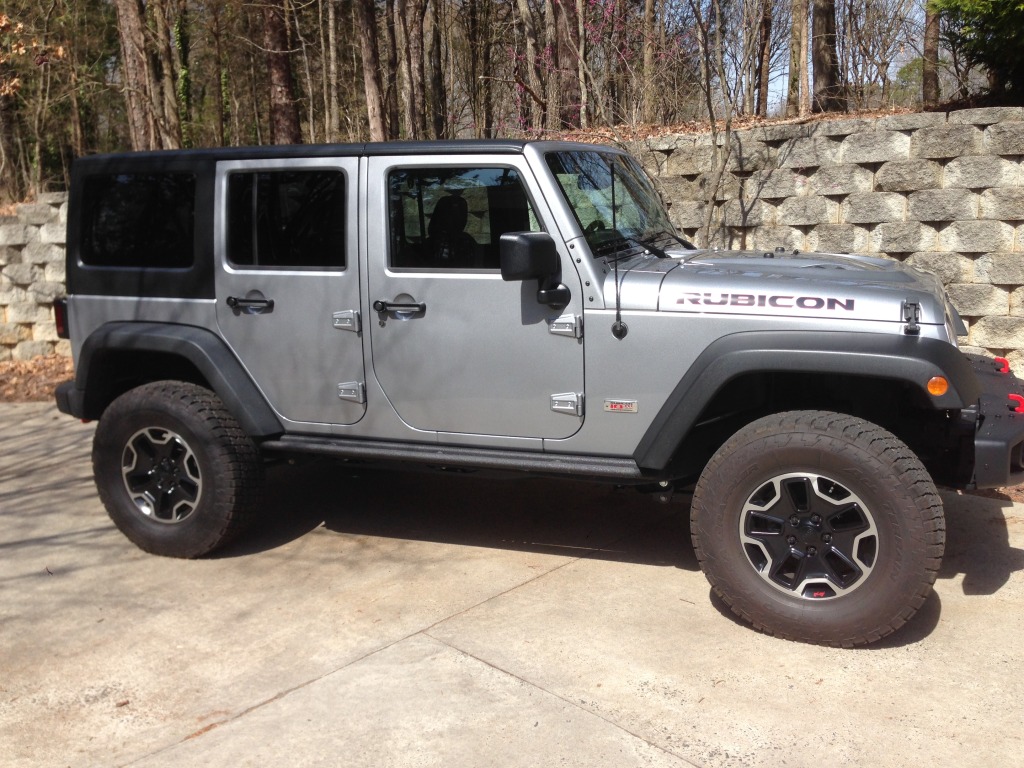

JK got a Zeon 10S, Teraflex carrier, and practically new '13 Rubi top:
ai1108.photobucket.com_albums_h407_sjones26573_Mobile_20Uploads_1428110531_zps789f678a.jpg
ai1108.photobucket.com_albums_h407_sjones26573_Mobile_20Uploads_1428191111_zps0ce1e017.jpg

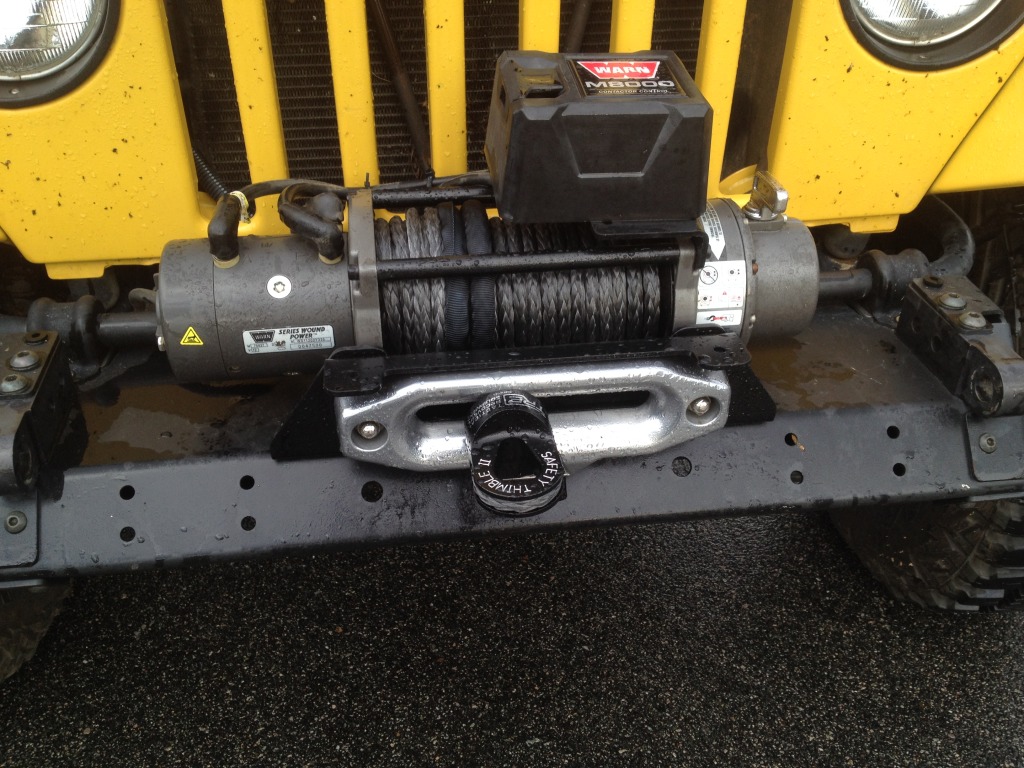

TJ M8000 got painted and a new TRE syn line with safety thimble:
ai1108.photobucket.com_albums_h407_sjones26573_Mobile_20Uploads_1428207138_zpse5874dd4.jpg

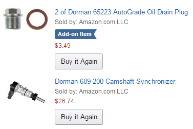

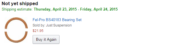

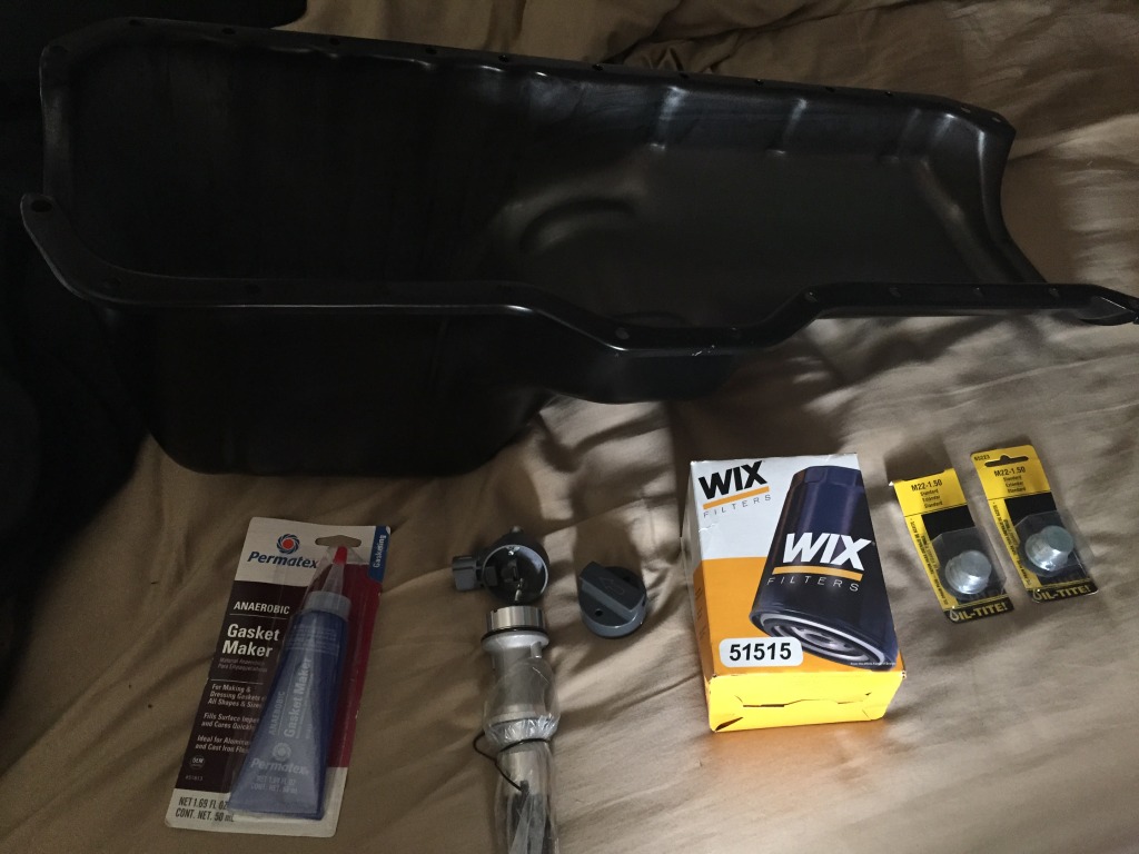

Bought the stuff to repair:
Received some of the stuff:
ai1108.photobucket.com_albums_h407_sjones26573_Mobile_20Uploads_1429744771_zpsc842517a.jpg

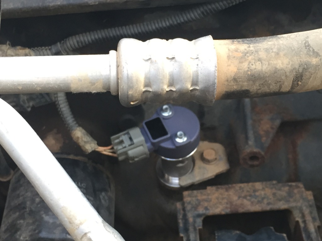

And installed the Dorman 689-200 despite reported flaws. New version uses alignment cap rather than holes and is stupid easy. Turned engine until cap fit on stock sync, twisted it out, twisted new one in, and it popped right in when the flat on the bottom lined up. Sensor plugged in without much trouble. Cranked it and it ran smooth and quiet, no timing issues. Took all of 15 minutes to install.
ai1108.photobucket.com_albums_h407_sjones26573_Mobile_20Uploads_1429744774_zps304c1611.jpg
ai1108.photobucket.com_albums_h407_sjones26573_Mobile_20Uploads_1429744787_zps24fbb58d.jpg

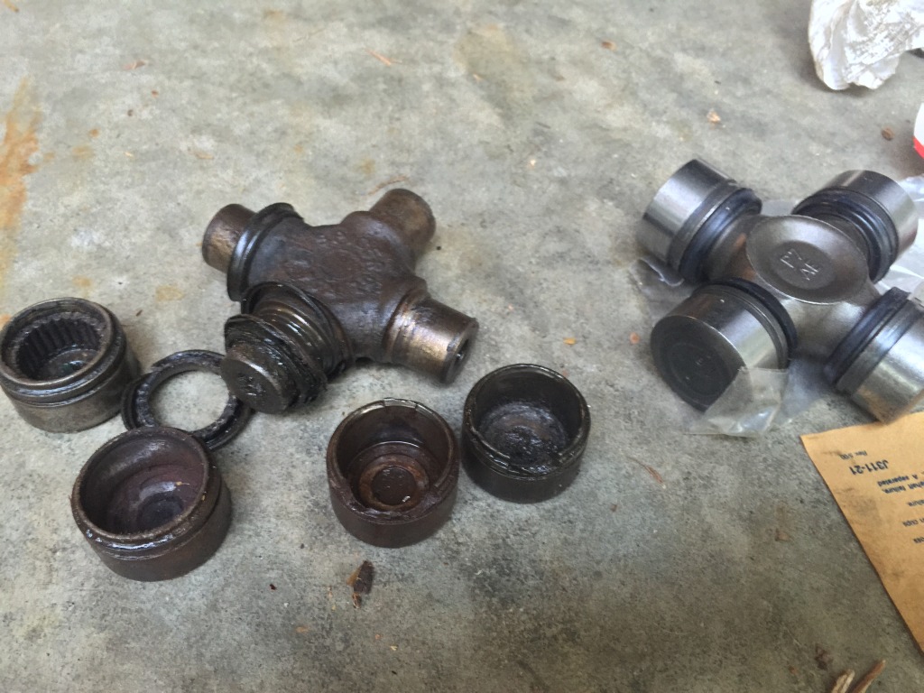

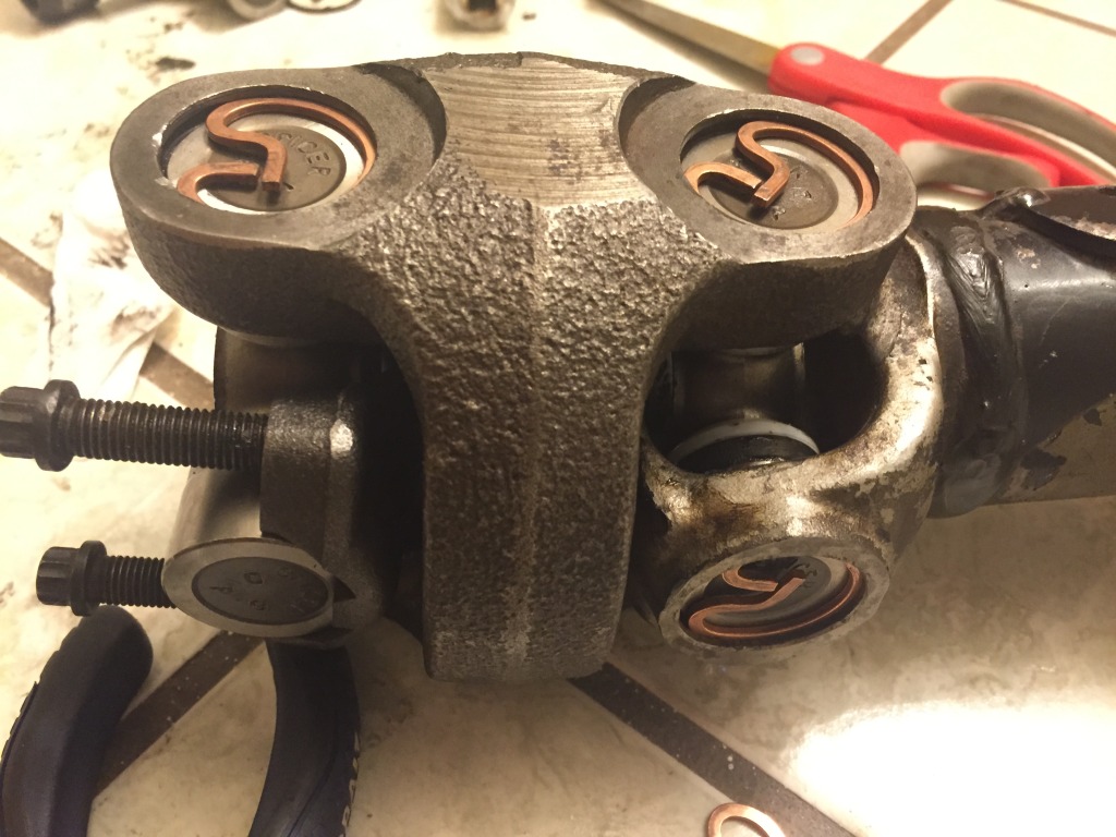

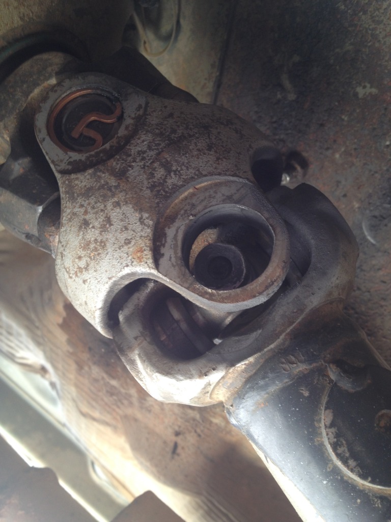

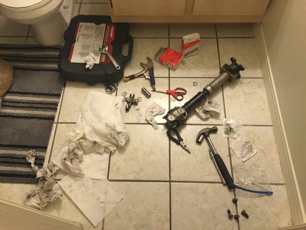

Rear driveshaft had been making all sorts of racket so I replaced both DC u-joints with new Spicer's. One was an older Spicer that I believe was overgreased, blew out the seals, and proceeded to wear. The other was a newer Precision that replaced the other Spicer that blew out a bearing cap a few month ago. It may have been rebuilt in a bathroom with a hammer, but I believe it finally has a good setup that is going to last a while. Has been smooth and problem-free since install and I've done plenty of driving.
ai1108.photobucket.com_albums_h407_sjones26573_Mobile_20Uploads_1430625972_zps50f67afb.jpg
ai1108.photobucket.com_albums_h407_sjones26573_Mobile_20Uploads_1430625982_zps0815789a.jpg

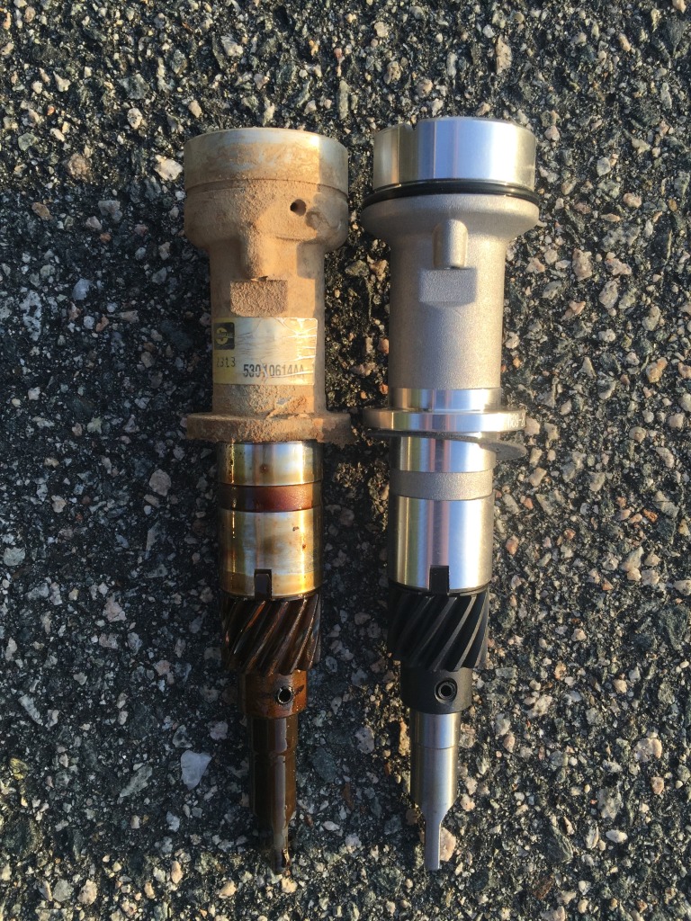

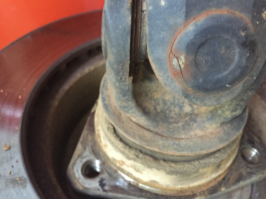

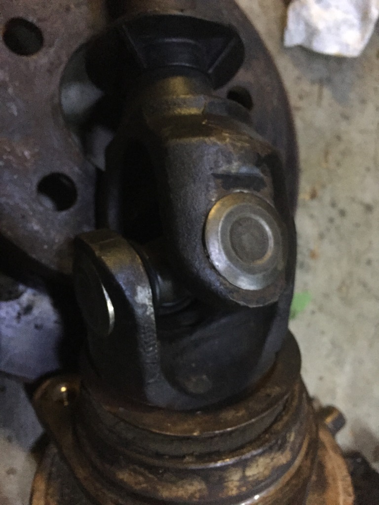

When on FWD, I had heard all manners of nasty noises, which I primarily thought was my other D30 u-joint going bad. After back home and in RWD, I confirmed it was pretty bad. The shop with a 20 ton press wasn't far, but I didn't feel like dealing with that, so I replaced it with a hammer as well. It had all manner of play. Much tighter and a quiet front end. While I had the tire off, I drooped the axle to reseat the bottom of the coil into the notch on the coil pad.
ai1108.photobucket.com_albums_h407_sjones26573_Mobile_20Uploads_1431560534_zpsed3d886a.jpg
ai1108_photobucket_com_albums_h407_sjones26573_Mobile_20Uploads_th_1431589600_zpsb7129a84_mp4_.jpg
ai1108.photobucket.com_albums_h407_sjones26573_Mobile_20Uploads_1431560542_zps7984be05.jpg
ai1108.photobucket.com_albums_h407_sjones26573_Mobile_20Uploads_1431588554_zpsb8ed830d.jpg
ai1108.photobucket.com_albums_h407_sjones26573_Mobile_20Uploads_1431588560_zps7b7cb37f.jpg

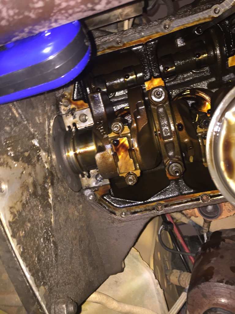

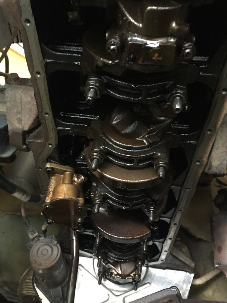

While I was home, I also tackled the RMS and Oil Pan Gasket
ai1108.photobucket.com_albums_h407_sjones26573_Mobile_20Uploads_1431588568_zps8f3d6c2a.jpg
ai1108.photobucket.com_albums_h407_sjones26573_Mobile_20Uploads_1431656505_zpsb7d2377b.jpg

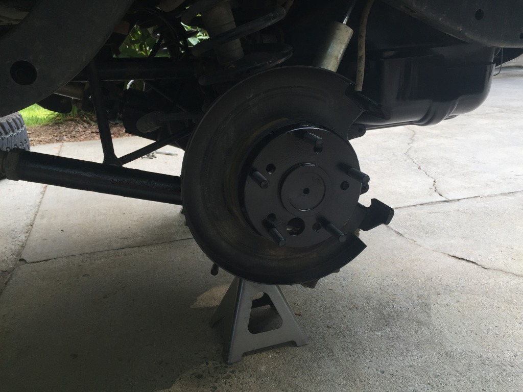

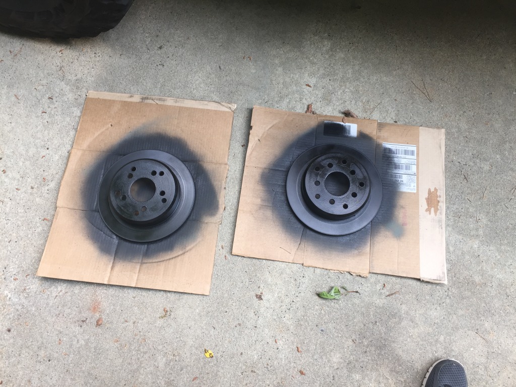

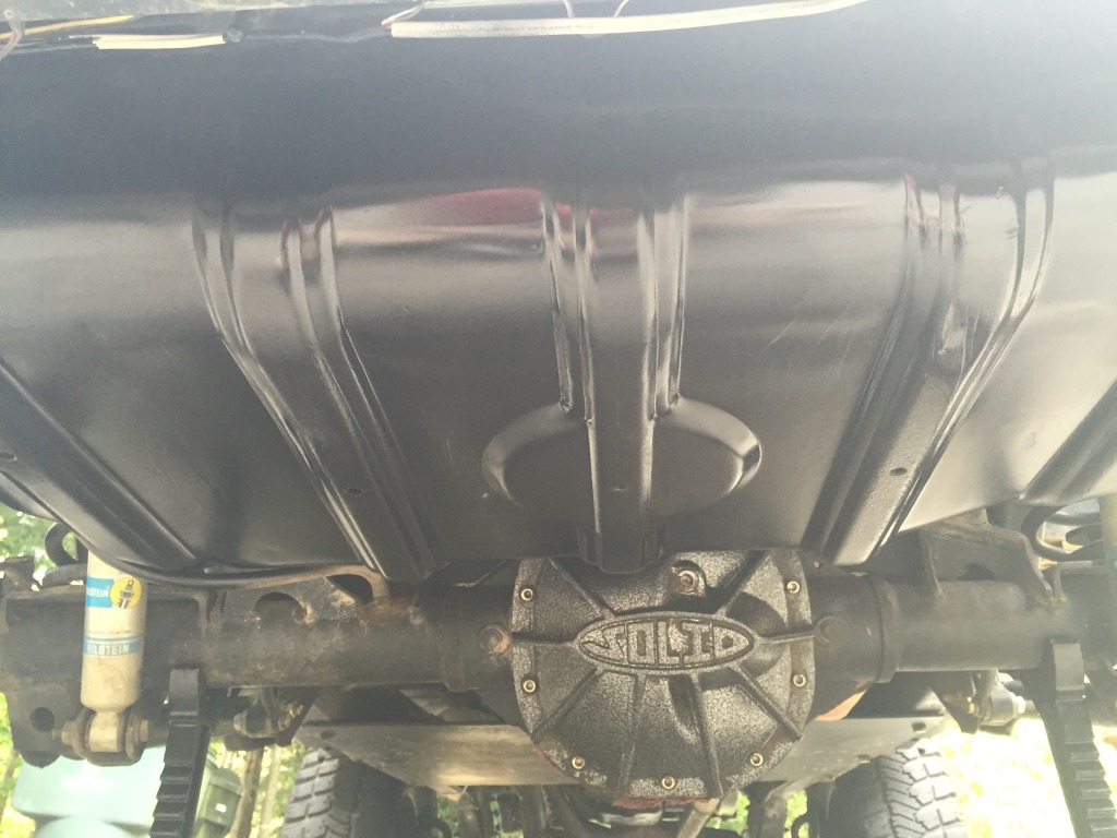

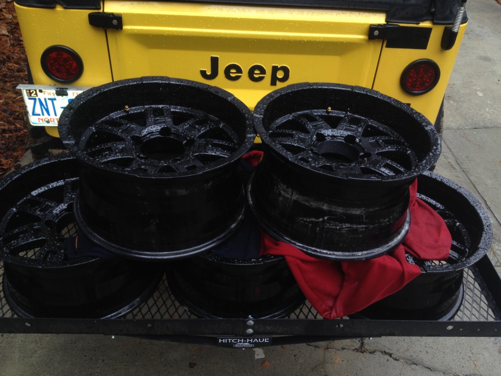

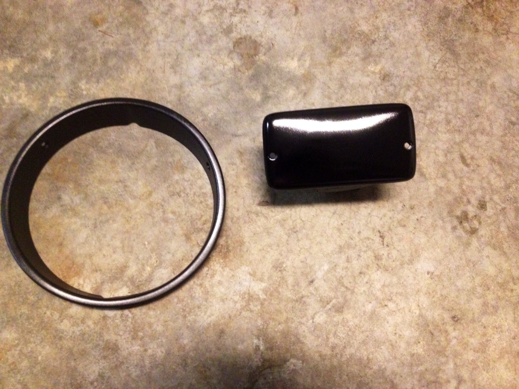

I also broke out the heavy duty Rusto and did some painting. The Super 88 shafts and 8.8 rotors were rusty as could be and were visible without the wheel caps so they needed a coat. Additionally, I coated that awkward piece of body that shows with a body lift, sprayed the entire gas tank skid (lots of rock rash) and hit a few rusty spots. I try to stay ahead of the rust in the paint department.
NOTICE: Yes, I painted the 8.8 discs. No, I did not tape them off. However, I avoided direct spray on the wear surface and what can be seen is mostly overspray. I was in a hurry and needed it done so I could drive it back. It was only the rear discs so braking was not majorly impacted and the pads wear through the paint in no time. I drove across the state immediately after this with no issue. So please, no debate.
ai1108.photobucket.com_albums_h407_sjones26573_Mobile_20Uploads_1431747805_zps416c9158.jpg
ai1108.photobucket.com_albums_h407_sjones26573_Mobile_20Uploads_1431747813_zps7a2c7970.jpg
ai1108.photobucket.com_albums_h407_sjones26573_Mobile_20Uploads_1431747929_zps7460a0ba.jpg
ai1108.photobucket.com_albums_h407_sjones26573_Mobile_20Uploads_1431747795_zps1bbff3a6.jpg
ai1108.photobucket.com_albums_h407_sjones26573_Mobile_20Uploads_1431747809_zps62ae26d1.jpg
