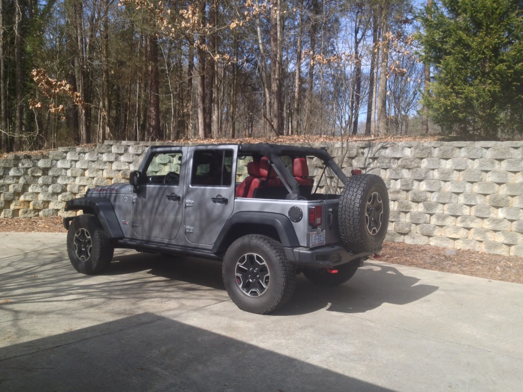

Finally home! Picked the Jeep up from the dealership in Salisbury. Dad had his in the shop and had gotten it back this morning, but had to drive my Jeep up to the dealership to pick his up, then drive to Raleigh and back to get me. A nice black lady asked if i'd trade her for her Chrysler. I laughed.

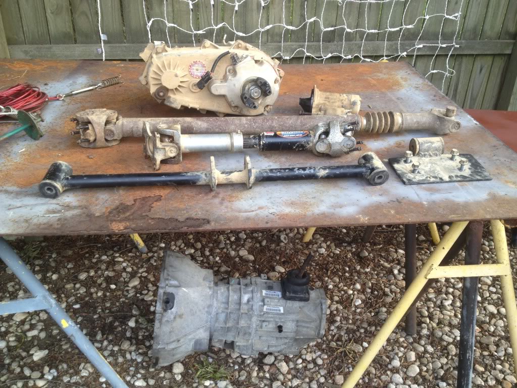

Got halfway through my SYE. My Tcase is in pieces across the shop.

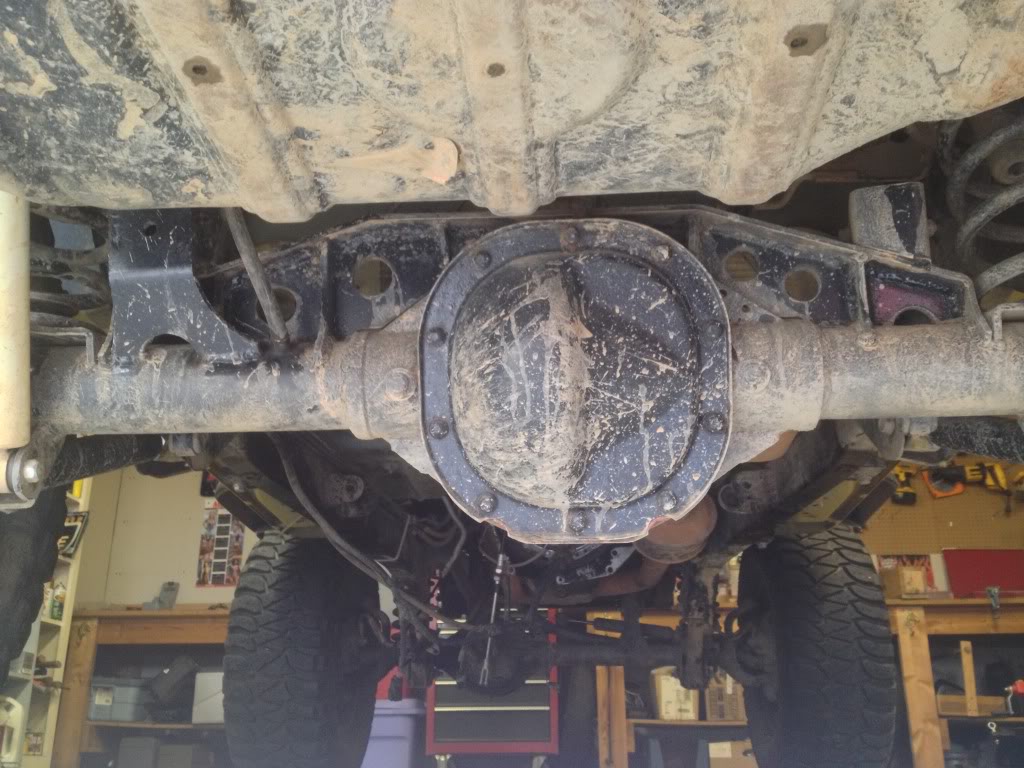

Anyways, the 8.8 is done and installed. It came with 2 pass side calipers so I had to steal a drivers side from one of the other 8.8s lying around. The brakes actually work now. Had to torch off, grind down, and reweld the shock mounts so the shocks would actually fit in them.

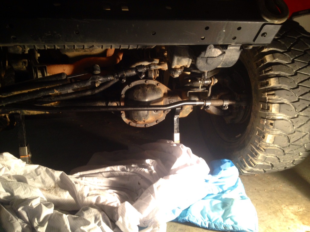

I'll be coming home again this weekend to get some work done. Still need to build a flat skid, swap the front axle, get an adjustable track bar, and figure out a sway bar setup for the 8.8.
So, yeah, slack as always. Since I last posted here, I got the front 4.10 LSD 30 swapped in and got the rear shaft installed, after stripping the wrong expensive as shit bolts Ford sold me. Got some hex heads that fit perfectly from Lowes but I'll swap them (Grade 8.8) with some 12 point (Grade 12.9) correct bolts from Knowwhere2Jeep.

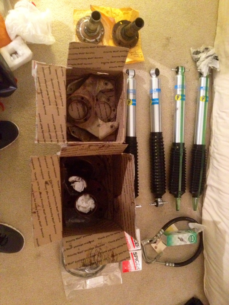

Lets see, since this, I:
- Replaced the tranny...twice. (#2 lasted a week).
- Replaced a ton of parts (Windshield, Centering yoke, Axle u-joints, Water Pump, TPS, Power Steering line, lots of bolts, ect.)
- Bent tie rod and installed ZJ tie rod

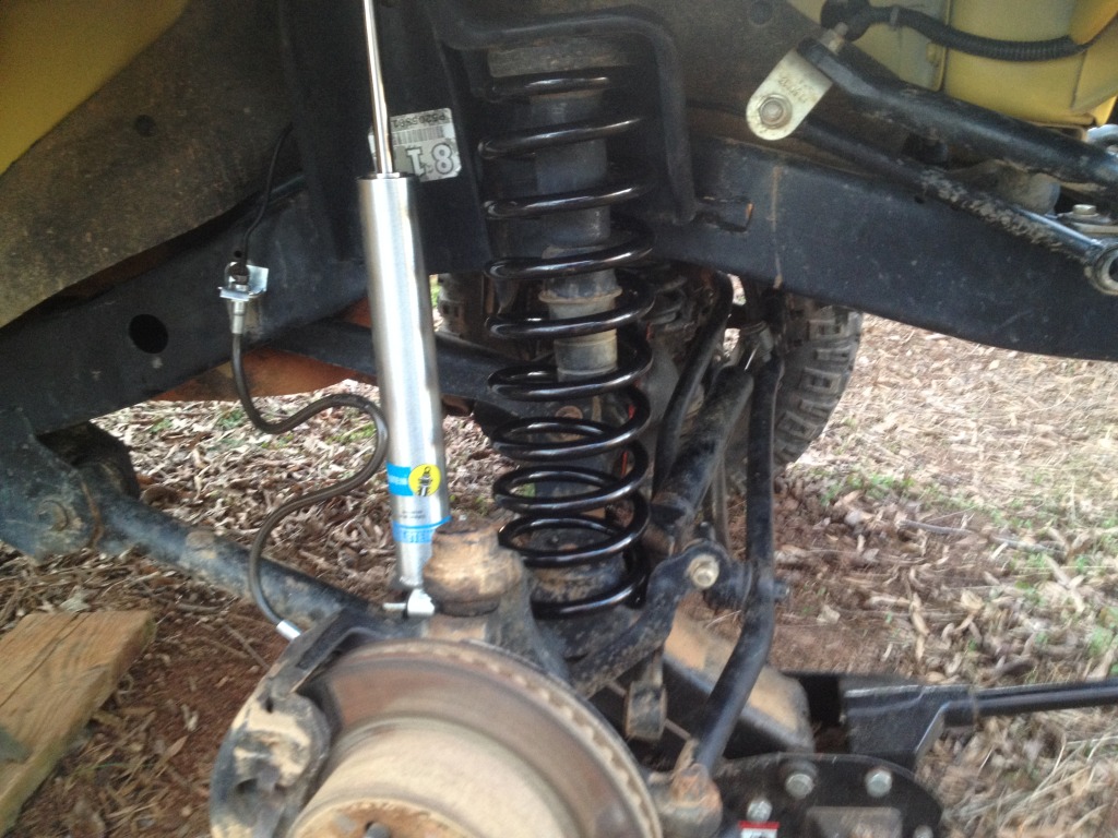

- Installed 3" BDS front springs and Bilstein 5100's. Have 2" rears and Bilsteins waiting to go on.
- Installed Metalcloak Rockers

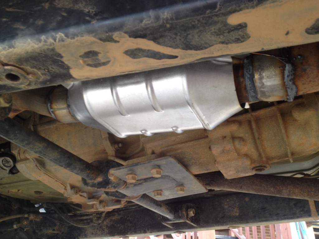

- Installed Walker Cat

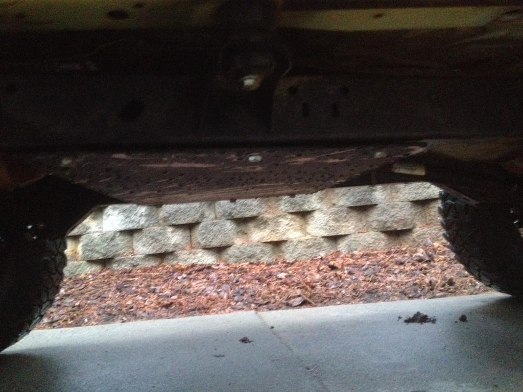

- Installed Flat Skid

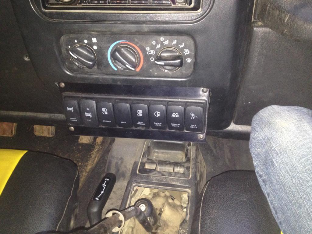

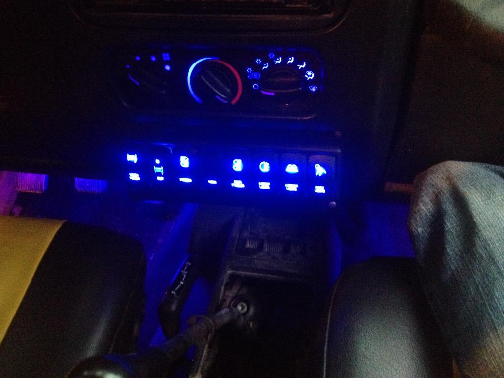

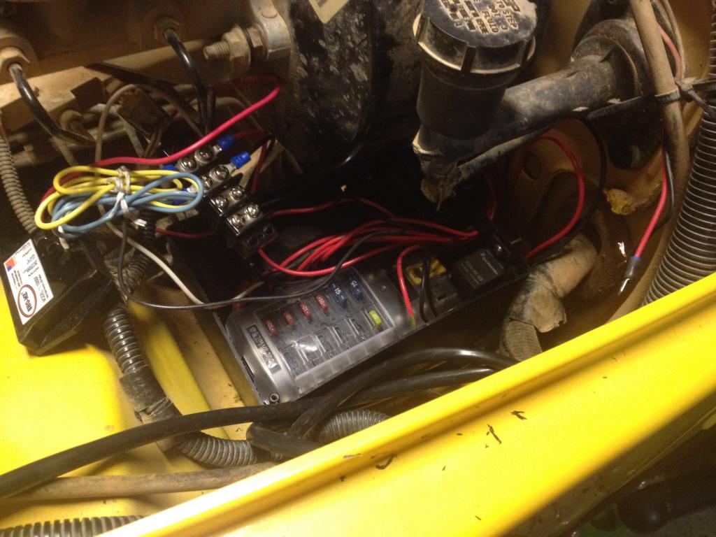

- Installed 12voltguy Custom Switch Panel, OTRATTW Custom Contura V Switches, Blue Sea Systems Fuse Block, 12voltguy In-Cab winch Harness, Sho-Me LED Flasher, and a bunch of wiring stuff
- Installed Crown Performance 3-4" Lift Braided Brake Line
- Painted Flares

(Notice the lack of driveline behind 8.8)
