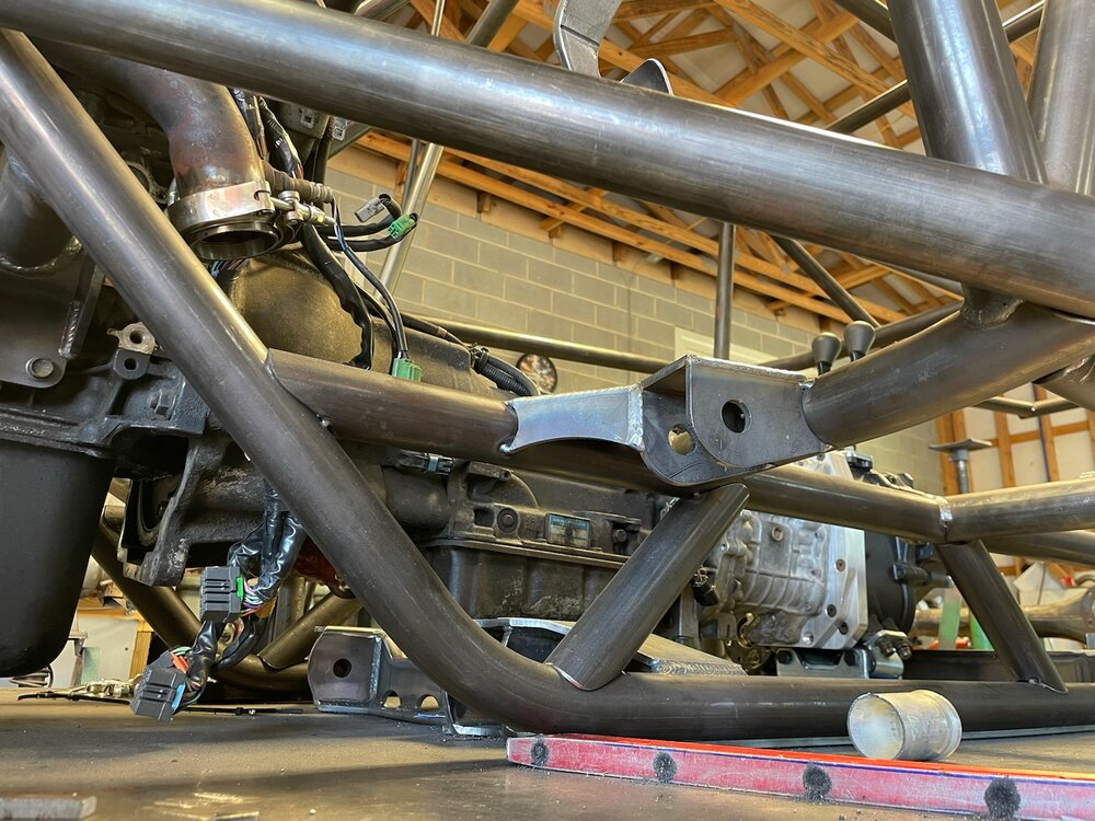

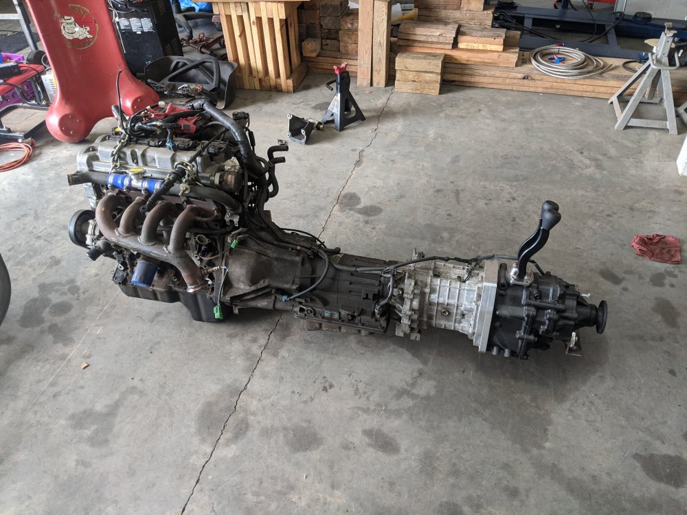

I stripped down my Sami buggy and took Chris a large trailer load of parts so he could get started. The plan is for him to build it out to a fully plumbed roller. I'll bring it home and tear it down for paint then reassemble it. Still undecided on the wiring, may try to get a few buddies together for a weekend or may just take it back to Chris.

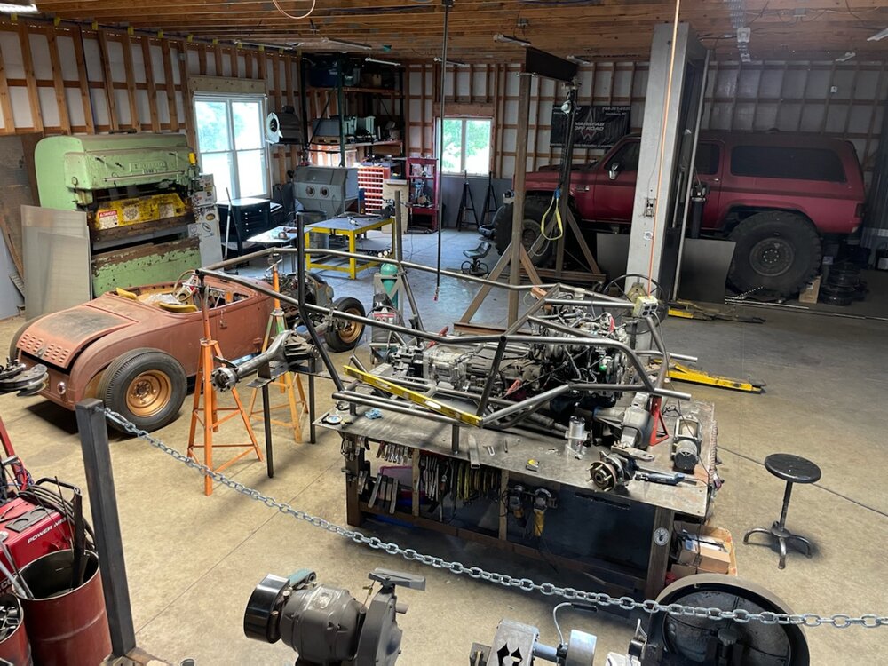

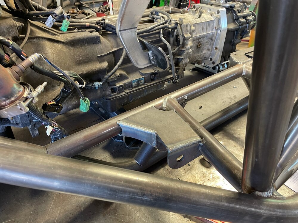

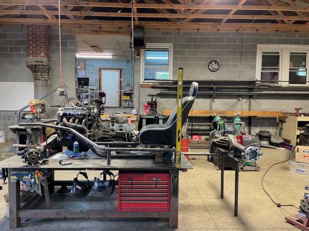

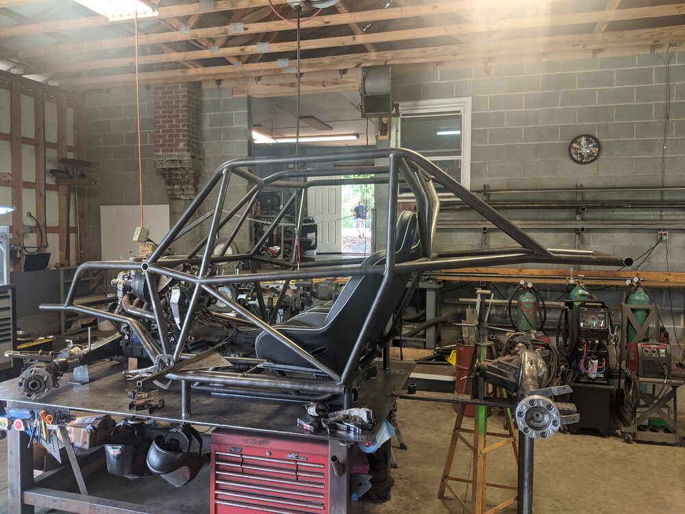

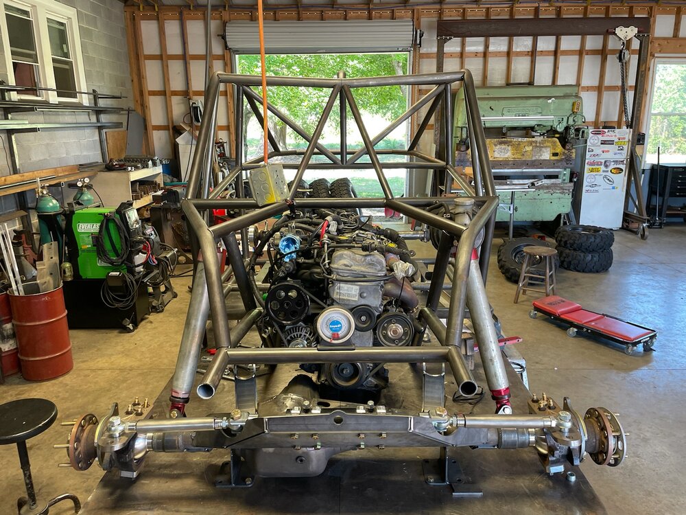

This is where it currently sits.

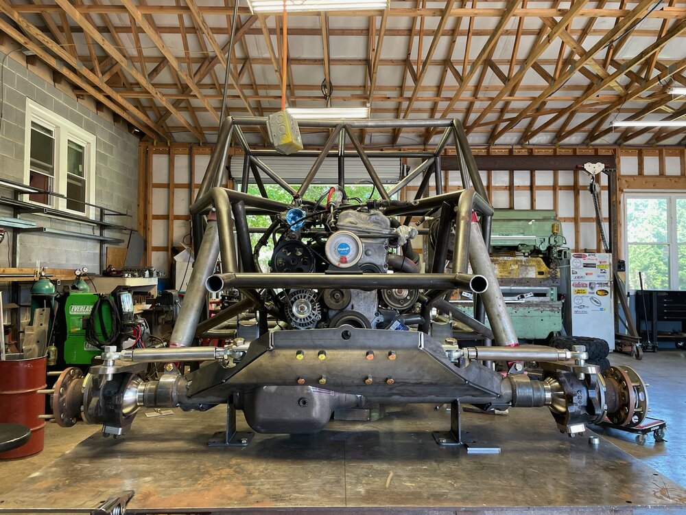

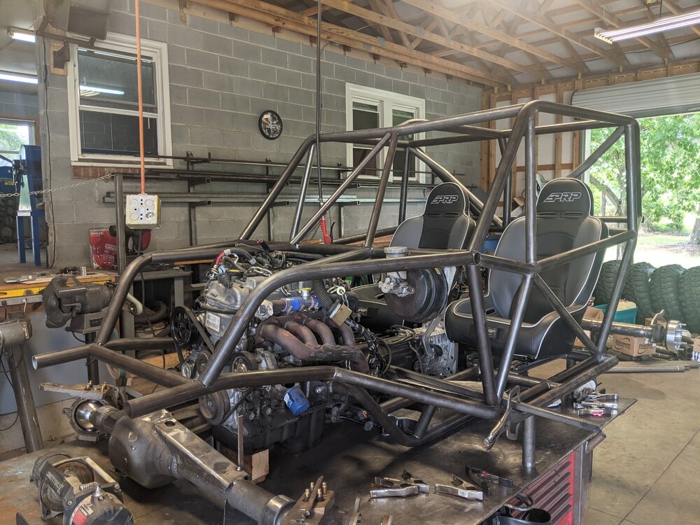

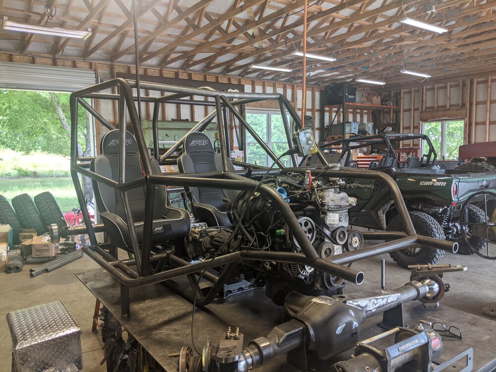

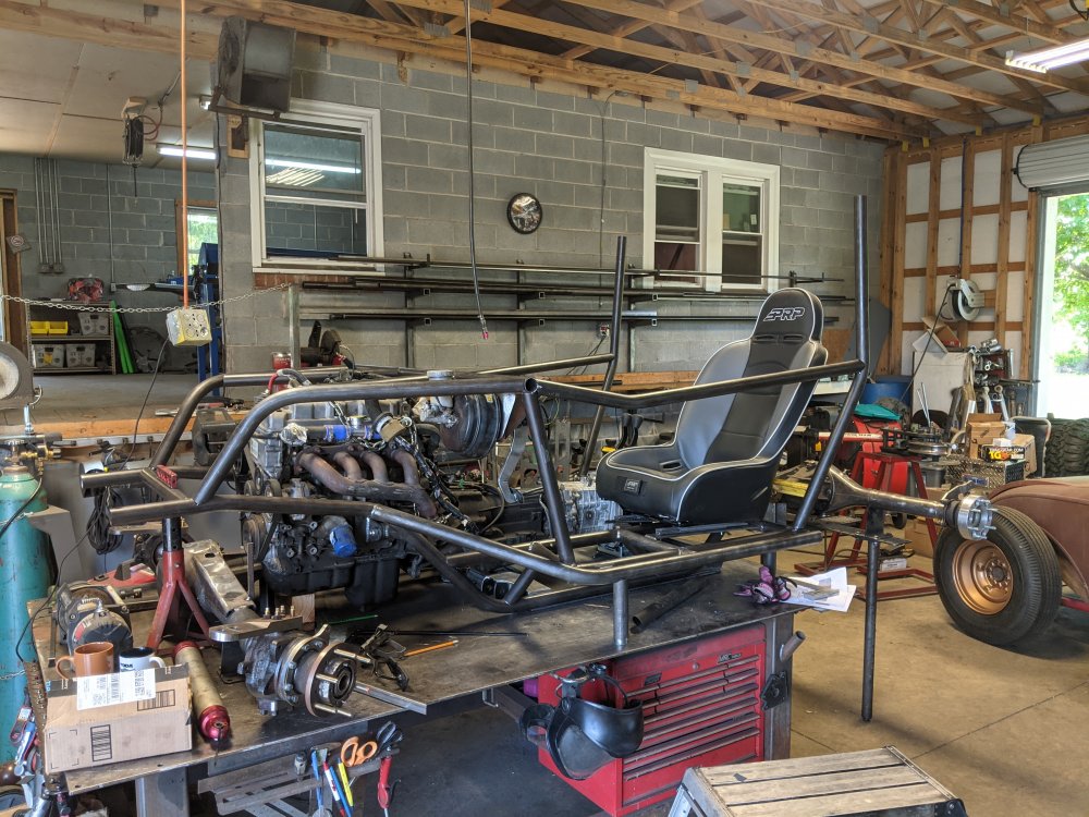

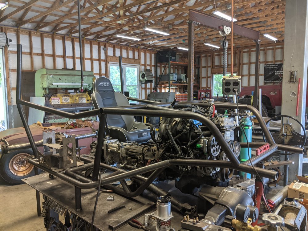

Using most of the parts from the Sami buggy but I did change/upgrade a few things.
2-seater
106-108 ish wheelbase
Suzuki 2.0L, auto trans, Tracker to Toyota t-case doubler

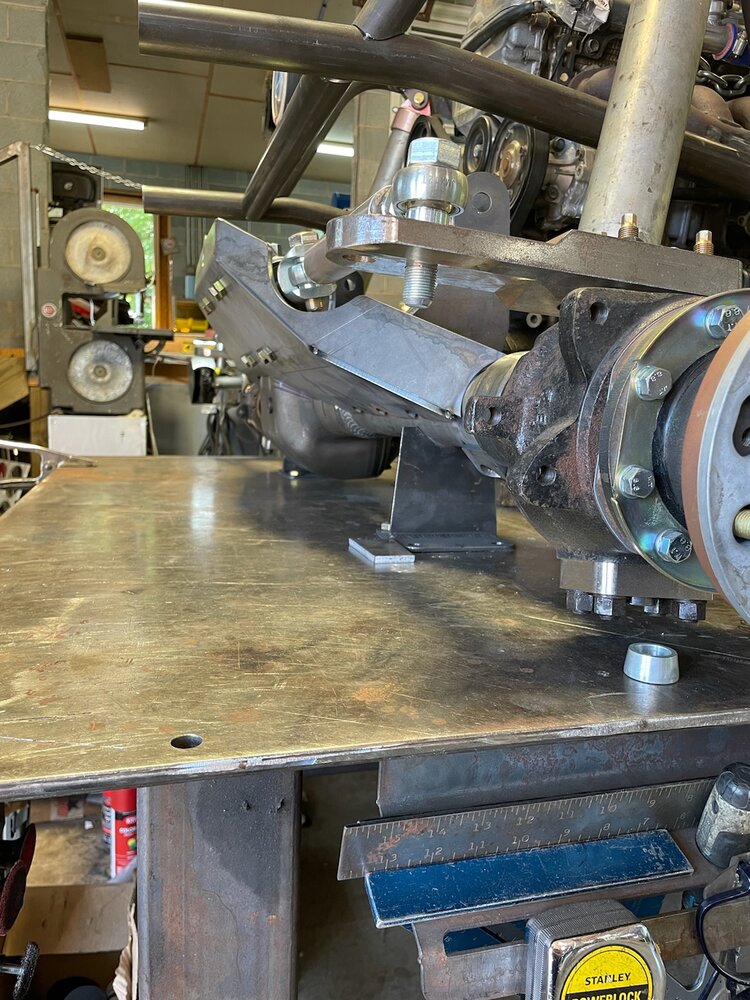

Trail Gear Tacoma width front axle
IFS rear axle

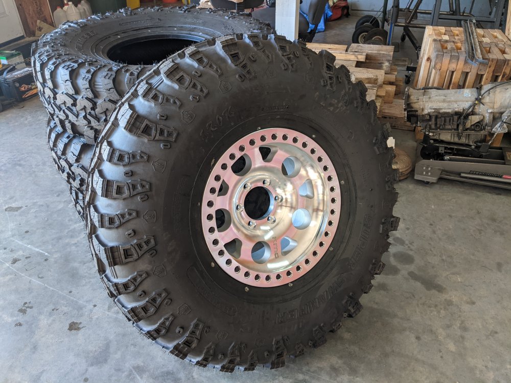

39.5 sticky Iroks on KMC beadlocks
4-link front and rear

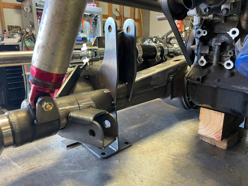

Air shocks (for now at least)

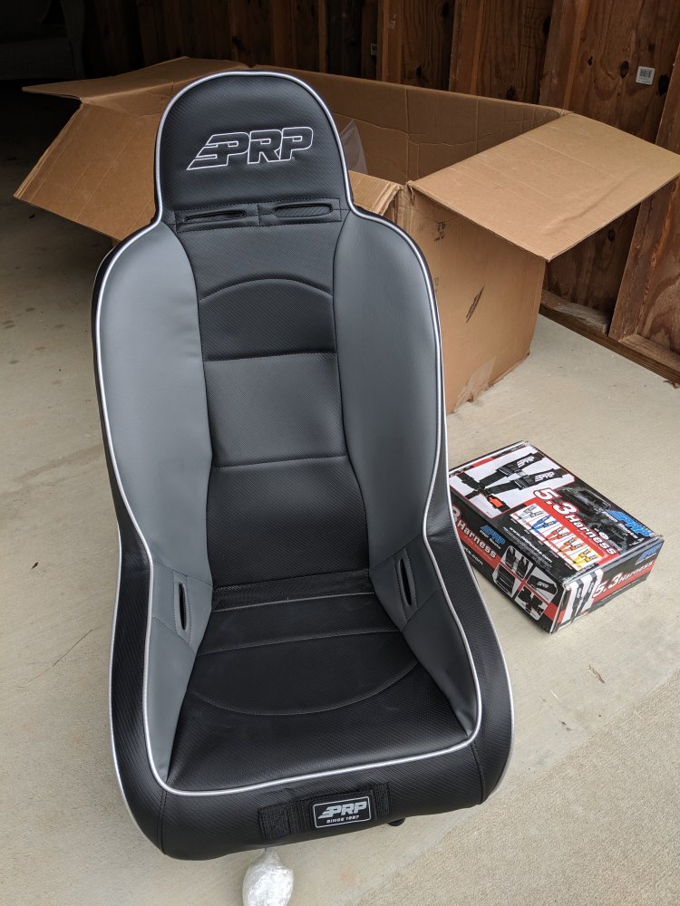

PRP UTV high back seats & harnesses

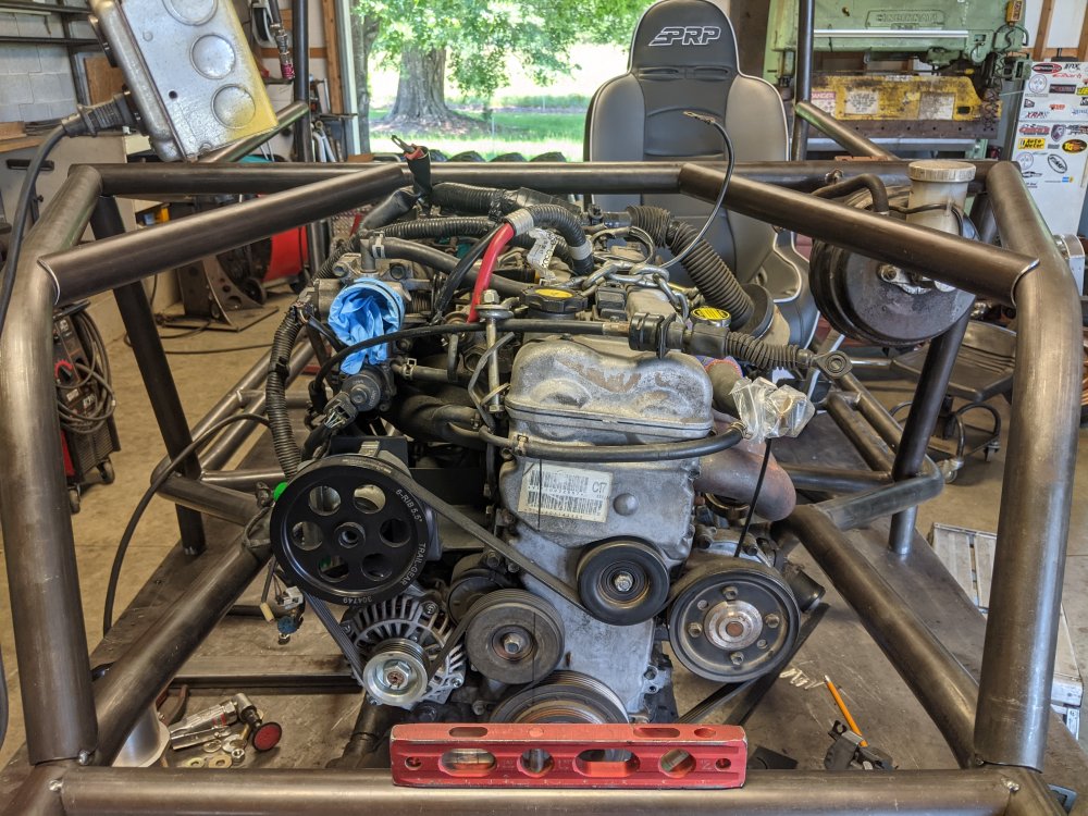

Ah I see now! From the table picture it looked like half of a v8!

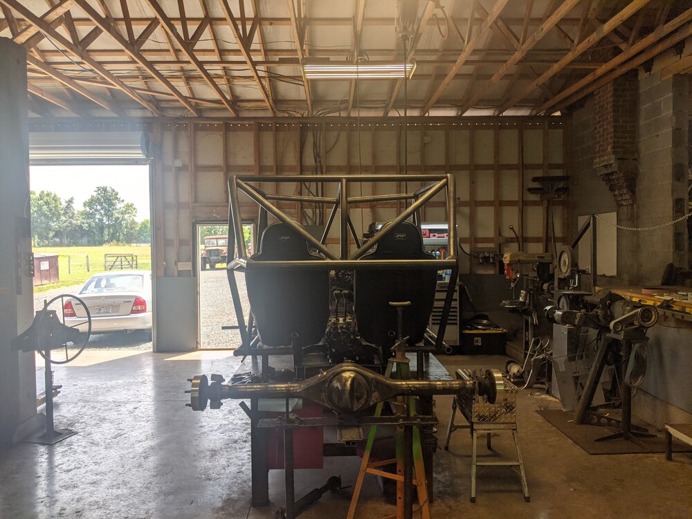

Chassis looks awesome... But I really want to know what's going on with that hanging chimney back there :lol:
When I bought this house 5 years ago there was an existing 50x22 block building on the property. The previous owners used it as a man cave. Had a wood stove, pool table and all his hunting gear. I added on to the back of that building with my new 40x50 so what you're seeing is the old exterior rear wall of that block building and its chimney protruding out. I have since removed the wood stove and put my CNC plasma in its place. My original plan was to build a "range hood" thing to hang over the table and draw fumes and dust up and out the chimney. Unfortunately I decided against it because I'm worried it'll just drop soot all over my metal roof and speed up the Sanford and Sons appearance of my building....
And before you say it... :) Yes I know I would love to have kept the wood stove. There's nothing better in the winter but years ago I had one in my old shop that we used constantly. (my neighbor was a pallet shop so we had an endless supply of wood) Over the years I had a few customers complain about the smoke/wood smell in their vehicles after they sat inside while being worked on.
