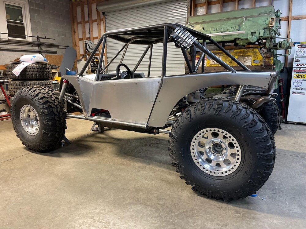

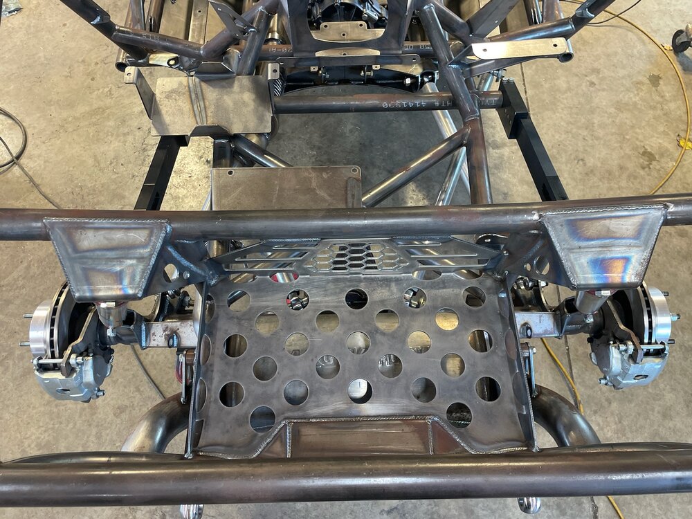

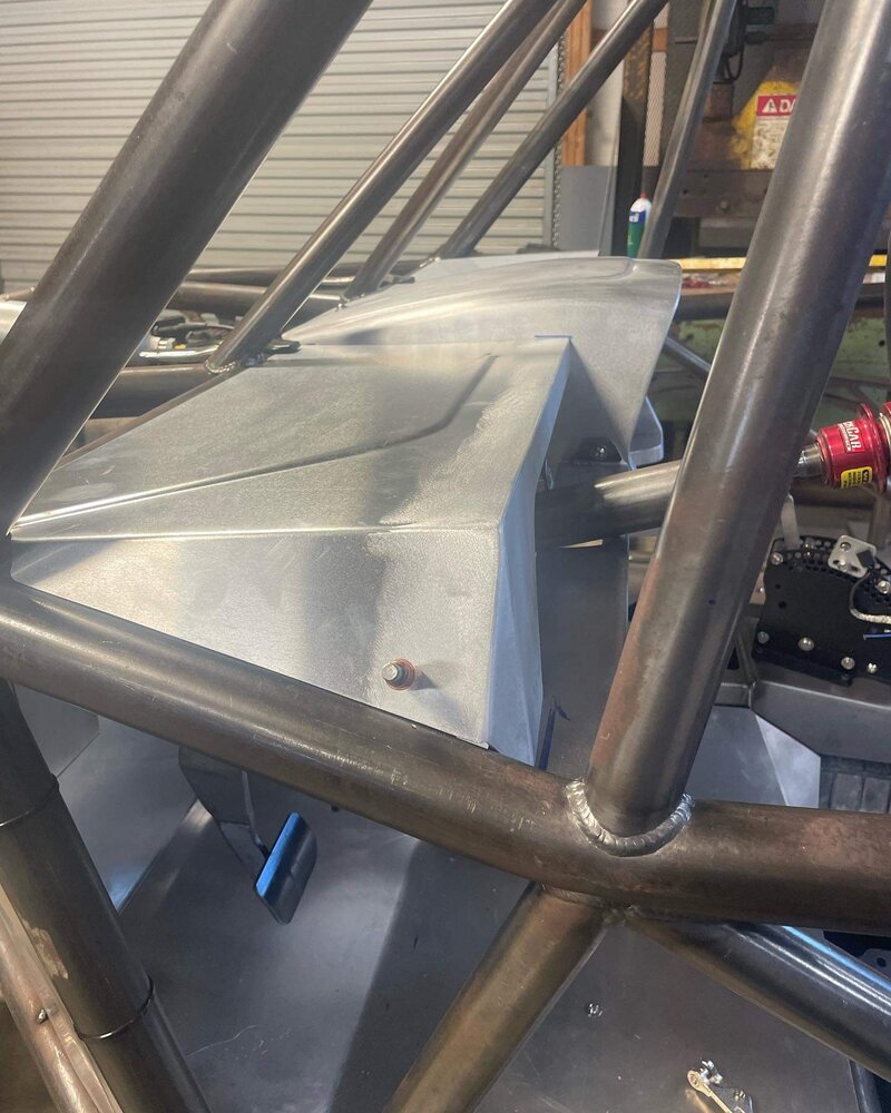

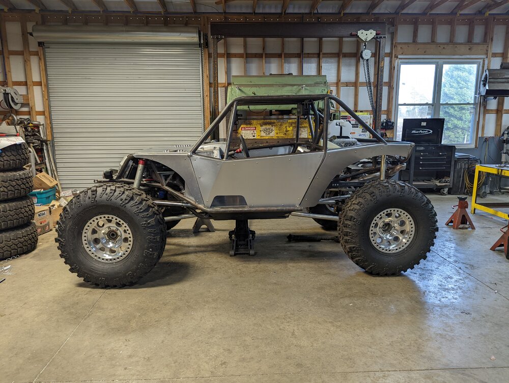

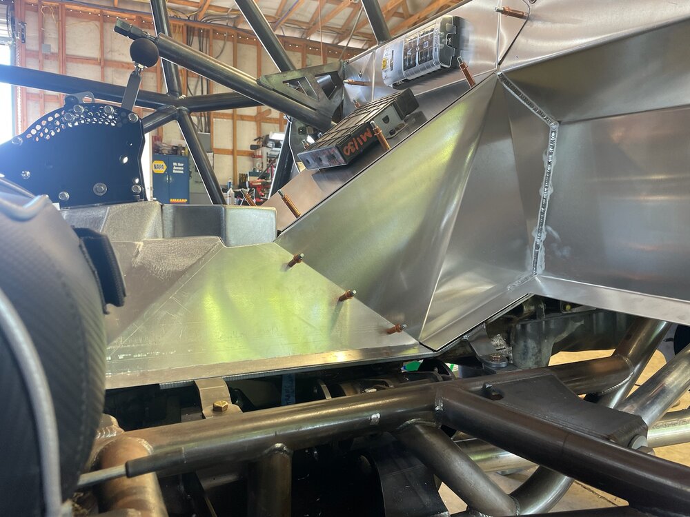

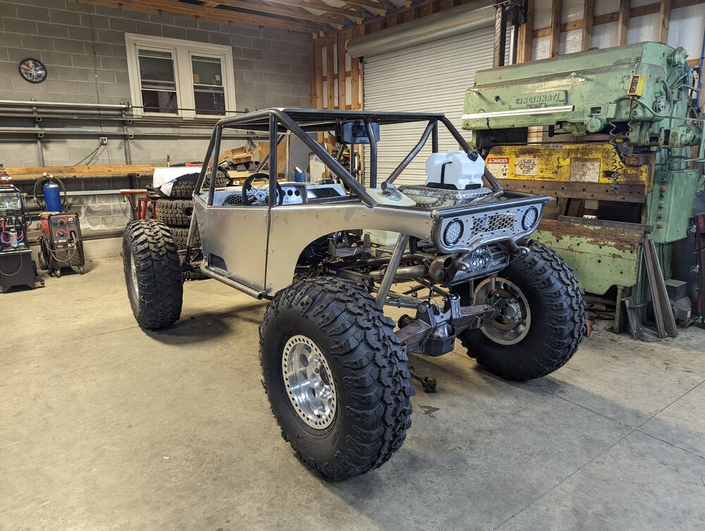

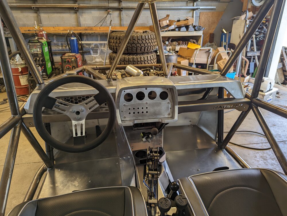

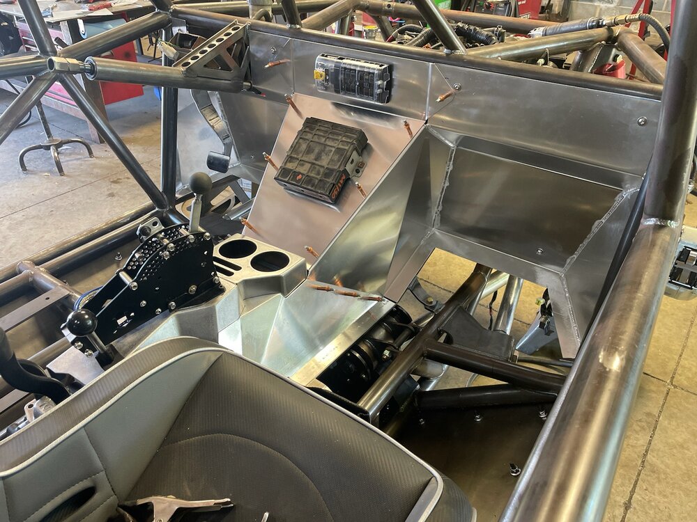

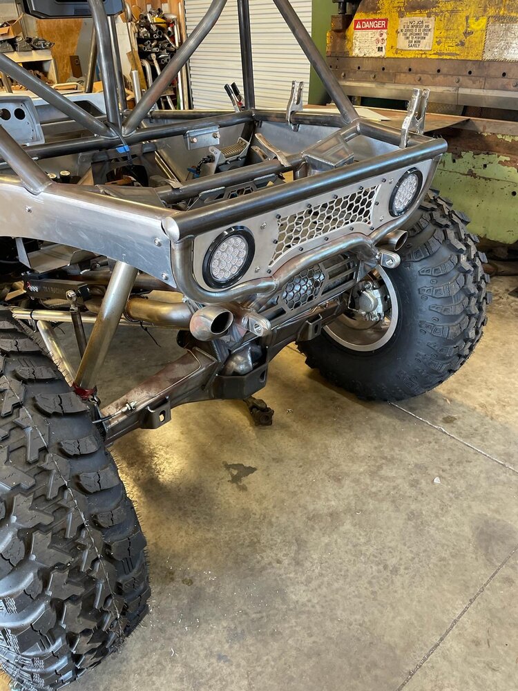

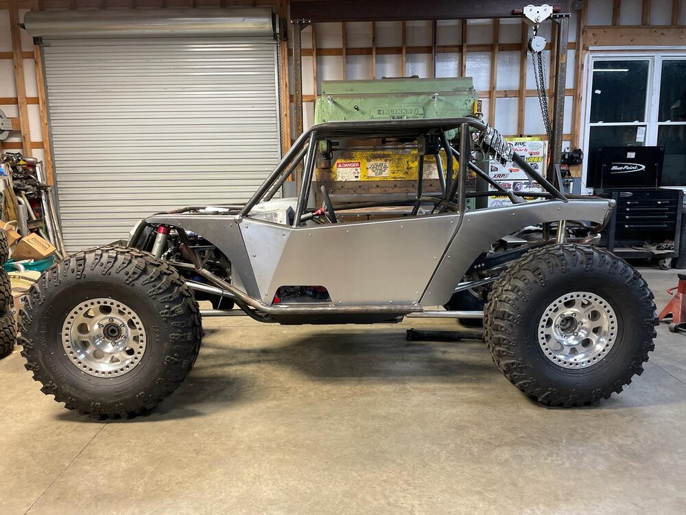

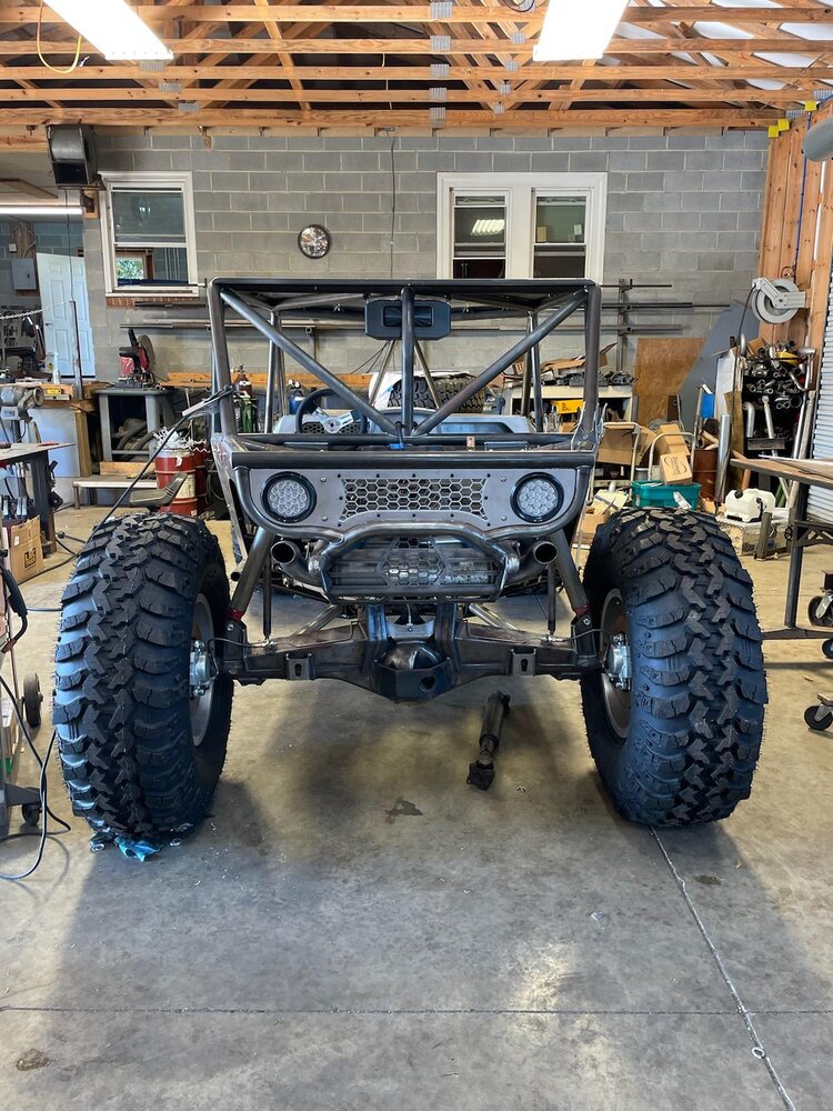

Chris has been working but I've been slacking on updating since I got back from vacation.

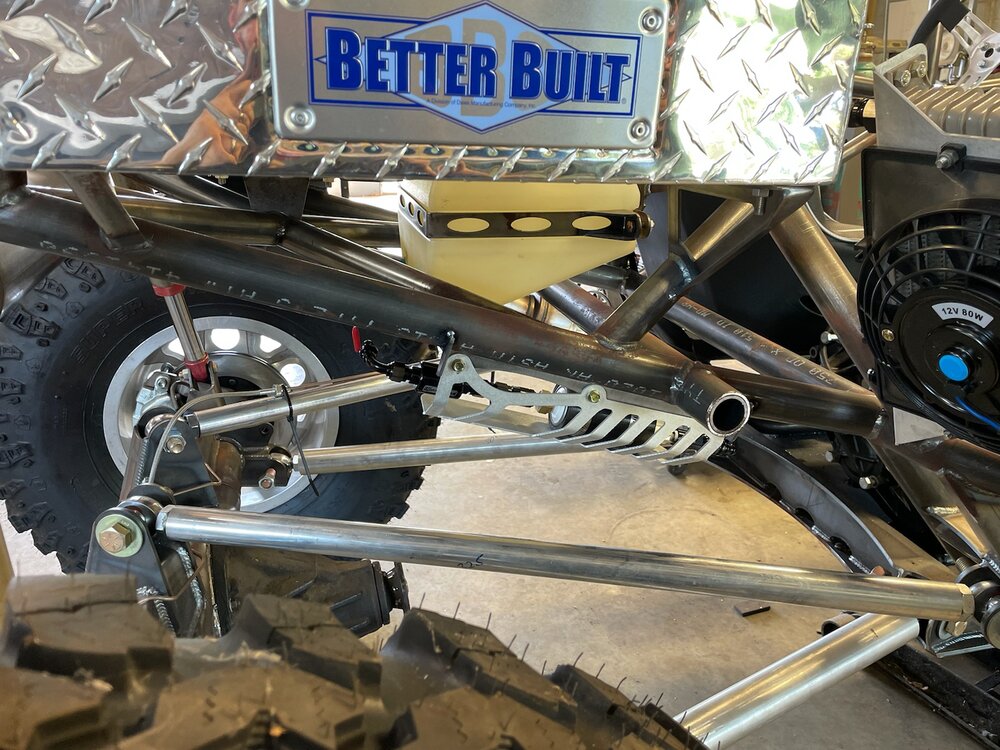

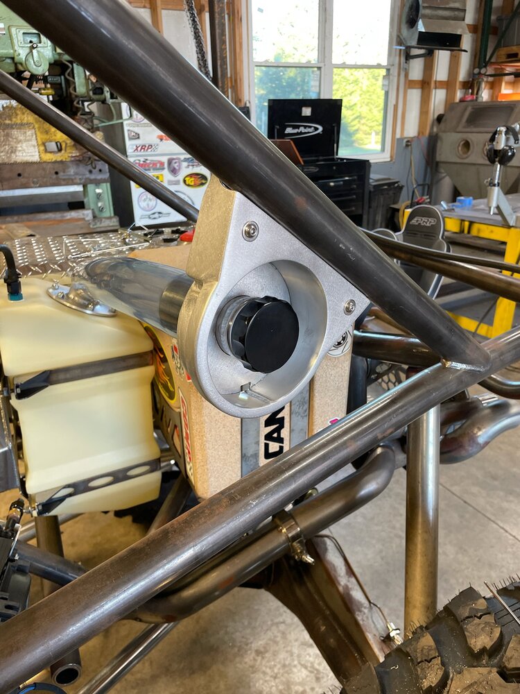

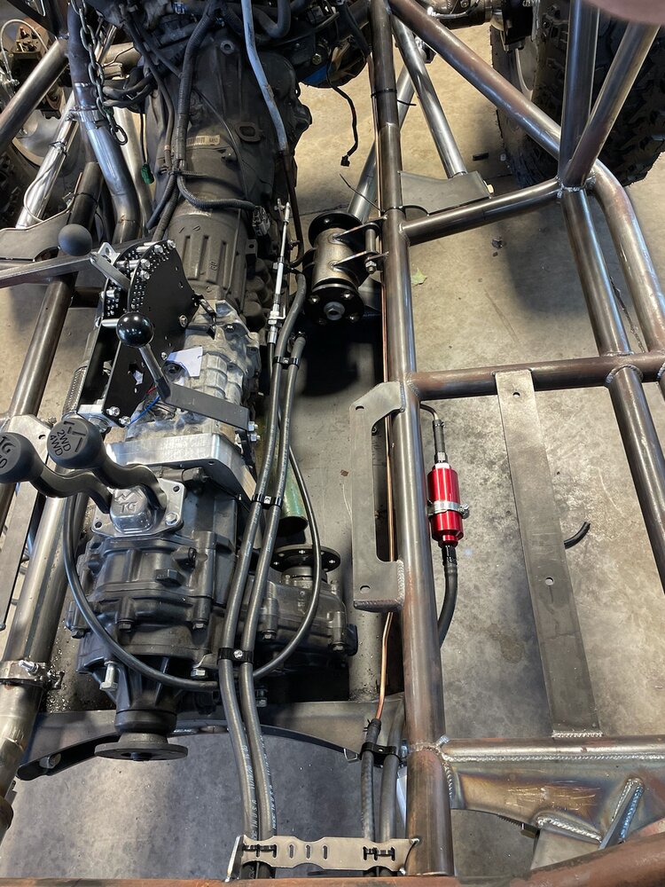

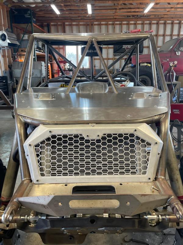

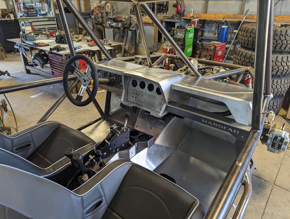

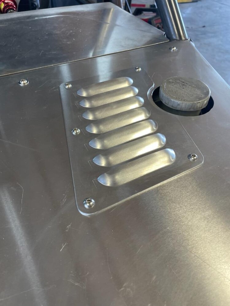

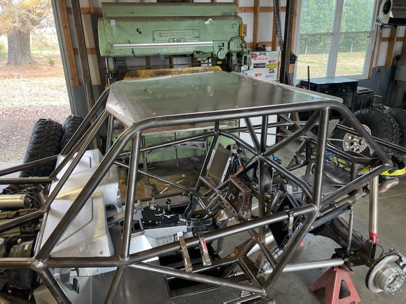

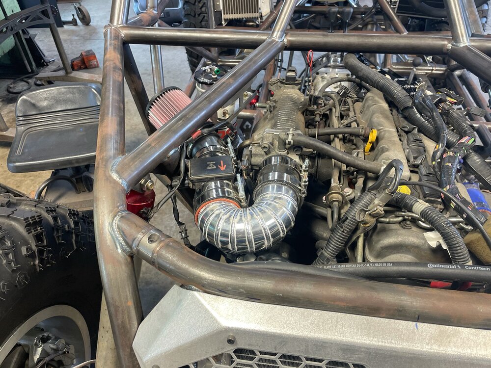

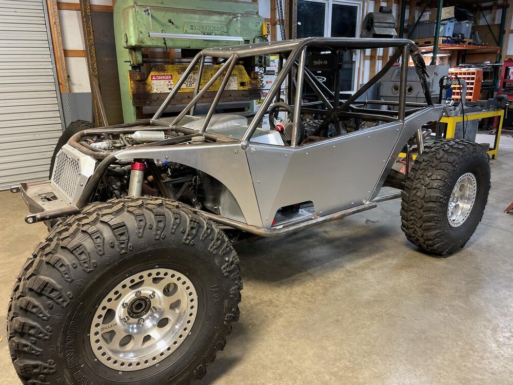

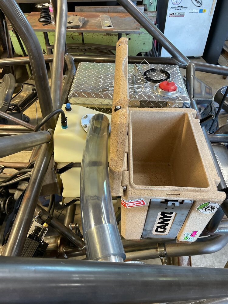

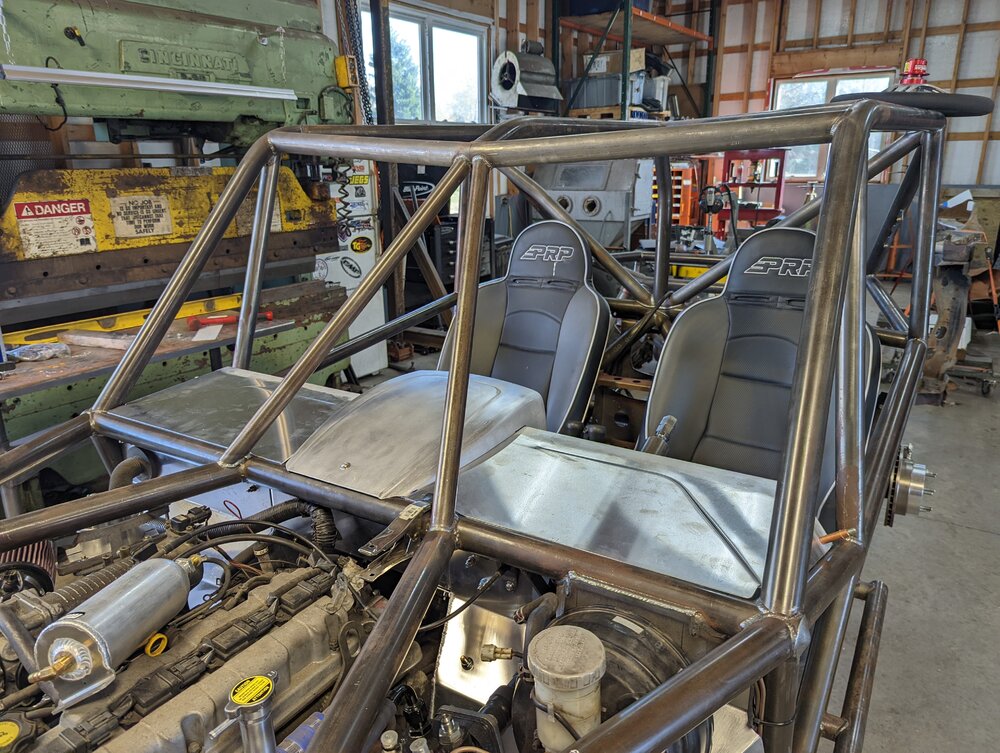

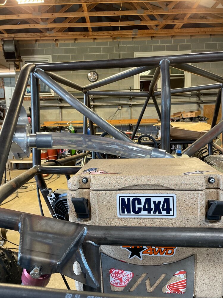

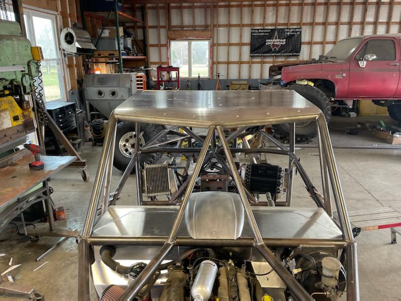

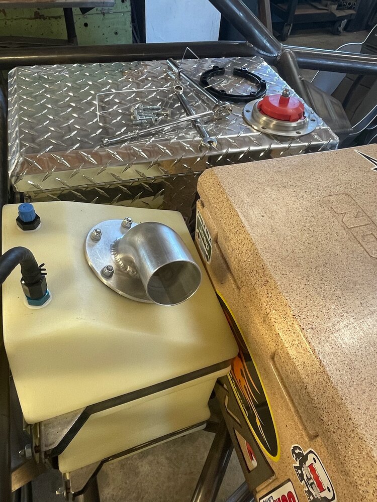

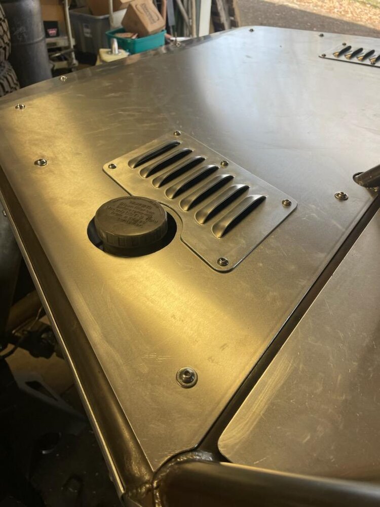

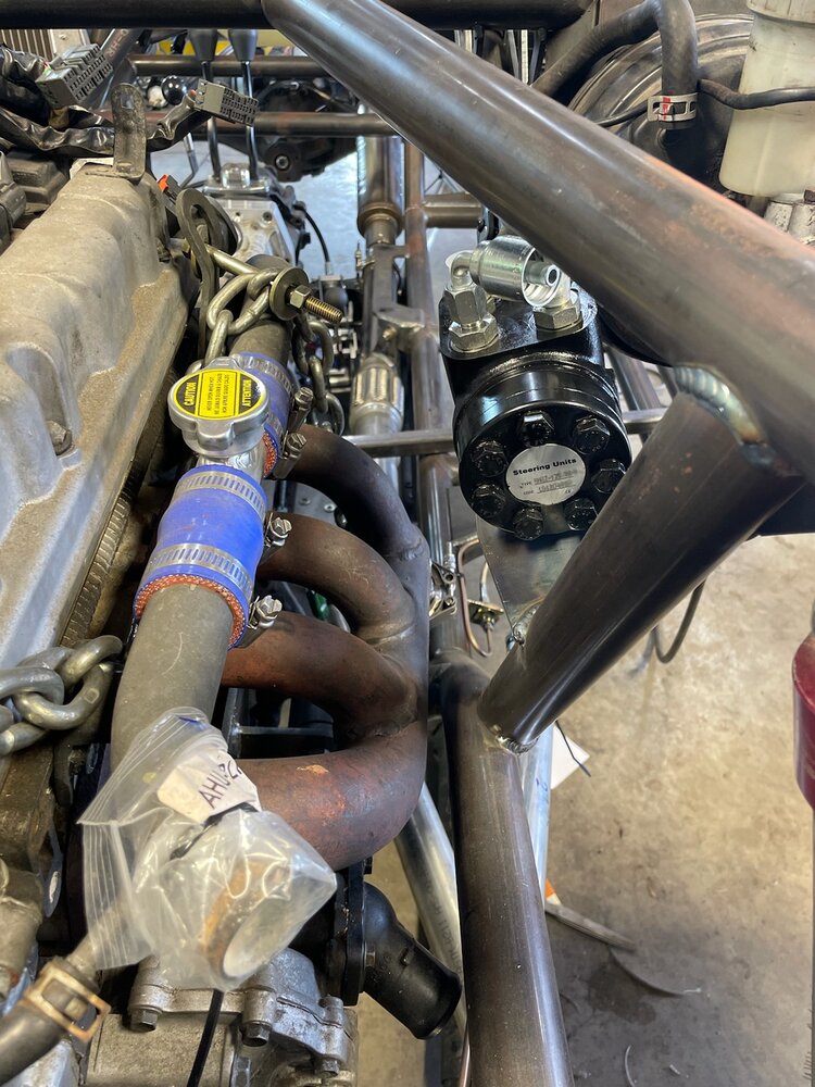

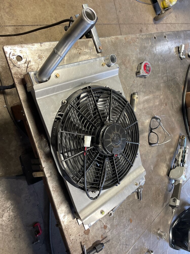

Brakes and fuel system are plumbed. Remote fuel filler is made. Intake is done. Fan shroud is done. Orbital is mounted He's working on plumbing the steering now.

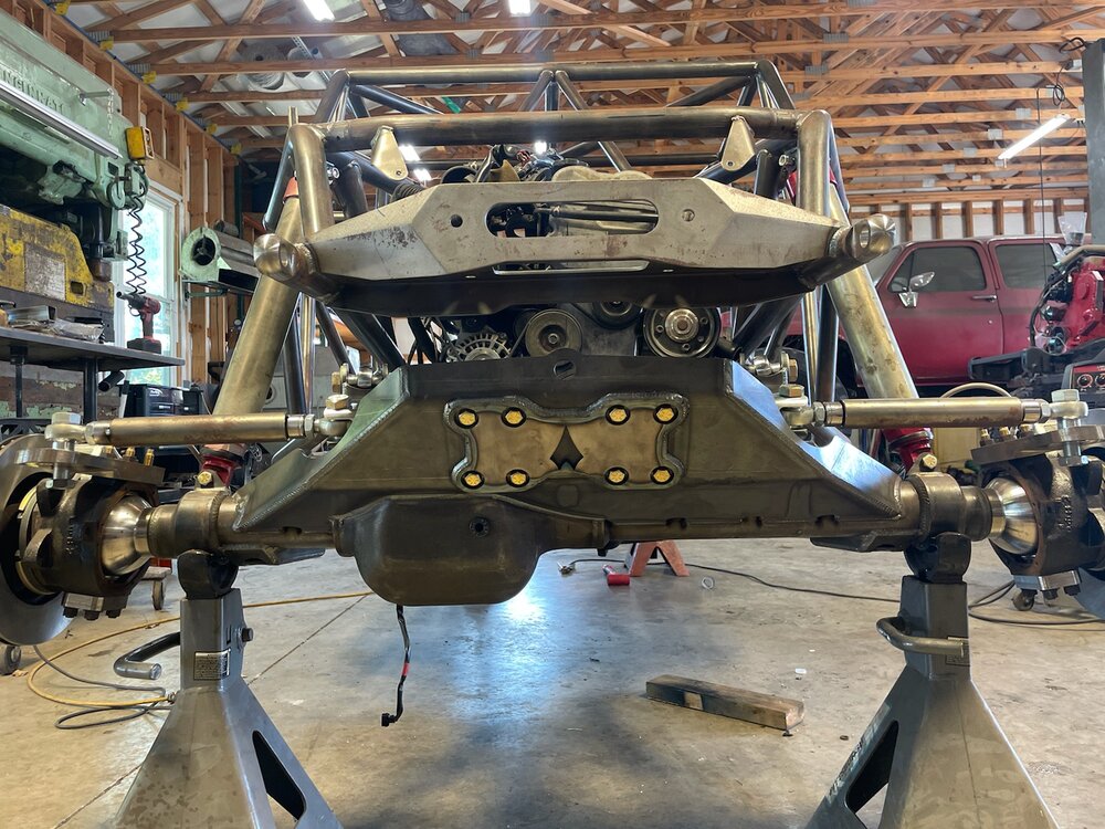

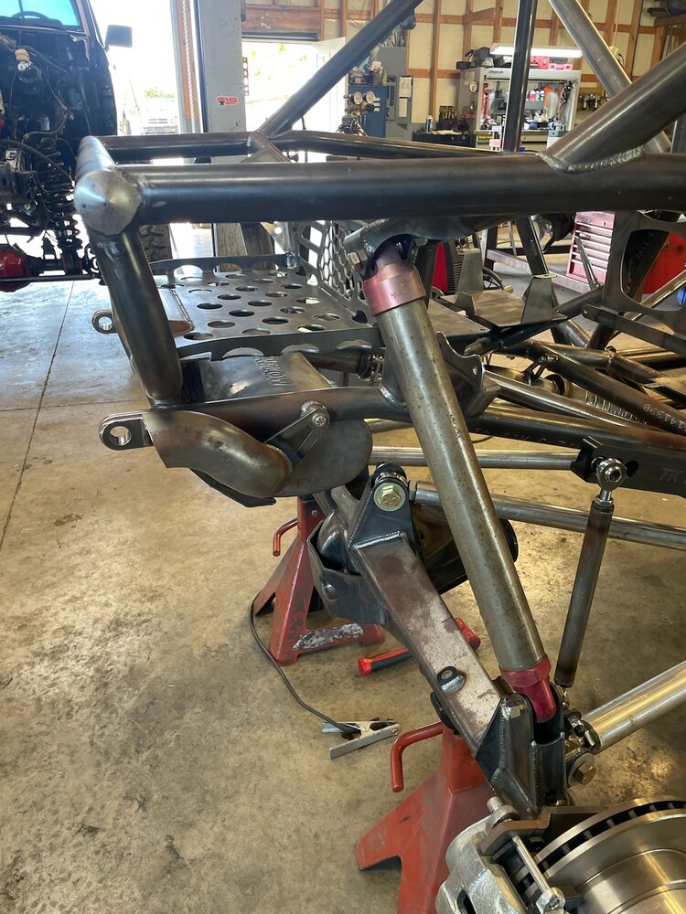

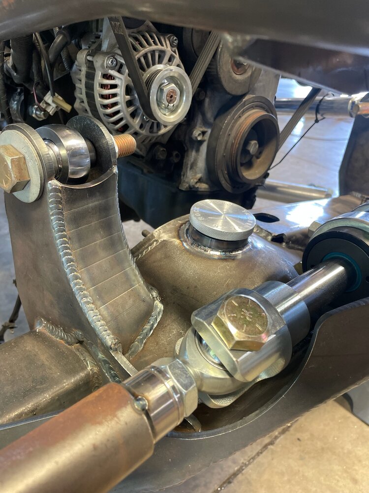

How does all of this welding not warp the steel? AWESOME job BTW! That's beautiful!
Warp which part? Warpage on the chassis is usually negligible. The axles are where you have to worry about it. Most of the welding on the axles is done in phases allowing it to cool between welds and trying not to do any overly long welds on the axle tube consecutively.
Axles is what I was concerned with...

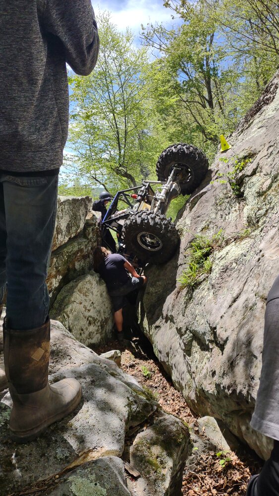

I just think about that ole boy stuck between those 2 rocks at the ranch
