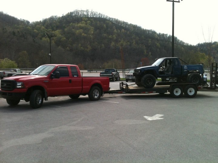

I've towed with both. Dad uses a tag drop deck 24' 14k lb trailer to tow his bronco. I use a 24' 14k deck over to tow the rig in my profile pic. I tow with a 03 f250. The drop deck seems a little more stable in corners but the difference isn't that noticeable. Its not enough to change my driving style, but the deck over with a tall load and you know if there's a headwind.

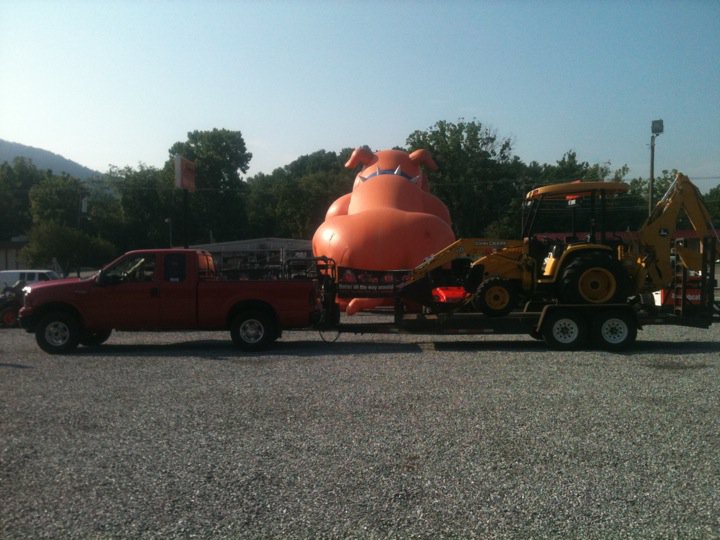

For comparison: My old 16 w/ 2 ft dove equipment trailer and an extended cab truck that had been bobbed ;)
I had enough room to move the truck all the way back to the ramps and put a Polaris Sportsman 400 or a Bombardier Traxter up front, but that was it. And even then they were usually touching.

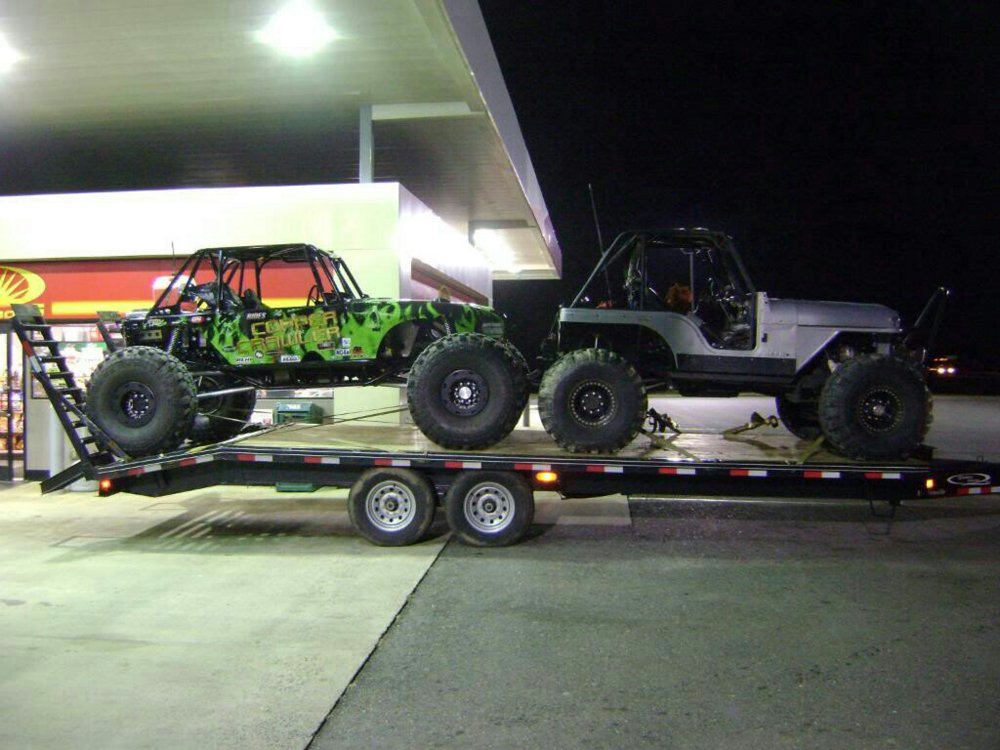

ascontent_a_iad.xx.fbcdn.net_hphotos_xaf1_v_t1.0_9_205744_8351d58ad8cd21ee46eb7e033af72799e839.jpg
HD Equipment trailers...the only way to go.
ascontent_a_iad.xx.fbcdn.net_hphotos_xaf1_v_t1.0_9_268423_8969c6e7f27182178b3e270615b2906b8766.jpg

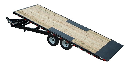

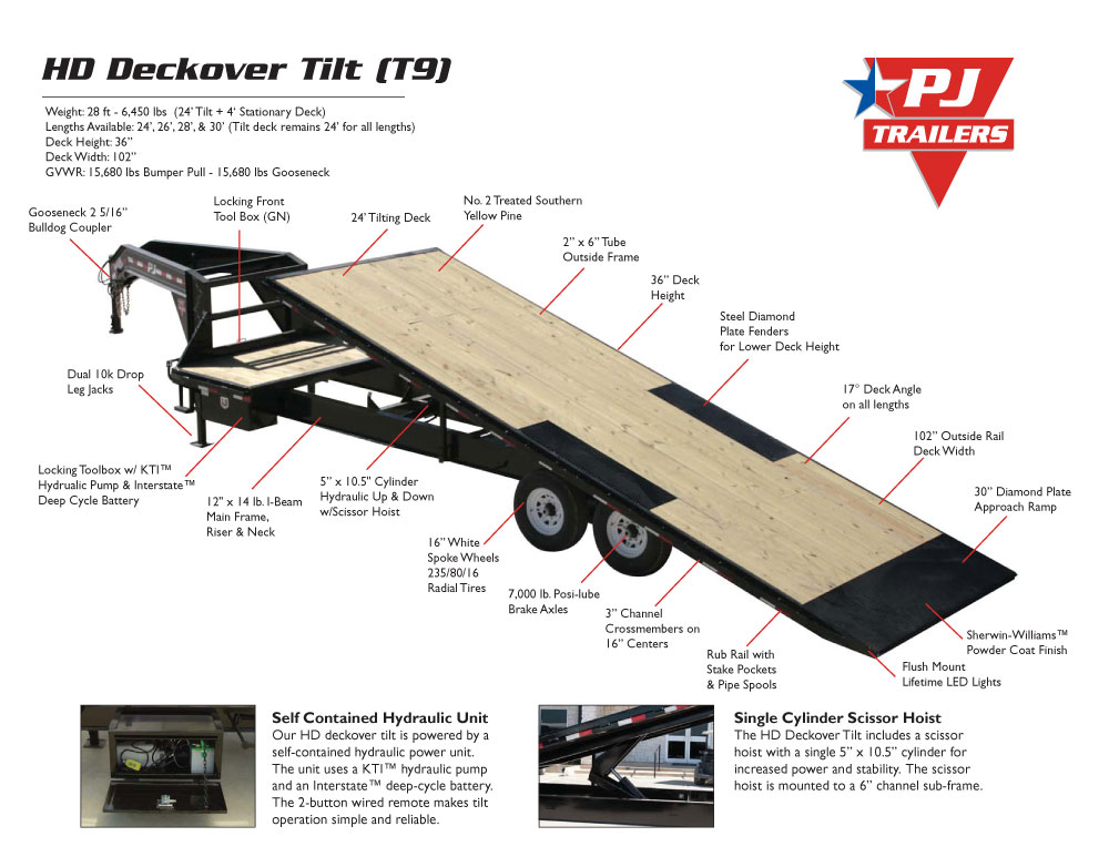

http://www.pjtrailers.com/trailers.cfm#Tilts
There are other ways to do the tilt. I believe I like ^ better, but there might be some advantages to this. Once I have a big pile of cash, I'll think about it more and then go buy one.
