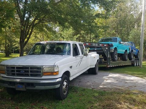

Side note: we have a 1996 F350 dually flatbed at work for small deliveries. 460, 5 speed, 4x4 with 4.10s. I guarantee her F150 would out tow it in every way. Braking being the primary advantage of the newer truck

I guess this is where I’m getting lost. OP’s two rigs combined (3500lbs/ea...google actually says less in stock form) are only about 800lbs more than hauling a Bobcat s175 (6200lbs). I don’t think anyone would give it a second thought or consider someone an idiot if you see a 6200lb bobcat on top of a 10k trailer weighing 3500lbs behind a 1996 Ford 350 with trailer tow rating of 10,000lbs. I think we can all agree 11,000>10,000...so what does it matter if it’s a 150? I’m legitimately asking.
