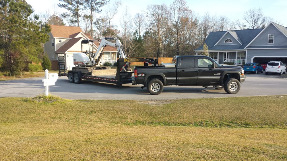

In my opinion, gooseneck is a totally different game because of where and how the forces are distributed and what it does to the way the truck is loaded. Brakes may still be an issue, but that's about it.
It hauls it pretty well. There's a VERY small window of space to properly place it on the trailer though. It's gotta be juuuuuust right or it'll either buck constantly or there's not enough tongue weight to make the trailer brakes work as well as they should. I've about figured out that the blade should go right over the split of the deck boards though, so that helps. If the trailer brakes weren't pretty awesome, it would definitely suck to stop. The PowerStops made a nice difference over stock stuff.
