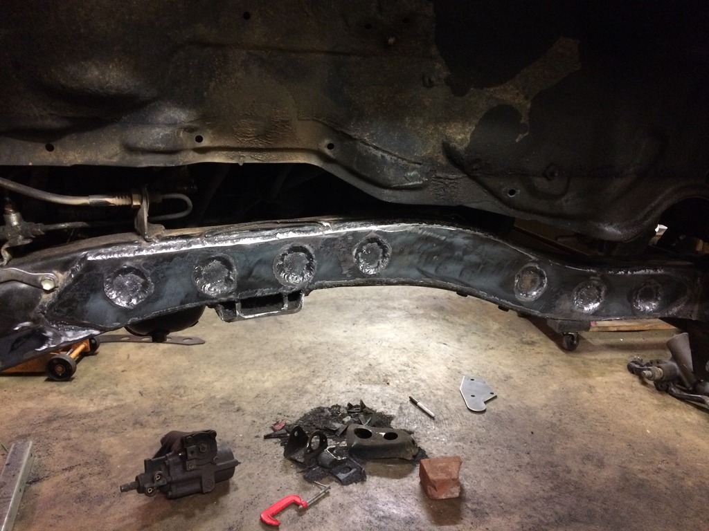

Found a bit of rust on the frame. Since I was cutting a lot of the mounts off I was able to fix the rust fairly easily and made it stronger than original. I plated most of the rear. Finished my chevy 63 swapped and got the truck pulled into the garage for a front end tear down.

I actually thought about cutting it and linking it, but I had a bunch of 3/16 plate and angle in the shop. So I cut some side plates and plated the frame back. Also I don't know what you're talking about as far as the seats go.

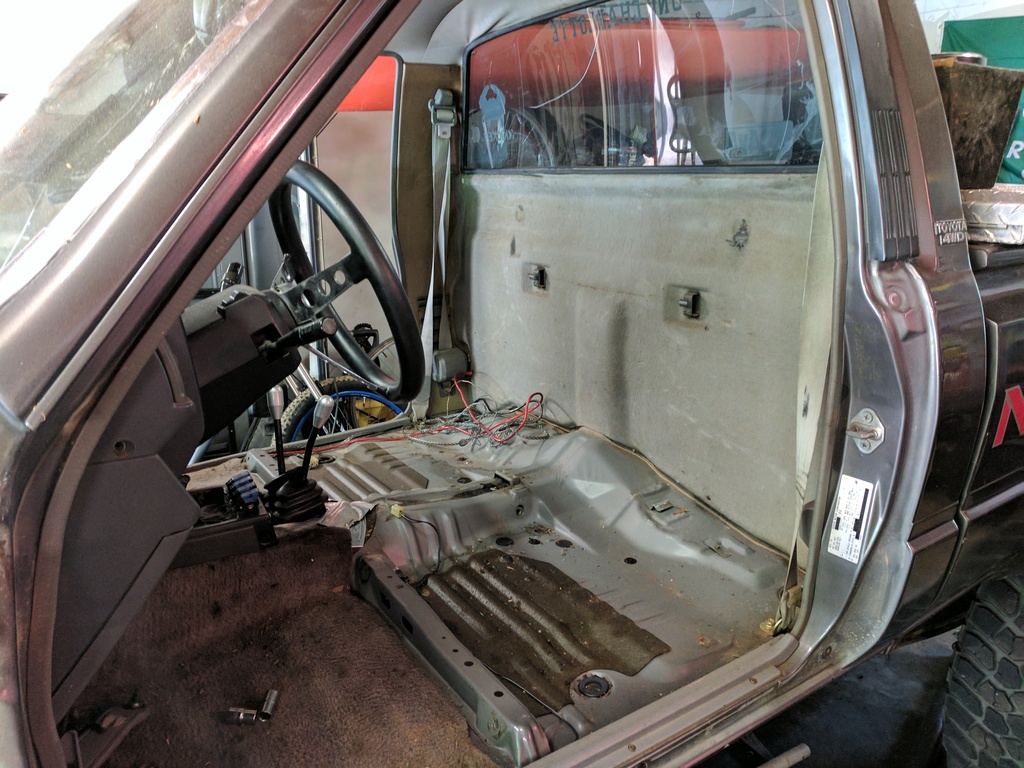

Or do you mean these seats? :flipoff2: I made some custom brackets and they sit a tad low but fit me really well. I may add some rises and raise them a bit but I'll probably run them as is for a bit.

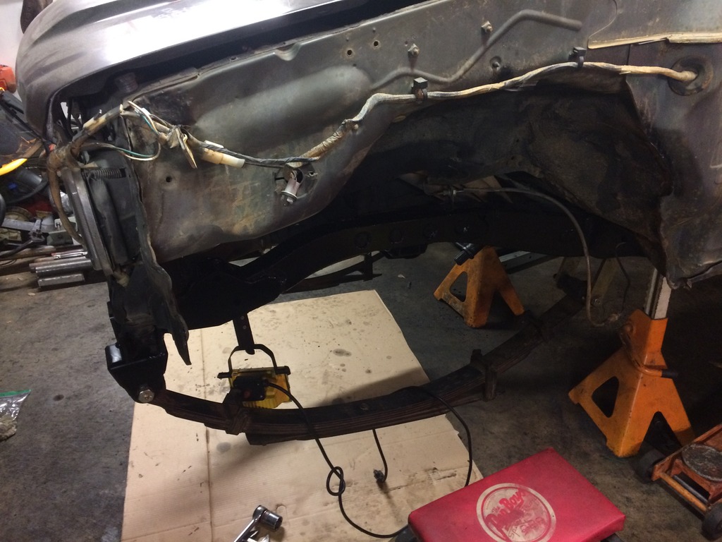

Got the front factory hangers, shock mounts, dogbone mount cut out with the plasma, took a big chunk out of the rad support for the steering box, plated the front frame with reinforcement plates, mounted my front spring hanger, and steering box. Also managed to rebuild my front axle since the parts from ECGS got here,
