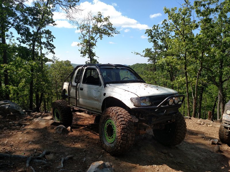

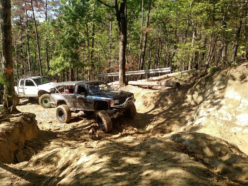

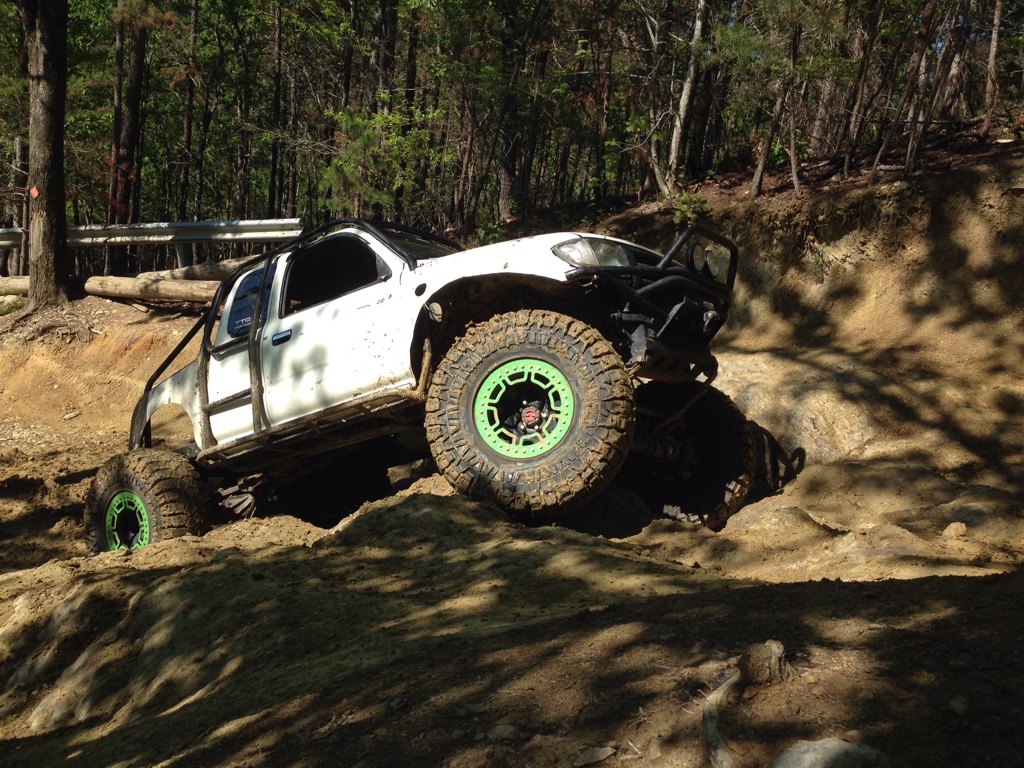

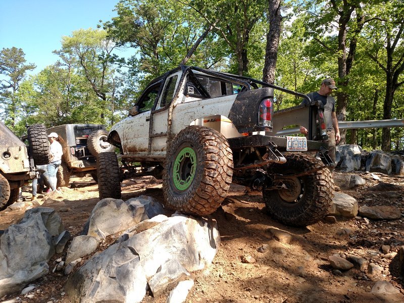

Been busy with wedding stuff but did manage to find a few hours Sat morning to put around URE.
awww_tacomaworld_com_media_img_20160423_100826709_514249_full_f92040350af6f8415243d8ee6ad12b7f._.jpg
awww_tacomaworld_com_media_img_20160423_110309343_514248_full_f92040350af6f8415243d8ee6ad12b7f._.jpg
awww_tacomaworld_com_media_img_20160423_110439870_514247_full_f92040350af6f8415243d8ee6ad12b7f._.jpg
Dip was on there for over a year. It had been brushed on trees, rocks, went through a rollover, and was just starting to look rough. A lot of it was stained as well
