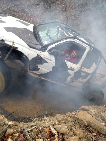

Coming out of shipwreck. What a mess that was
awww_tacomaworld_com_media_img_20160326_172039170_510154_full_a827c9fea7ca4656b1b1de4a735a0b6f._.jpg
Palmetto Crossing
Coming out of Shipwreck after a massive burnout that @ObeseFieldMouse conveniently didn't get on video haha
