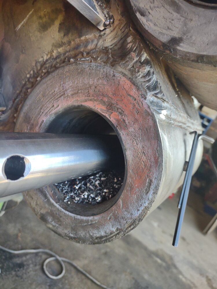

The bore on these allow for .208 clearance between my bar and the finish size. If I had a small bar it would be a bit easier. The sacrifice would be rigidity of the set up. I made the mistake of building to much of the id with weld only once!! Boy that sucked. Lots of die grinding latter I got the bar back in to get to cutting.

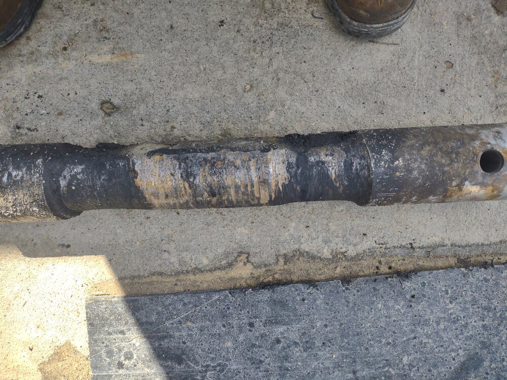

On another note I put over 30 lbs of wire in one job on one hole and faces. View attachment 433067
80 plus millimeter shaft.

Anyway, wouldn't be hard at all to make a smaller bar--don't know what kind of tooling you use if that square broach is necessary but wouldn't be hard either. I assume there's a keyway down the length of the shaft?
That's a sweet setup, might need to drop a machine off with you.

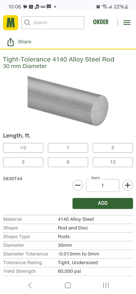

I was thinking the same. Be a lot easier to just order precision ground bar. Thomson Linear has just about any size you can think of:
@braxton357 @jeepinmatt many folks built all the need equipment for years. Until the recent only a few companies made equipment. All where really high end and very industry specific. Some make unit capable of holding ridiculous tolerances for huge stuff like power generation, steam, and the like.
China has caught up and making stuff for the masses. One or two are actually highly praised.
On the bar.....if I had the equipment probably. But the bar also requires the related set up bushings or (cones), bearings for the "carrier" brackets to allow the bar to turn free, and the appropriate bushes or adapters for the drive to turn it. At that point I'd buy it as a kit. I studied about 10 years on many machines and several publications on building it all from scratch.

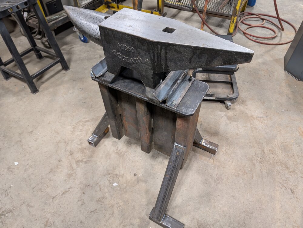

Been treating been boxes. Done some dental work after the line boring. Got my anvil stand done.

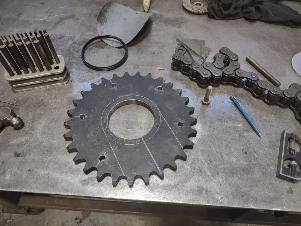

This popped up in my memories gadget on my phone.
Any guesses to it's purpose?
Looks like it would be to raise something up.
Nope!

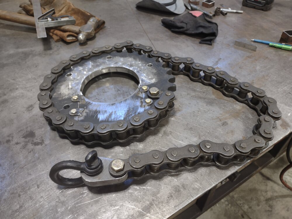

Edit: here's a hint for all. The bolt pattern in the sprocket got hardened dowel pins pressed in after this picture.
Ok, sooooo. It was late, the project sucked and we needed a solution.
Imagine a great big heated press. Like 40 feet long 10 feet wide. Has numerous cylinders that press and a heated platen with a bizzilion degree oil in it. And the press is north of twenty feet tall.
In the belly of this thing is a leaking gland and you can not get the cylinder out without wrecking half the frame and shutting down for extended periods. Cylinders measuring like 15 or so about 18 inches in diameter and 12 feet tall.
The sprocket had a window to remove and slip around the cylinder. Replace the window and with some sketchy spacers to hold it into the receiving dowel pins use a chain com-a-long (sp?) to apply rotational force.
Edit: The cylinder spewing oil had previously been monkeyed with. The company hired me to do several odd items and this came up. I felt like if the threaded insert was loose enough for this to work they had bigger issues. Turns out this was half the problem. They wanted a bandaid and I obliged by helping slap one on.

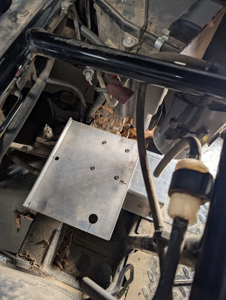

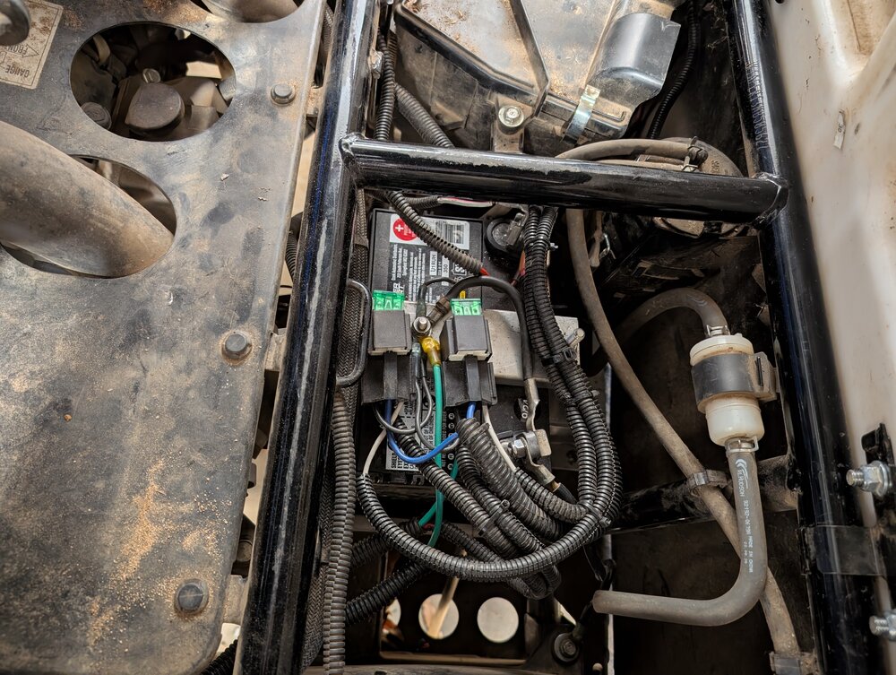

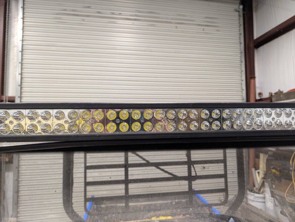

I finally stuck them on something. This winter I was lacking for light using the Mule. It has a horrible battery issue since new so we upgraded. I move the location to a more serviceable area and went up double the cold cranking amps.
Required fabbing a new battery mount. I ripped an old plastic tray from a lawn mower I need to get out of my way. Had a nice drain tube and fit the desired location and battery.
The once easily removed bigger battery is now covered in wiring. So much for simple. I can lay most of it back in units as it's wired. Not terrible but simple left went I decided to use the light bars I acquired from a nice bearded fella! A few years ago? 😂

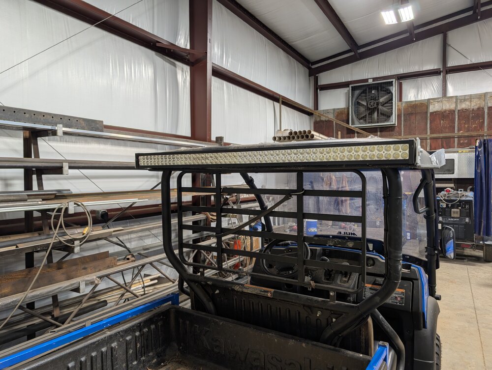

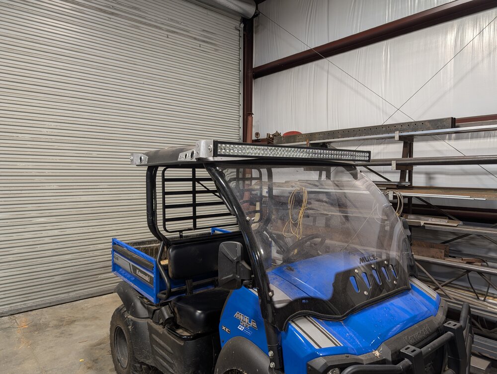

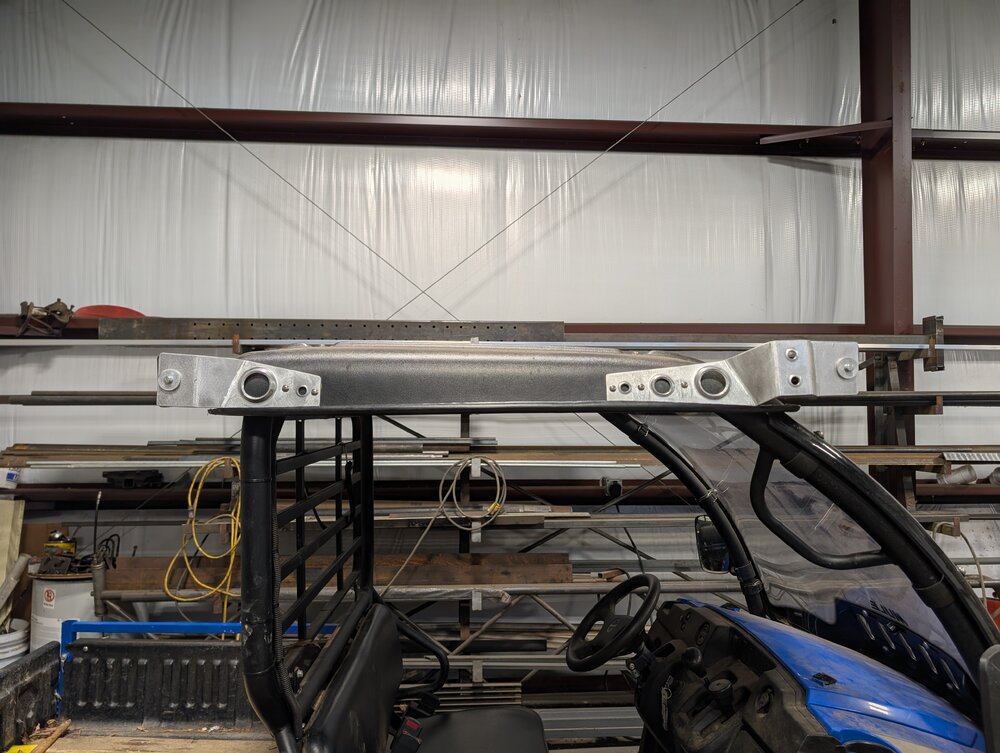

Wiring is a little ahead of the timeline. The units acquired are dang near exactly the same width as the top for the mule. However nothing is ever simple. It tappers steeply on the front slope and the sides are not square either.
Out came some scrap aluminum and a lot of swag engineering. A couple off set bends and cussing to make it work in a box pan break instead of a press style die I came up with these.
Dimple dies because I had them laying around and rarely use them. The brackets are 3/16 so they really aren't needed. Less boring and maybe goofy 🤪,
Can't wait to cruise to the creek and have cold beer watching critters. We will see how many honey bees they attract soon enough when I do some late evening bee work.
