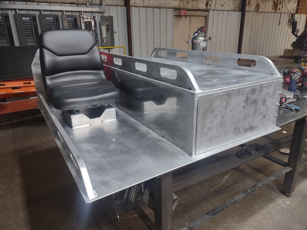

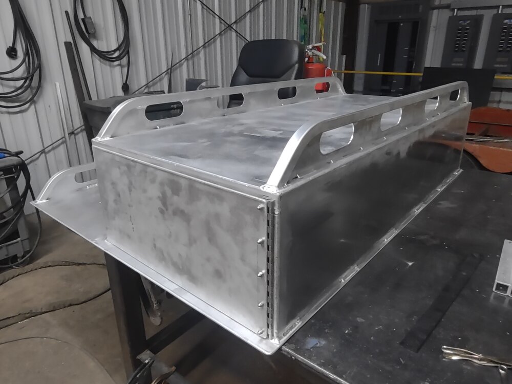

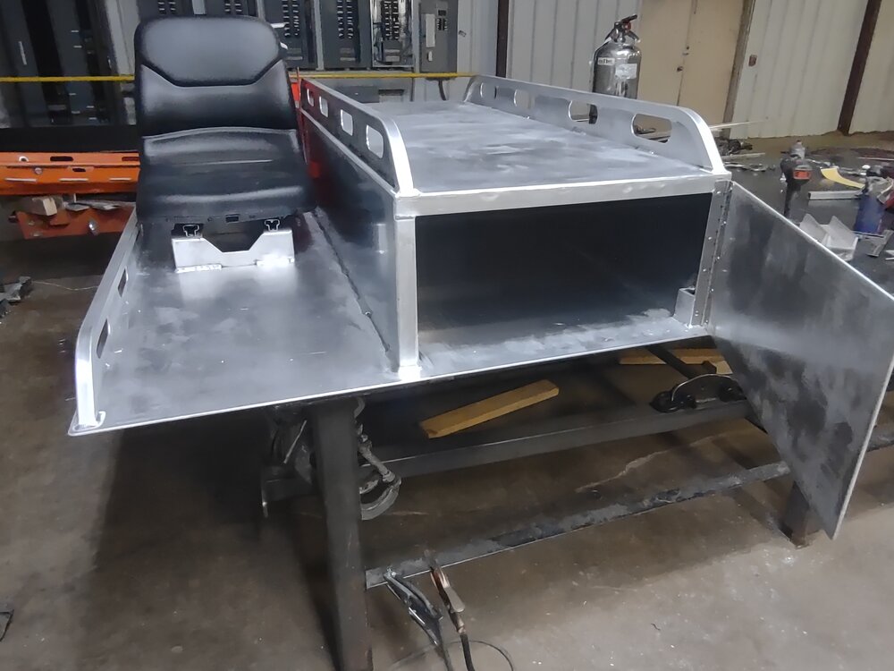

Insert for a UTV, got to drag out the ol tub bender. Tray is friction slides on high density plastic to keep it KISS. Seat is slide adjustable with seat belts and behind it store two extinguishers. It will also have a Stokes basket and IV bag pole that stores flat. Coating will be two tone. We haven't decided if it will all be tinted bed liner or not.

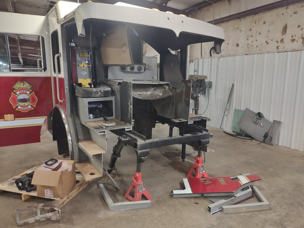

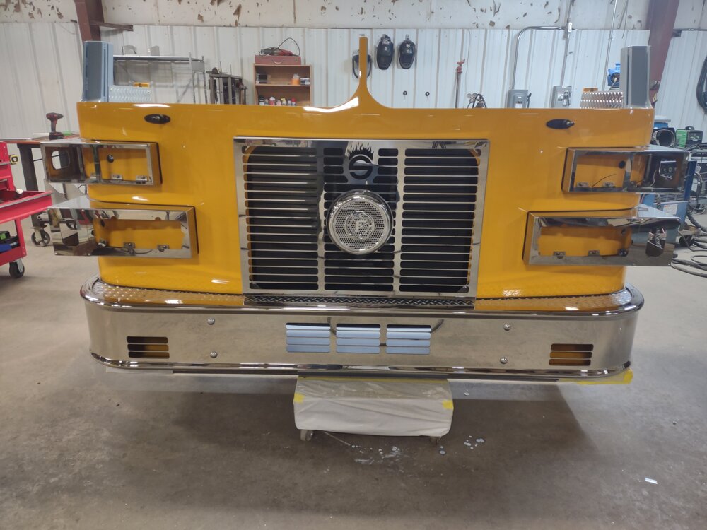

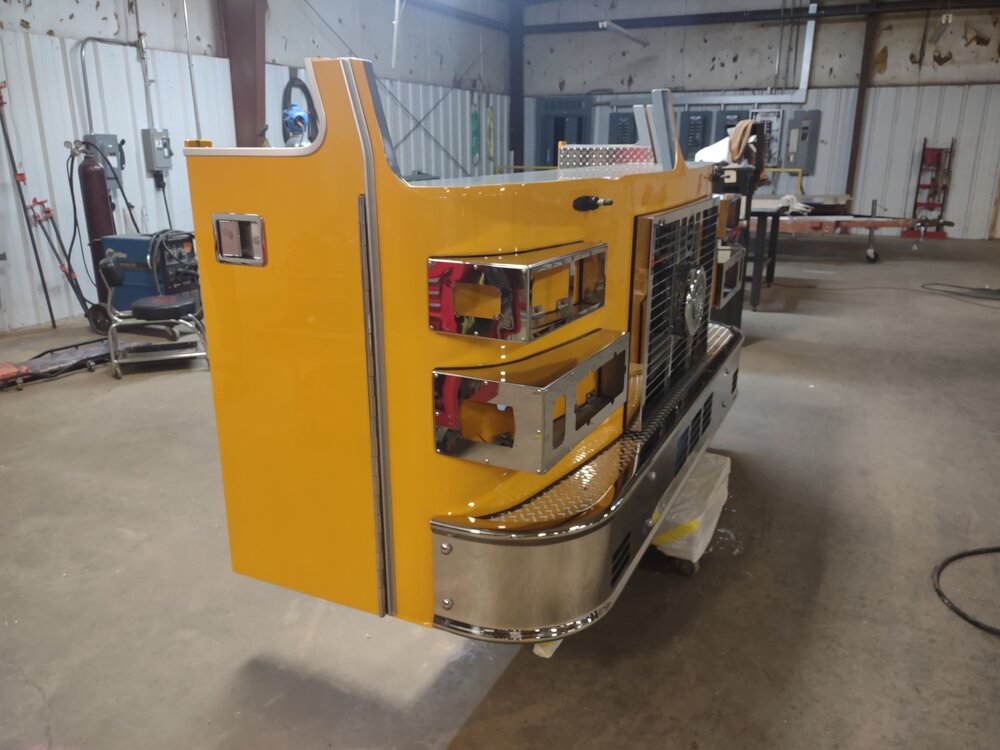

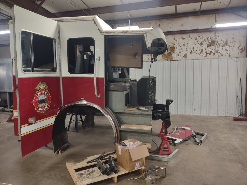

This truck had a very bad day. Complete roll over. Word was it was such a yard sale the service body detached and was laying separately from the cab and frame.
It ended up at a wrecker yard. The cab was torched from the front mount and wires snipped and delivered whole.
Fast forward and many hours later.
I hope to get some in progress pictures from another fella. He didn't fab but did take photos, šŸ˜‚. I didn't have time.
The front was down 1.5 inches on the passenger post and the driver drove up about the same. So it was twisted pretty bad.

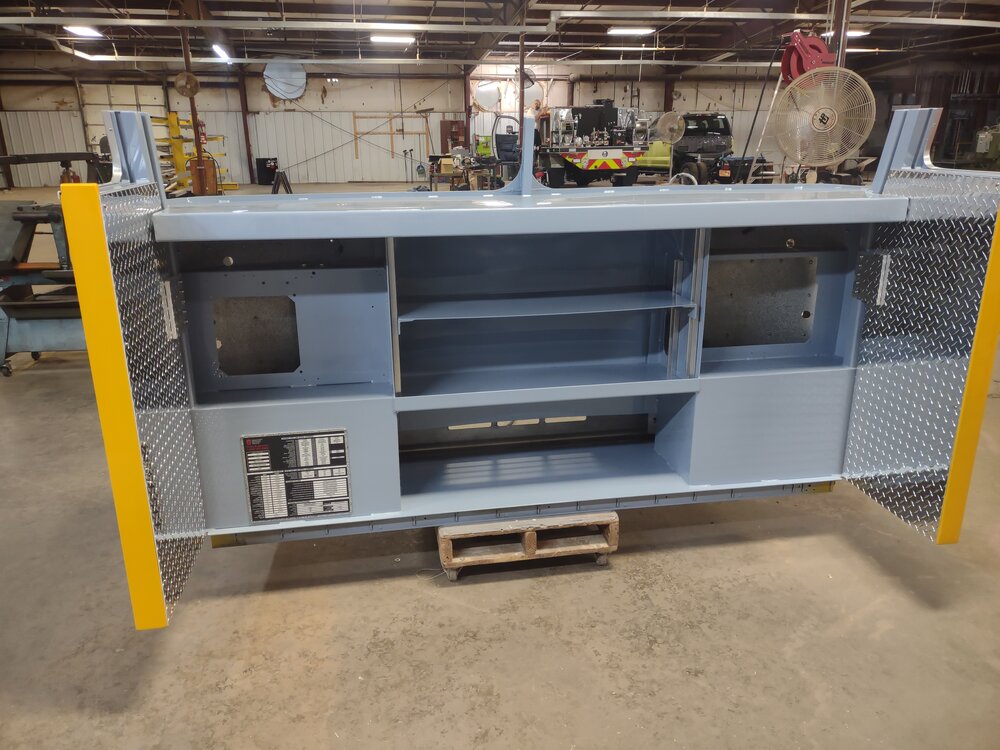

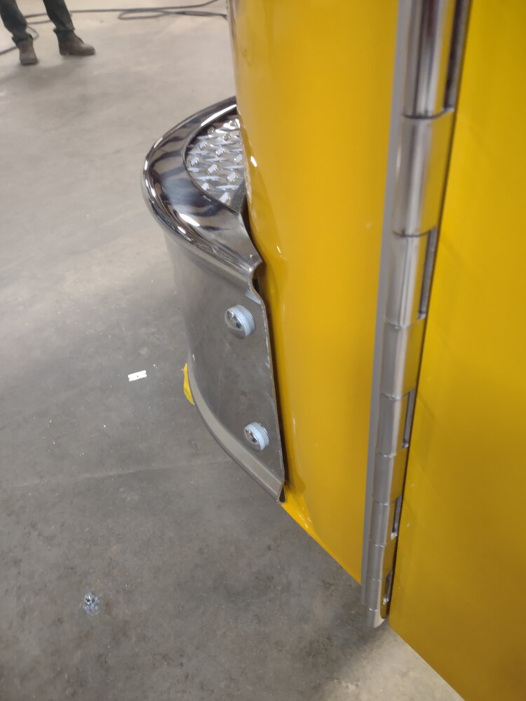

All the door post and A pillars where crushed or broken. I sectioned two door frames and inverted them for the lower window tracks. The trim was mangled so I robbed a square frame from a rear window and formed them for the front.
The doors got cut down, gutted and reframed out to support a door skin and needed hardware.
One A piller was bad enough I pulled a chop and section like lowering a roof line. The center support was none existent. Reworked that and it should receive cut down windshield glass.

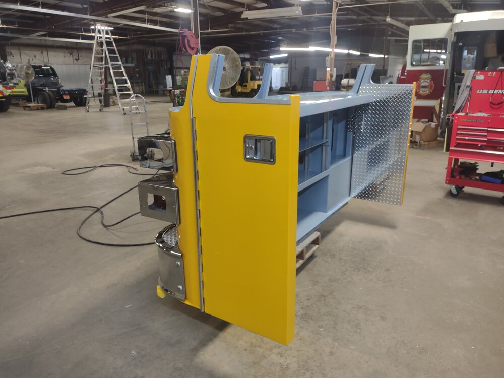

Bumper goes on like a standard build but we cut it down some for a shorty filler panel and a tighter fit than normal around the body line.
The whole body height was lowered as well by almost a foot.
The interior got a lot of factory braces and metal trimmed or deleted. The pockets have fillers not seen to cover old cavities for stuff like steering and the normal ten miles of wire and circuit boards and relay panels. Doors got smoothed out with ATP and I locked them in place with bracket on the original door stop location.
Added an adjustable tray because.... firetrucks have them, lol.
The whole unit will have stripping lettering and a ton of brand new LEDs, headlights, and a inverter to run them all on 110 volt power. The grill and false Fed Q will have backlighting as well.

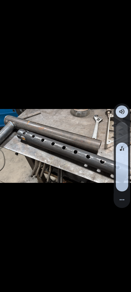

Been tinkering a bit on a personal project off and on. Had the frame built probably a year for the top.
Here's a further part before we get to that.

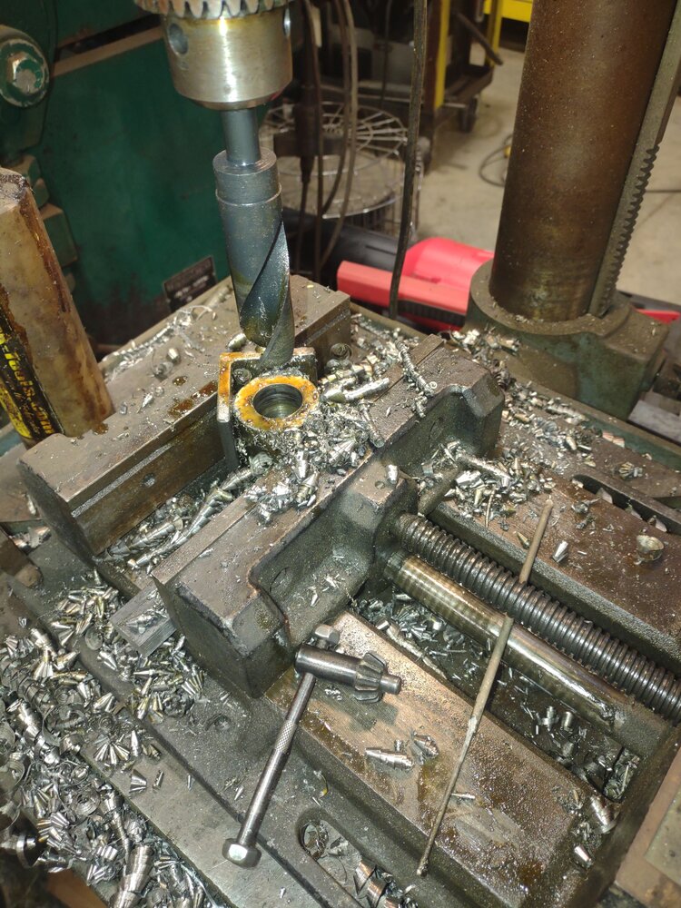

It was a video clip. File was too large. Anyways series of holes. Indexable in a through pipe to pick more or less air flow. Three choices. Small medium or large.
