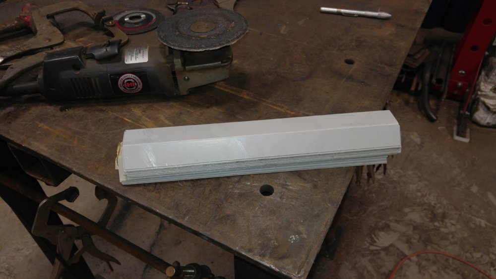

We use sno gem products. I prefer their bar systems.

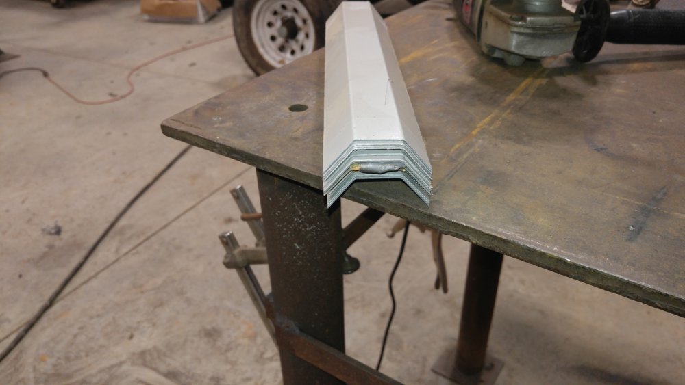

Was this supposed to be my gutter ties?
Right where I climbed up was one.....of course the end on the outer side wasn't attached to the gutter. But it was spanning the opening. Like awe fawk it no body will see it?

I work for my brother in law. We do commercial construction but specialize in metal roofing.
Looks like it. 2 screws into the roof and one into the top lip of the front of the gutter. I put them every other rib.
And make sure butyl tape is applied to the bottom of the hanger to keep it leak free.

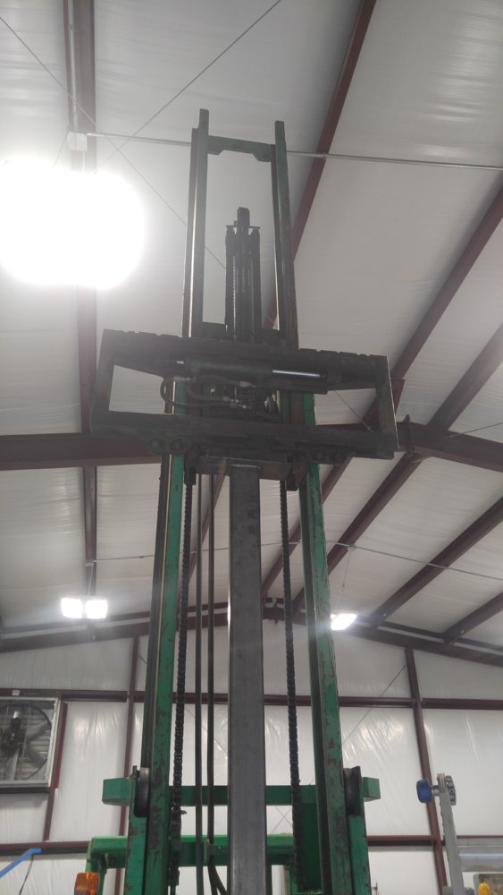

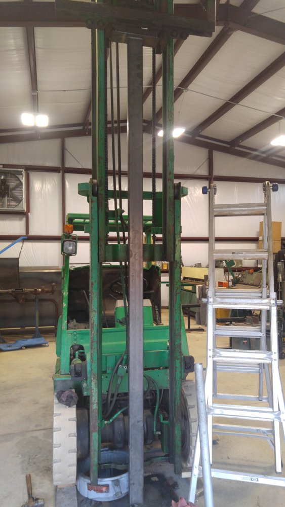

I solved my over head crane vs fork lift or other lifting methods.:)
It introduced a new problem in the form of some needed maintenance.:mad::(:mad::kaioken: When repairs are completed we will be on to proper use. Possibly accompanied by questionable crane duties..:lol:
Smilies are very accurate for the range of emotions experienced at this phase.
:rockon: The previous owner is one heck of a stand up guy. He actually fixed a fuel solenoid, pump seal, and a main cylinder before pick up. Now he is working with me on two small lift cylinder repairs. All are just symtoms of use and some age. The unit has great potential and is solid. After this I hope all the weak links are addressed. If not, it might end up completely refurbed.o_O
