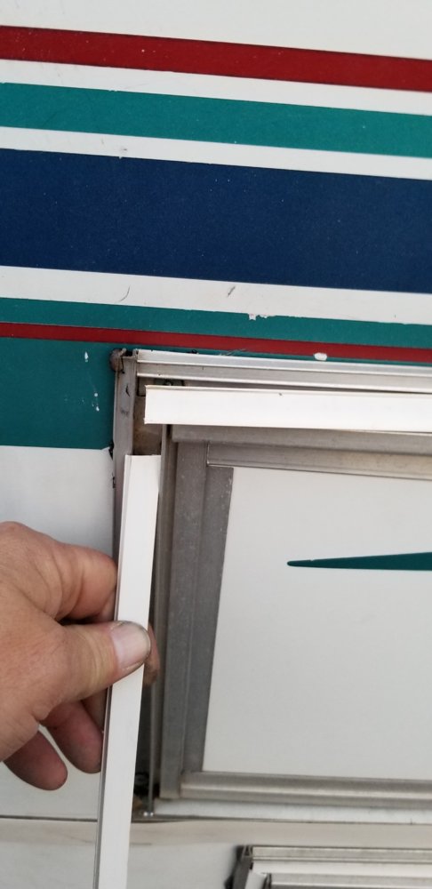

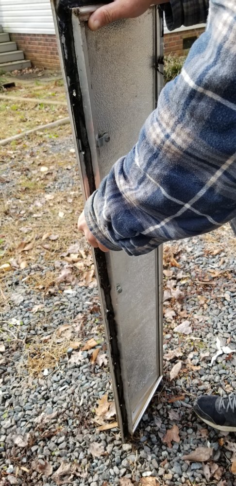

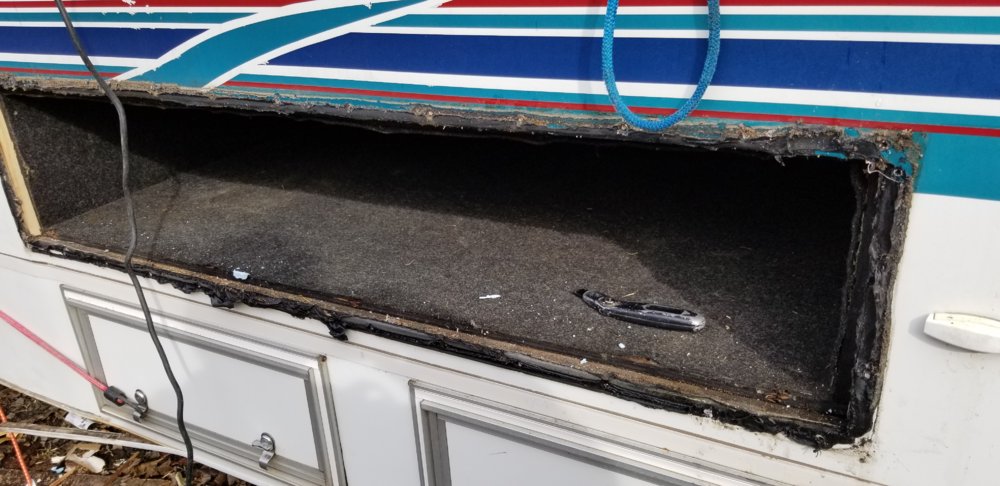

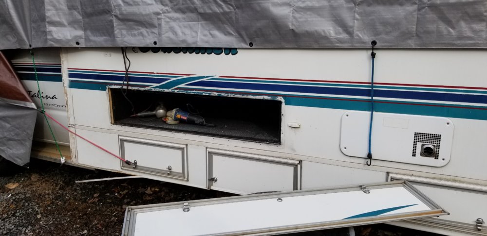

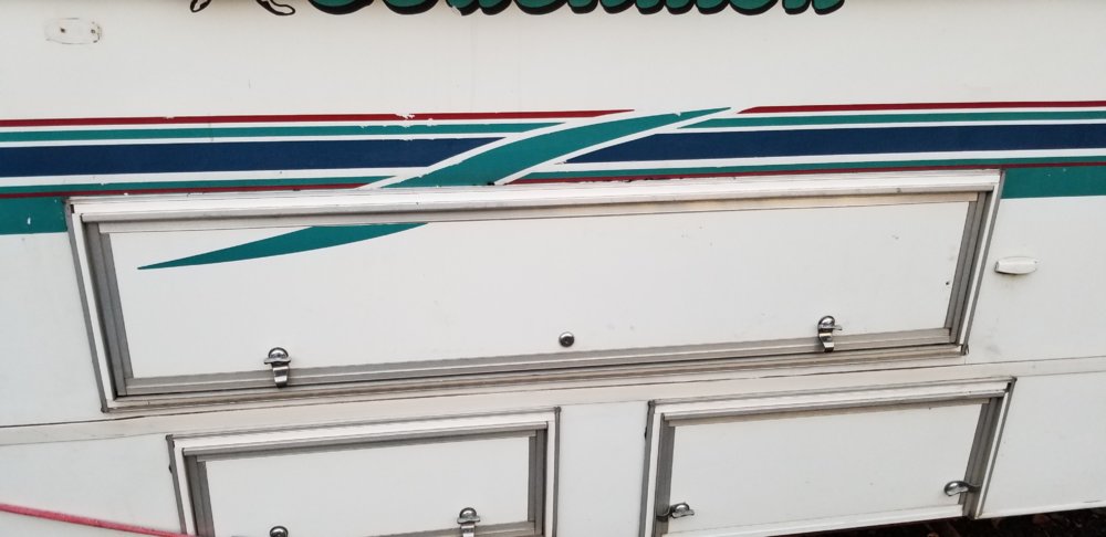

While I had the storage box removed, I noticed it had been leaking. So I decided to take the compartment door off, clean off the old sealant and redo it. Should be good to go for a while.

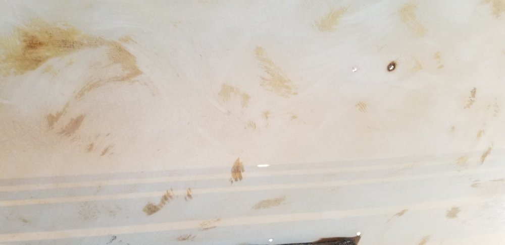

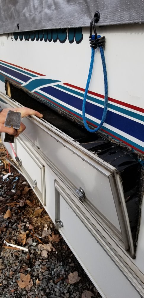

It took a while to clean off the old sealant. It's a sticky job.
Both sides were coated with this crap. Just think....All of the windows are the same way! Hours of removing old sealant by peeling it off by hand. Razor scrapers and this outside skin dont play well together.
Add new sealant, stick the door back in place, screw it, and pop the trim pieces back in.

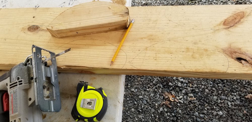

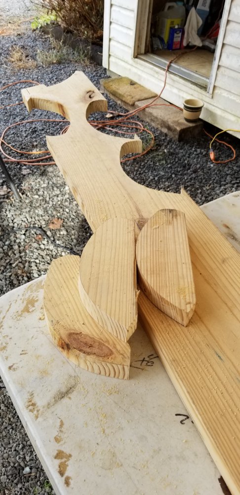

I was able to salvage one piece of wood from the nose cone. This pc. was encased in expanding foam and I had to dig it all out. I suppose the foam help preserve it. I traced out patterns and cut a few new pieces.

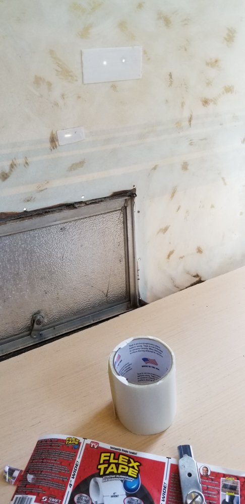

Oooops! I poked a couple small holes in the outer skin while prying off the old luan. Figured this would be a good time to use this fancy Flex tape. I hear it " even works under wuudder".

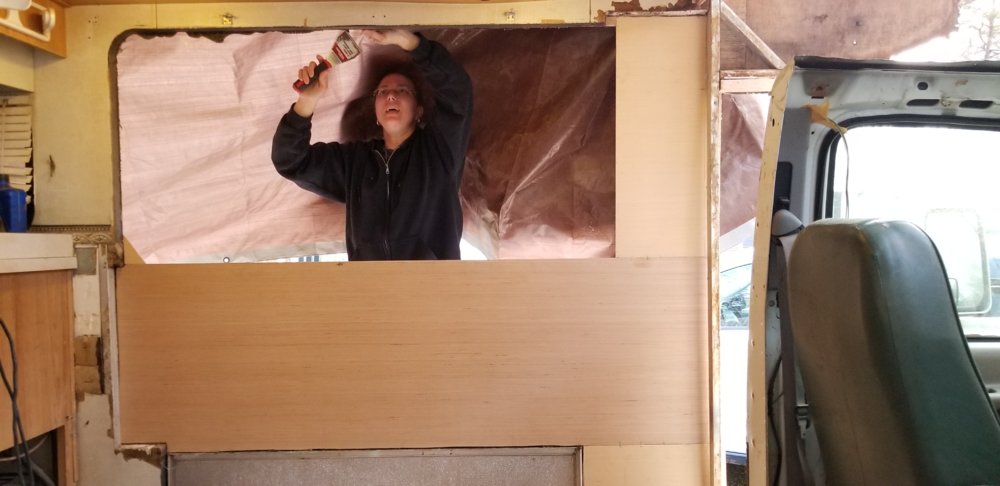

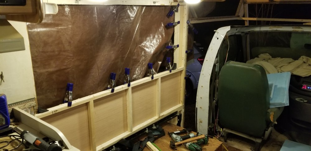

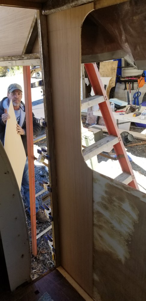

We removed both of the large side windows. And finally started gluing the pre cut luan panels in place. All of the water damage was below the windows. Except for the woodwork that is the window frame. It was mostly all rotted. I'll need to rebuild all of the window frames. Here's Brooke on the outside cleaning more of that damn sealant off. I am so happy she is willing to help in any way she can. "Yes honey..I have something you can do. Clean this sealant off while I stand here and figure my next move"

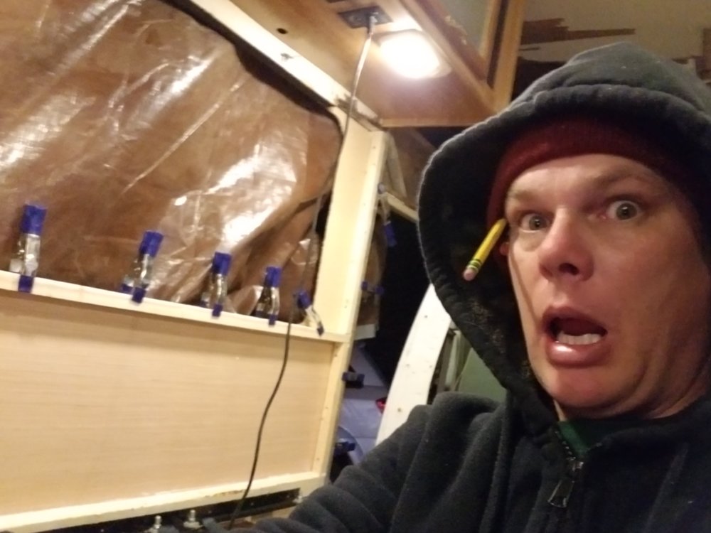

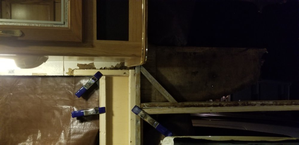

aaaaghhh! I'm losing my mind in here! But I've started on those window frames. Gotta glue them up and screw them into aluminum wherever I can.

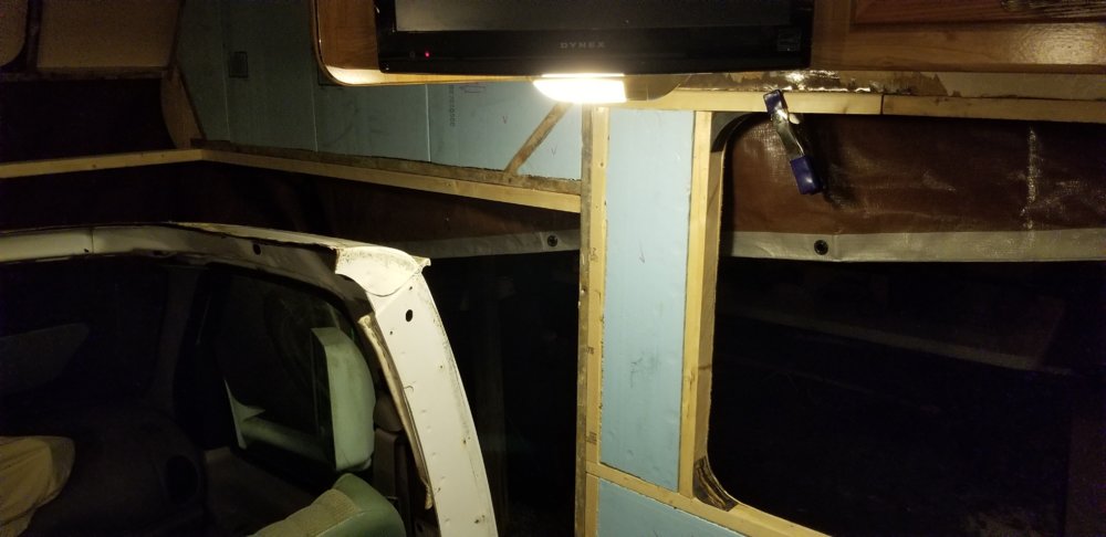

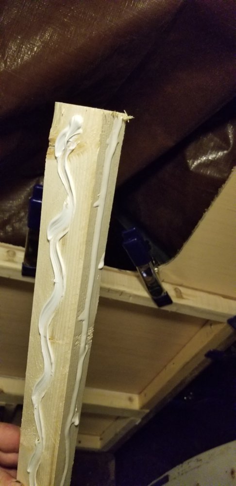

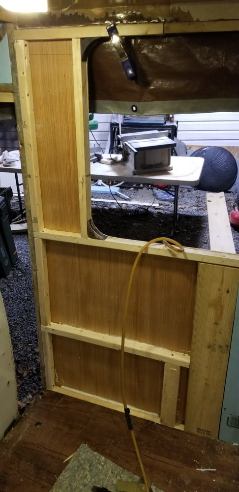

I had to add a few studs. These will help when its time for final paneling. Also..adds a good place to fasten things later on. All of this is glued and screwed

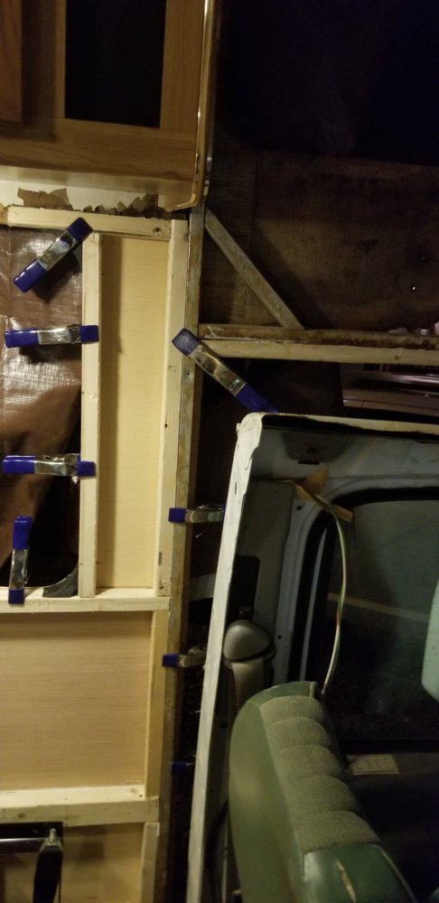

Here's a few pics of the replaced/rebuilt framework. Wherever you see new wood, remember, its replacing rotten wood. It's hard to believe that we are finally moving forward, instead of removing old crap.
The wood framing at the bottom is built in so I have something to screw the booths to inside the walls. Its s shame all this hard work will be hidden with paneling later on. After the foamboard goes in, of course. You can also see the little plastic window corner thingies. We had to salvage these. Cleaned up nice.

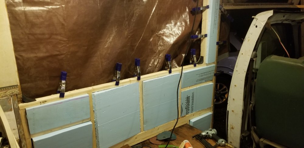

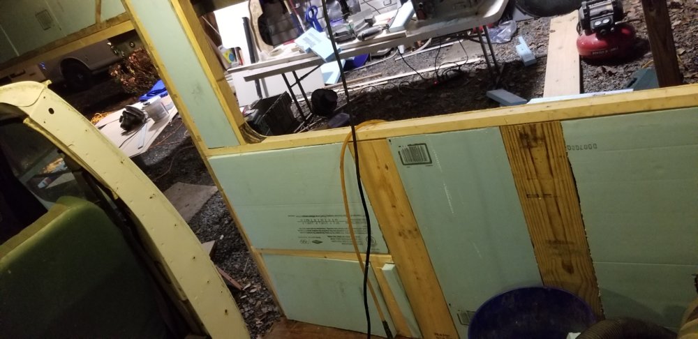

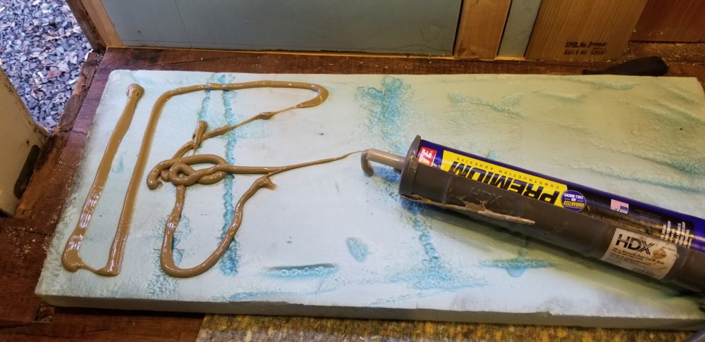

With all the foamboard cut it was time to test fit. They're all nice and snug, but that's not good enough. These puppies gotta be 100% slathered with glue and stuck to the luan. I tried the stay put spray glue but it ate through the foam faster than Ella can eat cotton candy.

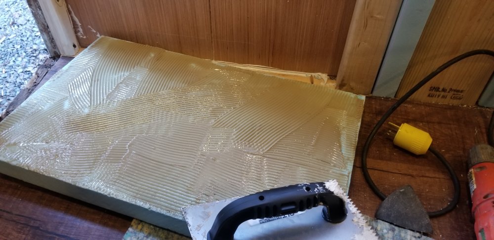

I had to find another approach. So..I tested a few other methods and glues. After leaving the test subjects outside in the weather for several days...A winner emerged. Loctite proline premium!
I'll have to squeeze this stuff out...
and spread it on with a trowel...
once in place..its stuck!
