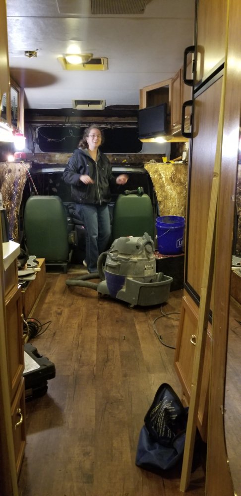

As I said earlier..time for a real cleanup and to make it our own! Here's Brooke cleaning everything. She spent hours cleaning everything.
Ella is excited, the rv smells better thanks to a good scrubbing, but Ella says her throat still feels tickly when she goes in. Ok..now I'm thinking the fabric on the jack knife bed, the booth seats and end pcs. ( pictured here) have got to go. Also..the carpet needs to go. I know a guy.
I have some lvt flooring that'll work great in the rv. This was leftovers from a pallet purchase. So free to me! First thing to go before installing new floor is old dirty carpet. This will get rid of the still lingering, slightly musty smell...right?

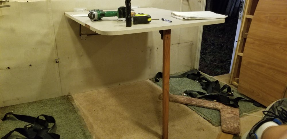

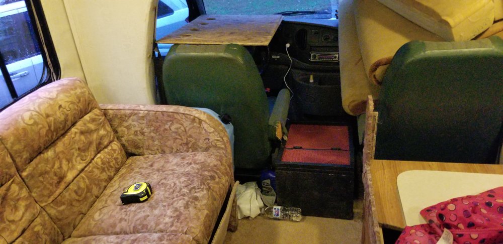

I had to remove the booths to do it right. This allowed me to see more of the side walls. Hmmm...the walls dont look so great and are showing me a bit more water damage than I, or anyone could see earlier.
The original carpet is green. The lighter colored carpet had been added later, but it was time for it all to go.

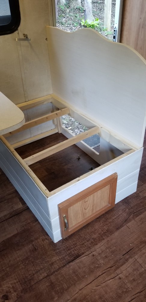

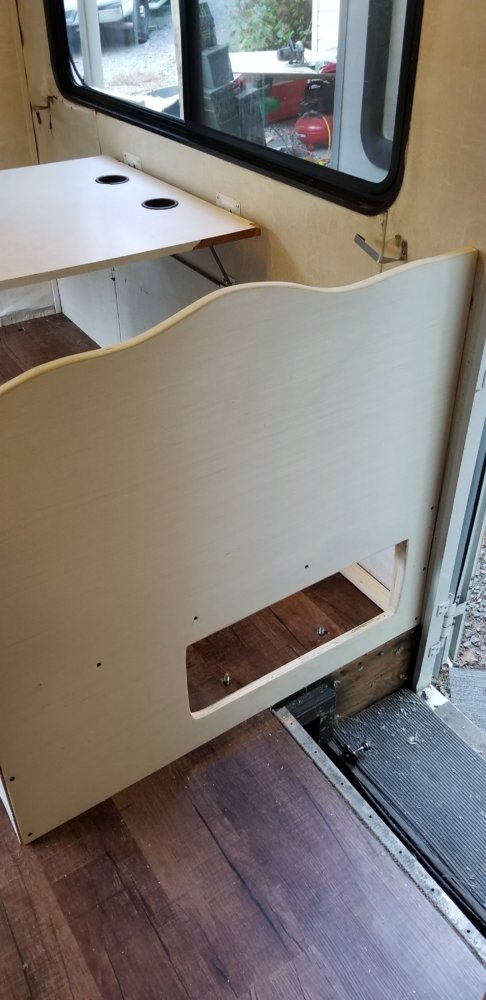

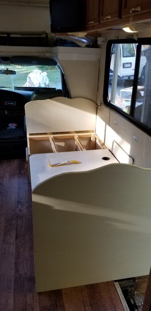

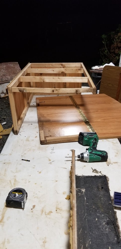

I removed the booths, cushions and decorative end pcs. And it wasnt long before I decided to go ahead and rebuild them. I kept part of the old framework, and added on,beefed up, and replaced some of the wood. The wooden end pcs and fabric covered pcs looked simple enough..I figured I could just build new stuff. So..I did. New plywood, cut to the shape Ella and I decided on..sanded, painted white. Also, new paneling to cover the sides. I will do new doors down the road.

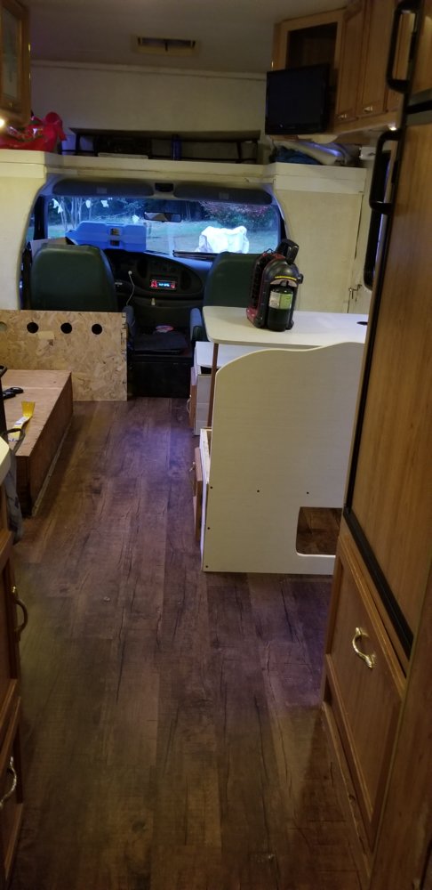

you can also see the new floors! I forgot to take pics of sub floor, but other than a few minor water spots, it was fine. I vacuumed it real good and sprayed it with some anti mold juice.

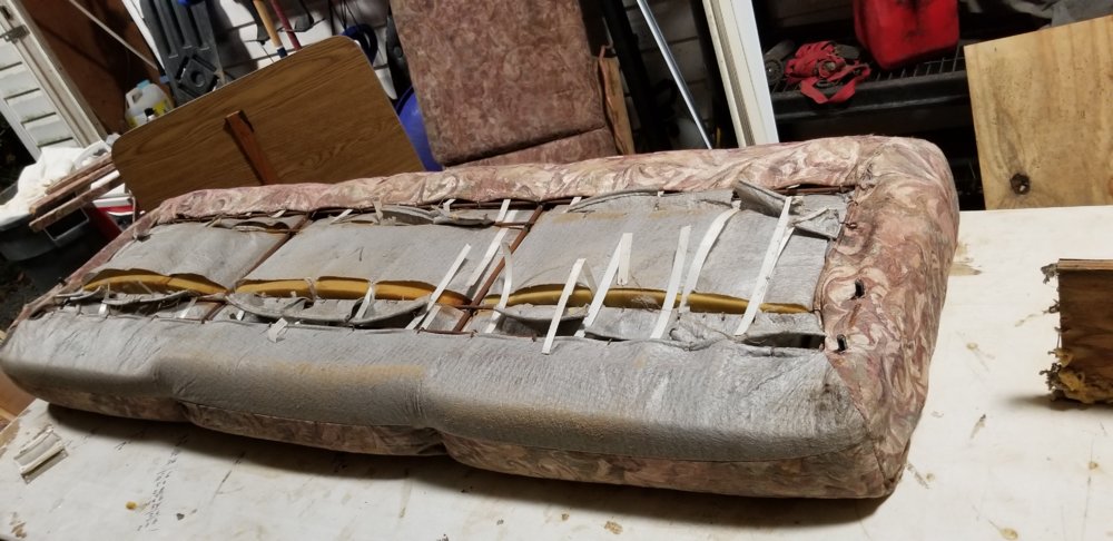

Brought the booths back inside the rv to get a good look. There's some decent storage under the booths so I cut a hole, and added a place to store shoes, flip flops, boots etc., right as you walk up the steps. This new feature should come in handy. Also..tossed the old cushions to the side. Brooke started searching the internets for new cushions. Also pictured are the old jacknife bed cushions. All this old fabric has gotta go! That'll make the musty smell dissapear..right?

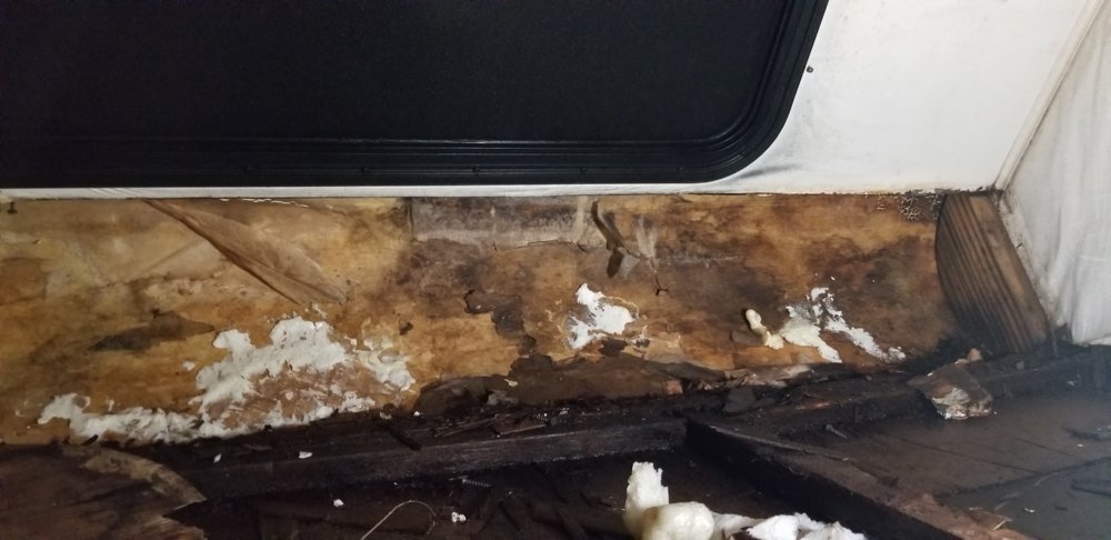

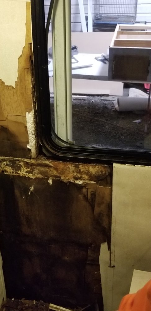

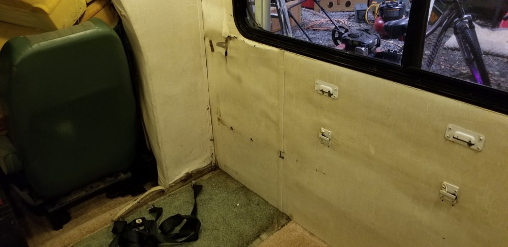

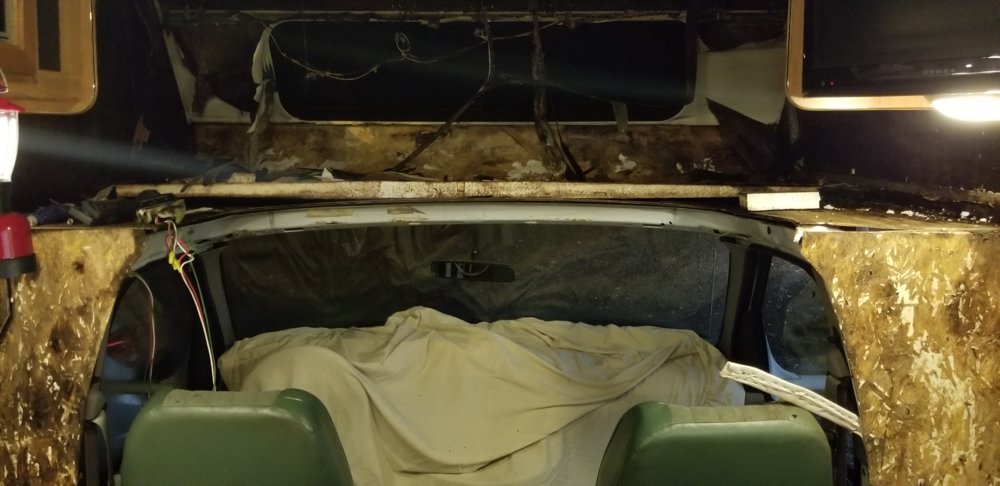

With all the cushions,fabrics, carpets, and curtains gone, it was starting to smell a lot better. BUT...remember those ugly water stained walls?

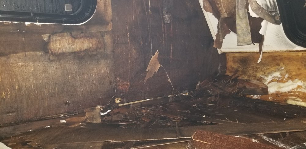

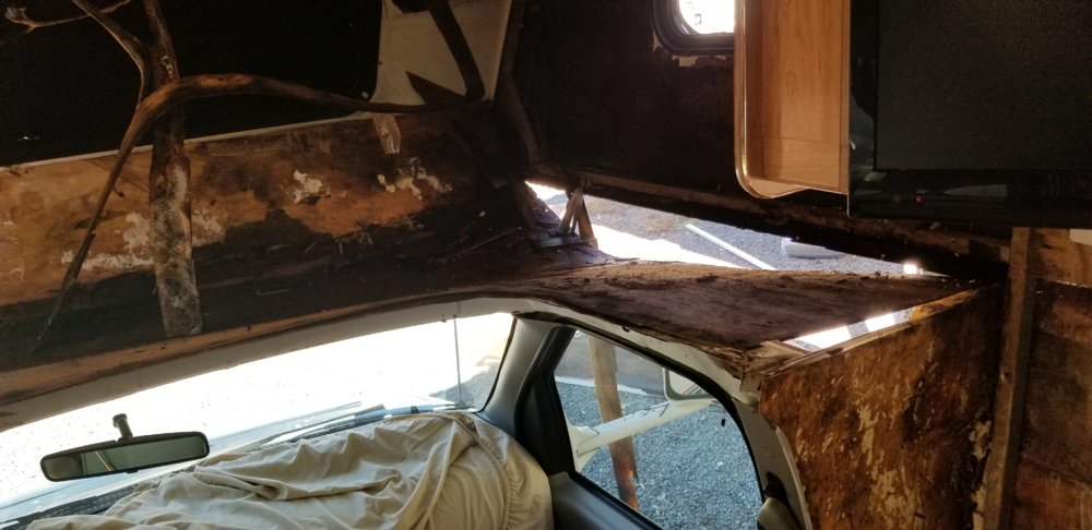

I poked one with my finger...huh oh! That cant be good. I peeled the wall away like wet cardboard! At first it was just the lowest corner, behind the passenger seat. Then further up....then....damn it man! I kept finding more and more water damage and rotted wood. It just kept going. All hidden by seemingly fine wall materials. It was not fine. Some of the wood had the consistency of half cooked brownies. Seriously, I could have spooned it out.
The following pictures were taken over a 4 day span. I learned a lot about how these things are built. More than I ever intended to know.
At this point, it has become obvious that new floors and a couple new seat cushions AINT gonna fix this.

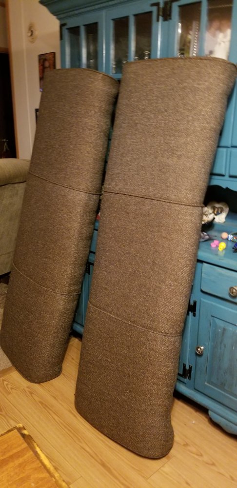

About those cushions....I've got a friend local to me who does upholstery work. He's done some r v seats.
You can't find better or cheaper online

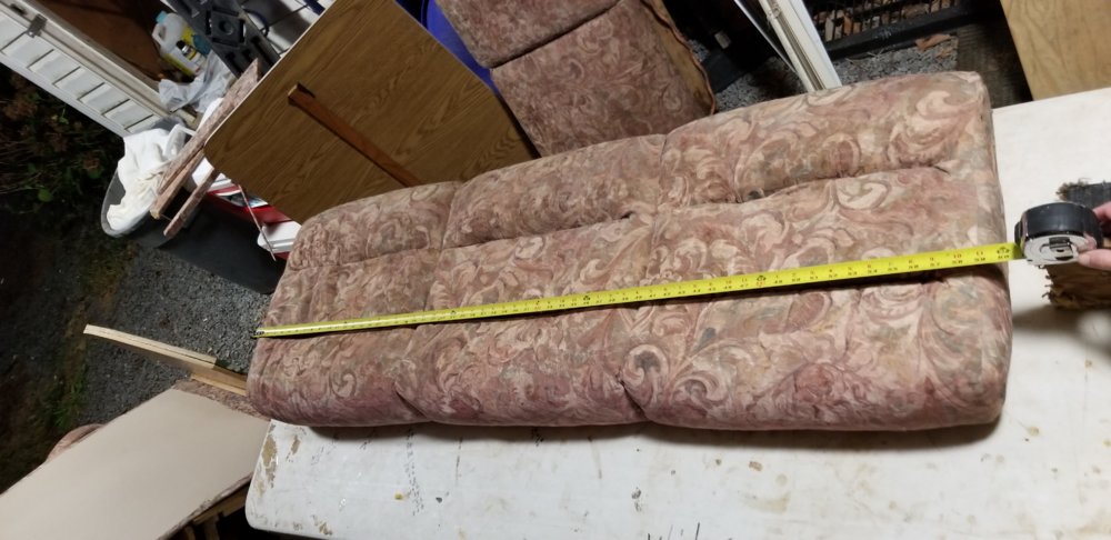

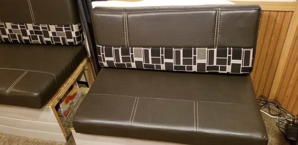

Too late man. It only took Brooke a few minutes online and an order was placed. Actually..almost all of the dinette cushion sets were crazy expensive imo. But she found a place that had one last set of an older design. These are a couple years old, but are still brand new. These were a couple hundred bucks and free shipping. Which , believe it or not, was a few hundred cheaper than the rest she had found.
And I too have a friend in the upholstery business. Twins upholstery here in Mocksvile. I have traded out some carpet work( 1 set of steps installed took me 2hrs to do) and in return, I had my sofa bed cushions refoamed and covered. Pretty good deal to me. Not an exact match with dinette cushions, but good enough for us!

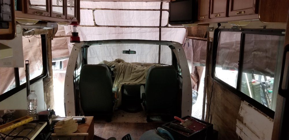

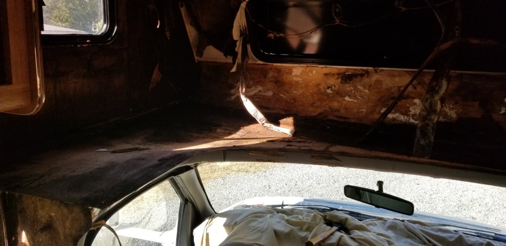

With most of the wet wood out of the way it was time to start looking at how to fix it. But first...how was it built?
The outside walls are thin frp stuff. (Fiberglass reinforced plastic.)
Glued to that, is 1/4 inch luan, glued to that is 1 1/2in foamboard... glued to that, are the inside walls. Its all one big laminated/glued together sandwich. Which makes it pretty strong as a unit. I gotta figure out how to make it a sandwich again. I had no real clue how..but now I do. Unfortunately...I dont have a lot of pictures that show how it was originally built, or much of the tear apart process..so I'll just hit ya with this one picture... This should be a real WOW moment for yall.

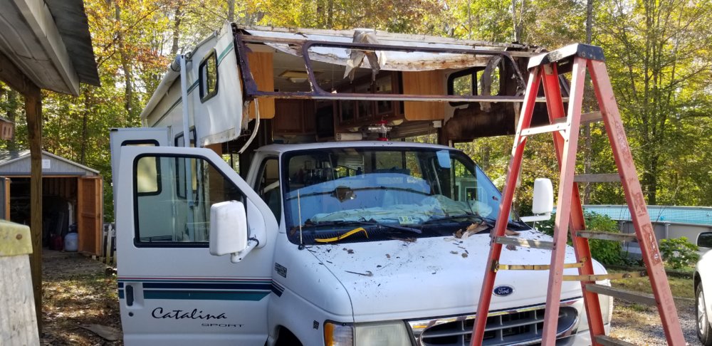

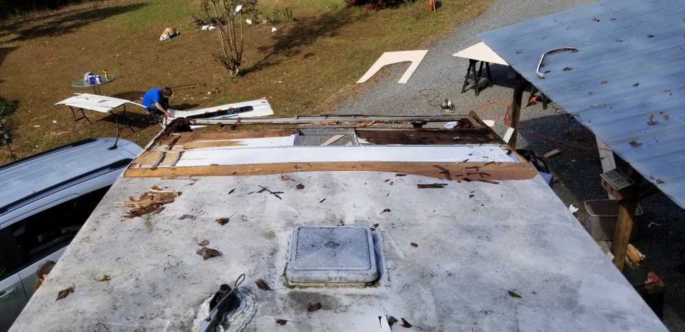

Outside and rooftop photos. We will be installing a new rubber roof as well as a couple new vents. The most foward vent pictured (actually a square hole you can see)might be deleted, still thinking about that. Itll be one less place that can leak..right?
Also...Brooke is absolutely thrilled with how this project has spilled out into her yard. Lol. I need a shop right?
